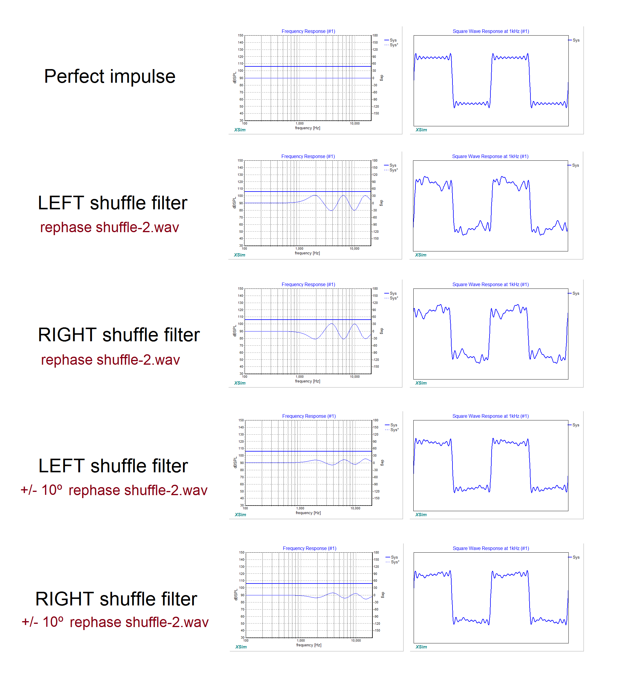

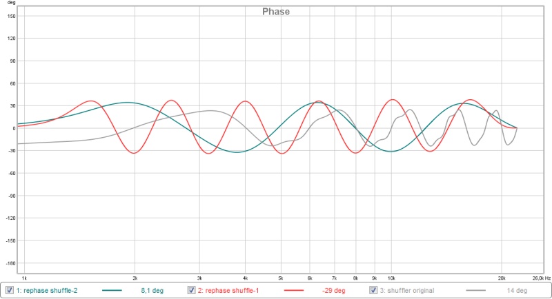

Yes, the same one BYRTT recreated. Pano posted a course (RePhase Shuffle-2) and a more fine toothed (Rephase Shuffle-1) shuffler.
The Rephase Shuffle-2.wav has very similar phase behavior to the original shuffler, without the FR changes. The other RePhase based shuffler has more fine variations. Edit: Hmmm, might want to review the above statement, here are the 3 phase results of the different shufflers:

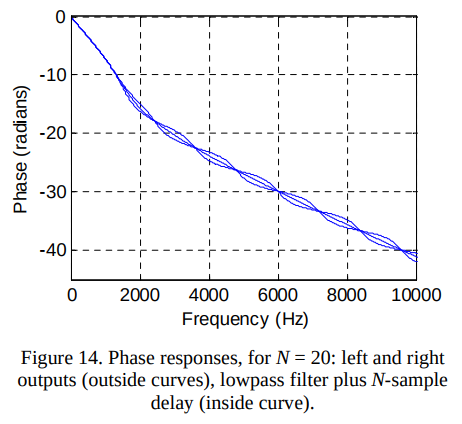

Hi Pano,
I wonder still at the following quote:
"The phase alternations were made to mimic the phase of the original multi-tap shuffler."

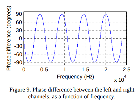

There are a few useful clues given in the form of images in the PDF, attached. I am going to make a few more versions based on these images.
Specifically, the first image suggests the frequencies that aught to be phase-decorrelated between L and R.

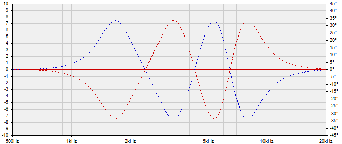

It will be implemented as two presets, "Pano Phase Shuffler - Left" and "Pano Phase Shuffler - Right", in the paragraphic phase EQ tab. That way it will be easy to add it over any existing correction (including individual drivers).
I don't intent to release rephase 1.1 just yet, so there is time for tuningI'm sure this shuffler could be made better.

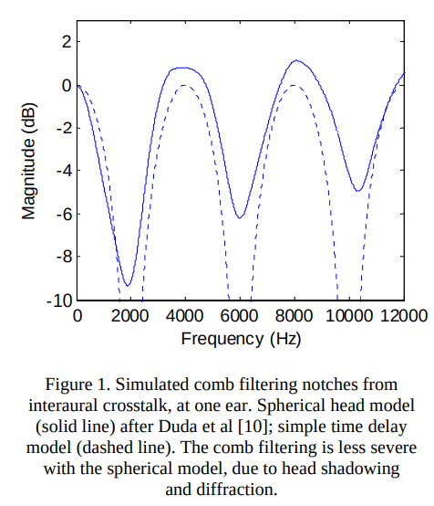

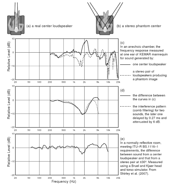

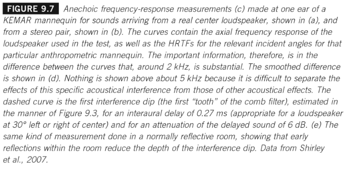

Data from Floyd Toole's book related to phantom center dip
Toole seems primarily concerned with the ~1.7kHz dip:
"...above about 5kHz... it is difficult to separate the effects of this specific acoustical interference from those of other acoustical effects"
Also of interest is the last graph which shows the comb filtering still has effects in a normal reflective room.

Combined data for comb filter dips
I combined the data above into a single graph. It's pretty messy but indicates that the rephase-2 shuffler could be improved by moving the phase shifts around to better match the measured interference dips, which to be fair are not in complete agreement from one simulation / measurement to another. From looking at the combined graph, deviations occur mainly at:
1.7kHz (similar to rephase-2 shuffler)
3.4kHz
5.5kHz
7.5kHz
10.5kHz
Not sure why these aren't multiples of the first dip.

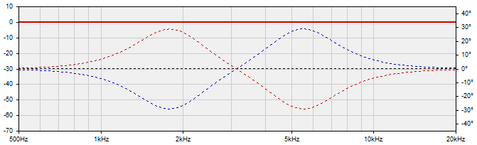

And another. 1800 and 5400 only. This one works well, I could tell right away. I like this method of adding a single phase shift at a time, making it possible to hear the effect of each.
https://www.dropbox.com/s/lyuymy2965mrw5j/rephaseMin2-24-44100.wav?dl=1
Note that these are even multiples, which makes a lot more sense...

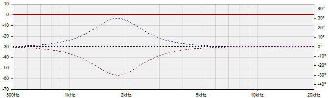

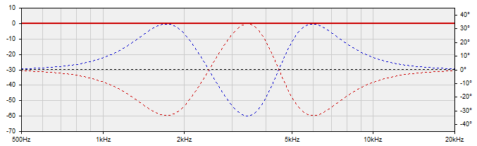

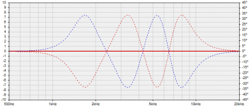

Finally struck gold!

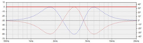

OK I've got something really good now.
The premise was to use the minimum amount of +- phase filters, corresponding to the dips shown in the combination graph I posted earlier. The peaks in the measurements should *not* be dealt with in this manner (I created several bad sounding filters which showed this to be the case). The peaks are not related to comb filtering, more on this later.
Min: 1.8kHz (+-30 deg)
Min2: 1.8kHz and 5.4kHz (+-30 deg)
Min6: 1.8kHz, 5.4kHz and 10.8kHz (+-35 deg)
Min6b: (shown) same as above, but Q adjusted to match measurements (+-45 deg)
Min6c: same as above, but +-30 deg
Min7: 1.8kHz, 5.4kHz and 9kHz (+-35 deg)
- Min7 "made sense" as it was +3.6kHz each time, but doesn't work as well as Min6
Min6b is the best so far, hence the bold.
The difference between 6b and 6c is only the amplitude of the phase adjustment. The amount that the dips are filled in sounds proportional to the amount of phase difference between the channels. I haven't pushed it past +-45 yet - imagine this would make things worse.
Further improvement *could* be made by:
- further shaping the curves to better match the measured dips
- matching the amount of phase difference to the severity of each dip (ie. 45@1.8kHz, 37.5@5.4kHz, 30@10.8kHz) ??
- EQ'ing the mid channel down between 2kHz and 10kHz to compensate for peak (difference between HRTF at head-on and where the speakers are actually positioned)
I'd like to hear what you think, especially if you've already tried Pano's rephase-2 IR.

Thanks Mike for the further experimentation. I was trying to remember why I chose what I did, and think it was just trying to get the same number of phase rotations into the same bandwidth as the original- with 1.7-2K targeted as the first major shift.
My guess is that the phase shifts should be targeted at the comb filtering caused by an average size head listening to speakers with a standard offset angle. From there, things could be fine tuned to suite the listener and the system.
At some point I'll make some WAV samples for those of you who can't easily audition impulse response. It's important to be able to toggle quickly between the filters, so a webapp that has the toggle buttons built in would be best.
Thanks for starting this thread, and I agree, individual fine tuning might even bring a greater revenue. This is starting to look like a combined solution for a couple of stereo problems.
- Fixing the Stereo Phantom Center
