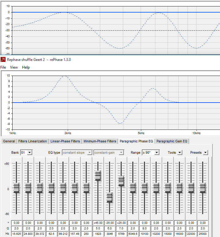

Looks like I also needed 2 attempts to nail it. What a night of sleep can do.Thanks for trying the shuffler and for your comments. I'll take a look at what you've done, sounds like a good approach. I can't remember what my final version of the shuffler was, it's been awhile. Will have to go look. That was my basic complaint, too.![]()
This is what I currently have, compared to your original one on top:
The idea's I tried to implement:
- In general use narrower filters. (The drawback is the angels of your setup need to be correct, or you need to adapt the center frq's).
- Increase the Q factor for higher frequencies, as the absolute bandwidth of the comb filter notches decreases
- Decrease the phase angle for higher frequencies as the comb filtering effect is less when going up
- Don't bother with the higher comb filter frequencies, as I guess the resulting notches become that narrow that they are being masked.

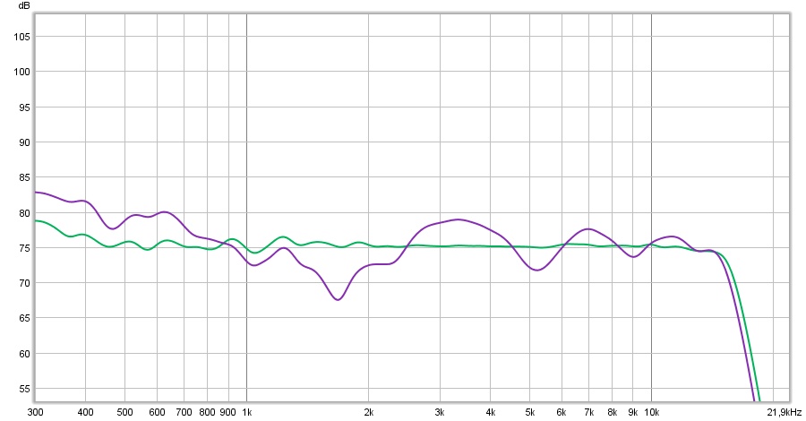

A left speaker measurement, right speaker measurement and a sum measurement at the listening position would tell a lot. The solutions mentioned in this whole thread work best for speakers + room that have a RFZ (reflection Free Zone). My guess would be that the Cosynes have that due to their Horn loading which reduces side wall reflections. The LP6 will probably light up the side walls too much, together with wide speaker placement.
Get them away from side walls and the wall behind the speakers and they should be able to have a decent phantom presentation.
Easiest would be to compare both speakers, the Cosynes and the LP6, as measured at the listening spot.
Here's an example from my arrays, featuring the left side, the right side and their sum as measured at the listening spot:
This particular plot is a 4 cycle presentation (REW), it was the first I found but it shows the sum is quite good in the exact sweet spot.

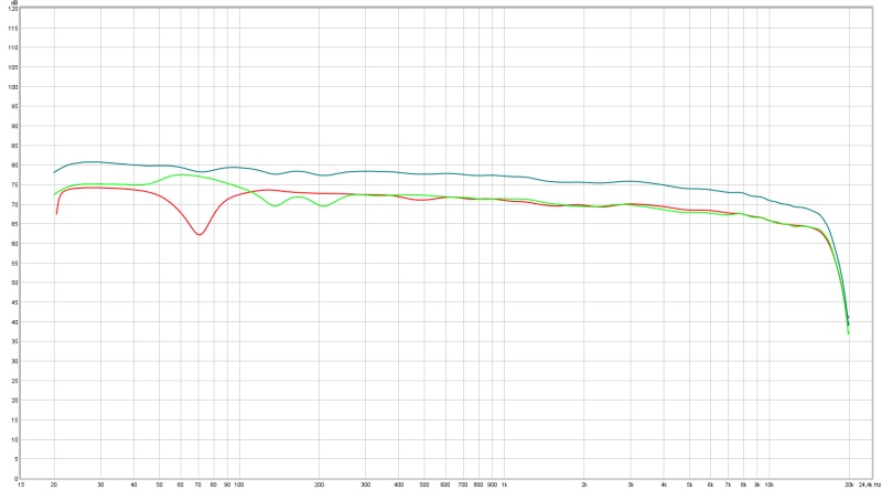

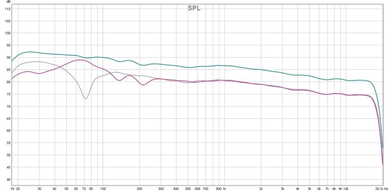

Here's another 6 cycle example I managed to find:
I'm using the frequency dependent window to mostly view the first wave front that hits your ears (or the microphone). Tonal balance (room curve) is adjusted using longer windows, letting some of the room energy back in.
For Stereo listening I use mid/side EQ to counter the effects that are discussed in this thread. For Home Theatre (with no actual center channel) I still use the shuffler technology because we have the discrete center channel source available.
My measurements showing the Stereo cross talk can be found here: https://www.diyaudio.com/forums/full-range/242171-towers-25-driver-range-line-array-492.html#post5788862
An example:
FDW 20 cycle, somewhat smoothed. Shown here is left channel by itself vs left and right channel at left ear position. No idea if this plot was taken with or without dummy head, I've done both, too lazy to look it up.
