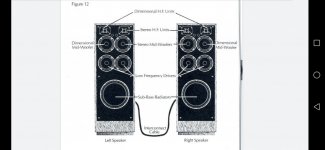

Well thats interesting system, see for example SDA1 manual which explains how it works https://polksda.com/manuals.shtmlDoes Polk's SDA add to the combing or make it better? If you physically cancel the wave arriving at the opposite ear, then perhaps the head turn effect isnt as abrupt.
Anyone know how its hooked up inside? the explanation is bit sketchy, how come sound reaches both ears but dimebsional sound doesn't?
Got it! Thanks.it can be found here.
Schematics for Polk SDA here https://www.diyaudio.com/community/...-polk-sda-2a-cross-over-modifications.381022/
Its some kind of a matrix, too late to figure it out how it works
Should be doable with regular stereo and DSP, some kind of crossfeed and little delay?
