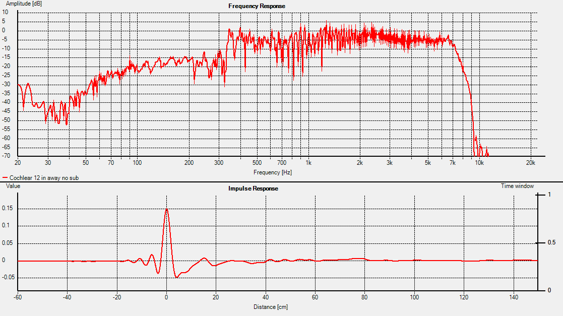

I have some near cone measurements (1 in from cone). My setup uses a Panasonic WM61A capsule and the built-in mic input on the laptop which was designed for video conferencing etc so I think it has a low pass filter at around 5kHz. I am pretty sure the speaker has plenty above this sharp falloff. What I can measure though is very flat - as expected from a cochlear spiral with stuffing. There appears to be NO reflections whatsoever and the response is amazingly flat. The bump at 30 Hz is the hum from the HVAC. The drop near 330 Hz probably corresponds to the closed-ended TL length of 36 inches (1-Lambda of 312 Hz)? Look at how clean the impulse response is, and the low THD of less than -40dB, and the nice -20 to 20 deg linear variation in phase.
I wonder what that sudden dropout is? I've never seen this on a near-cone plot. Even for a far-field response, it'd be way too sharp and of too great magnitude to be baffle-setp. Hold-on, is that response with the horn on?

I have been scratching my head on this one too. perhaps it is the fortuitous confluence of baffle step (for a 5 in wide baffle is 337 Hz) and the TL-tuning frequency? This is measured without the horn. Regarding the TL-freq, I thought an end-sealed TL freq is set by wavelength/2 but it appears to be just 1-wavelength?
Baffle-step for a 5" (0.127m) baffle would be 115/0.127=~900Hz and the magnitude pretty much always is the expected 6dB. The step tends not to show up much if the mic is significantly closer than one baffle width. A closed pipe does tune to half a wavelength, but I don't know if tapering changes anything as it does on open quarter-wave TL's, where S0>SL tunes lower.
IG
I am thinking that the cochlear gradual taper and sound its absorbent Wood's horn or 'black hole' like absorbent qualities will make it perform not like a sealed TL, but more like a semi-infinite pipe. Thus it should have qualities similar to a wall mounted speaker between two large rooms. Still trying to figure out what cause the first corner at 300 Hz though. Is it gain to the right or loss to the left? If it is a loss, could it be a (dull - broad) reflection cancellation?

I am pretty sure the frequency shelf near 300 Hz is a room-effect. I measured the frequency response again at 12 in away and got the same drop-off in frequency response when I mounted the driver on a piece of 24x36 in cardboard in an open baffle. I also used an old driver to make sure it wasn't a breaking-in effect which it is not. So the effect is clearly not a function of the cabinet design. The good news is that the Nautaloss speaker has an even flatter response than an open baffle - confirming my suspicion that the damped spiral absorbs the back wave like an infinite space.
So what we have here is a compact speaker that has a response like the front half of an OB without the huge OB size.
1/6th octave smoothing applied. Red is Nautaloss, Green is OB, Blue is OB with broken-in driver.
IG,
the dip happens to combine fortuitously with a sharp edge in the response that is predicted in the simulation. The dip is just to the left of it, and the response is already falling off at -6dB/oct due to baffle step, so what you see is a notch to the left side of the 300 Hz 15 dB cliff. In otherwords, a well placed dip in an asymmetric baseline coupled with a sharp cliff on the right. That is my theory anyhow. An easier way is to change the speaker height or room location when measuring. I don't have another driver.

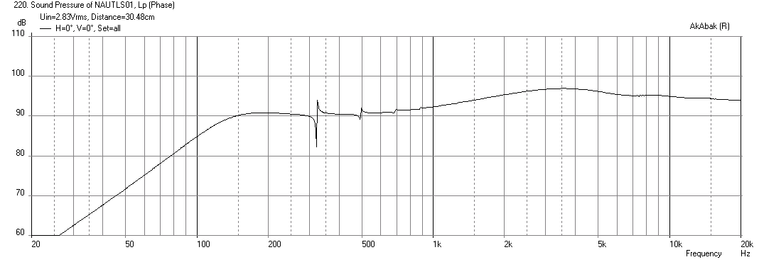

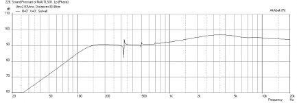

Here is a simplified model simulation of the Nautaloss without room reflections:
387262d1386876751-foam-core-board-speaker-enclosures-nautaloss-freq-12in-no-reflections.png

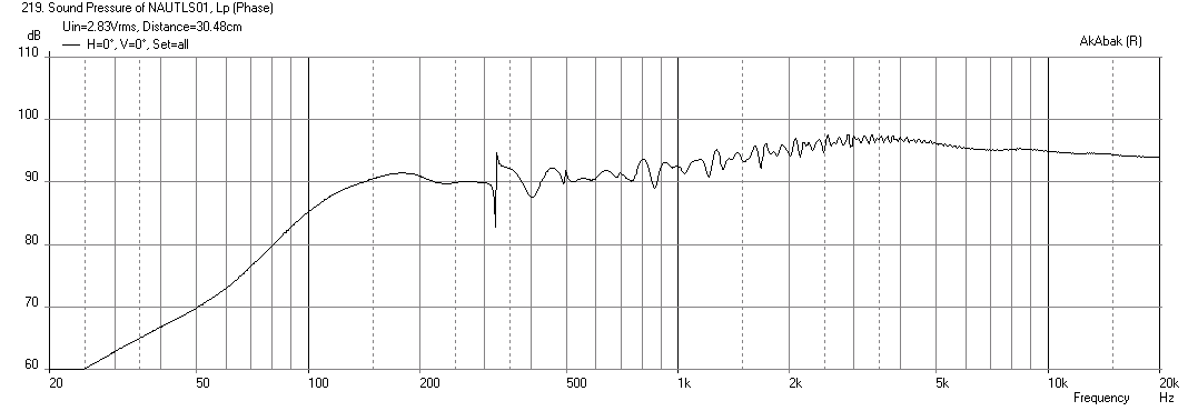

Here is the sim with reflections:
387263d1386876751-foam-core-board-speaker-enclosures-nautaloss-freq-12in-reflections.png
Here is the raw un-smoothed data for the response:
