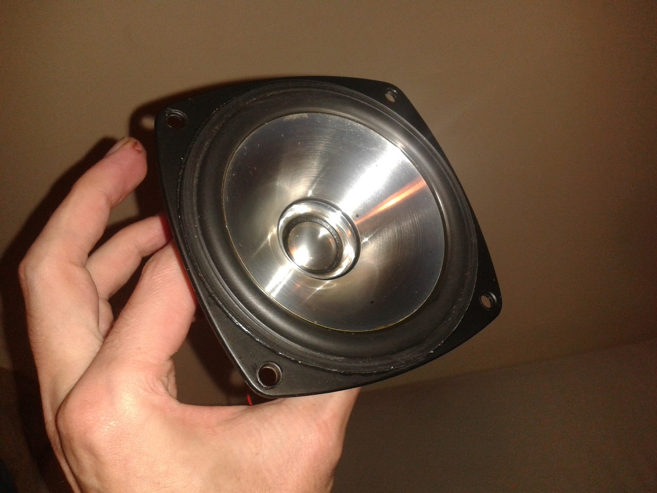

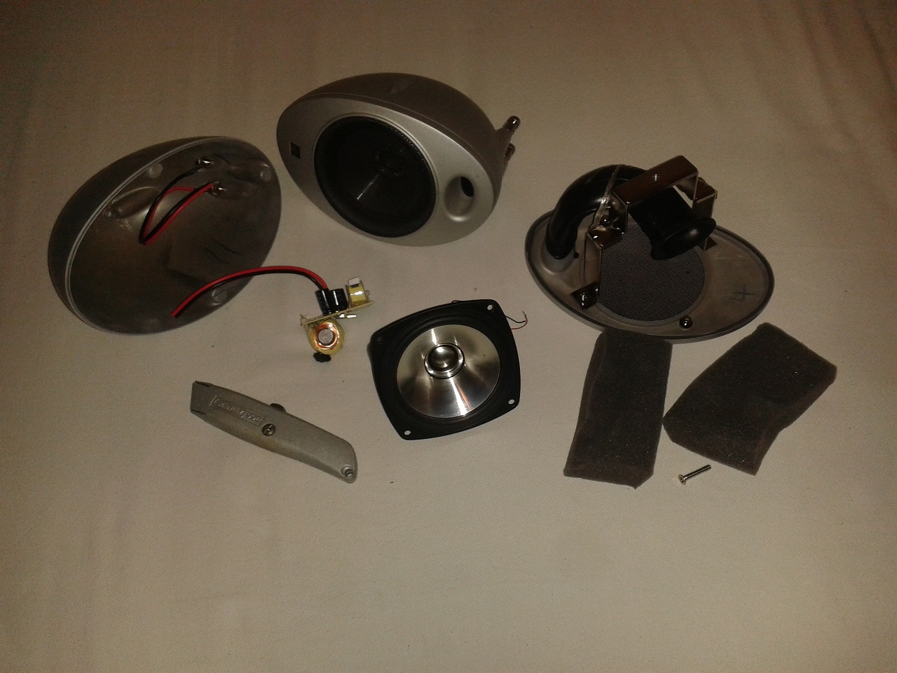

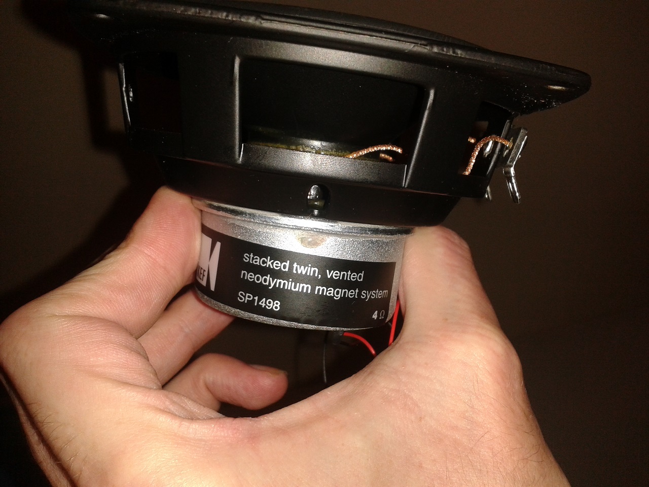

I think I have found a pair of drivers which I can use for some foam core enclosure experiments.
They are KEF Uni-Q SP1498 - 4 1/2inch with a 1/2inch tweet from the KTH2005 or 3005 Home Cinema system, AKA KEF Eggs.
I've looked for T/S parameters but so far drawn a blank.

Founder of XSA-Labs
Joined 2012
That is a nice looking coaxial driver - never seen a true dual magnet one that small. If you can get a measurement of the parameters with a woofer tester that would be great. Otherwise a sealed box (or Nautaloss) can always work as well as a Cornu as they are very flexible with the Qts used. Go with 24 to 27 in and 4 to 5 in deep should work in a Cornu.
Neither have I xrk, they are almost jewel like.
I read some where that the 'egg' enclosure is 1.5l. I did hook them up and have a listen, they sound quite nice (enclosure is a bit.... iffy).
I guess I could try asking KEF for the t/s parameters, cant harm to try, am not deep enough into speaker design to have a woofer tester.
My initial thought was your Nautaloss, second was a 'Micro' Tannoy Westminster Royal!
Common sense = Nautaloss.
