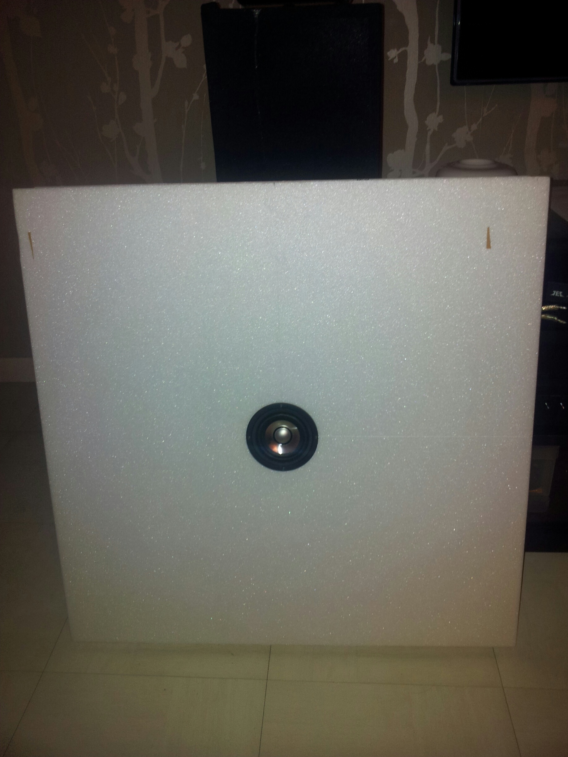

I just built my first cornu with Fountek FE85 100%depron.
What I can say....
Well....
It is not as good as my 2 ways speakers in the high frequencies.
Too much! definitely. I have to measure that...
Not sure it is well balanced.
But definitely there is hope...
Trumpets in Jazz music are definitely brillant.
The result is a very good surprise.
I have TC9FD on my way.
You might have to play with stuffing of the horn mouths near the exit to reduce the midbass while still letting the low bass come out. Good luck!
What material do you have in mind for that? Maybe it is one of my issues.
Christian.

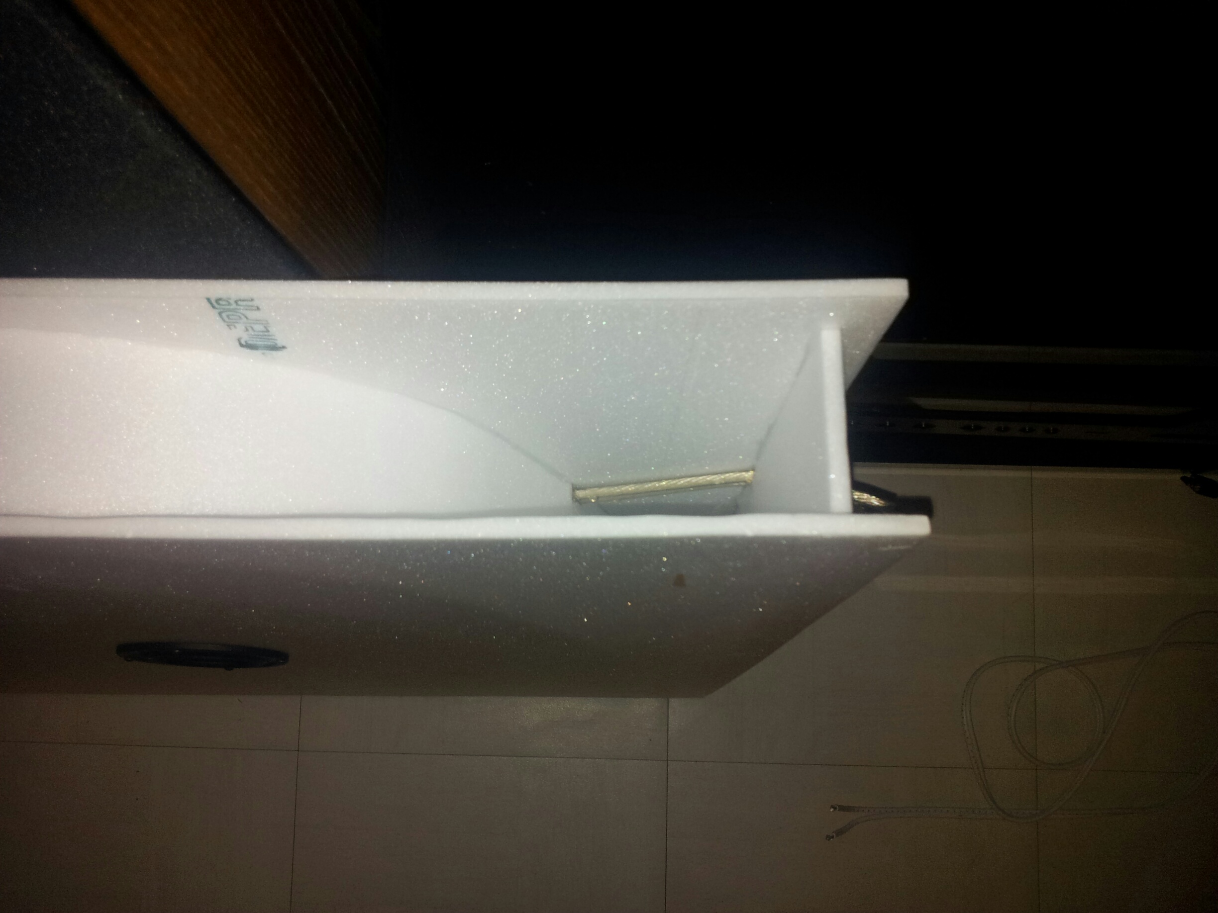

Here are the pics,
Yes, I think, there is too much high.
I have to measure.
Do you have an idea to reduce the highs?
Usually there is too much bass with Cornu. When you say too much high what approx range are you taking about? 1khz, 5khz, or 15khz? Cornu will have excess 200 to 400 Hz low mids until properly stuffed. Above 1khz can use a BSC like 1 mH and 6 to 10 ohm resistor in parallel.
The Depron looks beautiful by the way. Very clean looking - I wonder of the highs are the Depron radiating out the highs like a direct radiator? Try adding a sheet of cardboard with a hole cutout for the driver over the Depron. Does that reduce your "highs"?
Camelator,
My experience with TC9FD is that it does not need break-in, that may change the fs by 5 Hz over time but I have noticed that they measure very close to factory out of the box new in terms of Qts and Vas. It may be Depron is re-radiating too much mids and highs, or you have an air leak in the channels and it is not developing enough bass to balance out. How did you seal the channels to the last panel that was glued on?
I glued the first panel with glue gun.
The last one was glued with standard glue "pattex" and a lot of books on it. Don't know if I can find another one in Paris (don't know Gorilla glue here)
You are right, maybe there are air leaks. No way to know.
But I feel there are too much radiations as well.
So I think I will try a karlsonator or something like that with another material. I have to find it. Not easy in Paris, France. Don't know what to buy and where.
Definitely, there is hope for me with full range drivers, it is a good start.
But no good feeling with depron.
