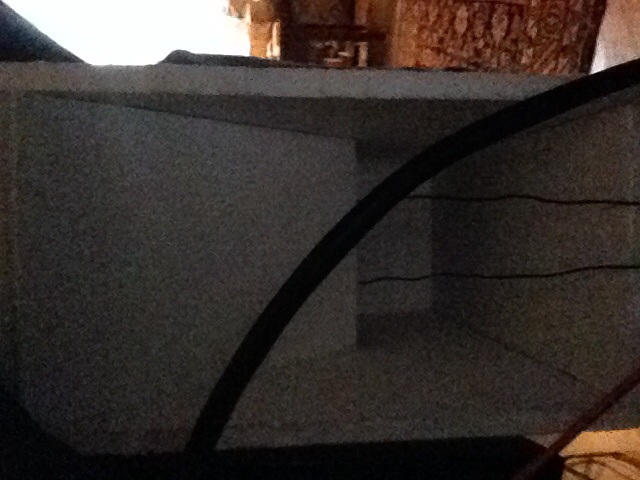

Look at the big speakers that are on the outside, these go down to <30hz. While what I hear is not nearly that low, I do know what bass will sound like. These little things are pretty satisfying.
I didn't see any impact on the screen.
I still don't know what the internal folds and geometry looks like but can imagine it sounds like a rear firing BLH. Funny how my first micro BLH was also made using a USPS box and tape. The path will probably be too short to have any bass lower than 100Hz is my guess.

That's what I thought too, but it does seem lower.
Well, before I sent the above message I plugged my iPad in and checked by ear, and it went down to 72 before it started falling off. And while I won't swear to it, it sounded pretty flat down from the 125hz preset I used to start.
Just imagine my box, closed on all sides. 12x12x6 internally. Now take the rear panel, and swing it in from the top, and fold the last quarter of it straight up in the center. That's exactly what I did on the cardboard box. If you swing it in at 45° the length would be 1.414*6 when it crossed the center based on good ol' Pythagorous. The angle I used was slightly greater than 45, so maybe more like 1.5*6 or 9", with 3" pointing up.

Maybe you can draw a sketch. Still don't get it. You have the rear panel folded in to form the mouth and just the one 25% section folded in again? That would give you a large rear chamber, a small constriction vent leading to the expansion mouth. It is sounding more like a BVR (big vent reflex than a BLH) which may explain why you are getting sub 100Hz output. Again a sketch would help. In the future don't forget to take photos of the build before buttoning it all up.
If the back is open, then sort of. It is much narrower, and then square sides. Also, the diagonal internal baffle, where it bends slightly in the diagram, is bent straight up in mine. And no stuffing at all, although I was going to play with that at some point.
My daughter is probably going to take them from me, so I'll be finishing up the second one in foamcore in the next few days and I'll take an open side pic. I may have to buy a second set of FE126's, but I guess the newer EN version.

Now that I see the inside of your speaker box, it is not a horn - maybe a very short TL. The longest path is less than 18in x 2 due to the expanding mouth. I am guessing it probably has an fb of 125Hz at best. It is probably close to a semi open baffle. You can get a lot more deeper bass if you made a longer maze like TL that slowly contracts.

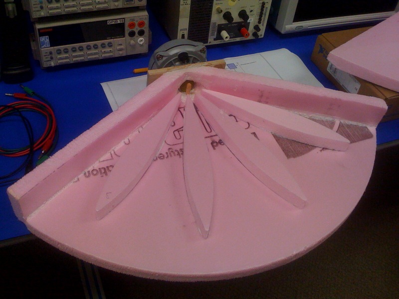

Plus, from what I've read you can make the length of the horn quite a bit shorter as the 'conical' part becomes the paraline, which may only be 1.5" thick.
Have a look at post #600 in the Square Pegs thread, from cookiemonster77...it certainly gave me food for thought...
It is a type of acoustic lens for a compression driver made by stacking plates.
