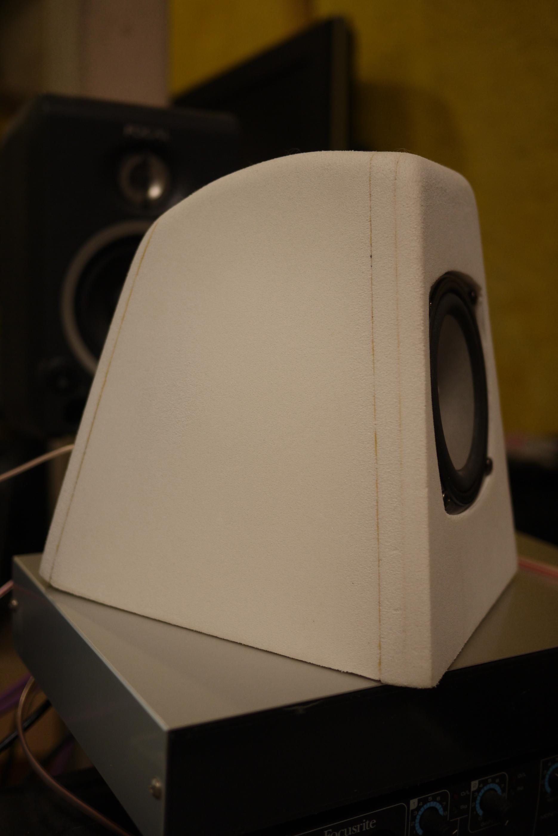

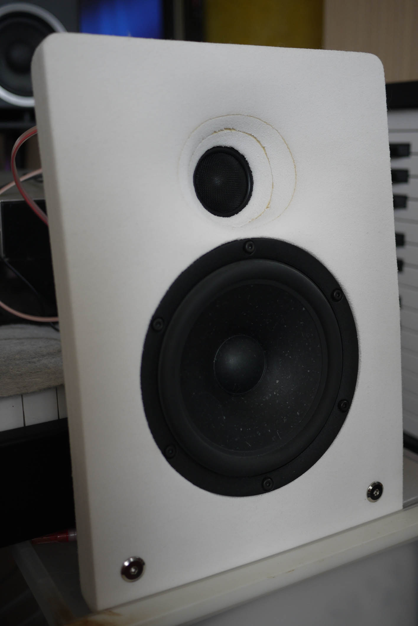

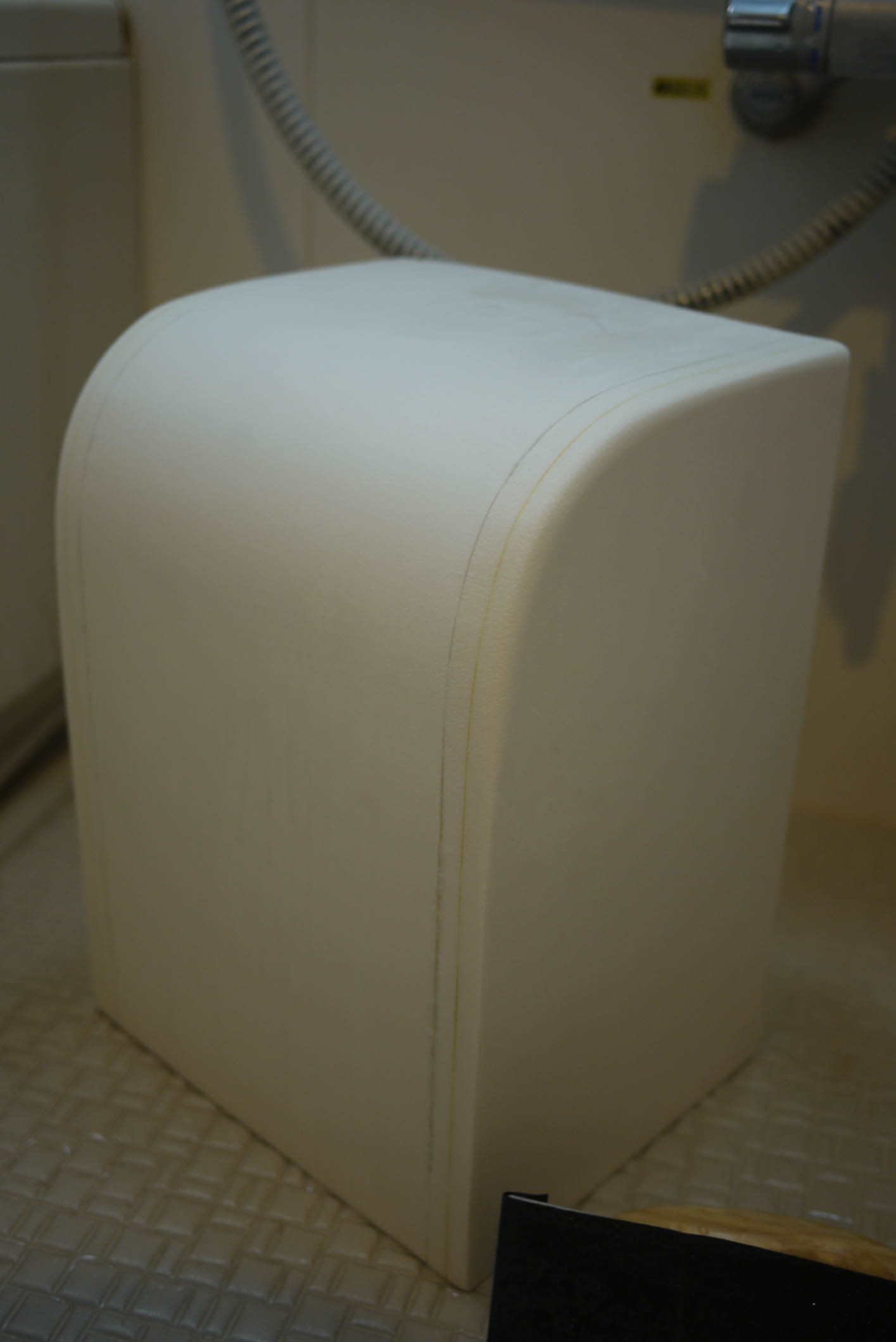

But in the end I am enjoying working with the EVA foam, it is an excellent material for enclosures, easy to work with, able to be sculpted, can be painted, and in the end imparts very little (to none) sound signature. As a DIY material is it really about perfect. Plus I like the white look.
![505593d1442979037-eva-foam-performance-speaker-enclosures-p1110524.jpg](https://www.diyaudio.com/forums/attachments/full-range/505593d1442979037-eva-foam-performance-speaker-enclosures-p1110524.jpg)
![506364d1443397110-eva-foam-performance-speaker-enclosures-p1110593.jpg](https://www.diyaudio.com/forums/attachments/full-range/506364d1443397110-eva-foam-performance-speaker-enclosures-p1110593.jpg)
![505077d1442736349-eva-foam-performance-speaker-enclosures-p1110518.jpg](https://www.diyaudio.com/forums/attachments/full-range/505077d1442736349-eva-foam-performance-speaker-enclosures-p1110518.jpg)
![494874d1437507291-eva-foam-performance-speaker-enclosures-p1110213.jpg](https://www.diyaudio.com/forums/attachments/full-range/494874d1437507291-eva-foam-performance-speaker-enclosures-p1110213.jpg)

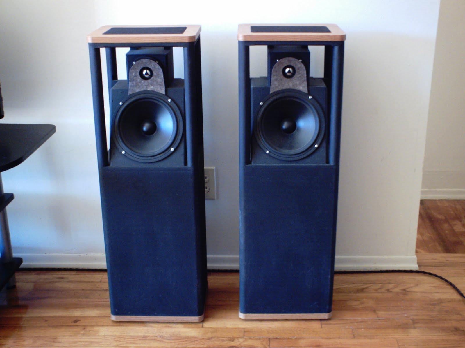

EddieT, not sure I understand your question. Which "Steens" do you mean? The mainstay speakers have cloth that is simply a cosmetic treatment. The speakers are in boxes (a bit different from usual square boxes), then there are 4 posts around the boxes around which the cloth is wrapped. It differs with different models though. The construction can be seen here: http://www.soundandvision.com/images/styles/600_wide/public/correct2cebhr-1.jpg?itok=M1DO0wh4. For the 1C, there does appear to be some felt on the baffle of the tweeter box behind the tweeter (http://4.bp.blogspot.com/-4pYwB0ObbKY/TlY-VJUd7JI/AAAAAAAANKI/iWsRog0_nH8/s1600/Vandersteen+1c.JPG), but I've never seen a good image of it. I own the 1c and it is a very nice speaker (but I'm not up to removing the integrated cloth surround.

It actually does both: serve an acoustical purpose and economical. Vandeersteen designs his speakers first around sound. So this means he uses multiple enclosures for each driver, felt fronts for baffle diffraction, time aligned. The vandersteen model 2e entered production in 1977 so he may have been one of the first to use separate small enclosures for each driver and step them to get time alignment. The B&W 801 came after in 1979. Now it is really common. I had a friend in university who had the Model 1 and they sounded excellent and I almost bought a pair. The cloth sock is to cover up this rather raw look (unpainted rough non-reflective MDF, exposed felt covers, stepped boxes) and to create a transparent cover to not interfere with the sound.
You can see the felt front cover and how the sock works better in the model5
