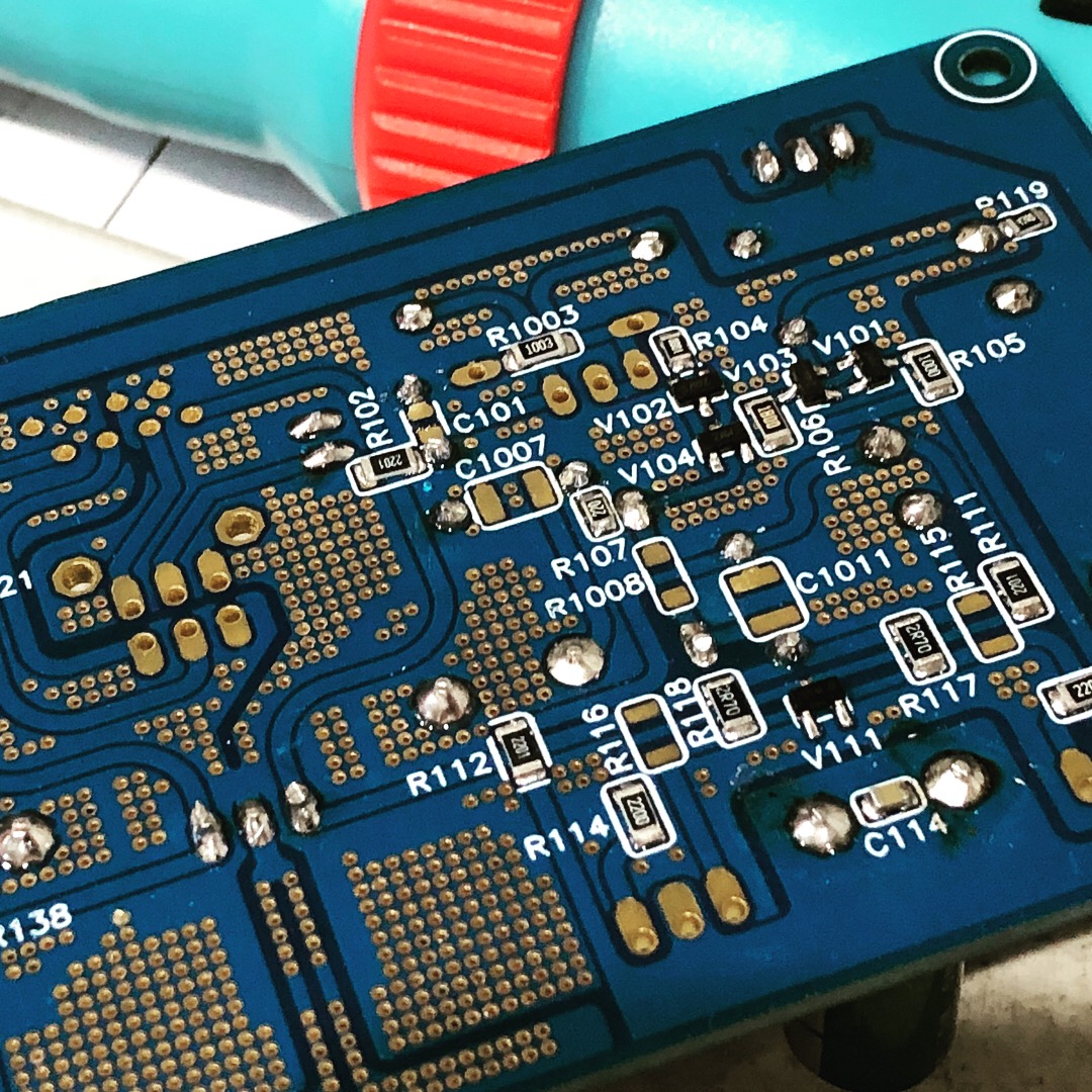

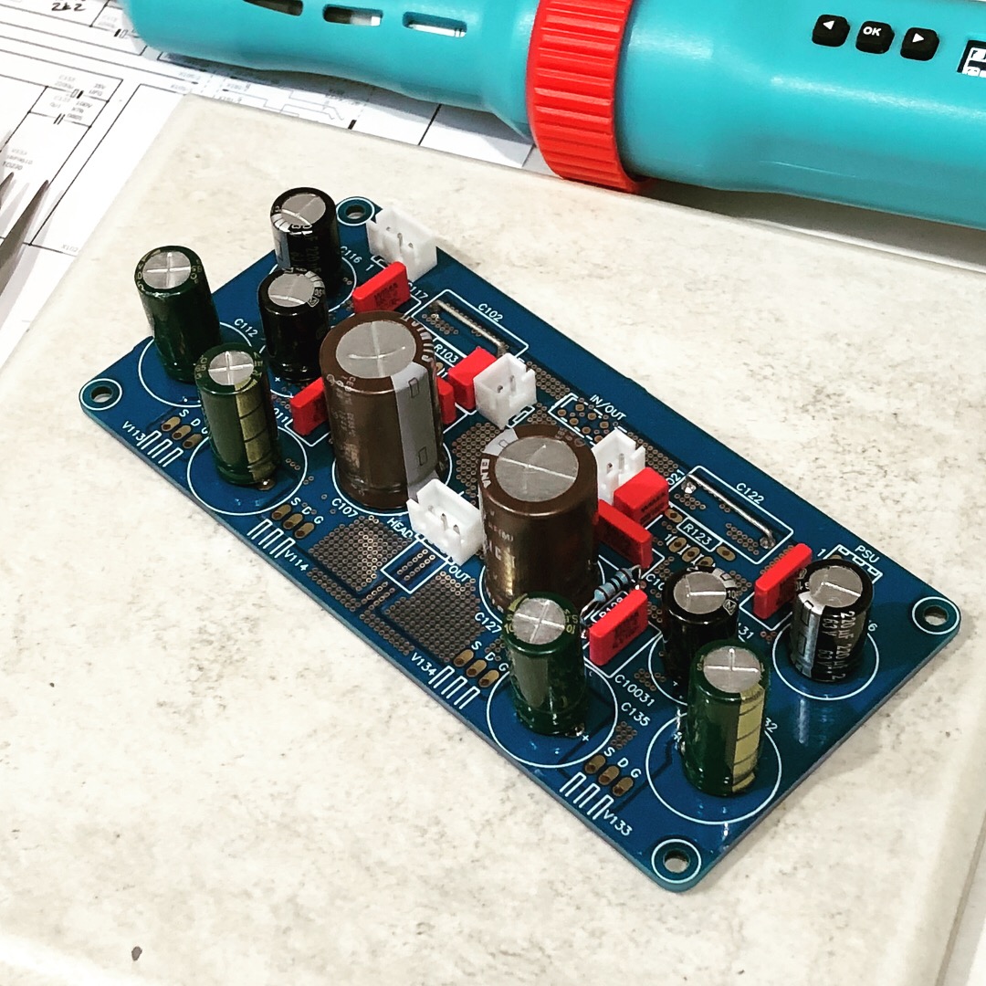

Thanks, Linuxguru. Basement is now dry and drywall repairs and carpet replacement to begin soon. My electronics lab is back up and made my first new amplifier since the flood last night.
So the audio lab is about half way back now.
