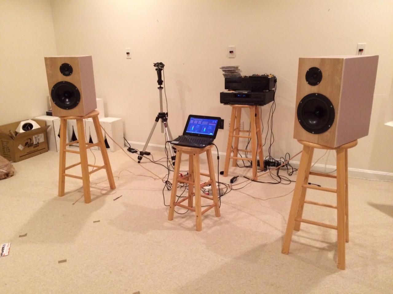

I have plenty of both, but working on the dining table the bottles were definitely closer!
(Most of the enclosures are all hot glue, but I ran out on the very last panel for that centre speaker and had to switch to PVA - and I had a bad panel gap from a sloppy cut, thus the clamp on the corner. Fortunately foam will bend to conform!)

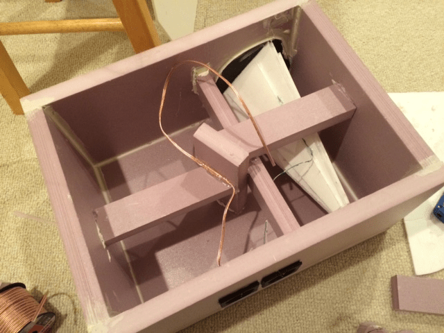

Thanks Jim,
Good to know - I can imagine that it is slow since it is not porous. Liquid Nails (non VOC) works well too. The box I made for my 10F/RS225 speaker is still standing and solid. I used a 3/16in thick subfloor plywood on the baffle face to allow the wood screws to hang the heavy 8in woofer. That was also bonded to the XPS with Liquid Nails (non VOC). The XPS box measures better (slightly lower THD) than the same box made out of 3/4in BB plywood. Important to use non VOC glued since solvents and their vapors will melt the foam.
And, I'd like to try using XPS for something larger, say floorstanding single-fold tapered TL/horn 60L internal 20x116x26 (2cm boards) -- which size I had stayed away from due to mass/cost/difficulty. I assume it would have to be well-braced and weighed down with (removable) bricks, and the upper baffle "composited" with 1cm plywood for attaching (relatively light) drivers. Does this make any sense?

I was contemplating "facing" the XPS with Cu or Al self-adhesive foil/tape to increase stiffness but then thought of a problem: very different coefficients of expansion. Use thin plywood instead, but that is susceptible to moisture/humidity-induced instability unless very well coated. I think vinyl veneer will likely creep or bubble up as well (25C and 100% humidity summer-winter differentials here). Hmm.

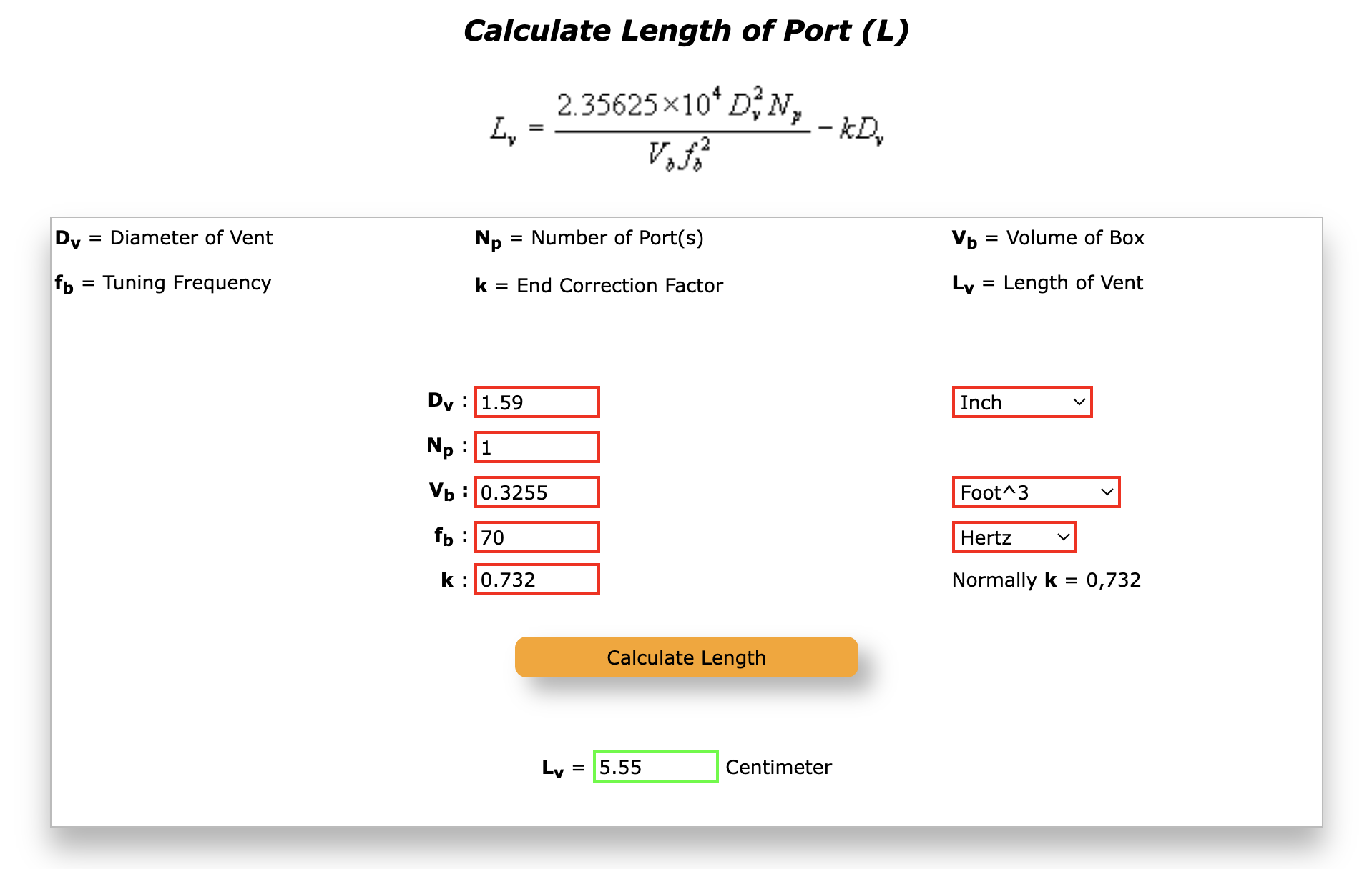

I had a quick go with an online port calculator (http://www.mh-audio.nl/Calculators/WVC.html):Yes, maybe even thinner if you like. Play with volume and bass reflex calculator to optimize volume for the tuning frequency.
@xrk971 - I assumed the same Schedule 40 PVC pipe that you'd used in your original design, and so with the 2.5 inch thick enclosure it looks like we have a 5.55cm long port. Given the box is thinner than the original, a longer port makes sense to me, but am I correct in that thinking?
The box resonant frequency goes down with volume and vent length. The box volume should be matched to driver Vas if possible. Usually ~2x Vas is good but it’s ok to be larger - then vent length needs to be shorter. If box volume approaches Vas or smaller than Vas then you need a sealed box for best results.
You can make a pretty small reflex speaker with a 0.04 cu ft Vas driver. That’s 1.1L Vas so about. 2.2L (milk carton size) cabinet makes a nice speaker that reaches down to fs of driver easily. With AMTL you can go deeper. So the volume can be bigger, but if smaller that 1.1L then probably not good to make it a reflex box.
