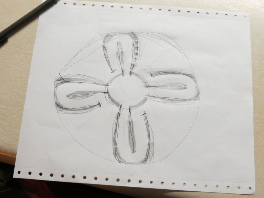

Show us please. Mine from moons ago is not a spiral but of course it *uck shaped. I am not near that drawing but will share when I can so you can tell me how wrong I am. It starts as a 4' round ply and doesn't need foam board as it's more of a TL opening to a straight sided horn. Maybe I will try a quick sketch. This is dependant on when my wife gets home and I have to be the man about the house again.

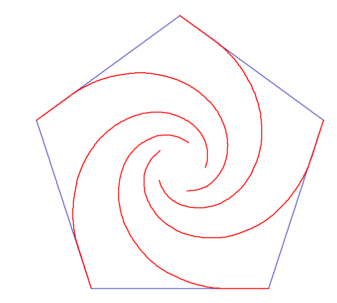

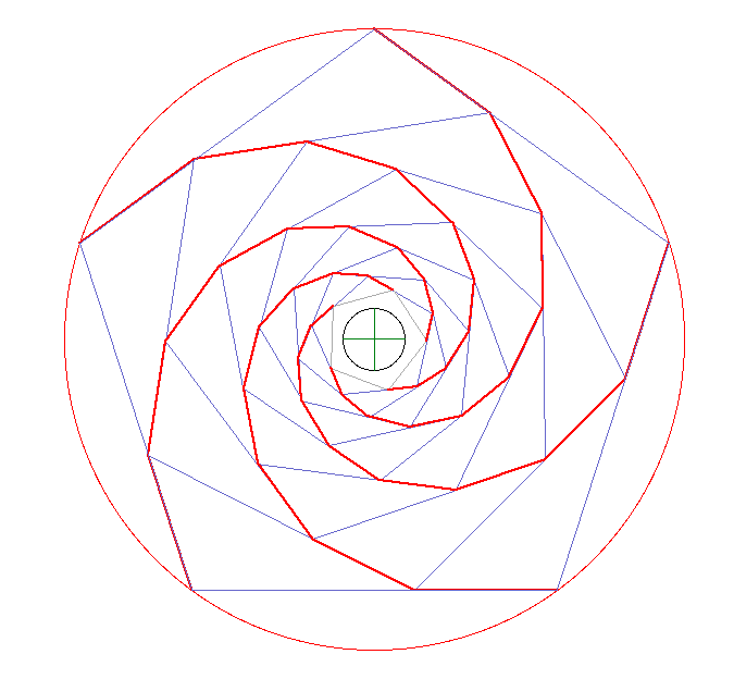

Anyone want to go at this one? Only one horn length, could be a pentagon, or a circle. Mouth needs some detailing

What size drivers are those meant for Dave?

What is the path length, and is this a Fibonacci expansion rate? It doesn't look fast enough, that is, expansion at 1:1:2:3:5:8:13.
It's a sketch on my notebook, I still have to enlarge to full scale and will show you after it is cleaned up. It is similar to regular Cornu but with round overall profile which makes horn mouths have different exit angle.

Dave, that's not fair. You know I make a great Guinea pig, especially the Pentagon. Let me digest it.
