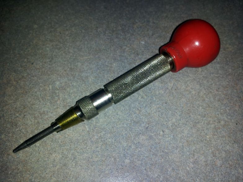

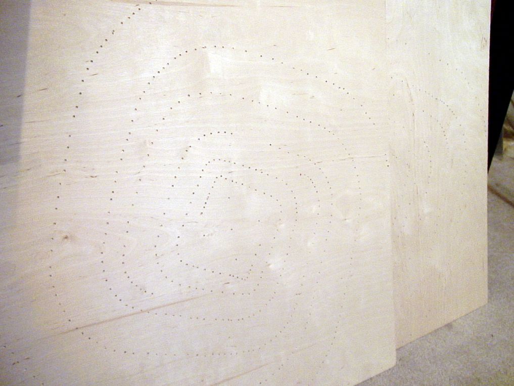

Whew!! Finally go some actual progress. I gave up the ghost and just bought two 2' x 4' x 1/4" birch plywood. Much better than working with the curvy old stuff. I used a spring loaded center punch relaxed to its weakest setting and had both panels done in 20 minutes.

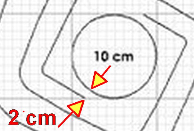

Strip depth or channel height depends on driver Sd. Which driver were you using again?
The Vifa TC9FD-18-08.
The 4.5 in was for the 70 cm size with Fostex FF125wk. Vifa is smaller, measure your throat width that you just drew with the punch. That width x channel height x 2 needs to approximately equal Sd for Vifa tc9fd which Is 36.3 cm square, if I recall correctly.
I just checked my old 20 in cornu plan. It was hand drawn by me and I made mods as I went along so it does not follow the plan of Planet10's pdf layout if scaled to 20 in. My throat widths were custom adjusted to 1.2 in wide. Thus my channel depth is 2.34 in ( I picked 2 and 3/8 for convenience). If you scale your pdf drawing down to 24 in, the throat, I believe will only be 0.6 and this means depth needs to be 4.7 in. This may be reason others who built the 20 incher using the pdf scaled will have too small of a throat?
Throat = 2 cm x 2 = 4 cm
4 x 9 = 36 = 3.52" width.
Correct?
No, the circle has nothing to do with it. That is cutout hole. The gap is from innermost channel edge to next adjacent channel wall.
