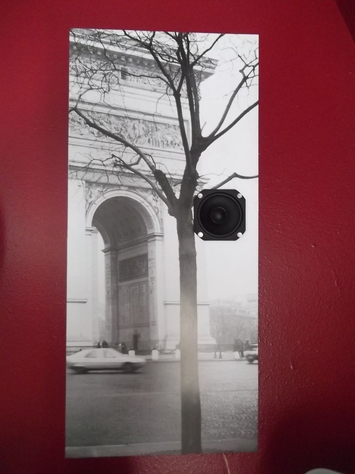

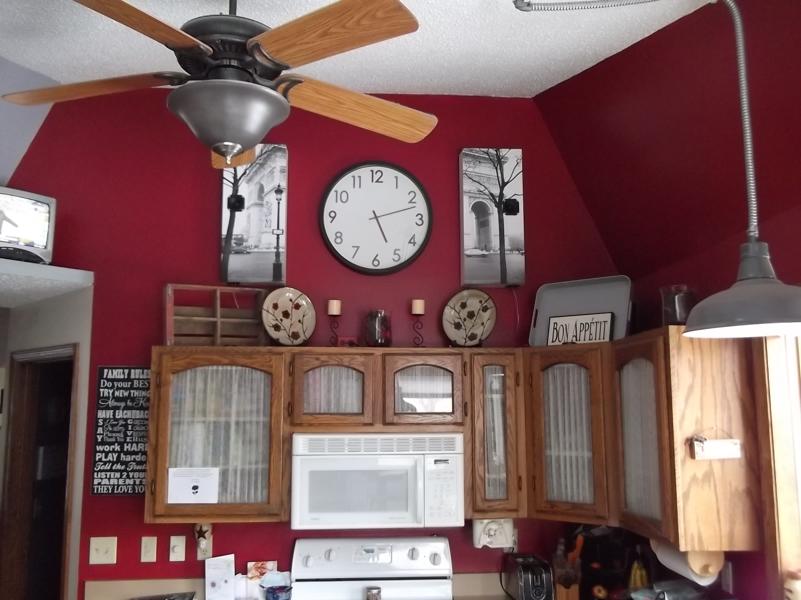

I have to give many thanks to XRK971 for some of his foamcore box designs.
I used his Vifa FIB enclosure for fun set of speakers for the kitchen. The Mrs. highly approved when I came up with putting a print on the front. Found a 36"x24" print and split it down the middle and then cropped the top and bottom to fit.
I am amazed how they sound! Great low's for a 3" and they blend in so nicely. I laugh when the friends walk in with a confused look on their face wondering where all that sound is coming from.
Thanks again X

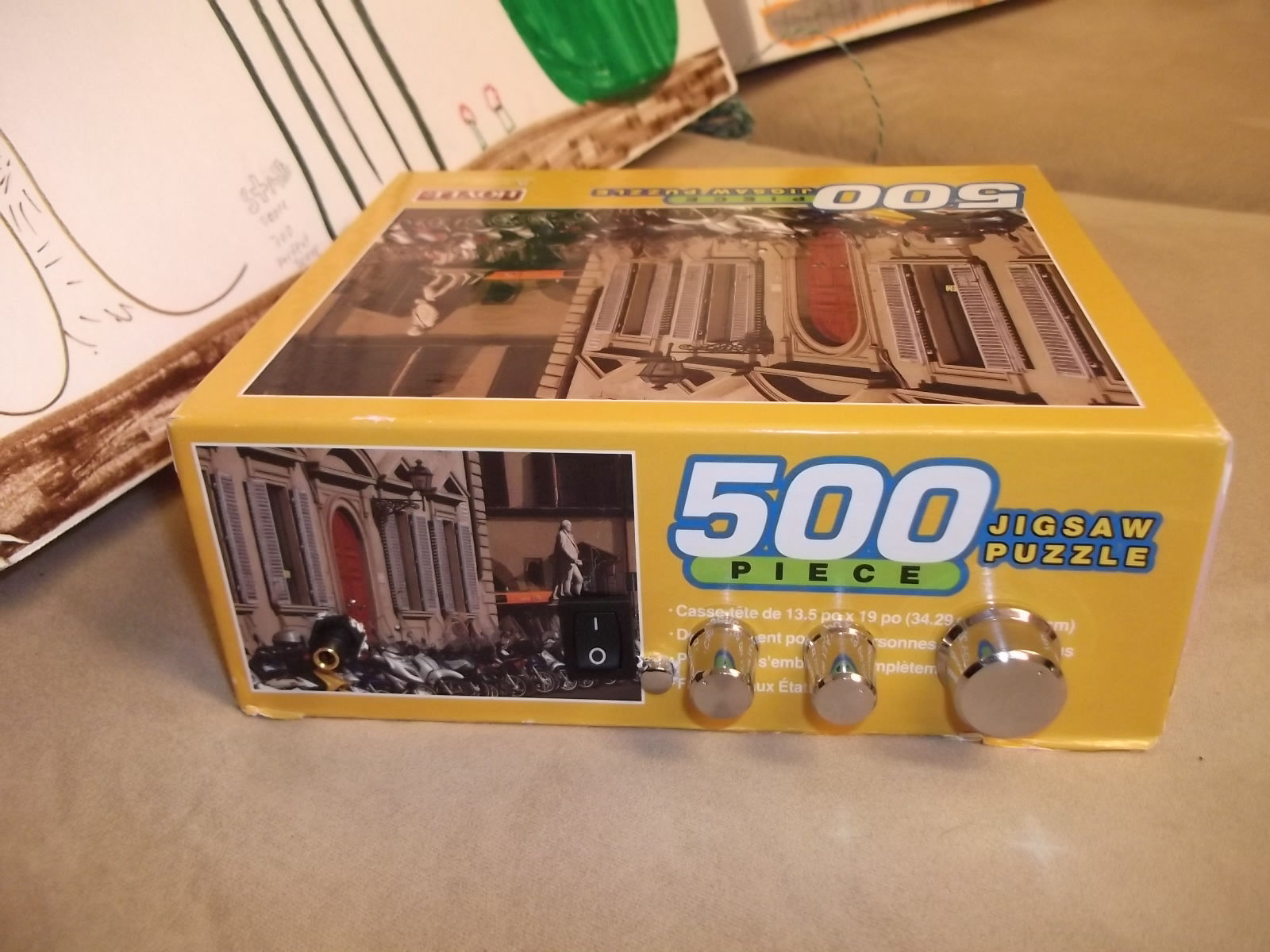

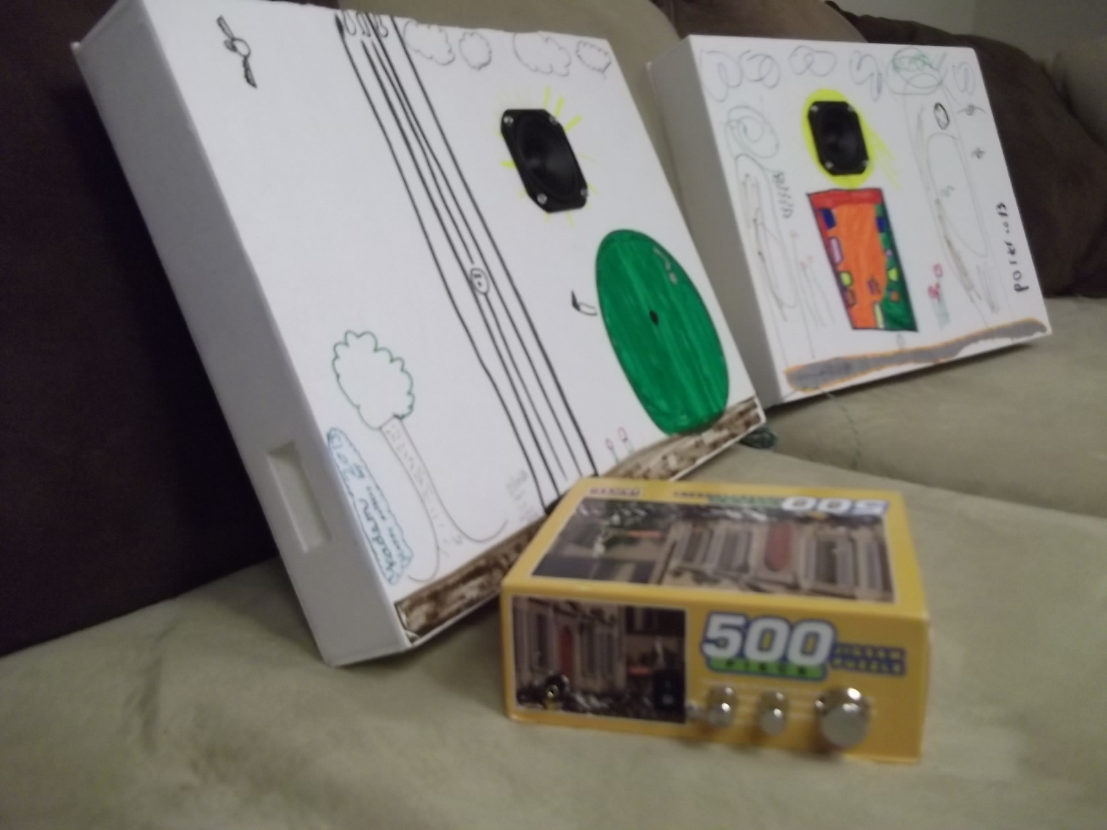

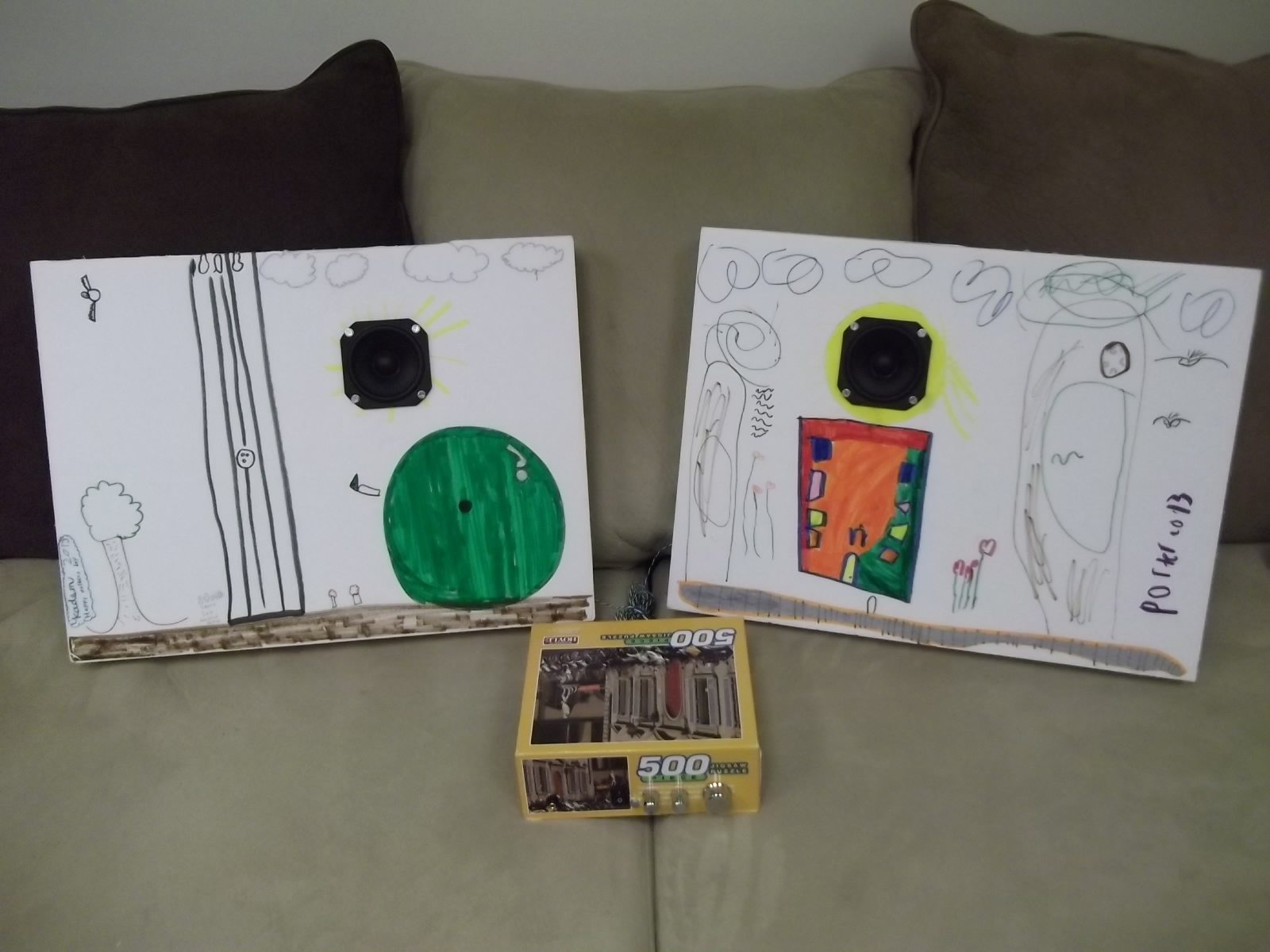

I also used his 30"x20" mltl design by split it in 2. Same speaker for the set up and then I let the boys each bust out the markers for some 7 and 10 year old artwork.
It's gift for my mother for her new arts and crafts room back home. They also sound great. The imaging of the little speakers is so nice.
I hooked them up to a lepai 2020 but couldn't give it to ma stock, so I disguised it in an old puzzle box. Now it will blend right in on her art shelves.
Kudos to X! Fun boxes to build and I didn't even have to start the furnace in the garage.
