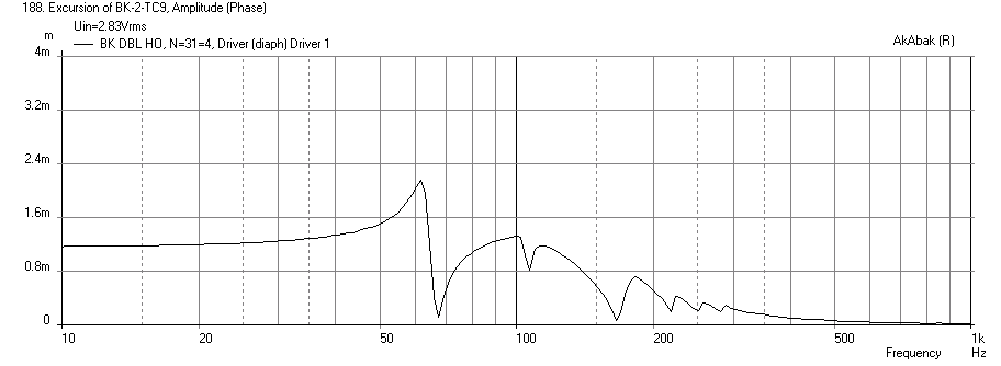

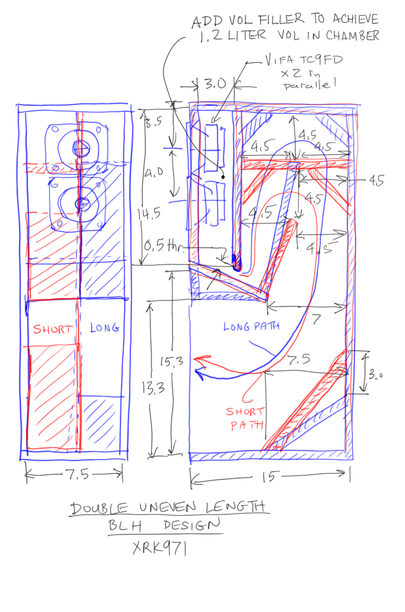

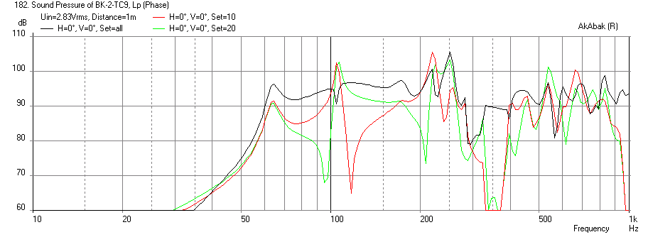

Double Uneven Length Rear Firing BLH with dual Vifa's
It is quite surprising that the Vifa TC9FD, with its rather high Qts of 0.89 can be made to work well in a BLH with dual uneven length rear firing horns. The simulation in AkAbak shows that this design can achieve modest bass down to about 60 Hz in the 92 dB range using dual drivers wired in parallel. The uneven length horns allow the big hole that was previously at 200 Hz to get filled in. The response, once smoothed with a bit of stuffing in the driver chamber will give a very 'full' bass feeling as there is good coverage all the way up to 300 Hz. So a set of 3.5 inch 2x$12=$24 drivers in this double horn cabinet can actually produce a response that almost rivals a $48 FE126EN with smoother coverage over the 200 Hz range, no shoutiness peak at 7 kHz that the Fostex is known for, and giving up a little bit of bass extension which is to be expected when using a dual horn cabinet without really changing the overall length of the horn substantially.

Sketch of Double Uneaqual Length BLH
This is a sketch of the type of design mod that is required to implement a double uneven length horn. Although not shown, the sims above are for this geometry but somehow with the mouths exiting on the back.

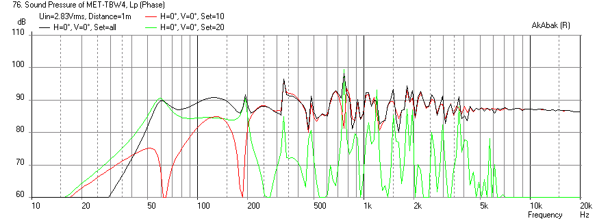

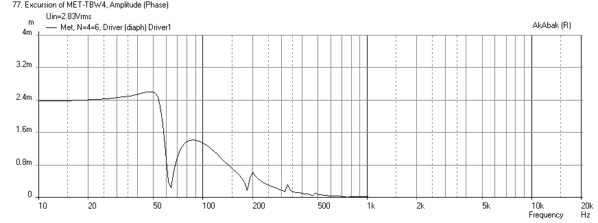

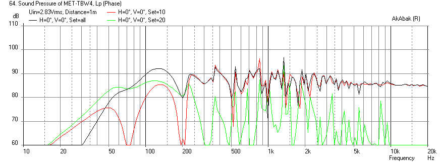

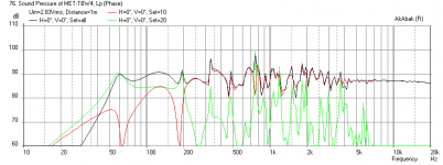

Founder of XSA-Labs
Joined 2012

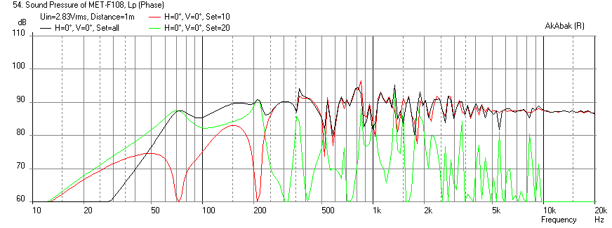

Prez,
I just built a simulation of the Met on AkAbak to see what the W4-1320SIF might look like. You can't use the FE126EN cabinet - the T/S params are similar but don't translate - probably due to big difference in Qms. Anyhow, below is my sim of the Met with the FE126En (first plot)- not bad. Then I stuck the W4-1320SIF in and not good (second plot). I went and tweaked the cabinet to make it larger and changed the porting to get something reasonable (third plot), with cone displacement (4th plot). So I would be careful in building the Met cabinet as it. The modified cabinet that I have is as follows (in inches multiplied by meters/inch):
Code:
Width_top = (3.00 * 0.0254);
Depth_top = (1.00 * 0.0254);
Height = (45.0 * 0.0254);
Width_bot = (11.0 * 0.0254);
Depth_bot = (7.00 * 0.0254);
Leg_Height = (2.0 * 0.0254);
Driver_pos = (18.0 * 0.0254);   | Distance from top
| Port depth and length
Port_len = (3.5 * 0.0254);
Port_dia = (3.0 * 0.0254);
Sims with speaker placed 4 ft from back wall 1 watt at 1 meter. I added a little BSC circuit of 3 ohms and 1.2 mH.

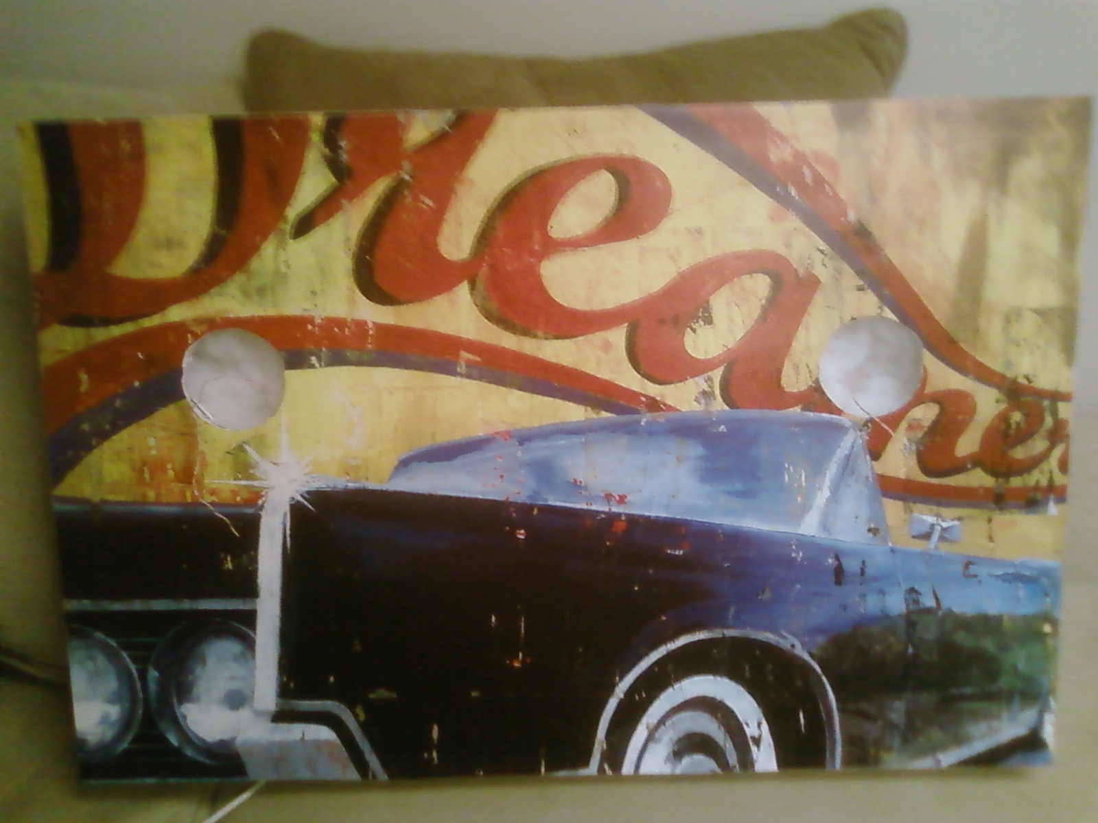

Thanks to X!
Another big thanks goes out to X.
Just completed one of his wall mounted designs Using the every popular Vifa 3". The slim wall mount MLTL using a full sheet of 30x20 foamcore for the front and rear baffles.
It's a proven design because I built a split set for my mother and my uncle liked them so much I built him the original plan and covered it with a car print. It's going in his office at his car lot.
Just waiting on the drivers that should be here tomorrow.
Thanks again X
Founder of XSA-Labs
Joined 2012
Ryan,
That does not look anything like a speaker! Very nice print for a car shop. I am actually listening to mine right now and they sound fantastic. I have them mounted behind my desk so I switched left/right. This was one of the first FC speakers I ever built. It originally was based on a larger straight duct TL. That sounded OK, but I wanted more bass and when I slapped on the constrictor ports - they became MLTL's and it improved the sound 200%. I am glad you like them - I hope your uncle does too - nice one of a kind present that doesn't cost much but brings big smiles. :)
