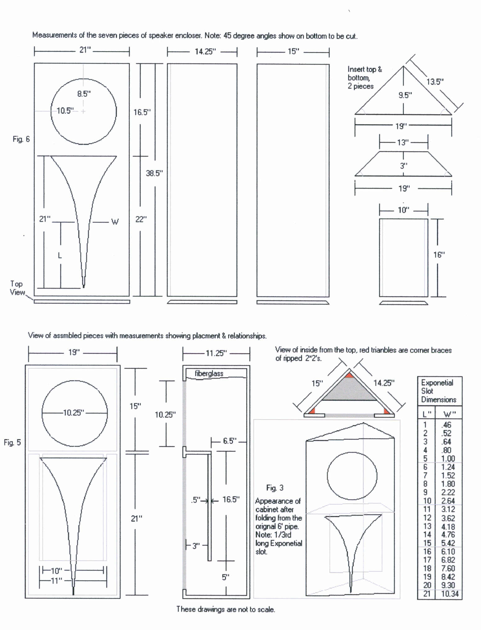

$2.00 Baffle
Attached is a PDF of the $2.00 Weem's baffle. It was a simple yet effective corner enclosure using the acoustic labyrinth principle. I have many of his projects in PDF format gleaned from Popular Electronics and other publication. David Weems is still with us, but at 91 he no longer builds speakers. He called me last week to announce that he has auctioned off all his old drivers and test equipment to benefit the Civil War battlefield park in his home town of Newtonia, MO. You can read a bio on him I did in the October 2009 issue of Audio Xpress.
Possible to get a copy of the plans??
Not sure.........They're in a Flickr photo album, 'Weems Celotex TL', but Flickr has been 'improved' and at a glance don't see how to post them to the general public other than what's up in the address bar: Weems Celotex TL - a set on Flickr
Clicking on the thumbnails to blow them up still doesn't give me a link other than in the address bar, so give it a try and let me know.........

The Karlson slot loaded TL is Norman Fuller's realization of the attached patent. It sims plenty good enough using current generic M.I. or '50s era 15" driver specs.
