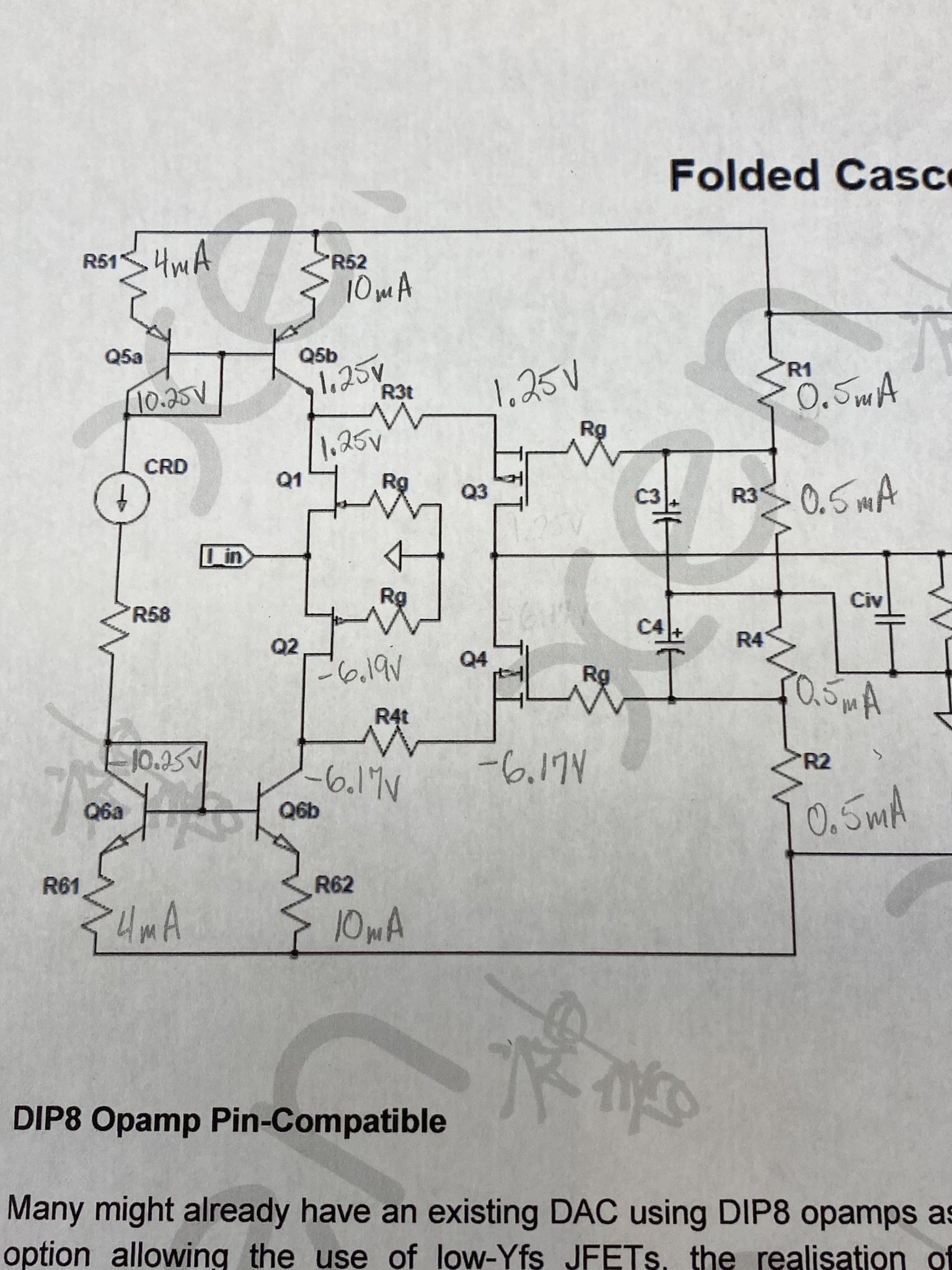

I made notations on the schematic with additional measurements. The voltage readings at Q5b collector, Q1 drain and Q3 source starts at 6.5V then after 2 minutes settles to 1.25V. Seems to be an issue here 🤔.

I already told you earlier that you have too little current through the current mirror.
Your Q1,2 have Idss 10.5mA, so R52,62 should have at least 13.5mA bias.
You can do so by increasing R51,61 etc, to 2.4k or 2.7k.
Exact value you will have to try in circuit.
Patrick
Some additional Info :
The CRD E452 from Semitec has a nominal current of 4.5mA, but is specified at 3.9mA~5.1mA.
The current mirror formed by Q5,6 has a current gain of 2.44x.
That means the bias of R5b,6b is 9.5mA minimum, and 12.4mA max.
This current feeds both Q1,2 and Q3,4.
For the circuit to work well, the bias current through Q3,4 needs to be at least 1.5mA, ideally > 3mA.
That means the values in the BoM will be fine with Q1,2 Idss of 6~8mA, as those available in the DIYA store.
If you want to use high Idss JFETs (8~11mA from DIYA store), the simplest change to make is to change the CRD to E562.
IMHO high Idss in this position has no real performance advantage except for increased dissipation.
It is also wise to measure the CRD current with 12V supply before soldering, just to check what bias current you are getting.
Patrick

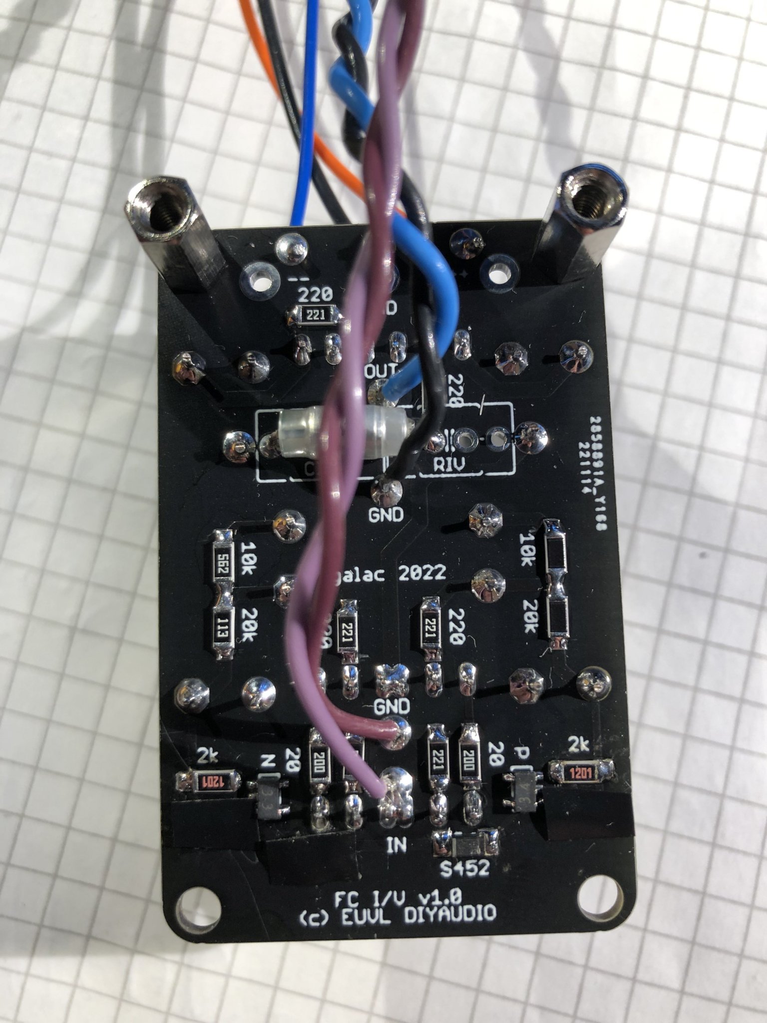

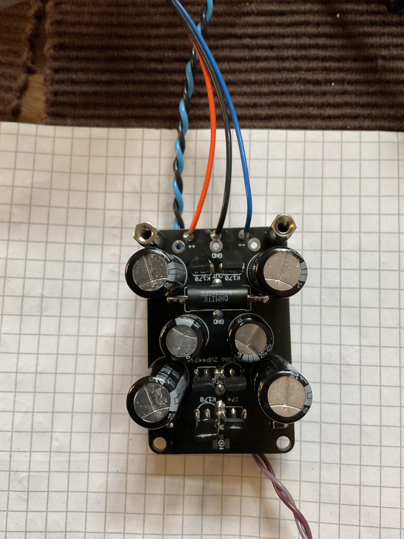

As blue pcb's are not my favorite I made my own (and black) boards. Also changed the CM-BJT to HN4A51/HN4C51 which are leftovers from the CM-build. The rest are footprint changes.
Initally I struggled a bit to get the CRD-tail working with the toshibas. I've ended up with 470|1.2K - quite a difference to the BC5xx. Results looks quite ok now.
Q3/4 to GND ~7,2V
Q3/4 ~3,8mA
R58 4,36mA
"Gain" 1 (2.5k hot in - 2.5k Riv), Waveform looks clean
DC offset wandering ~ +/-1mV
@Patrick - thanks for another great diy circuit.
p.s. I've masked the parts/values that haven't been spoilered by Patrick

Yes, resitors are 1206 thin film - but not the collector resistors of the bjt's. Didn't have the values at hand so I had to switch temporary to thick films. Thins are 250mW, Thicks are 660mW.
Quick Test with board not fully warmed up:
1,2k 22,9mW (5,2V, 4,4mA)
470 57mW (5,2V, 11mA)
Q5a 2,9mW (0,65V, 4,4mA)
Q5b 27mW (2,45V, 11mA)
~30mW per BJT (300mW max.) - should be ok.
Can't measure temp of the bjt's but way under 55° - maybe 30° Case at ~18° Room.
Each dual BJT will see ~20mA at 7V, i.e. 140mW.
They are rated at 300mW at 150°C absolute maximum.
I never use them more than 50mW.
It is for good reason that TO92 devices are chosen.
Case temperature (which you can measure) is not the same as junction temperature (which matters).
Patrick
