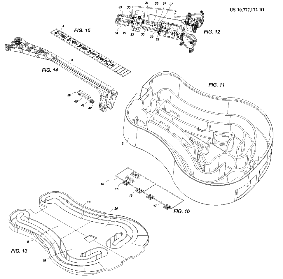

Hello all - I am new to this site, looks really great! I was granted a 20 year Utility Patent last year for my Folded Horn Acoustic Guitar. Patent # 10,777,172, can find on Google Patents of course. I have two five foot long folded horns inside an acoustic guitar. The horn is exponential and has a 1:8 ratio from throat to horn, with a speaker mounted to each compression chamber. This is long enough to capture the lowest frequency on an acoustic guitar at 1/4 wavelength. The true acoustic sound is a captured by a mic, not a pickup. Check it out and let me know what you think. CNC programming is complete, and will build a partial proto next week. Thanks!

Yes, a mike, speakers, and two horns. Not PA horns, the mouths are quite small. More like saxophone horns; and nobody thinks a sax is too soft. The internal shape is quite complicated and needs much staring at diagrams or a 3-D model. (Huh, with CAD and 3D Printing we could make plastic hand-size models at home for study.) The amplifier is projected to run on small batteries. There are a whole bevy of other changes (modified frets, stringing, neck attach, compliance) indicating Joseph has done much thinking.
Will it play? Sure looks like it. Will it compete with traditional acoustic guitars? It can take years even decades for one form to take over from another. The current "classical" is pushing 200 years old; and yet the Nylon Strings came in with a rush because all Nylon went to stockings and war production (Nylon Riots) until 1952. Guitarists switched-over in less than 20 years. Historically most acoustic instrument evolution is much slower.

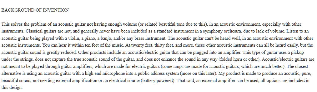

The patent is notably well written. Much of it is a re-cap of the guitar's weaknesses and a teaching of new fabrication technology for complex but natural shapes. None of that is the actual patent, what matters is the "I Claim"s. Many patent writers get super-specific. Which means anybody can do it a little different and deny infringement. I was pleased to see that, while the drawings show two horns, which IMHO should be "one or a plurality of horns" to capture all variants, and the teaching cites specific electronic products, the I Claims don't specify this ormost other details. Making the patent quite broad. (Always remembering that the guy with the bigger lawyer can just take the patent in trade for an infinite squabble in court.)
If it is truly better and takes over the world, that is a blessing for all. But if sales are tiny until 2039, Joseph gets little to no compensation for his effort. The telephone, the electric car, the vacuum tube, burbled in small sales for most of their patent periods.

Wow, what a great take on this! I find it difficult to argue with anything you say, and I like to argue! Right now this is an idea, build to follow. Will it be perfect, hell no! I will listen (the only true test of music) and change as needed. Anybody who thinks they will hit a home run on their first iteration is either a fool, or too young to know just yet. We have all been there. Do I want to make some money, sure. Truth be told, I have some and really want to see how I can invent something that musicians would love to play, and people would love to hear. Thank you so much, I really appreciate your opinion! The Great Benjamin Franklin said "our critics are our friends, for they show us our faults". I add: and they help us improve. More opinions needed and welcome!!

Hello again dreamth. While I did use the classical guitar as an example in my patent, it was just to make a point, that guitars are not as loud as most other instruments. This is a steel string acoustic guitar, not a nylon string classical guitar. It is not meant to be used in a symphony orchestra. It is meant to used to play blues, rock and roll, country, bluegrass, folk, ballads...that said maybe a classical guitar experiment is needed, who knows if it will work? I saw the Chicago Symphony Orchestra when Sir George Solti was conducting, it was wonderful. I have also been to many parties where people, including myself where jamming and singing in three part harmony, also wonderful. So yes, the party is where this guitar is meant to be! I do enjoy your feedback, keep it coming, that last one was pretty good!

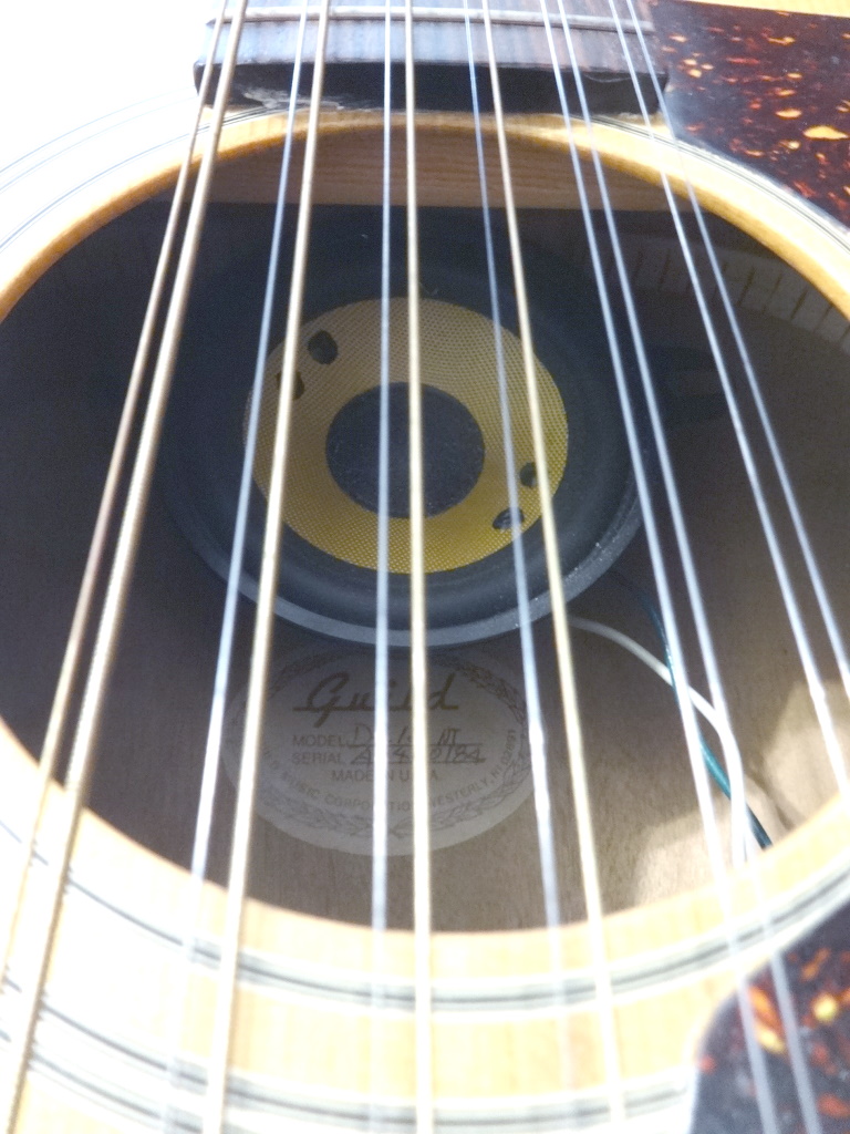

The Echoplex was the 1960's vintage version of the looper pedal, built with magnetic tape and vacuum tubes. I eventually got a dead one and rebuilt it.
An attempt was made.
No patent, unsure if I ever even "turned it on". Cant remember the adhesive I used.
12 is a whole lotta strings to take off and put back on, so it's sat in there for the past 20+ YEARS. The Guild it's in is typical of my equipment investments - not worth a dollar more than I paid for it all those years ago.
The fashionable sound effect was to go from an acoustic intro to full shred metal at the touch of a footswitch. Didnt have to be loud metal, just the classic "Boss distortion pedal" sound leaking out the soundhole. One thing that made it not so nice is that's where the mag pickup clips in, covering it partially. I wasnt about to saw up the guitar to mount one in neck or bridge position. There's bracing right under there, for one thing...
So I've just dealt with the guitar being heavy and unbalanced in the meantime. This and a tailpiece 1/4" jack I installed devalues the guitar from stock.
