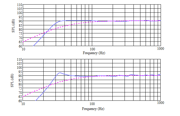

At the risk of introducing some basic physical principles, you'll potentially get some joyous resonant issues if you simply 'make a tower, vent it close to the woofer instead of the bottom'.
For example, attached. The upper is a reasonably well-designed 'vented tower' alignment intended for use in a moderately large space & for critically damping via the old click test to suit the room acoustic. The lower is the exact same speaker with the vent moved to close proximity to the driver, no other changes. QED. The problem with over-simplifying everything to the description of a 'plain old vented enclosure' & assuming that only Helmholtz action exists is that ye olde laws of nature don't make it so. A Voigt pipe unfortunately is not a 'plain old vented enclosure' and doesn't actually work on those physical principles, as its resonant behaviour is primarly dominated by eigenmodes (standing waves) rather Helmholtz (cavity resonance) so claims to the contrary are unfortunately mistaken.
Back to the actual question: short version re how much flexibility between different drivers is 'it depends'. A longer version is 'if the enclosure is acoustically large and Vb / Vp (pipe volume) swamps Vas then there is a modest amount of flexibility, as would also be the case with a conventional vented box, although the alignment will vary depending on how significantly the driver Fs, Vas, Qts differ from each other. Providing there isn't a huge variation, the differences also shouldn't be huge as far as the alignment is concerned (anything higher up is a different matter mostly unrelated to the box). Most drivers are built to a moderate production +/- QC tolerance anyway. The greater the deviation in spec. between the units however, the greater the difference you can expect to see in alignment terms. As noted above, for a Voigt pipe (aka ML-horn, aka [single] tapped horn, aka TQWT etc.), like any other enclosure, the dominant lumped driver parameters as far as alignment is concerned are Fs, Vas & [effective] Qts once amplifier output impedance or any series R from speaker wire & connectors are factored in.
