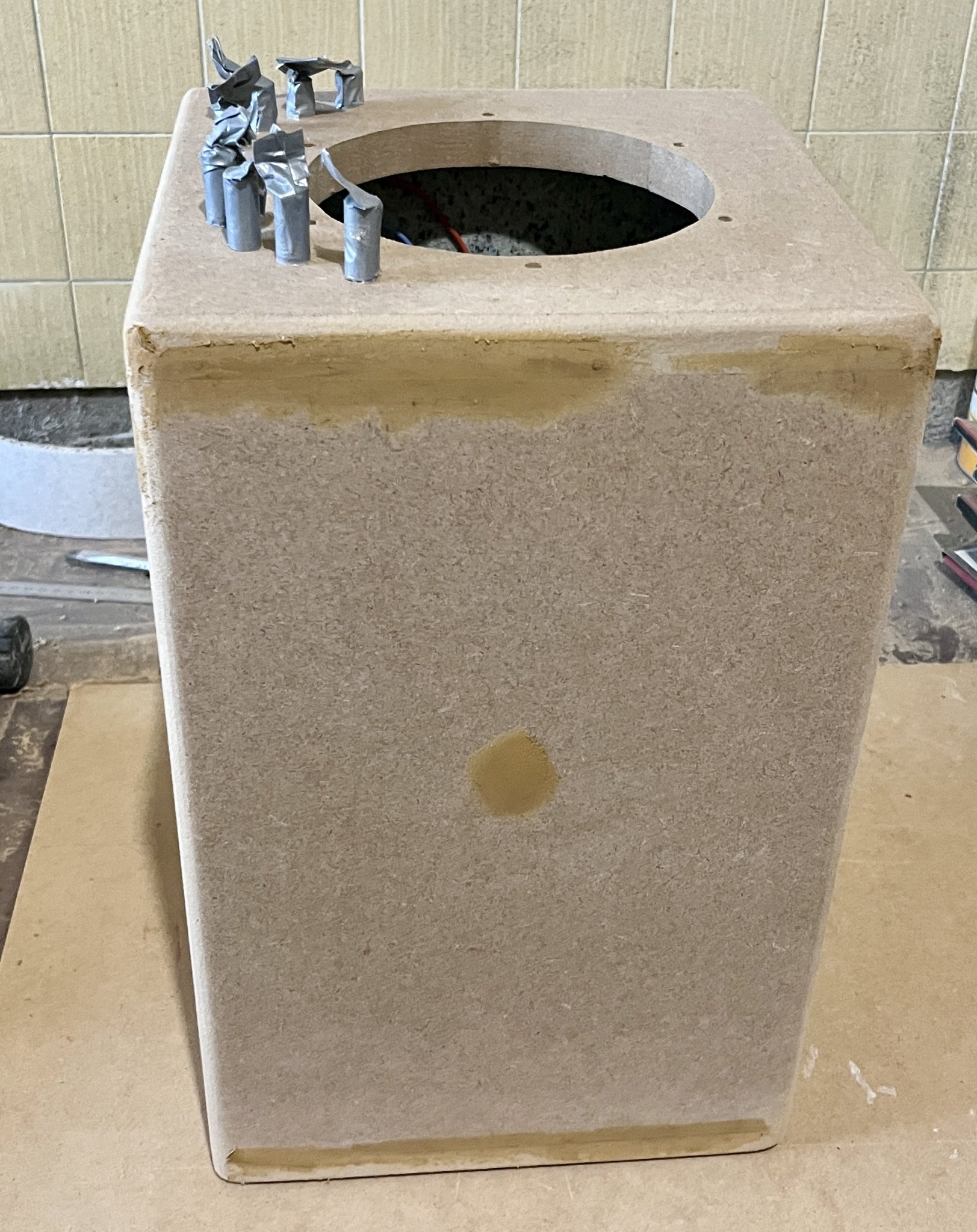

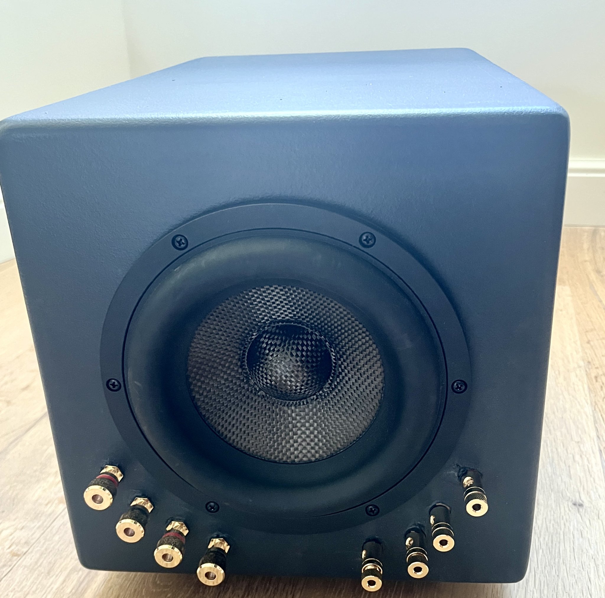

I would like to share my experimentation and realization of an active SUB based on the force cancelling principals, also called dual opposing driver configuration, based on an “exotic” setup:
The Sub:
For the sub I used 2 speakers from Dayton Audio : EPIQUE E180HE-44 200W – 2 x 4 Ohm 84dB 25Hz. They have a dual coil, and an impressive Xmax of 14 mm for such small speakers. In a sealed box, the volume for the 2 speakers is only 16 Liters, so quite small, for a big sound !
The box finalized:

The Sub:
The box finalized:

Any chance you have bigger pictures?

8 posts for 2 drivers? Each coil of the dual coils is feed outside?

the description mentions « 6db less when we consider one side » which I don’t understand: if the amp power is multiplied by 2 (ie: 3db) with 2 speakers, how can the global speakers volume by multiplied by 4 (6db)?Also called push-push.
If we consider only one side (ie one woofer), output falls 6 dB on axis as the transition for 2∏ to 4∏ stereiradians. Standard baffle step diffraction theory).
When you add the 2nd woofer, you get 3 dB more from the second woofer, and (typically) ∓3 dB depending on whether you wire parallel or series.
In a woofer as small as yours there would be no 2∏ radiation, the baffle is too small.
