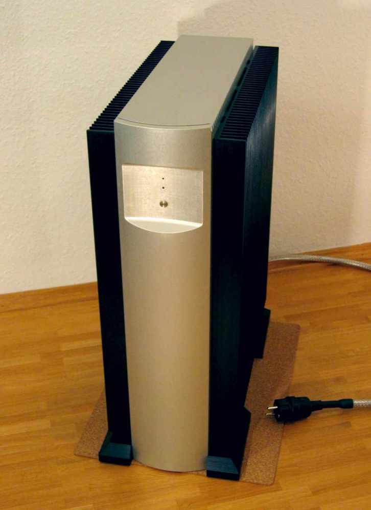

"So a kiloWatt... for what?"
120W fully differential Class A Monoblocks, each dissipating 500W. 1kW for a stereo pair.
Natural convection, with additional water cooling manifolds built-in for hot summer..
First DIY project from 2006.
Patrick
Patrick

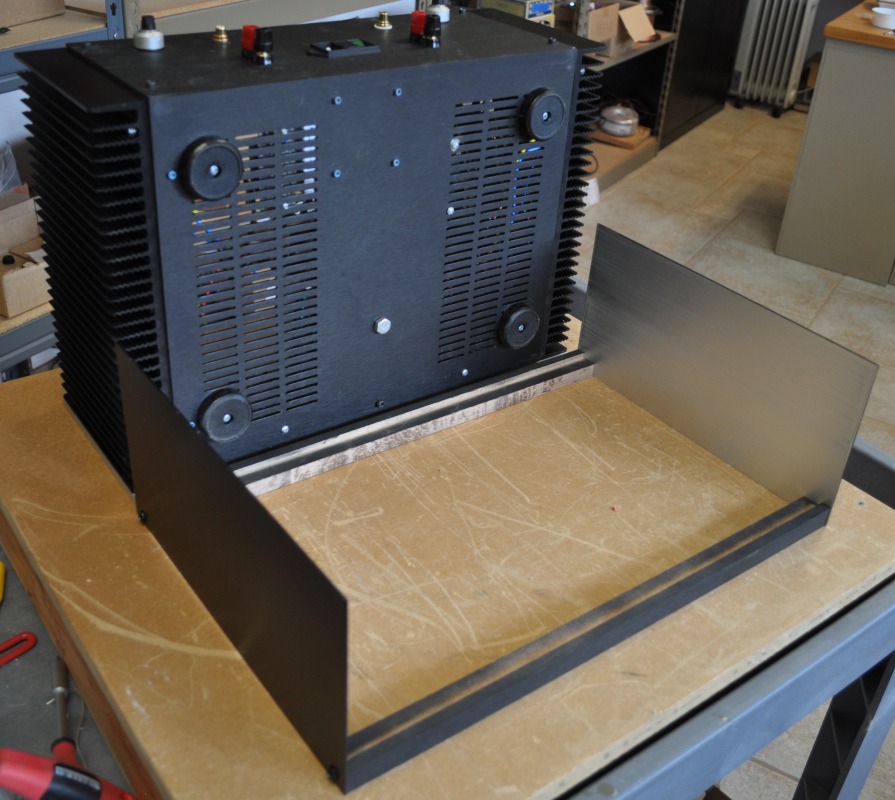

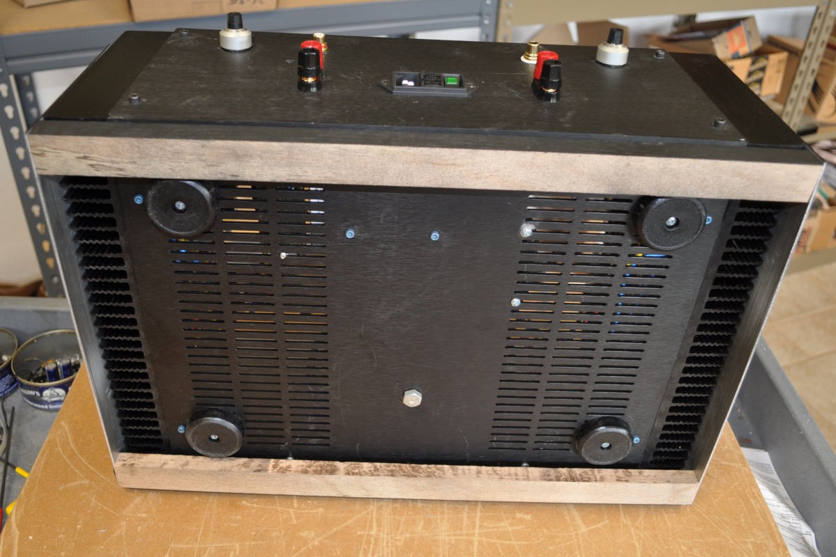

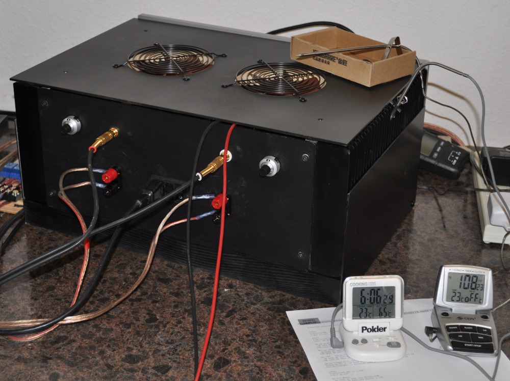

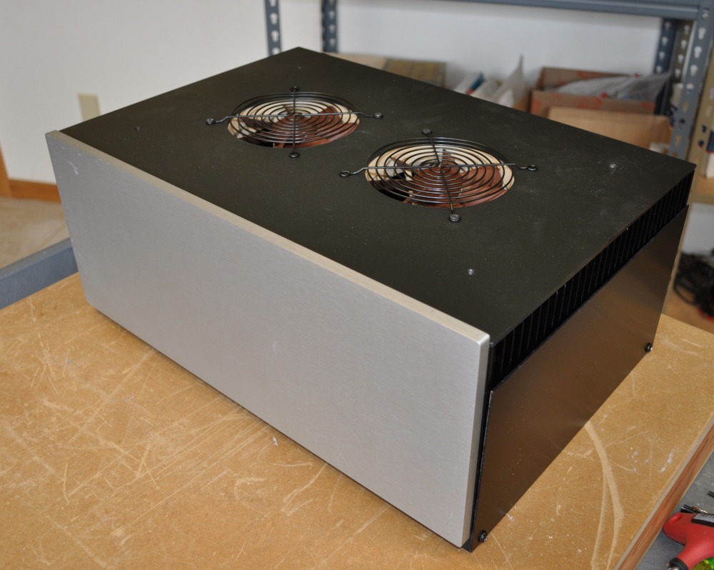

I finalized my fan cooling of my SIT3X in a diyAudio Store 300mm 4U chassis and it looks good and works very well. Here are some pictures:

Well done. I like the airflow baffle engineering. In which direction are your fans blowing (I guess in)?I finalized my fan cooling of my SIT3X in a diyAudio Store 300mm 4U chassis and it looks good and works very well. Here are some pictures:
I was musing about a forced air hifi rack in ZM’s babysitter thread: https://www.diyaudio.com/community/threads/babysitter-for-papas-koan.186554/post-7042342 ☺️
Ihquam, nice airflow design. I have also been toying with bottom up through the heatsink type of solution but I still have an oven inside. (Amp is LuDEF) Would be nice to have your feedback on 1)how much cooler things run and 2) how noisy is it? Thanks for sharing.I finalized my fan cooling of my SIT3X in a diyAudio Store 300mm 4U chassis and it looks good and works very well. Here are some pictures:

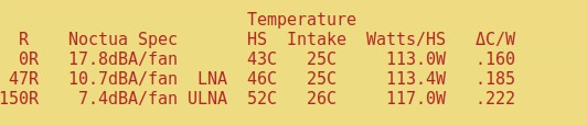

Here are temperature measurements for the setup on post #73 https://www.diyaudio.com/community/threads/forced-cooling-a-class-a-amp.385221/post-7044446 for three different fan speeds. I did not make measurements for the amplifier with no fans since that would require totally rebiasing the amplifier to a much lower overall power dissipation.
Temperature
R Noctua Spec HS Intake Watts/HS ΔC/W
0R 17.8dBA/fan 43C 25C 113.0W .160
47R 10.7dBA/fan LNA 46C 25C 113.4W .185
150R 7.4dBA/fan ULNA 52C 26C 117.0W .222
diyAudio Store DISSIPANTE 4U 300mm chassis
Two Noctua NF-S12A FLX fans
Each fan has resistor R in series with 12VDC supply.
Total power to amplifier: 120VAC 2.34A = 280VA (140VA/ch)
