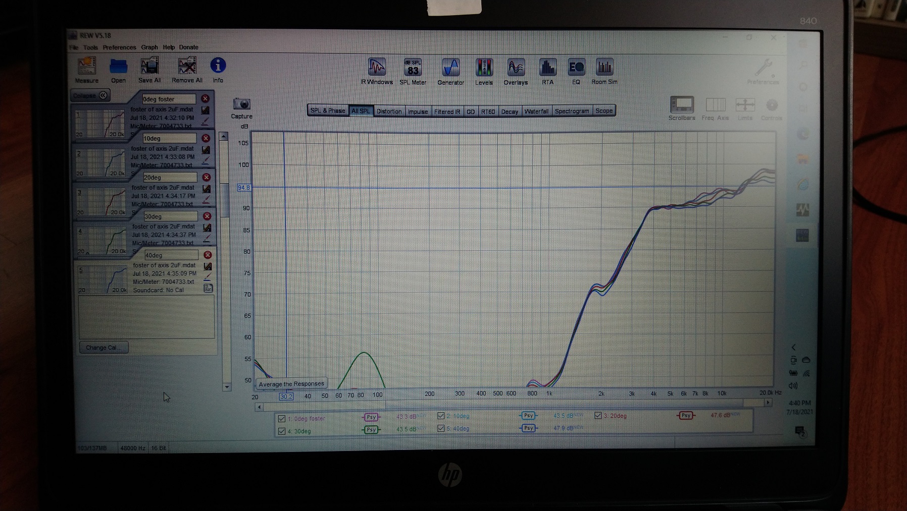

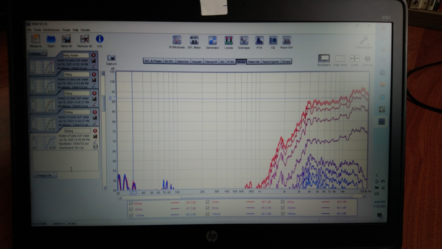

here is my measurements of foster planar
I do like it so much I got more and started new project
i can post distortion measurement, but you already made your mind
so i will not

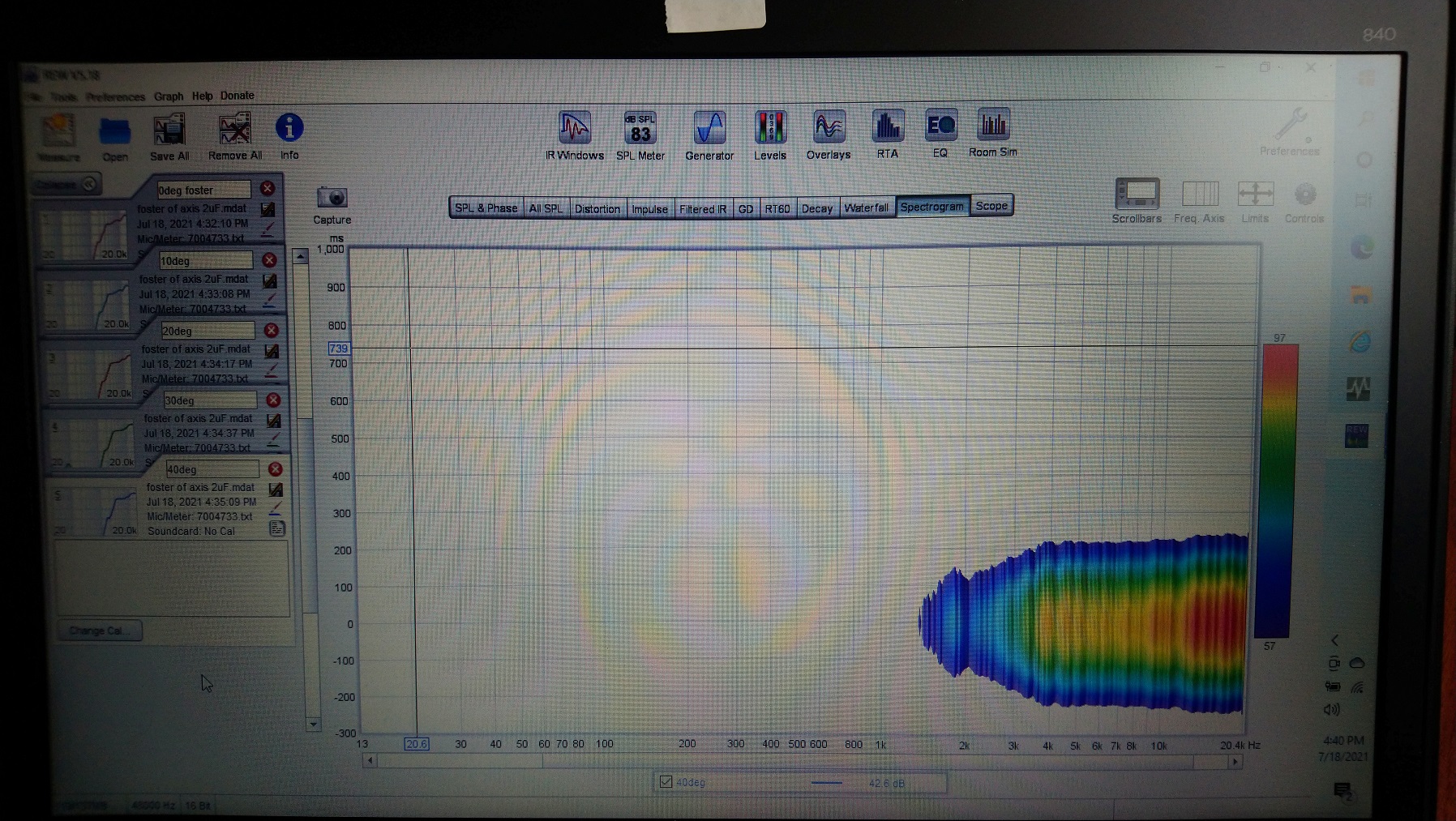

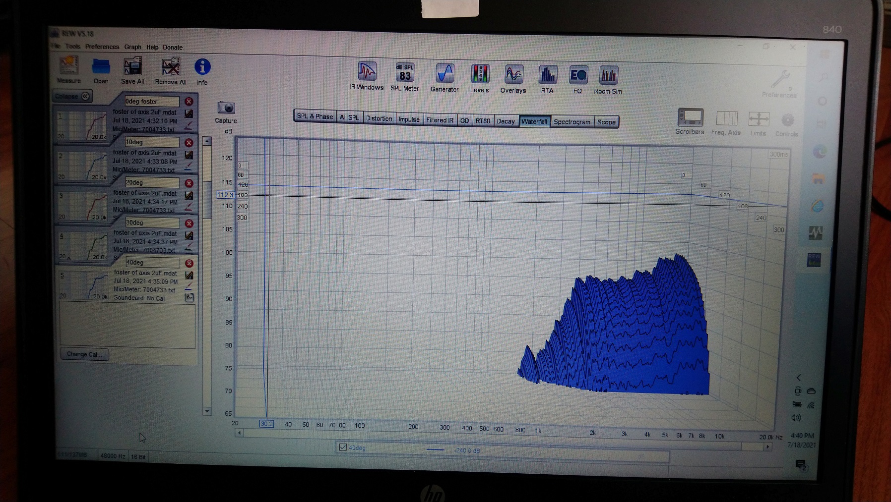

this is how mine measures

I have only made up my mind about the old and abused ones I have :) I'm not even sure it's the same tweeter, only looks similar and is made by Foster.
I measured FR of mine without the 'waveguide' in the Dali setup too (metal plate with the two tweeters mounted and a short 'waveguide' for the ribbon), and I think they were something similar to your measurements. Maybe Troels should have measured it without the waveguide and he would have had another opinion, I don't know.
Once the ribbon is out of the Dali waveguide thing, it visually looks the same as the one here.
If you have the distortion measurements, it could help others make up their mind.

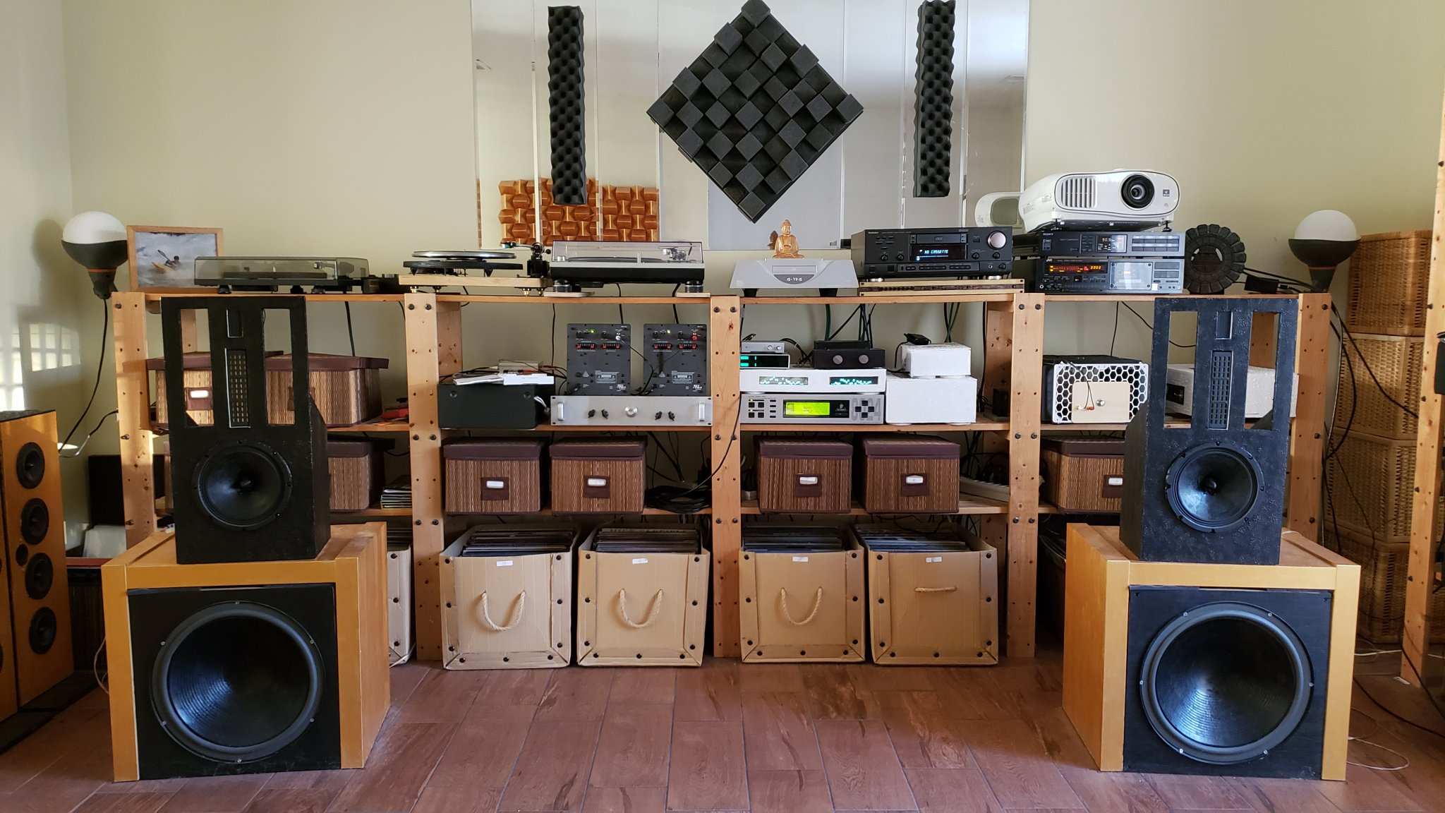

The speakers i built with this supertweeter are finished and are one of my best sounding creations. Minimalistic open baffle.
I am going to build yet another, with even less baffle, just wires.

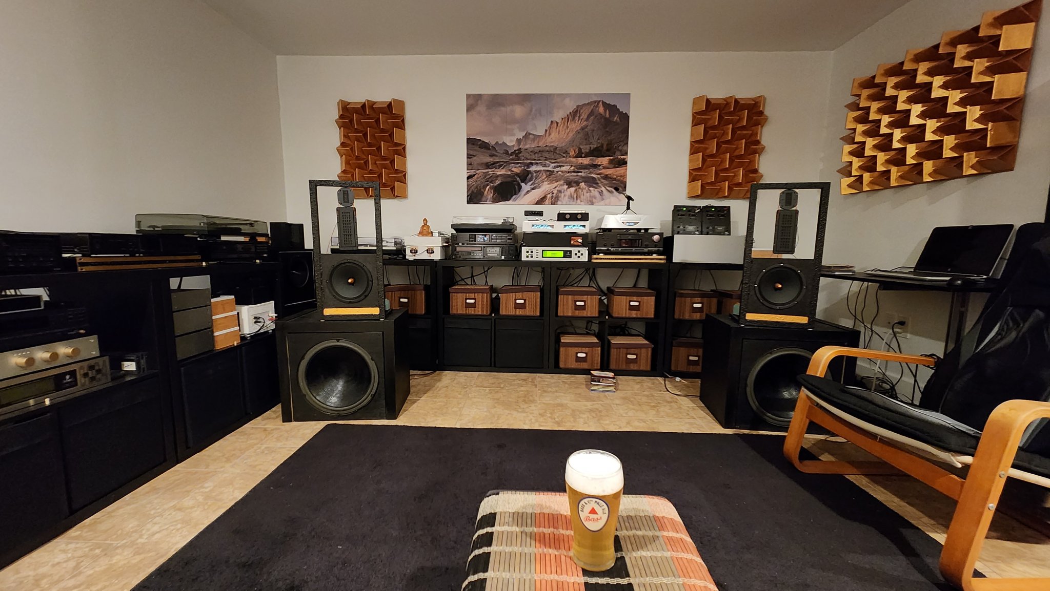

For better stereo image I find less baffle or no baffle best. This gets more critical for mid and tweeter. Soundstage is someshing I am very keen to have best as possible.
My system right now is 4way open baffle. Works for me. Keeping speakers away from the walls is a must. Still things to experiment with, but I am happy with the sound for now.
