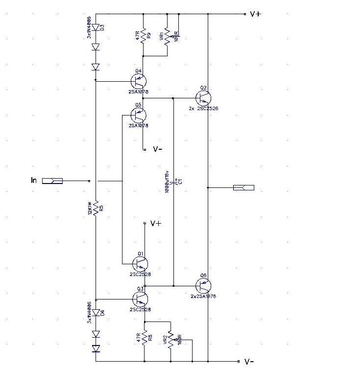

I have recently built an amplifier with output stage what is called here "diamond buffer", using FETs. I was sure this was not a new output FET concept although have never seen it before. I expanded my observations in the thread named {My 'parallel' amplifier}. I switched to another amplifier since then but plan to return to that one as soon as get good acoustic systems for listening (measured parameters were not that bad).
here is output stage of amplifier that was proposed around 1987 in 'Radio' magazine. It was entitled 'parallel' there that is where I took this name from.
I could mess base resistors value a little bit though (drawn without book). That amplifier was intended to drive 8 or 4 Ohm load.

I have open a new thread, using Marc Vi's sziklai-darlington
output stage instead of normal diamond buffer's NPN/PNP, so the
6-transistor output stage can be an huge AC current gain.
sziklai-darlington diamond buffer (SDDB) for power output stages
ULTIMA-SDDB CLASS-A POWER AMP CIRCUIT PDF
In this SDDB POWER AMP , the Vbe of Q13 about 0.7V is equal to
the stand-by current multiply (R25//R33+R26//R34), if R25//R33=
0.33 OHM, the stand-by current will be 0.7V/(0.33+0.33)=1.06A.
It is about a small power class-A amp's stand-by current .
It can be applied to either Class-A or Class-AB.

The good old four transistor unity-gain buffer which consists of a complementary emitter follower, another emitter follower pair that replaces the bias diodes and two current sources is very popular in complementary integrated op amp designs as well as some discrete designs. For a schemetic, take a look at Sonny's page:
http://www.geocities.com/sonnya5000/basicb1.jpg
He did some nice simulations about distortion and how to improve it for low impedance loads.
What I wonder about: why is this nice topology apparently not used for power output stages? Is it because it is too difficult to keep the bias constant?

The circuit in this diagram switches from class-A to class-AB at a few volts of output, is that deliberately?

I have heard this power amplifier. Also with currently models very hard to beat after replace old capacitors through new devices.I have on hand a pair of German amplifiers that are using power diamond buffers as outputs.
In the attachment the complete schematic and some informations to Fujitsu's MET's for power stages.
I can access geocities site .Please post up some photos!
Geocities is gone now!
Thanks Tiefbas.
Yes they are nice amps. Feedbackless power stage.
I suppose the outputs devices to be hardly matched.
I have drawn the front end schematic another way.
- four transistor emitter follower (diamond buffer) as power output stage?
