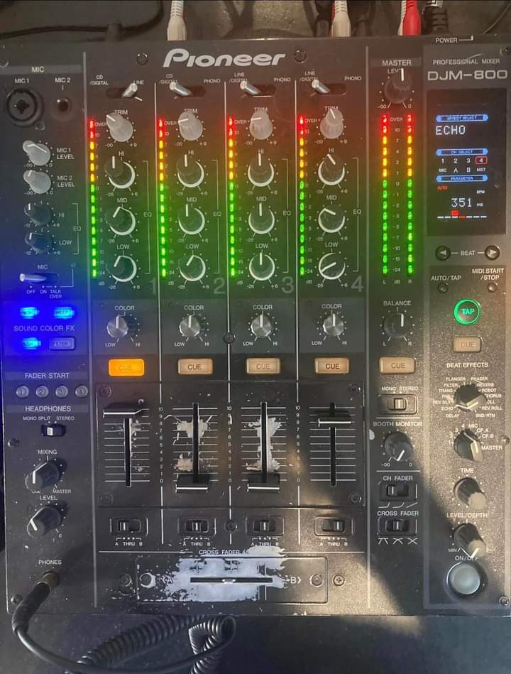

4X CDJ 2000 NEXUS connected to a DJM 2000 Via RCA
XLR out from the mixer into a Alen & Heath Zed14 desk XLR out from desk into an XTA 226 crossover low end rolls on around 30hz and rolls off at around 80hz then crossover into the amps (E100 for sub)
The rig was playing drum & bass around 96-105db (we had to turn it down a few times due to noise restrictions) for around 8 hours.
I genuinely think the issue comes from djs completely ramming the outputs.
Image as en example not our mixer but you get the idea
I've been told running a completely digital signal path could eliminate clipping?

I have limiters enabled already but unfortunately that dosent solve the square wave issue. The XTA dsp I use has a RMS limiter which was setup correctly but the drivers still manged to fry 😐
Perhaps if you where frying HF drivers you could blame clipping in the signal chain. What you show is thermal failure which is caused by long term average power exceeding what the driver is capable of you need to adjust down your thermal limiter. The DP226 seems to only have one limiter per output with a maximum attack time of 90mS idealy you want a longer time constant around 6s for a sub driver to get the most out of it, however even with a shorter time constant you can reduce the average power by setting the limiter threshold lower.
