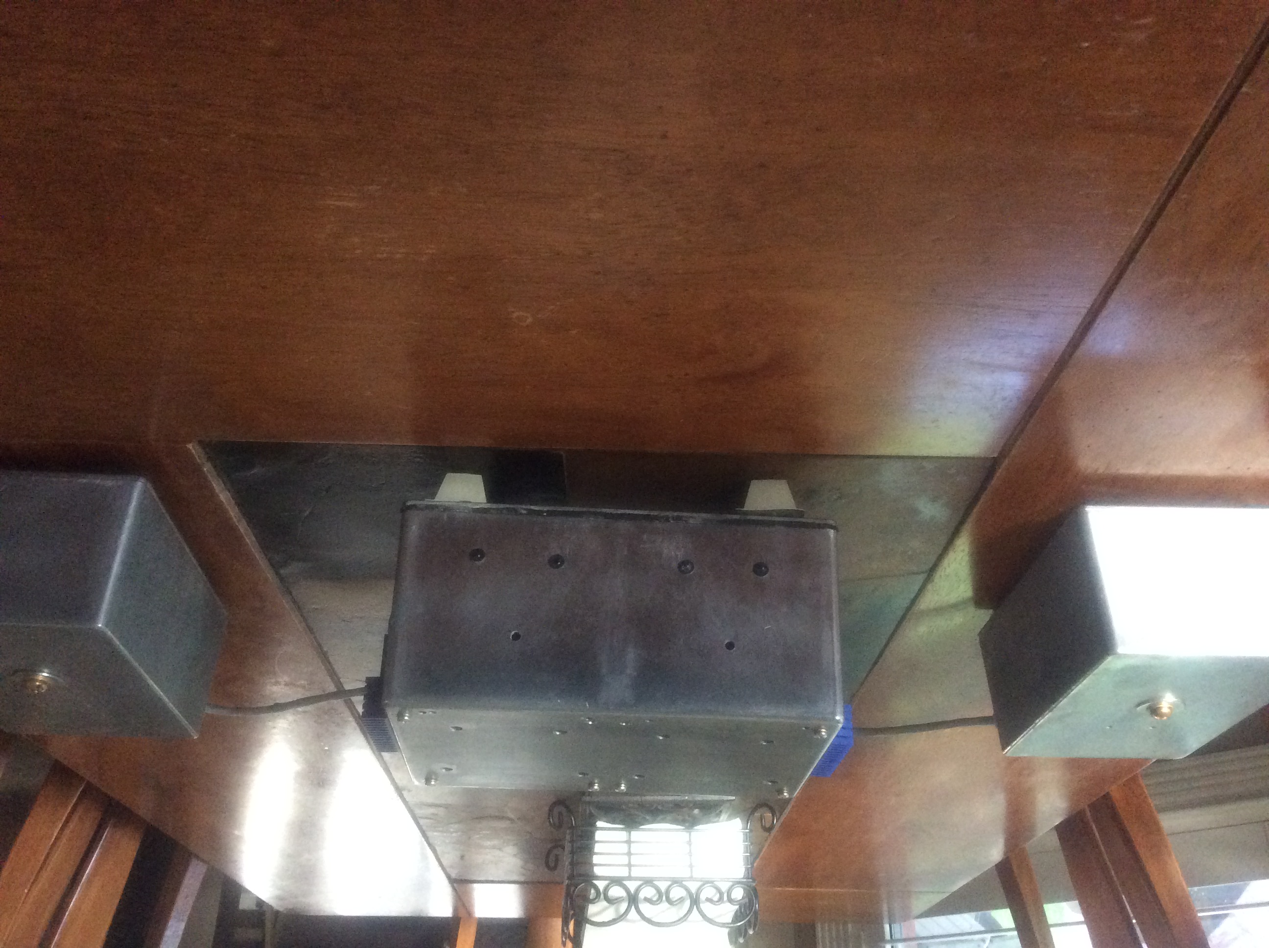

Thanks gglera. Nice clean build. I also like that you used the sides of the enclosure as a heat sink. Its nice that these amps don't need a huge heatsink, although I always seem to use a big one anyway. I remember the heatsink on Dario's development board was just a piece of aluminum sheet.
Jac
Yeah Jac, I think next one I build isn’t going to use heatsinks. I’ll just use the sides of the chassis (like gglera) and save on space&weight.
Pete

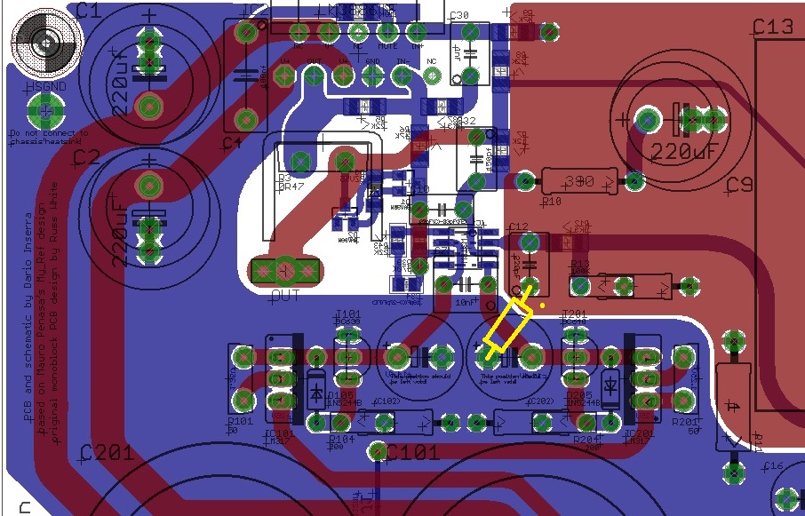

R11
Dario, et al., so for the V1.05 boards I just built should I follow the picture above and move R11 from its current position on my board (near C13) and move it to the position shown in the diagram Dario posted, from the "+" lead side of the empty cap to C12?
Thanks, Pete
The latter boards (from 1.5 and Up) have tenfold less distortion and most of this reduction is due to R11 position.
Thanks, Pete

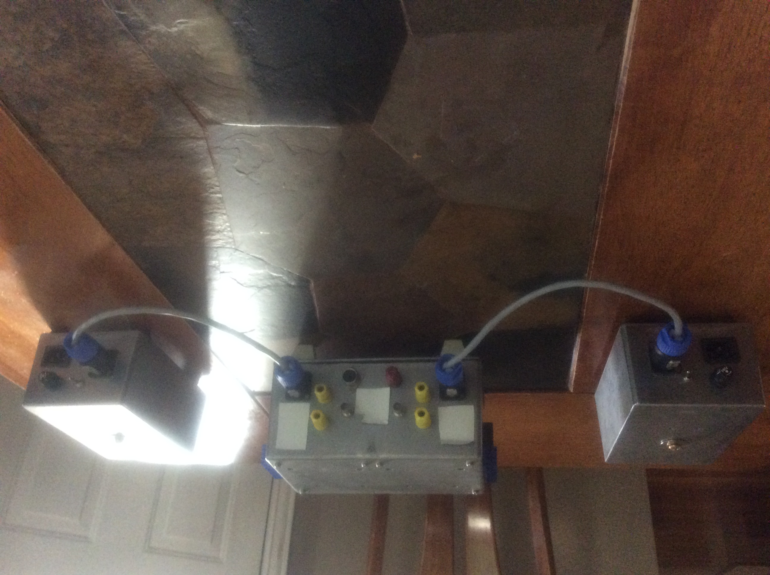

My FE build
This uses the boards from the 13th group buy. The three chassis from another project.
Powercon connectors from transformers. Amphenol Mil-Spec BNC Twinaxial input connectors. EF Johnson 5 ways. Brass power transformer mounting bolts.
