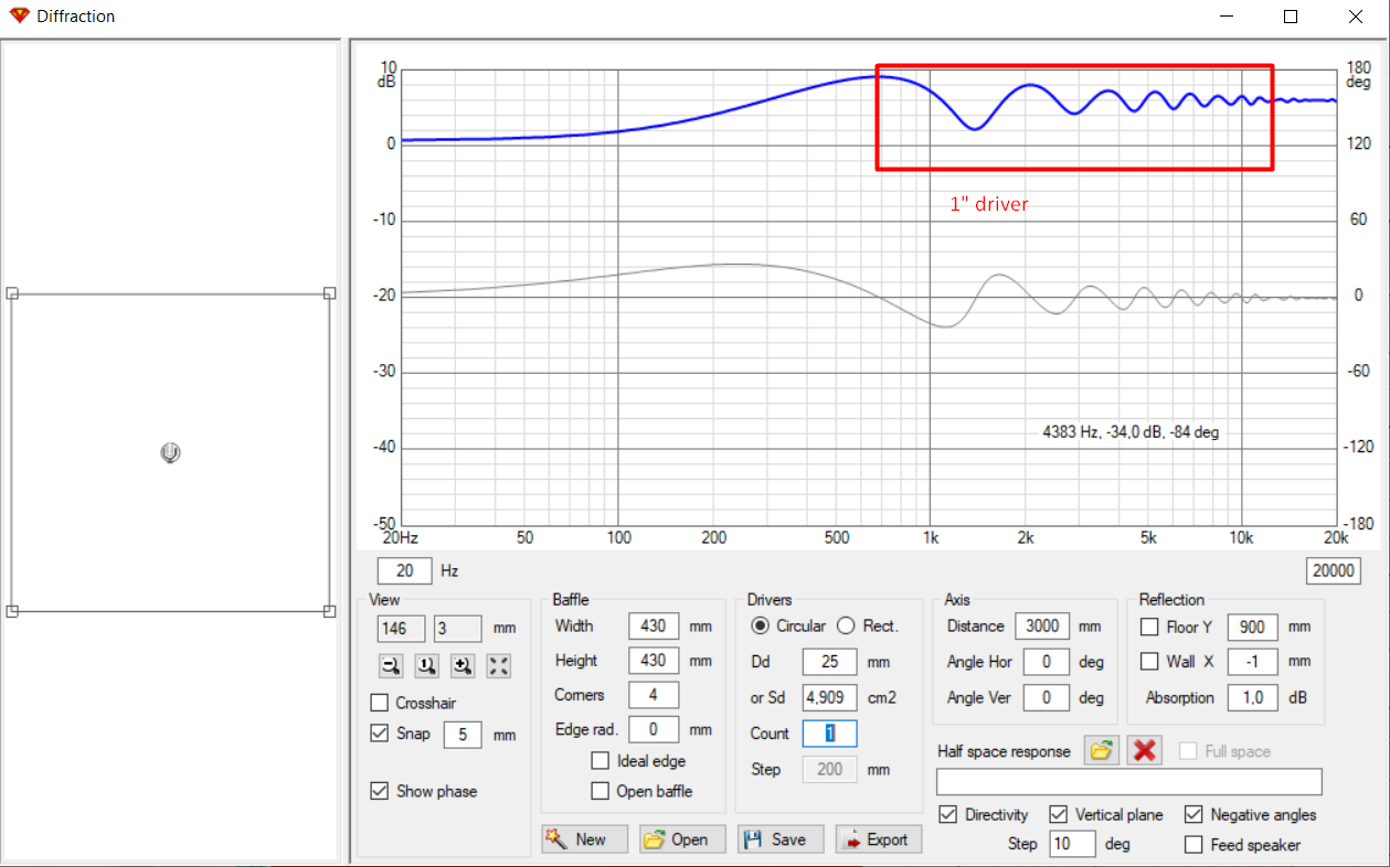

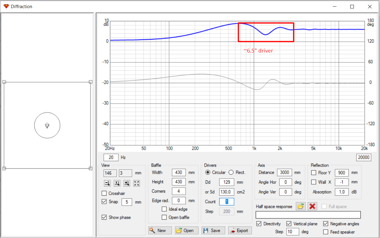

It is a trend but also least amount of diffraction, if you think it through. Small driver on large baffle has diffraction wigle over wide bandwidth. Keep the baffle small and drivers big, in other words as little baffle surface as possible.
Also, the baffle step is easy fix with EQ/crossover, but the wigles you can't EQ without causing more problems.

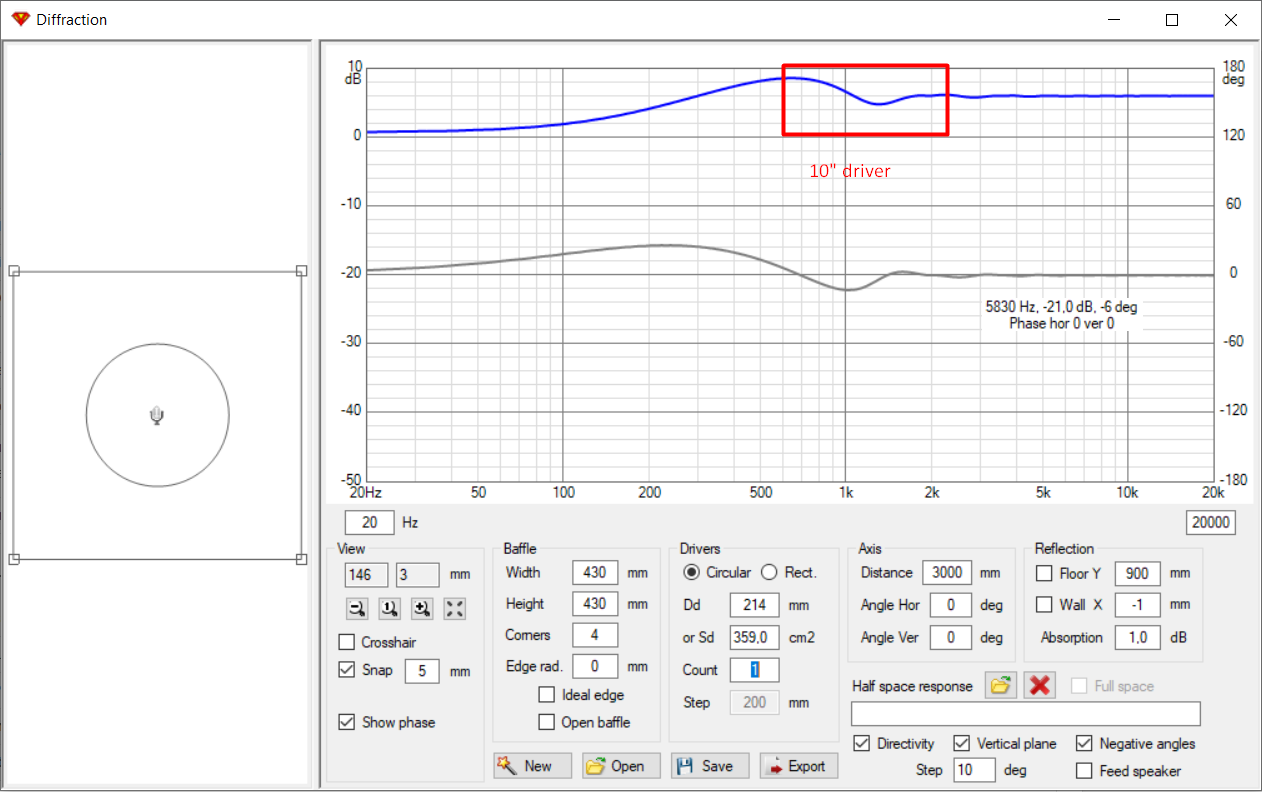

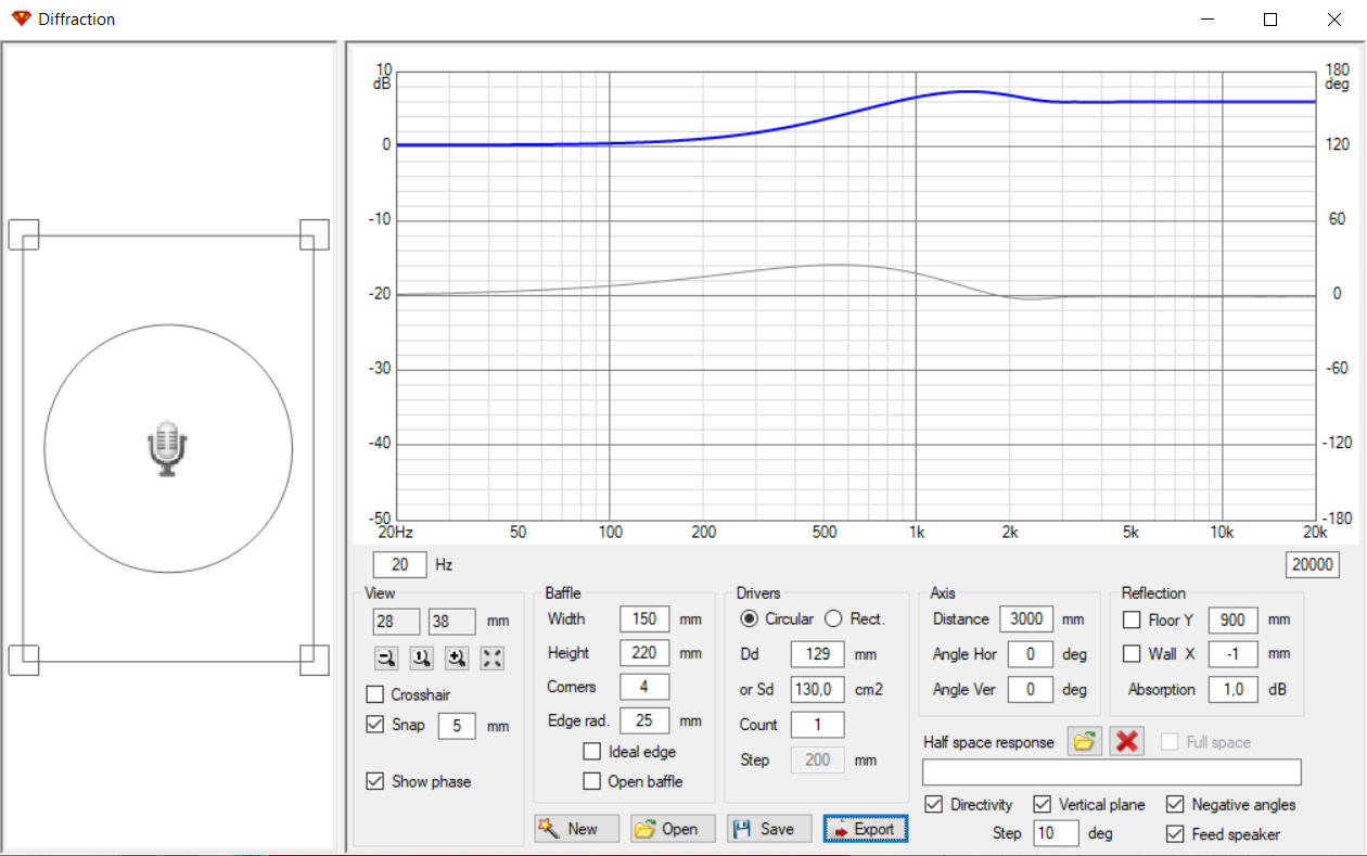

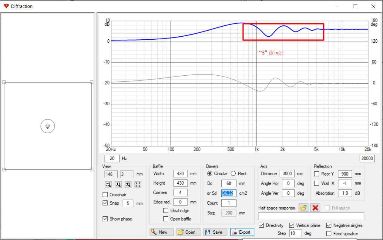

One more example showing the "bandwidth" I've mentioned multiple times now 🙂 Small driver on large baffle has a lot of wiggle (over wide bandwidth), big driver has no wiggle at all. Attachments demonstrate 43cm square baffle, driver in the middle and 0 degrees reference axis to maximize the effect seen on the SPL graph. Attachments are 1", 3", 6.5", 10" and 15" drivers on the same baffle. You'll see the bandwidth that has diffraction "problems" gets narrower until almost disappears on the 15" driver. Last attachment shows ~6.5" driver on ~6.5" baffle and you see there is no wiggle at all.
This means less baffle surface = edges as close to driver as possible, is better. When the baffle edge is right at the driver edge, the frequencies which don't beam are long enough to not cause diffraction at the edges. Makes sense. Slanted edges / roundovers help to get bigger box and still have baffle "edges" close to the drivers. On a direct radiating multiway speaker there is large and small drivers on same baffle so some tricks must be done to minimize baffle area. Google up the Revel Ultima Salon 2 images, pretty much minimal baffle right there 😉 Pulled up the Revel Salon 2 since it is often mentioned here in the forums due to infamous comparison between Salon 2 and JBL M2 some years back. By the way the M2 also has pretty much a minimum baffle area.
Theoretically, if you had a driver which was completely directional (emitted no sound 90 degrees off-axis) then the baffle would have no effect what so ever.Thank you everyone, I believe I understand a bit better now.
A direct effect caused by a physically smaller driver being closer to a point source, the larger driver has a greater radiation area and one gets an averaging as a waveform meets the edge excited by a wider range of distances from the source causing plus & minuses in the ripple cancel out yeilding a smoother large scale FR (what we measure). One wonders if that acoustic smearing at the edges causes some low level detail to be lost in the averaging. Consistent with the generalization that smaller drivers do higher frequencies better.

When driver is small compared to baffle the wiggle is a lot worse.

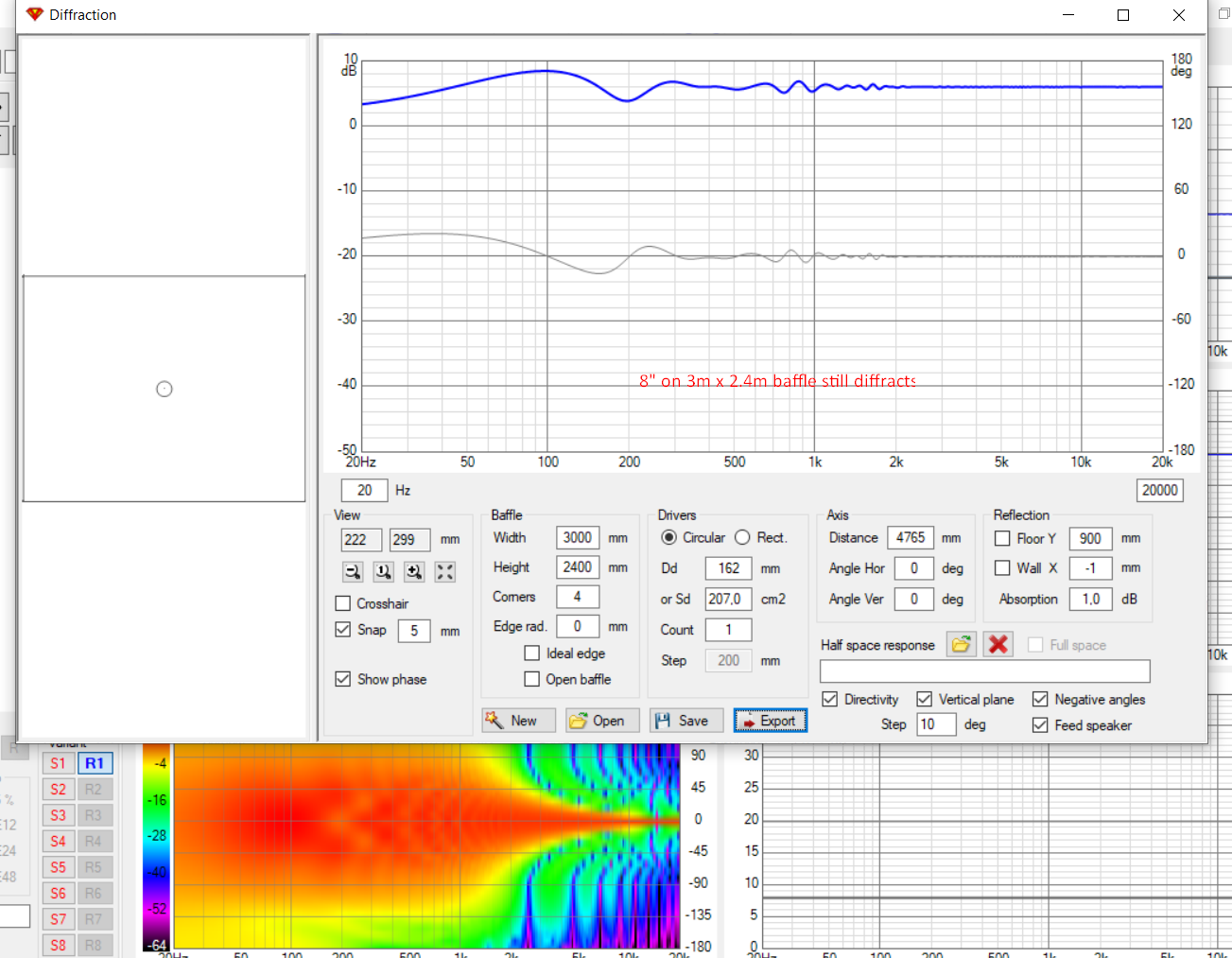

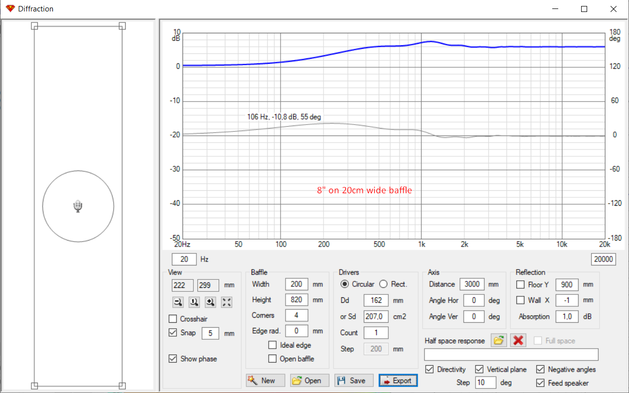

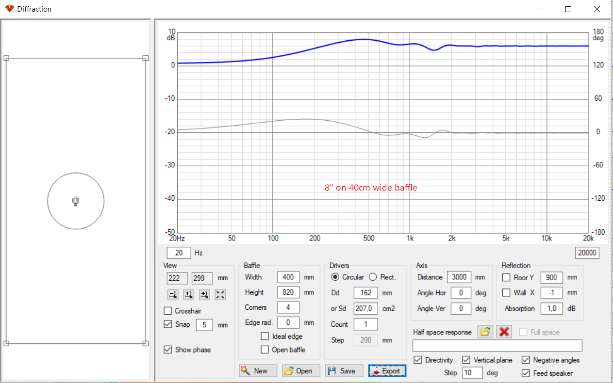

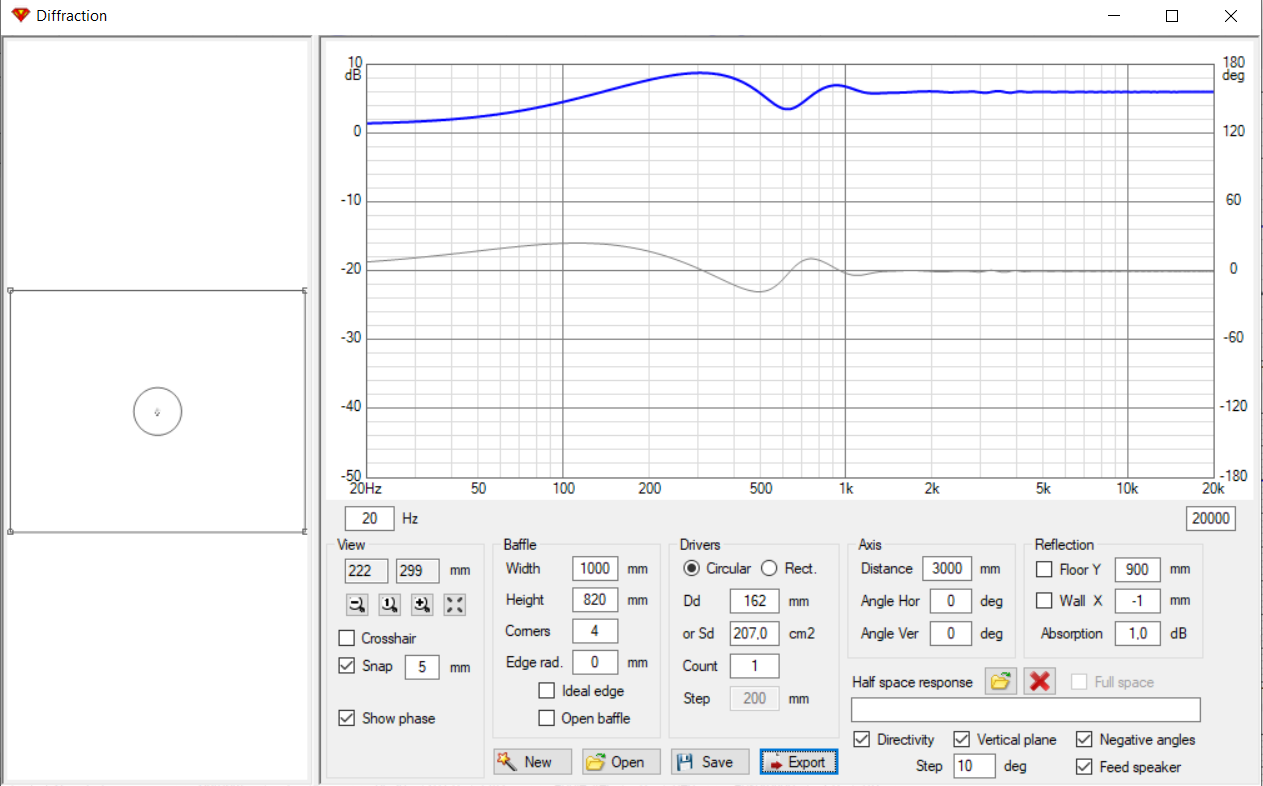

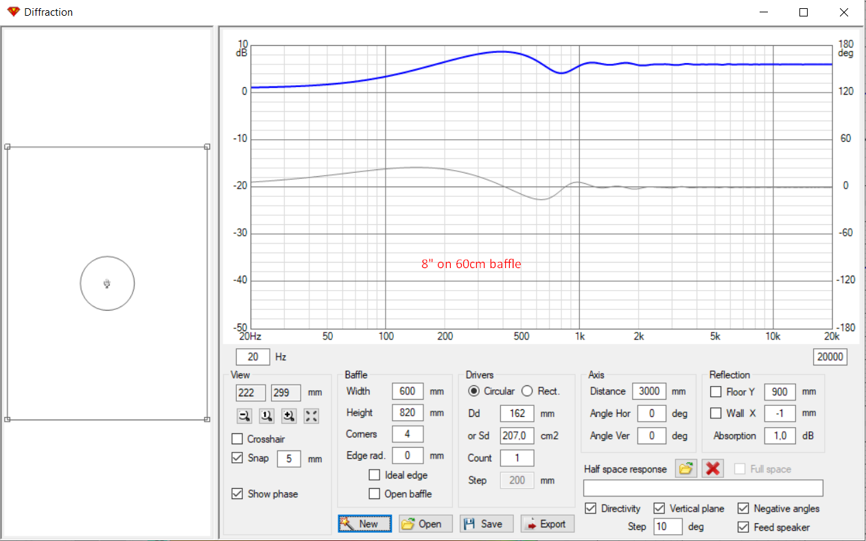

Alright few more 😀 This time driver size stays same but baffle gets wider. The diffraction starts lower in frequency when baffle gets larger. Upper frequency for the ripple is bound by the driver beaming as in examples before and when the bottom frequency slides down as baffle gets wider the ripple gets wider bandwidth and effects seem to get worse. Edge diffraction is still there even when the baffle is size of a wall, 3m x 2.4m.
Attachments are 8" ideal driver on 82cm tall baffle. Widths are 20cm, 40cm, 60cm and 1000cm. Last one is the 3m wide 2.4m tall baffle and Directivity polar chart is seen underneath the diffraction simulator. The diffraction effects in the listening window are very closely stitched (orange dots on the red area) so maybe the ear isn't sensing them anymore on a large enough baffle? This is silly big though, and lot more artifacts than narrow baffle.
My conclusion based on the diffraction simulator with ideal conditions that wide baffle (compared to driver size) yields worse diffraction effects (more ripple) than narrow baffle. Roundovers and slants seem to help. When baffle is no wider than the driver, no diffraction ripple is seen.
The experiment was purely visual and considers only the diffraction effects I don't know what audible differences there is. It is high probability that less ripple sounds better though. There is lot more to loudspeaker design so wide baffles shouldn't be skipped. Diffraction can be reduced with roundovers and beaming (horns) 😉
