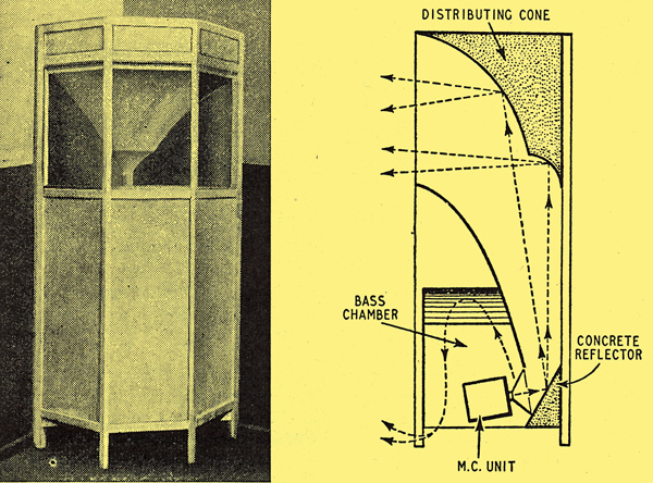

The Voigt Domestic Corner Horn output from the horn is from about 90Hz-12k.And that a FLH is really only capable of 3-4 ocatves so at some point(s) the box is no longer a horn.

This might interest you.
Voigt Corner Horn contemporary build based on original design and materials
A friend of mine built a pair, using an existing one for reference. Just to say that it fits in a corner, and the plaster moulding of a 3 dimensional curve is not for the faint hearted.
From memory (not 100%) it was called a quarter wave horn because it fitted in a corner. Think of it as a quarter of an ice cream cone. So it was a quarter of the full horn. I have heard what I think is an original Voigt full wave Tractrix horn. Absolutely enormous. It works in free space an points horizontally. It did sound fairly awesome.
