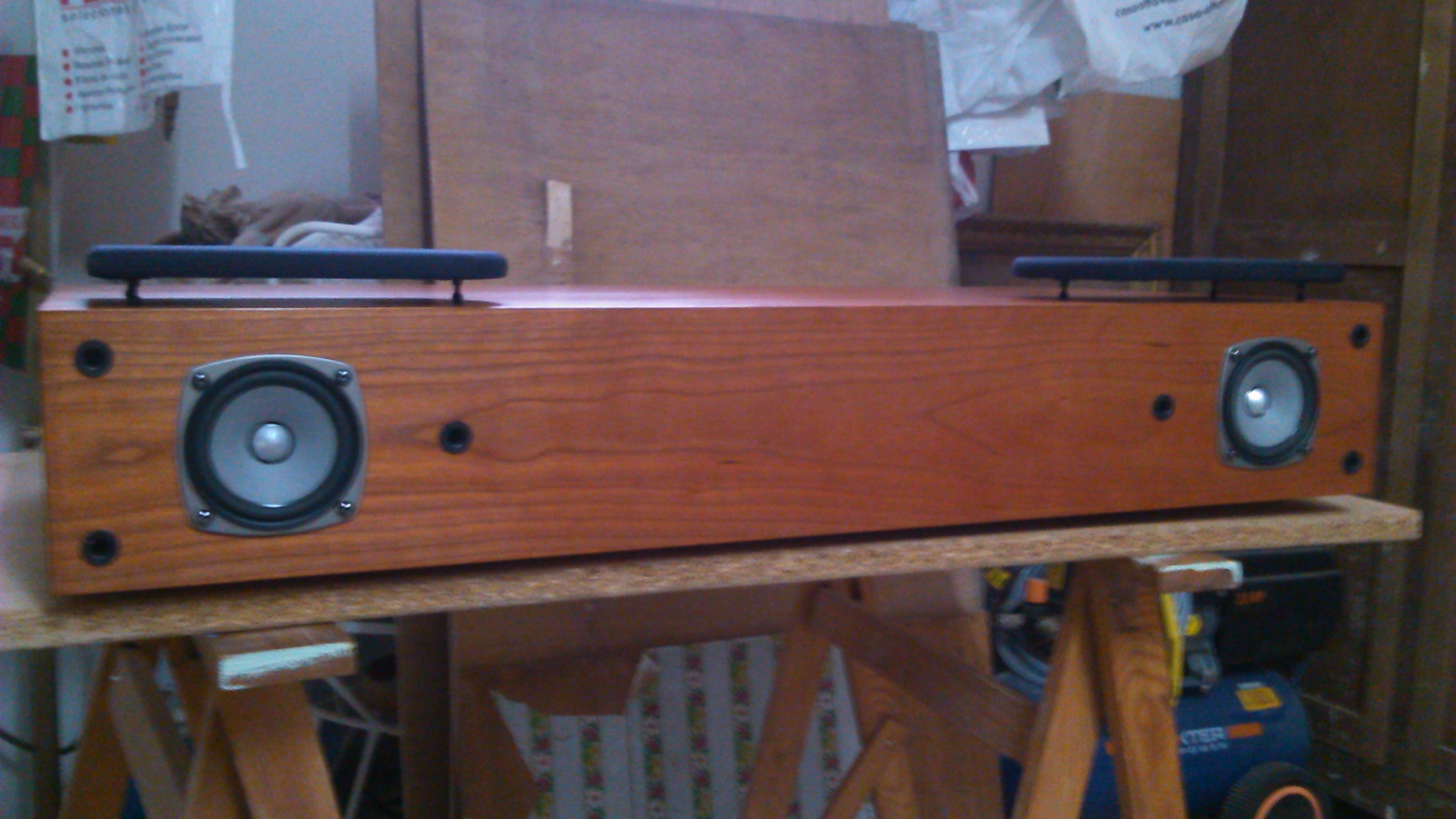

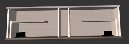

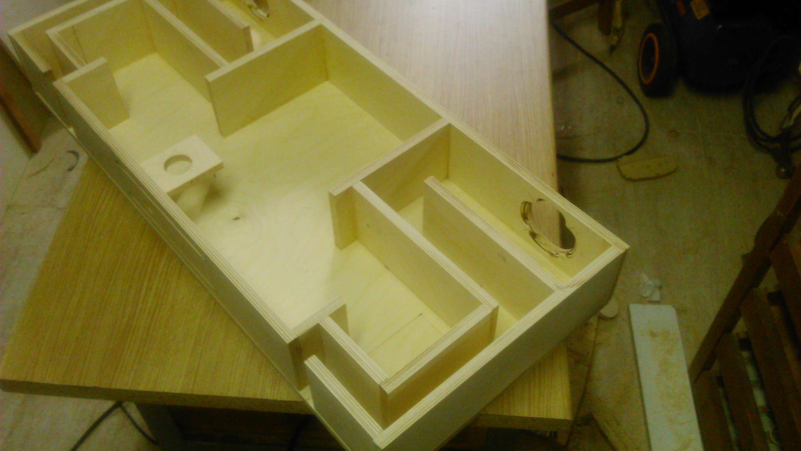

I always look at those spaces as a place to put a helper woofer. How much volume is it?
Around 12L.
Box dimensions were fixed to match tv stand, here the looks was very important. I didn't want bass, just clear and clean mids. Owner is pretty deaf and the object was improve speech inteligibility.

Around 12L
Would work with 1 or 2 Silver Flute W14 (but those don’t seem to be available in Europe).

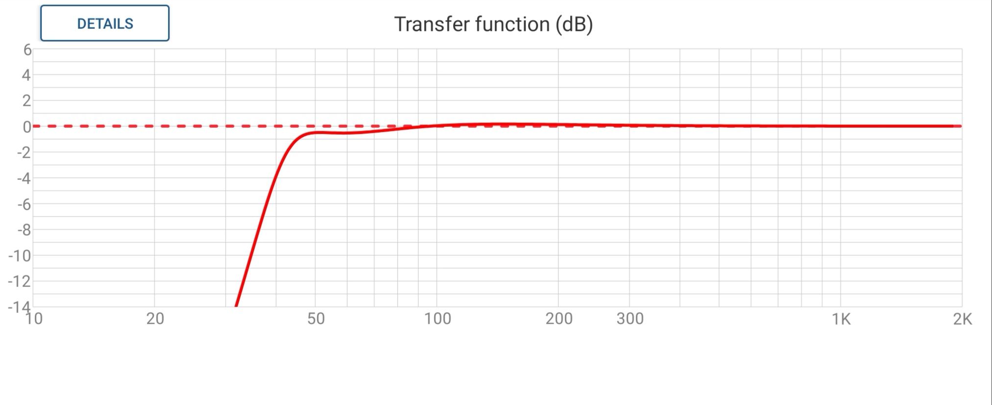

Just a quick example:
Dayton Audio rs-225-4 as a woofer in about a 45l ported box would reach down to 38Hz
Add two Dayton Audio rs100-4 as full rangers in a 2.8l ported box each that would go down to about 75Hz or 0.8l box where those would go down to about 145Hz
X over at 100Hz for ported or about 200Hz for sealed and you'd be golden.
A simple 3116d2 2.1 amp equiped with line in and bluetooth should do the job just fine.

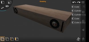

Hi all,
1. € 10,40/piece: VISATON FRS 8 M - 8 Ohm
2. € 28,40/piece: Dayton Audio RS75-4 3" 4 Ohm\
3. € 33,45/piece: Tang Band W2-803SM 2" Extended Range Speaker
4. € 39,95/piece: Dayton Audio Reference RS100-4
5. ?
Maybe someone has a good suggestion for a good sounding driver between 10 and 30 euro's, I'm not planning on making a crossover.
Thanks for reading!
