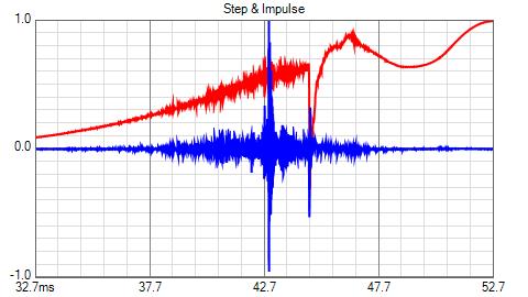

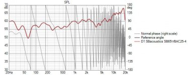

You can see the ringing is still in the IR, but not in the windowed IR, window defined by 5 cycle FDW. So the IR really is ringing and not due to any EQ filtering as the ringing appears in the raw responses also. What could make it ring?
Could it be low damping factor due to 8 drivers in series? I don't want to rewire the array only to find that wasn't the cause. Perhaps I could put some R in series with the amp and see if it gets worse. But I also had this ringing in my Synergy project so perhaps its something in the sound card.

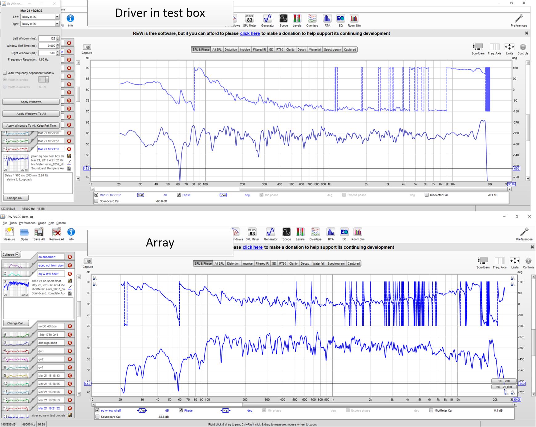

Yes phase is ugly w/o FDW but its not due to being in an array. Its due to latent reflections in the environment.
attachment.php
The array phase is a little bit messier but I'm better able to absorb around the small test box than the tall array.

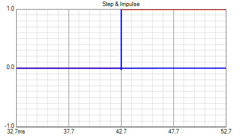

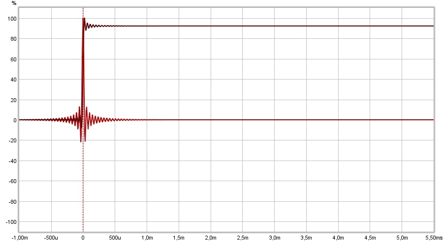

The ringing you see can be one of many things, lets start by looking at a generated Dirac pulse (generated with Rephase):
attachment.php
As you see there's even some ringing there (due to the abrupt end of the impulse).
Now put in the DAC, and loop back to see how that performs within REW. Guaranteed it will not look any cleaner than the Dirac pulse. Next put in the amplifier...
But, the series of pulses in the first raw measurement:
757684d1558281985-range-line-array-wall-corner-placement-ir-garage-door-jpg
That is a series of peaks of the separate drivers arriving at the microphone.
Once we EQ out all of the dips and peaks, you'll immediately see the clean up in the impulse. The impulse is "just" a rendering of the total data with an emphasis on high frequencies. EQ-ing this flat isn't that easy, as one would need quite a bit of resolution in the top end to see the summed result of all those tiny pulses.

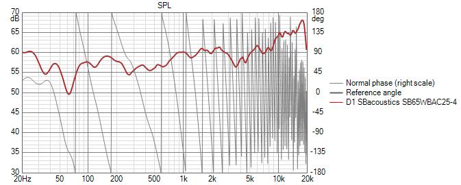

I took the measurement of the single driver test box, imported it into Vituix, and looked at its IR. I next used Vituix calculator to create a filter that made the FR perfectly flat.
Attached pics show the before and after
the measurement viewed with FDW5
attachment.php
The IR and step in Vituix
attachment.php
The simulated IR with a Vituix mirror filter
attachment.php
Its just as you said. A ringing IR just means there is more EQ work to do

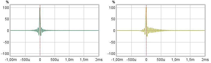

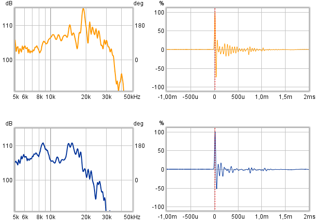

Have couple of points that maybe can be reason some of the HF hash seen, one is the relative hot ringing and high HF reach on axis for SB65 8kHz and up another is for many sound cards of past decade it had been modern argument their sharp low pass filters should be of minimum phase instead of using linear phase filters.
Here is HF hash of SB65 (orange) verse TC9 (blue) on same big cardboard baffle, sample rate for session is at 192kHz and had it been at 44 or 48kHz guess hash would be much worse:
attachment.php
Her is loopback session at 44kHz with a quite old souncard using linear phase low pass filter (green) verse a moderne one using IIR low pass filter (gold):
attachment.php

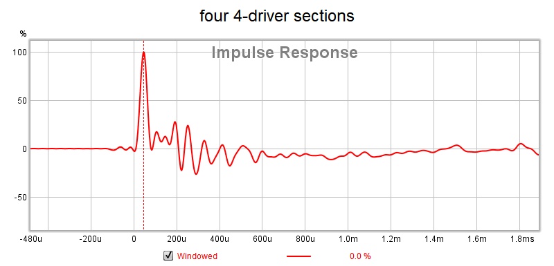

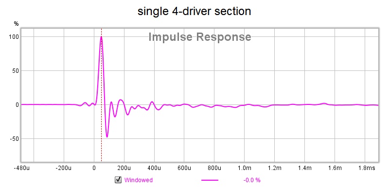

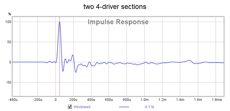

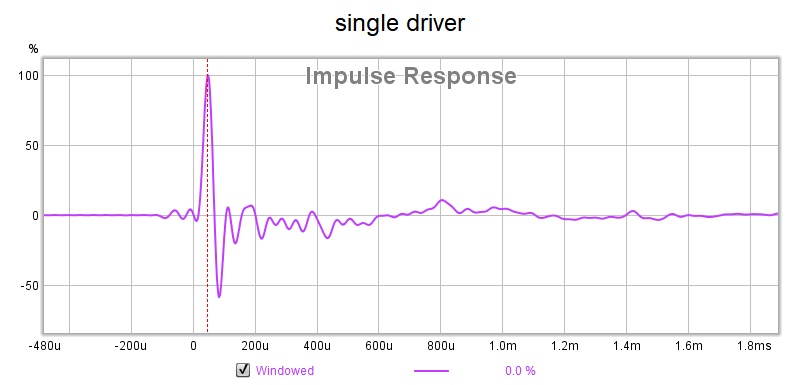

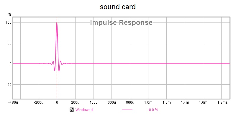

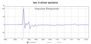

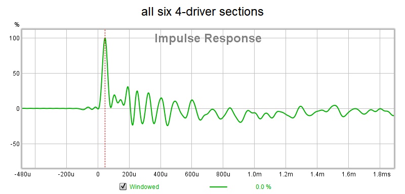

Hi guys, had some time to test my 'multiple arrivals' hypothesis...as the source of 'ringing'
So I started ground up with a soundcard measurement to eliminate that variable.
Then i just built upwards from single driver on an open baffle, to the full array, which has 6 groups of four TC9's per section.
Measurements were out on a deck with the mic about 10ft away centered on the array. Not as reflection free as out on driveway, but all i had time for....
Following plots in order:
Sound card
Single TC9 on open baffle
Single 4-driver section from array
Two 4-driver sections
Four 4-driver sections
All six 4-driver sections
Thanks for doing those tests and uploading mark100! From your screen captures it appears there is more ringing from the full array vs the single/small array.
You bet !
My take is that we can correct the squiggles under 200us....I think that's diffraction. My open baffle was the same width as the array baffle.
Past 200us is multiple arrivals combined with their comb filtering, imo.
I don't think it can be corrected.
