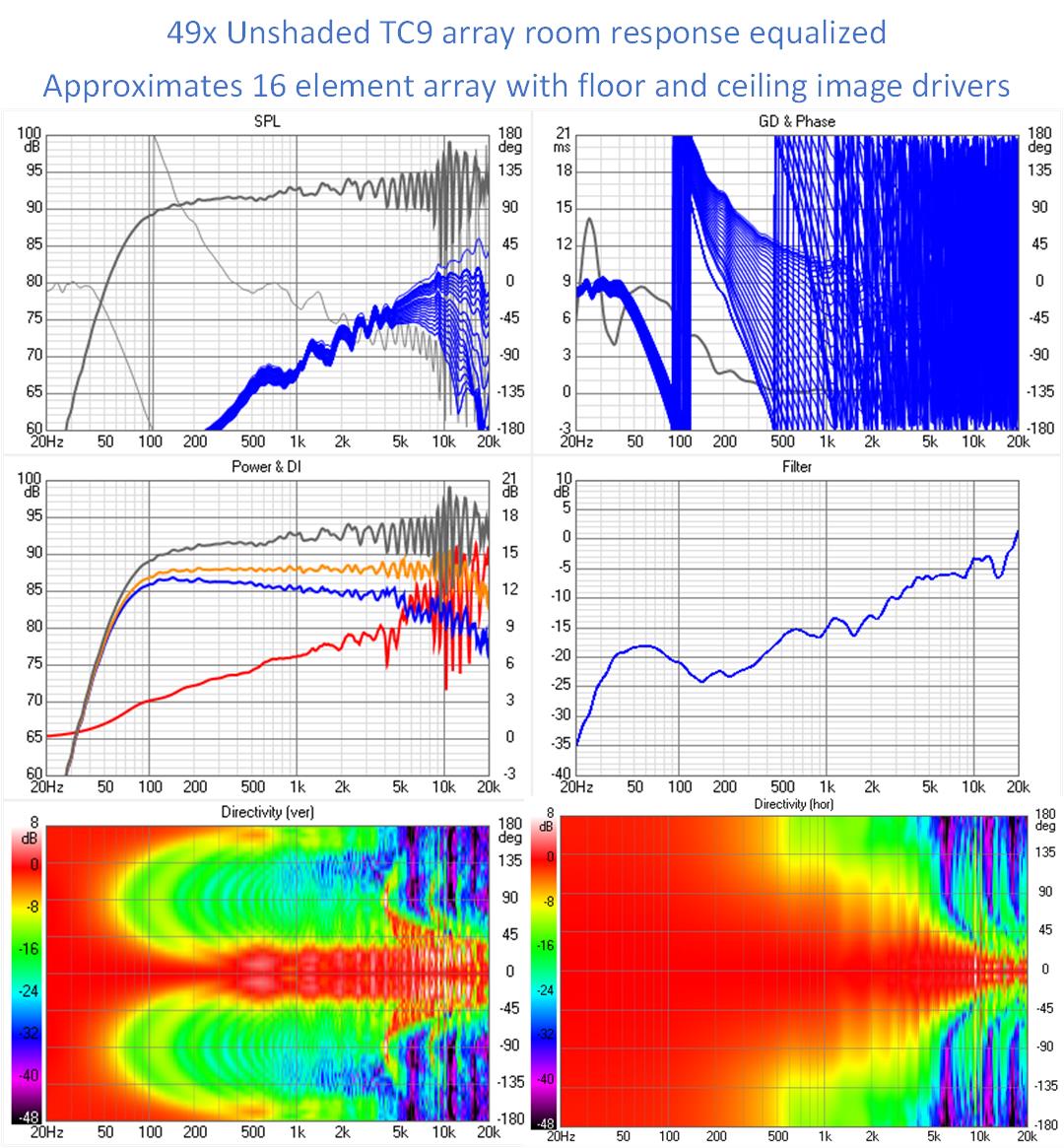

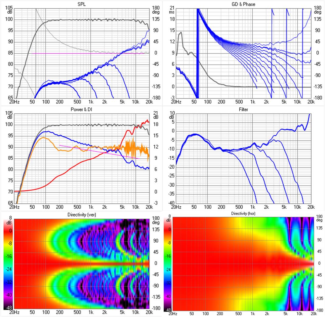

Vituix has a hard limit of 64 drivers. After being reminded of that, I tried a 21x3 element array. The response of that looked broken. I dropped 7 drivers off each end of the array and things started to look reasonable. Think of this array as a 16 element array with floor and ceiling image drivers (and one extra) in a low ceilinged space.

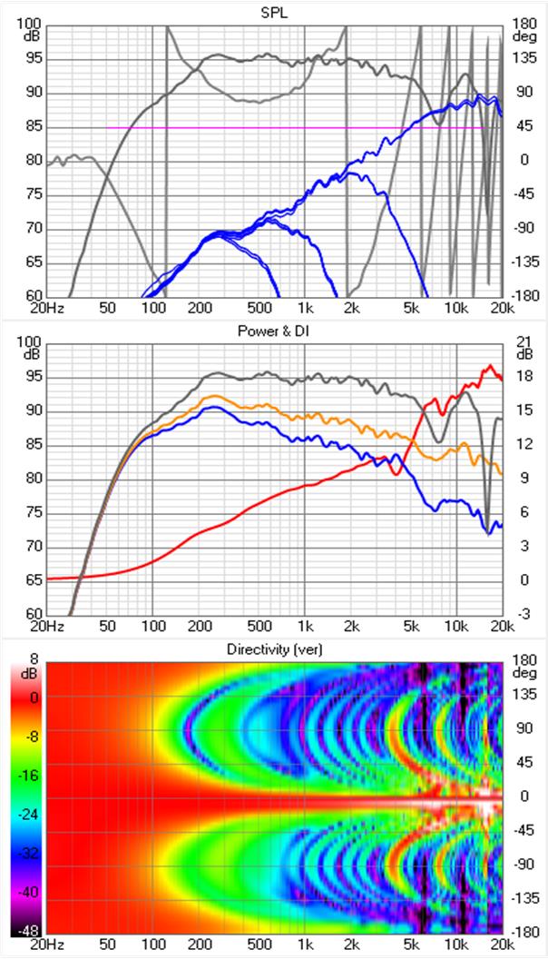

First the un-equalized array with a flat driver model (i.e. point source)

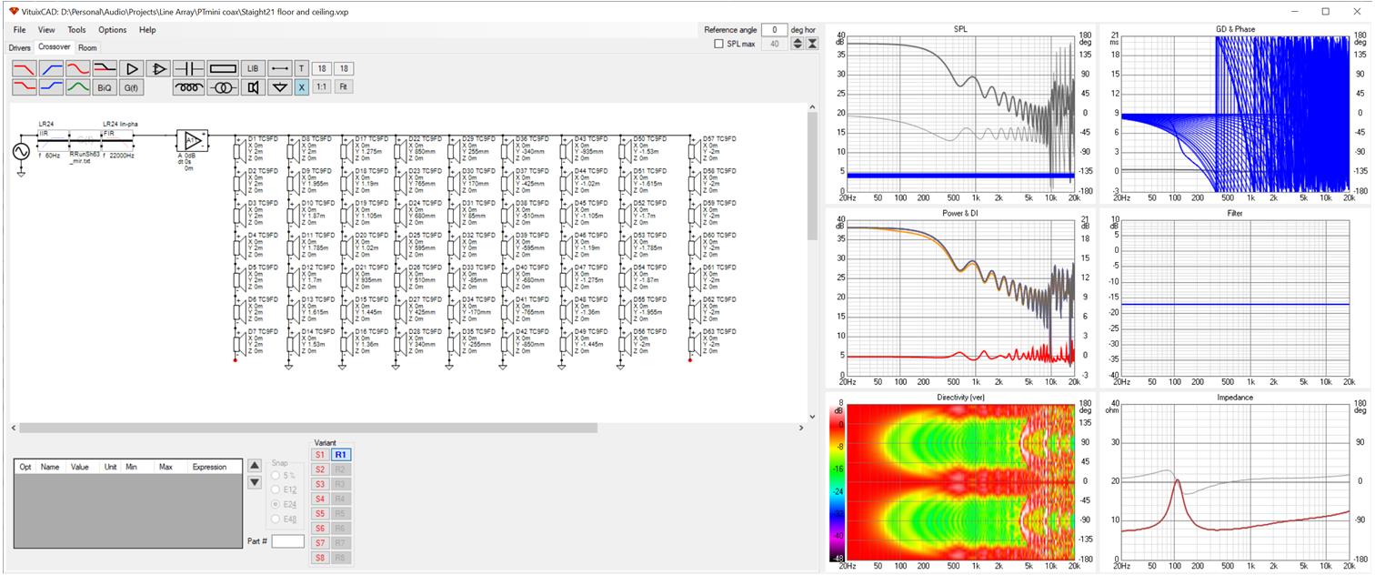

Plugging in the TC9 directivity data and equalizing to the 6th octave smoothed room response curve:
While these results look reasonable as far as they go, I've noticed undue sensitivity to microphone elevation and listening distance, which in no way corresponds to reality. Enough said for now.

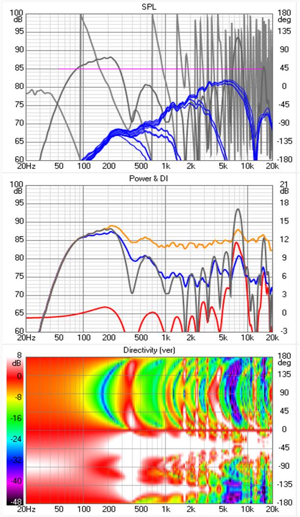

still using linear phase LR like beforeIn all honesty I think this FR plot is pretty close to reality. Did you apply some sort of absorption in the reflection properties? I'd believe we wouldn't get a true floor reflection but that it would be somewhat reduced in level. Not sure how much it would be reduced though.
Not sure why the vertical directivity is upside down from what I expected, but that may be due to the lengthened array with floor mirror? (missing the ceiling, thus having the symmetry (mid array) fall below the zero line)
What does it look like without floor reflection but with the 1m height position for equalising?
I think for a seated listening preference that shaded result looks pretty interesting too.
If one were to prefer a listening seat only setup it could prove to be worth investigating this further.

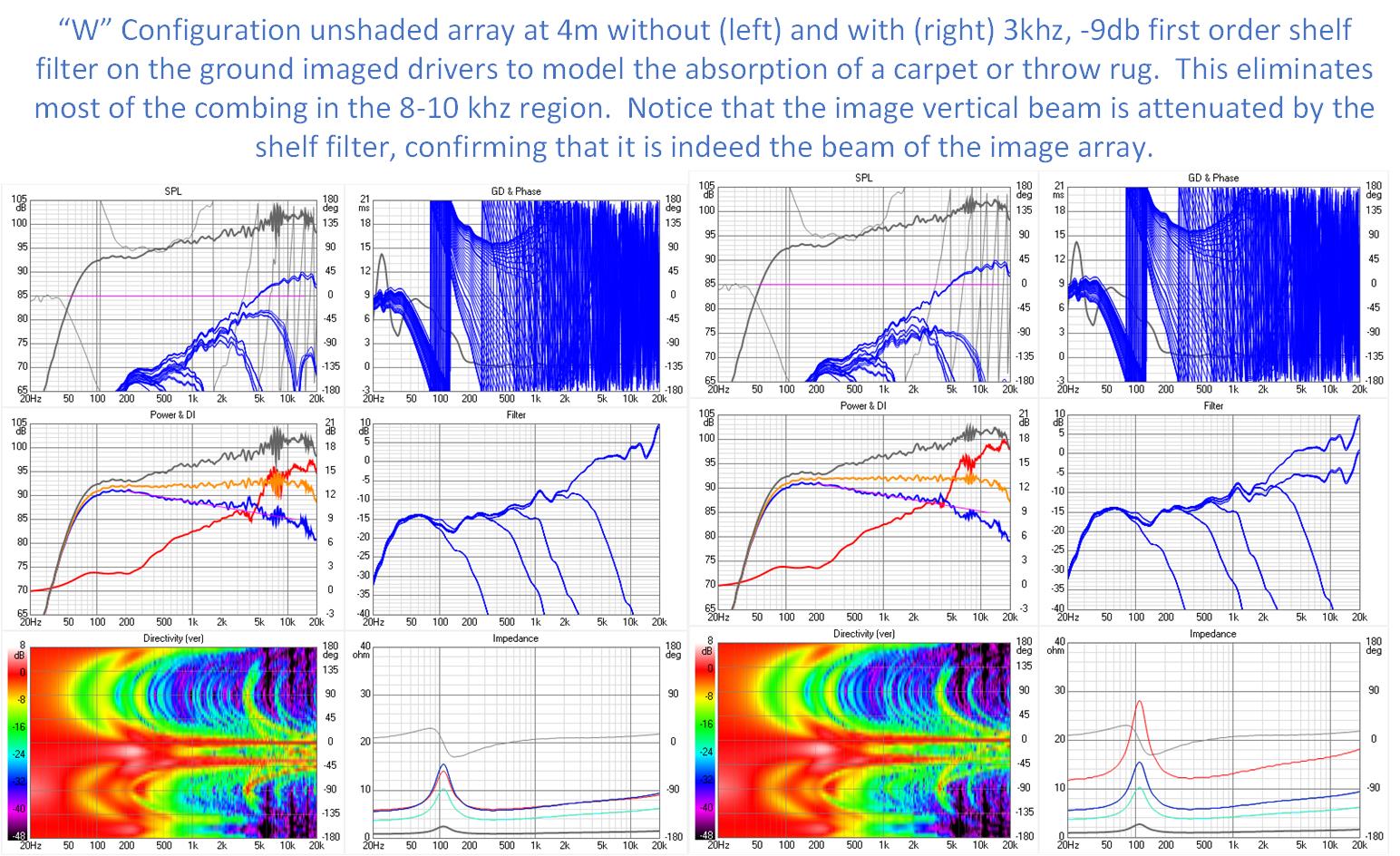

I redid the spreadsheet to include the floor image drivers and reduce the microphone height. Ignoring the floor reflections contribution, the spreadsheet shows the top driver can play up to 454 Hz without combining destructively but because of its floor reflection, it needs to be limited to 75 Hz. That is at 4m listening distance. At 2.7 meters the computed limit is 57 Hz. On 2nd thought, I don't think a recliner will help, what you (most of us) need is a bigger room! I will have to see how much destructive combing can be tolerated.
Its easy enough to model floor absorption with high shelf filters for the floor image drivers. The right kind of carpet will muffle floor reflections in the treble which is what is needed

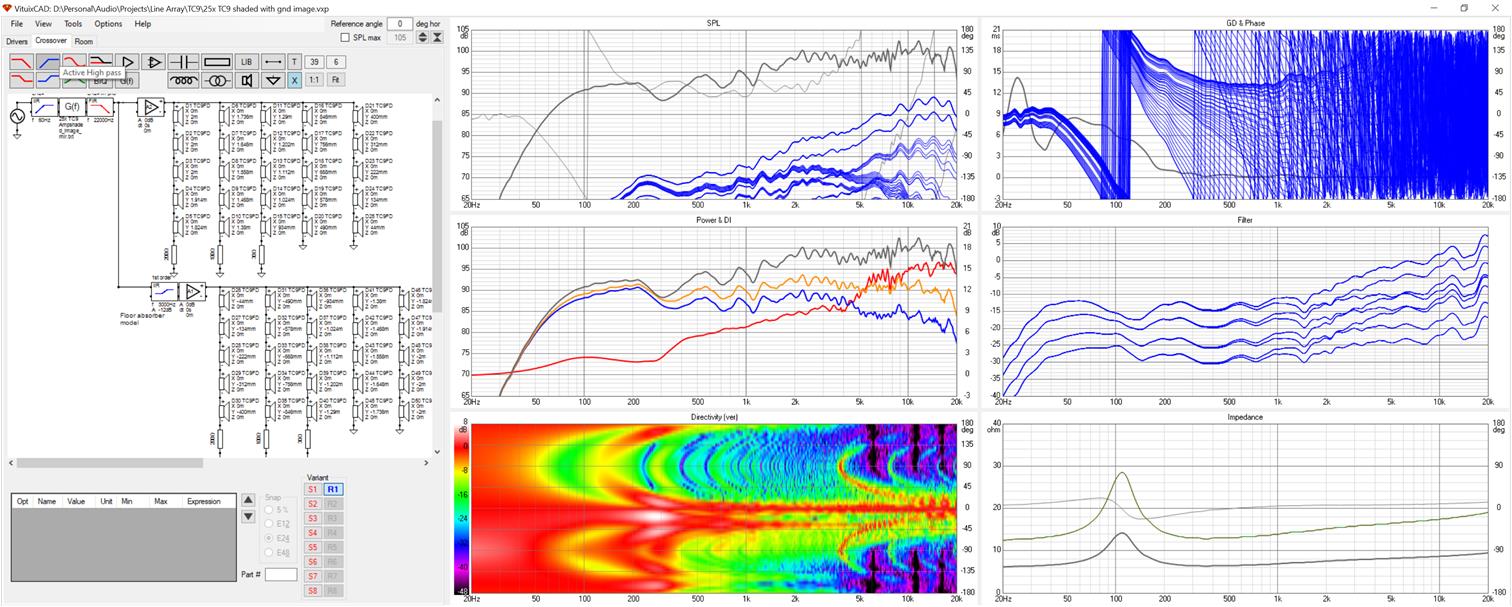

It was easy to create a frequency shaded array with ground image because my unshaded array with ground image simply had the shading filters shorted out.
Unshorting them I see something that appears to good to be true except for the polar map but there is an explanation for that. This array has a ground image and the mic is at the center of the primary image and well offcenter of the ground image array. Thus we get two beams, a real one and a virtual one that in reality is buried in the ground. Its not immediately obvious why that 2nd beam is at -45 degrees...If I set the mic offset to zero, we get a single beam.
This array is equalized to the orange room response which is nicely flat. The only reflection artifact is the combing between 8 and 10 khz. It will be interesting to see if modeling absorpton on the floor makes that go away. This is encouraging so I will go ahead and tune the simulation to match Wesayso's listening position.

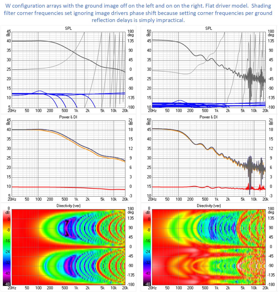

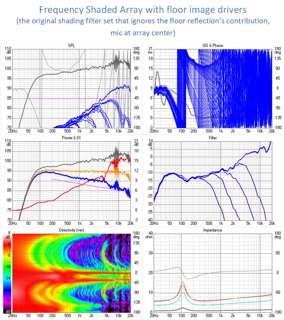

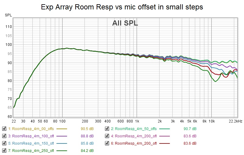

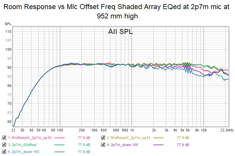

Now I have a model with ground image, first driver raised a bit above the floor to allow for cabinet bottom and feet and simulated and shaded for a mic height of 952mm, still at a listening distance of 4m.
Setting frequency shading corner frequencies to keep reflection relative phase shift below 90 or even 180 degrees turned out to be impossible - so I set them as i would for the same array without a floor reflection.
Comparing simulated equalization results we see the consequences of the imperfect shading are combing between 8-10 khz. Modeling the absorption of a carpet with a shelf filter that attenuates only the ground image above 3 khz by a max of 9 db, we find most of that combing is eliminated.

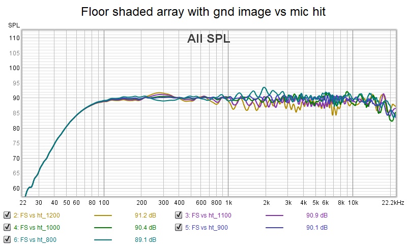

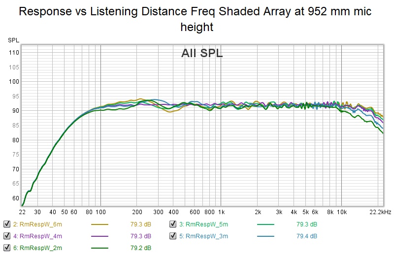

Here is the response vs microphone offset for the array with a listening distance of 2.7m. Its response also seems quite invariant with listening distance; there was only marginal improvement when I re-EQed for the shorter listening distance.
I noticed that Vituix is enforcing a +- 2m baffle height limit where this array configuration needs about 2.2m. The top 3 drivers were all given a Y value of 2m despite my best efforts. As these are only driven with low frequencies, I don't think it affects simulation accuracy at all. In fact, I disabled those drivers completely and all I lost was a little bass.

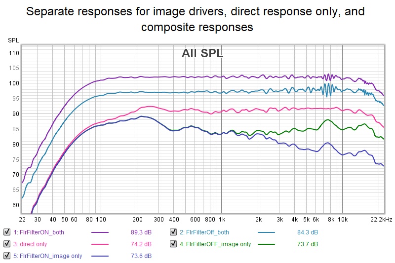

I thought it would be interesting to look at the image driver response at the LP separate from the dirrect response. I did this with the shelf filter that emulates a carpet or throw rug that provides up to 9 db of absorption in the treble both on and off. Combing levels in the treble are cut roughly in half with the filter in place. i don't see a reason for that peak in the image response at 7.5 Khz in any of the Vituix graphs.
The top two traces on the graph were raised 5 and 10 db respectively for visual separation. The direct and image only traces are at their original levels, with the image about -7db relative to direct.
I did this graph hoping to see a reason why the long delayed image response doesn't "hurt" the composite response more than it does. The only thing I see is that the image drivers sum to a relatively flat response, except for that 3 db peak at 7.5 khz, coincident with the combing.
