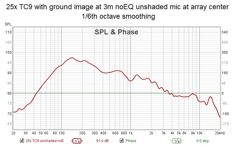

Yes Vituix does indeed predict the -3db per octave but you won't see it in every picture because the first thing I do is EQ it away. Look at the filter curves in middle right graph of those sets of 6 Vituix graphs. You'll see how much filter gain is needed to flatten the treble, among other things.
Vituix also will show the expected bass boost when you include a set of ground image drivers in the crossover schematic or when you enable floor and ceiling reflections in its room response tab.
Vituix breaks though when I include both floor and ceiling image drivers; in fact it cracks a little with just ground image drivers. Its limited to 64 drivers and a +2m to -2m tall baffle and near those limits it gets a little sluggish.

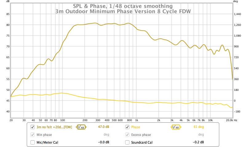

It was more where that ends and the shelf begins, like this outdoor measurementYes Vituix does indeed predict the -3db per octave but you won't see it in every picture because the first thing I do is EQ it away.
Nice measurement! Eliminating the room really cleans things up.
Here is the equivalent from Vituix. Its similar but not the same. Combing appears exaggerated in the sim for one thing but smoothed out here. REW won't let me FDW an imported test file so I smoothed it 1/6 octave. The sim drops further with frequency.
A big difference may be that the sim sums outputs from 25 identical drivers whereas the measurement sums and thereby averages outputs from 25 drivers with a random spread of response around the data sheet response

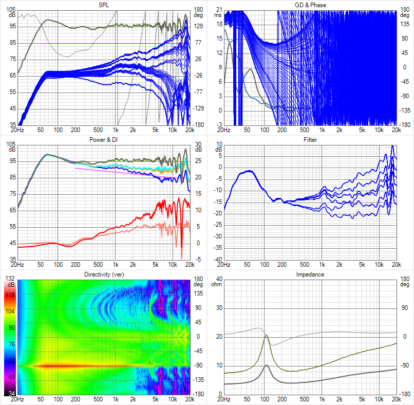

I'm joining the simulation fun (thanks to nc535) but I'm looking for other things
How do I keep the widest sweet spot possible while improving on an unshaded array. Here's a careful first result done with DRC-FIR and using averages of 4 different heights as the base for processing. No floor/ceiling image used here.
Standing will still get quite a reasonable listening curve.
Shading the bottom 5 by about 6 dB with a resistor and inductor, followed by 10 drivers unshaded, next group is again shaded ~6 dB with resistor bypassed by an inductor. Top 5 drivers cut off earlier.
The goal wasn't to avoid all combing here. but to possibly get better results with (simple) shading used on the drivers furthest from listening axis. Now I just need to repeat the whole process for an unshaded array. Heights, driver distances etc. are an exact copy of my array.

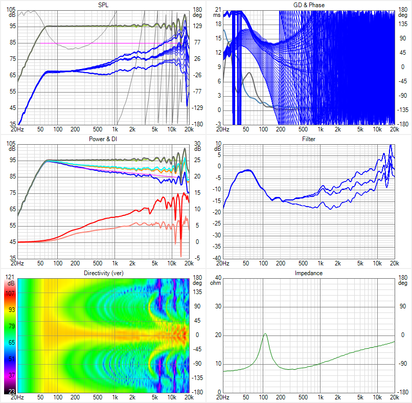

With floor image drivers active:

Very interesting and good work!
Everytime I pulled responses vs mic offset into REW, I had REW generate the average but I never bothered to put that average back into Vituix. I would expect equalizing to the listening window average that Vituix provides to be roughly equivalent, once you did the trig to set the listening window angle to provide the height you want at your listening distance.
I imagine most of that red/orange/yellow I see in the vertical polar plot top octave is due to the peaks and valley of the combing and not indicative of the variation absent the combing.

I got an explanation from Kimmosto this morning about why the vertical main beam moves down when the mic is moved up.
Its surprising to me how far down the main beam points in your ground image chart. -90 degrees is pointing at the floor!
the reason for change in polar map is that origin of the speaker i.e. listening axis changes when microphone offset is adjusted. It's usually very difficult and slow to adjust location of all driver instances in crossover to simulate just small X,Y changes in listening point. Much easiest is to change position of virtual mic/ear which kinda moves whole construction up-down and left-right from listener's point of view. So main beam of the speaker (usually) shoots below mic/ear i.e. to negative vertical angle when mic/ear is moved up, and so on.
