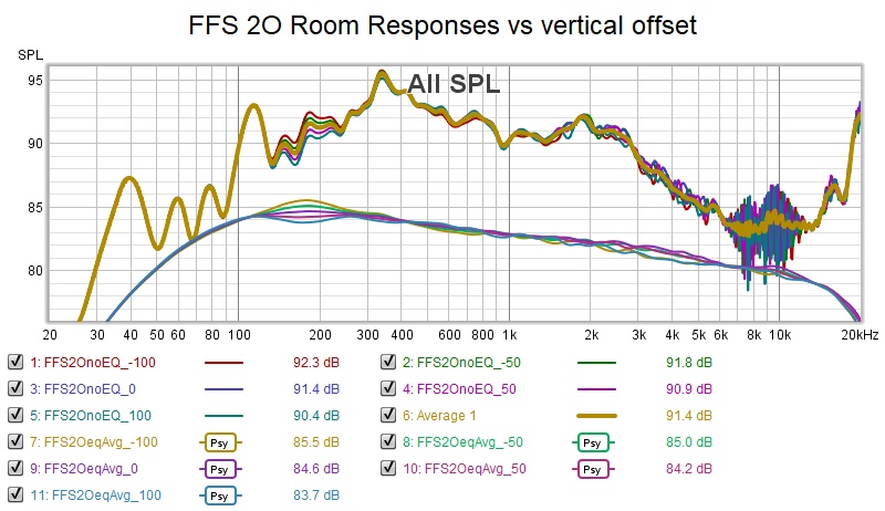

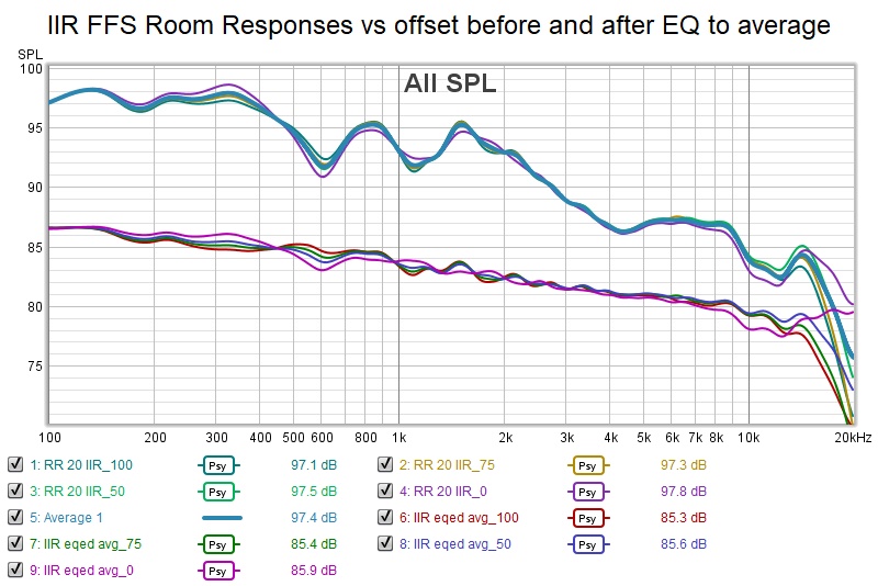

One little tweak. Not much to complain about here except for loss of treble off vertical axis above 15 khz where many of us can't hear anyway.
attachment.php

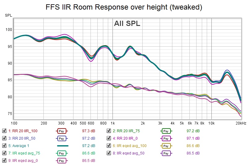

One more tweak evening out the top half octave.
attachment.php
I have to ask myself if I could do as well with the sharper lin phase filters. I think so. The improvement here is in the top half octave and amplitude weighting of the 5 central drivers and that would carry over. Treble does fall off after 15 khz but does so consistently over the window and so can be brought up.

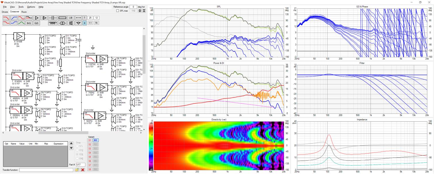

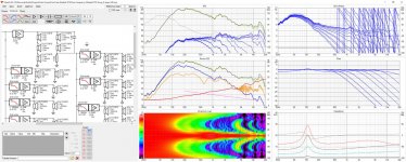

Here is a screenshot showing my shading on the central 5 drivers, the 2nd order IIR LPFs, the unequalized room response in orange and the vertical directivity, among other things.
attachment.php
The difference in LinPhase vs IIR is the upper mid bass dips in the room response that are filled via equalization; probably not deep enough to limit dynamics but something to be aware of.
With amp requirements down to 8 and an IIR solution outlined, the MiniDSP 4x10 becomes a candidate for implementation. If going that way, I would still do a global FIR EQ via JRiver.

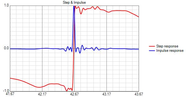

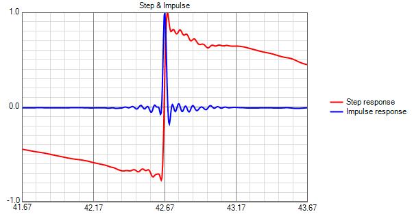

Found that the room response exports don't have any phase attached so I exported the axial response and went through Rephase and REW to get a phase correction, with this as the final impulse and step response
attachment.php

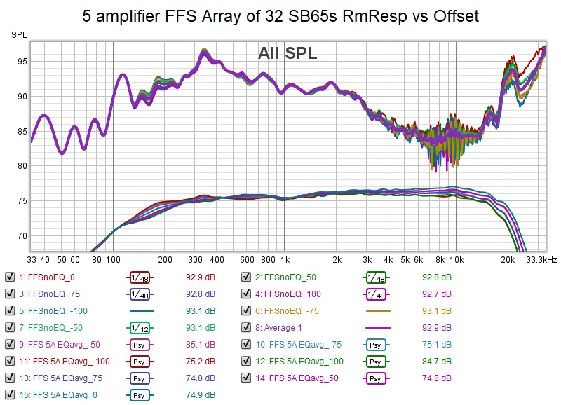

I turned my attention back to my own SB65 arrays this morning and I think its time to declare victory. My latest configuration requires only 5 amplifier and DSP channels per side, which I can do with hardware I already own and its response is within +/- 1 db over the +/- 100 mm vertical window centered on my seated ear height and what variation there is at the high end is effectively just a slight change in voicing.
attachment.php
The upper group is the unsmoothed unequalized responses which were averaged and then equalized to produce the lower group of traces. I don't have a room curve filter in place but if I did the slight rise in the treble would be come a slight variation with height of the falling slope of the treble.

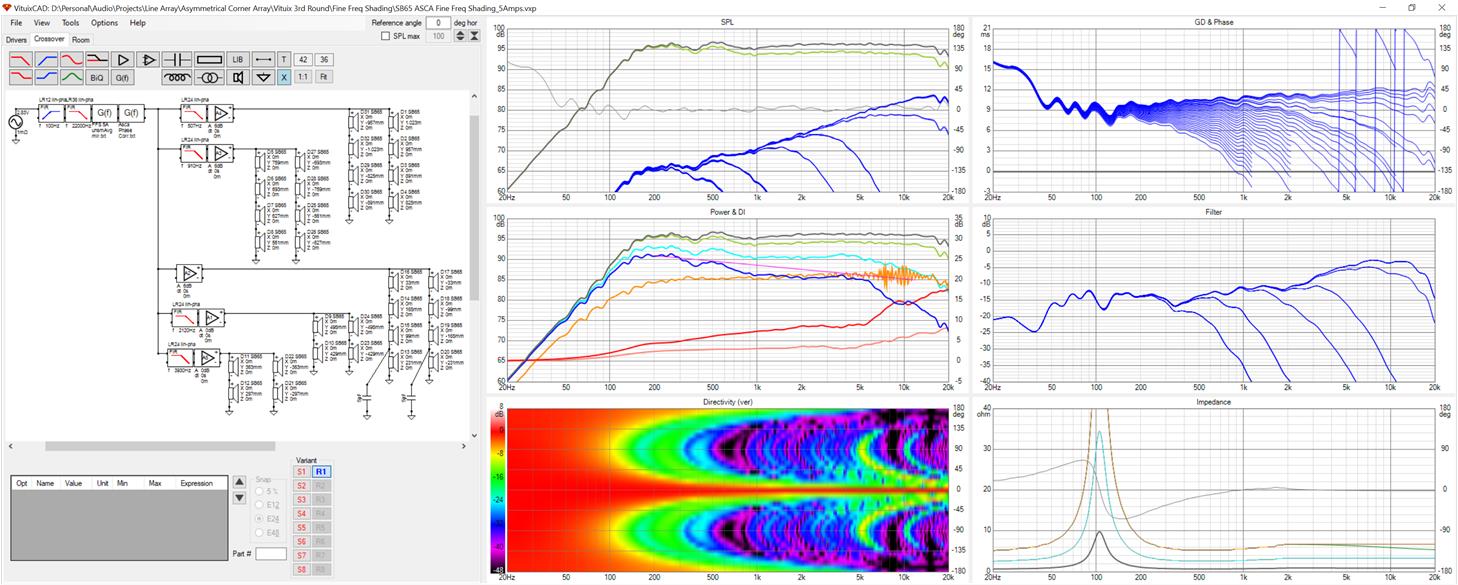

Here is a screenshot showing my amplifier configuration and filters. I've done this with linear phase filters because they work better than IIR and don't cost any extra when implemented in Jriver. Based on previous work, I'm sure IIR with 2nd order filters would work but with more variation.
attachment.php
Notice the two capacitors in the lower right corner of the schematic. These roll off the outer two drivers of the central 8 driver group with a corner near 10 khz for an incremental improvement in the top octave, saving an amp and DSP channel.

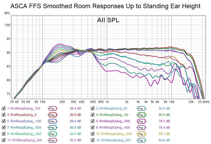

While the response is very good around my seated ear height its actually quite bad at standing ear height - about -560 mm offset
attachment.php
This is to be expected given the small number of drivers that are driven full range. The large drop with increased offset between 500 Hz and 1 khz is related to the low pass filter cutoff frequencys and vertical offsets at which they cut in. From the ends of the array working in, the filter cutoff frequencies are 507, 910, 2120 and 3930 Hz.

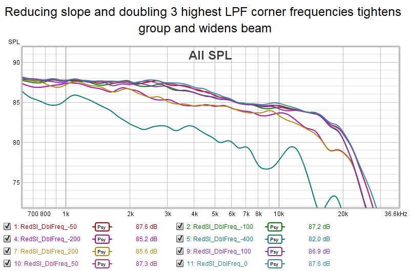

Was I really done? Of course not. Concern was expressed about the laser beam focus and that change in slopes with height might be perceptible. What was really needed was a gentler touch like Wesayso has in his passive shelf shading. I tried several things but what worked amazing well was reducing my filter slopes to 2nd order and the doubling the corner frequencies for the 3 groups of drivers closest to center.
Response within the original +/- 100 mm target window is within +/-.6 db!
attachment.php
I didn't re-eq to get this plot. I was in too much of a hurry to see how tight the group was - and that is what you should look for in the picture. The tight group at the top is the original +/- 100 mm window. The next two traces below are + and - 200mm. The outlier is -400mm; I didn't make it to standing height but I did achieve a tighter cluster near nominal ear height and slower degradation with movement away from it.
  • Reducing slope and doubling 3 highest LPF corner frequencies tightens group and widens beam.jpg

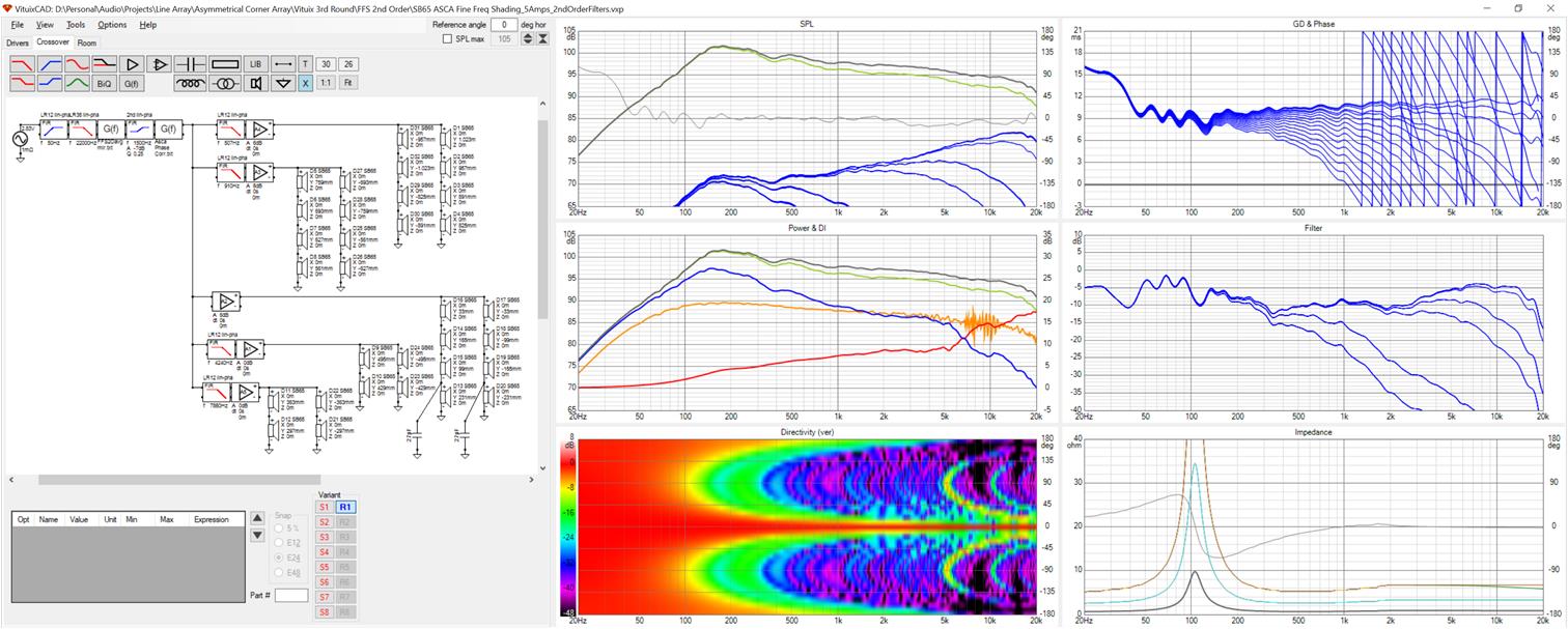

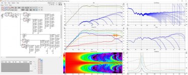

Here is a Vituix screenshot showing my wiring diagram and filter configuration. I see I misspoke earlier - all the filters are 2nd order. Corner frequencies for the 2 highest frequency filters were doubled from the calculated 90 degree phase shift frequencies.
attachment.php
There are 8 drivers in array center driven full range. Flanking them are two groups of 4 drivers and further out, two groups of 8 drivers. Furthest out drivers have the lowest filter corner frequencies now at 507, 910, 4240 and 7860 Hz.

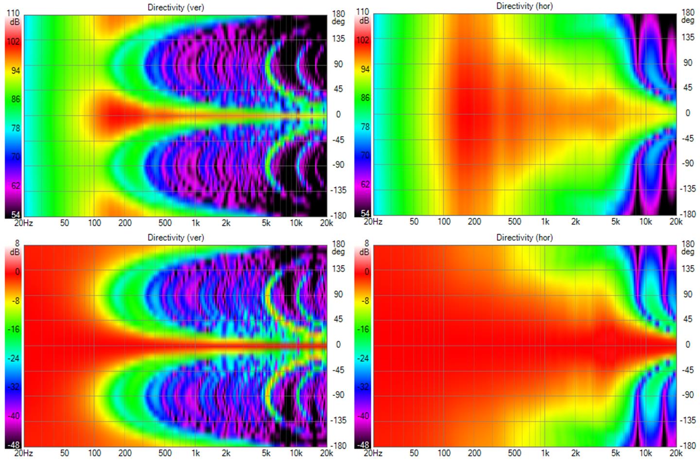

Here is directivity.
attachment.php
the fading away of the main beam un-normalized is just the room curve filter attenuation.

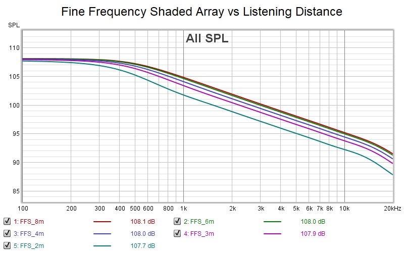

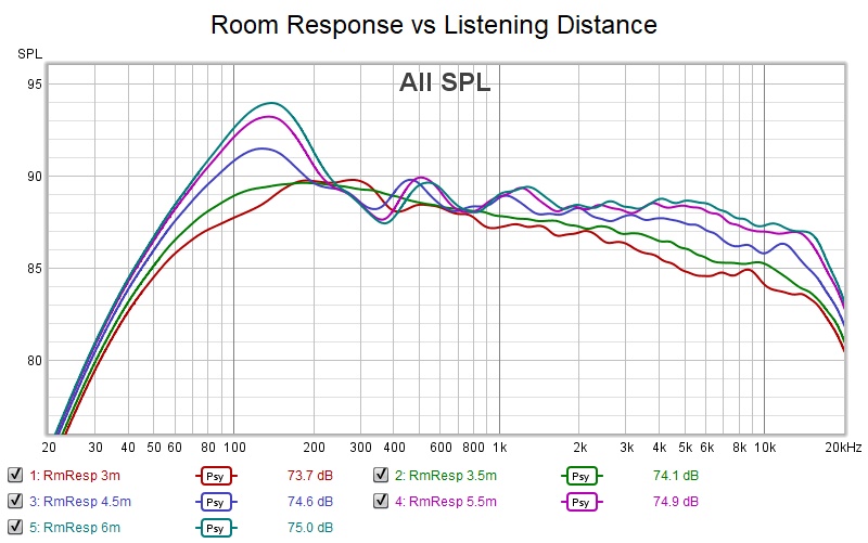

In the meantime, I checked response vs listening distance. The extravagant 11 amp+DSP channel solution was listening distance independent in that the slope of the roll off doesn't change, just the point at which it starts down.
attachment.php
(the graph is for 24 points at/near TC9 spacing with a lin phase 4th order LPF on each successive driver pair flanking center)
The practical 5 amp solution has a rolloff slope change with distance that makes a 3m equalization pretty bad at 6m
attachment.php
I may want to invest in a few more amp channels to be able to do better than this in case I every want to play in a larger room or at least rewire in such a way to preserve the option with patchcord like changes.

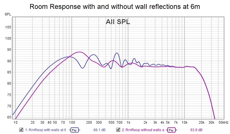

Here it is (the version with 5 amps, linphase 4th order filters) both with and without wall reflections. It is somewhat better.
attachment.php
Down around and below 200 Hz, the room is going to have its way with the shading algorithm...
