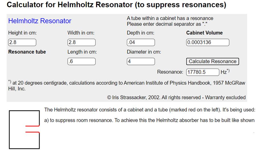

I talked myself into looking at helmholtz resonators.
I found this calculator
Helmholtz Resonator
These things are often used in large scale as bass traps. Scaled down, the block diagram looks like a bandpass cabinet where the cabinet volume is the air trapped between the driver cone and the horn wall
attachment.php
Its difficult to tune the resonator out of band. The closest I came is shown in the picture above. I set the volume assuming a volume plug is implemented on the horn wall to minimize air volume. I assumed a volume of driver SD times 2x linear Xmax. I assumed a tapered/frustrumed port with an effective length of .6 cm, and then adjusted the diameter. I was surprised that increasing the diameter increased the resonant frequency. I ended up with a diameter of 4 cm and resonance at ~18kHz This is not the direction I wanted to go!

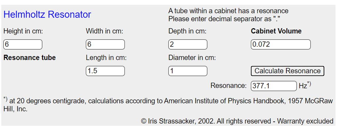

The next try was to get the resonance below the passband. I used cabinet area representative of TC9 instead of DMA45 and trapped a generous amount of air, set the dia. to 1cm and tuned the length to a resonance of 377Hz, just under 400 Hz XO (probably should have gone lower)
attachment.php
This represents a TC9 stood 2cm off the back of the horn wall with a 1cm diameter tube sticking back 1.5 cm into the trapped air volume. This is at least feasible. (but that doesn't mean its worth doing)

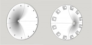

If it made mounting or positioning easier I have a slightly squashed rectangular version of the HF1440 round guide.
I'm not saying its easier (I've been feeling your pain 🙂)but so far I prefer the round one. I've brought it into Sketchup, extracted the profile and re-spun to create a wg that is easier to do CAD on. I thickened it, add flat back edge for recessed mounting in baffle, added a flat angled surface for mounting the DMA45s, and got them positioned. Next step will be "drilling" the port holes through the thickened waveguide.
attachment.php
The extracted profile is only piecewise continuous, thus the "construction lines.
I will try to mesh it after I get the holes in but that will be a first for me...

I think you are telling me that I need to cut the wg into a mouth section and a throat section so I can do the throat at higher resolution and you are telling me how to do it cleanly. The process may be different in Sketchup (Its solids have hidden geometry that you can unhide and use to make clean cuts.)but I get the idea and will work towards that. In the meantime I'm happy that Sketchup is only putting up token resistance to my efforts.
I went back to HR to compare my CAD of the bandpass to the simulation and to check the simulation itself. In doing that I found that 0.5 cm2 port area was sufficient for 106 db total SPL in Vituix. So I'm going back through the CAD loop to implement the smaller hole and the shallow bandpass chamber, really just enough to accomodate the half round suspension + 1mm
attachment.php
The new BP chamber has a volume of 8 cm2 x .3 cm deep and a port dia of 8mm by 0.65mm long. This has a helmholtz resonance of 2223 Hz. Looking at port diameter in relation to the full waveguide, its hard to believe that either the hole or the resonance will have a great effect; but we shall see.
