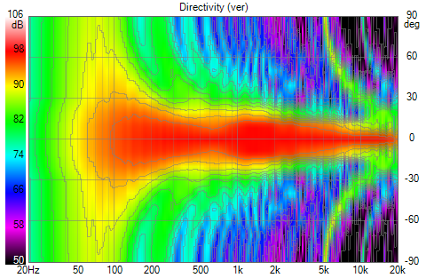

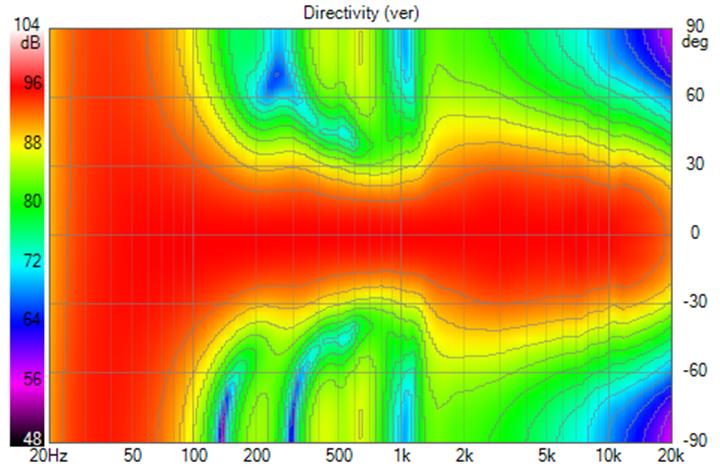

I did some tweaking and got this un-normalized V polar plot for all drivers except the CD. The sidebands are gone but the first pair of rows of 5" drivers are just outside the rim of the waveguide. You have the seeming redundancy of arrays just inside and just outside but that is apparently what it takes to get a sidelobe free pattern
attachment.php

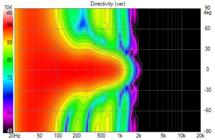

turning on the CD
attachment.php
we see the intentionally narrowed pattern below 1.2 khz

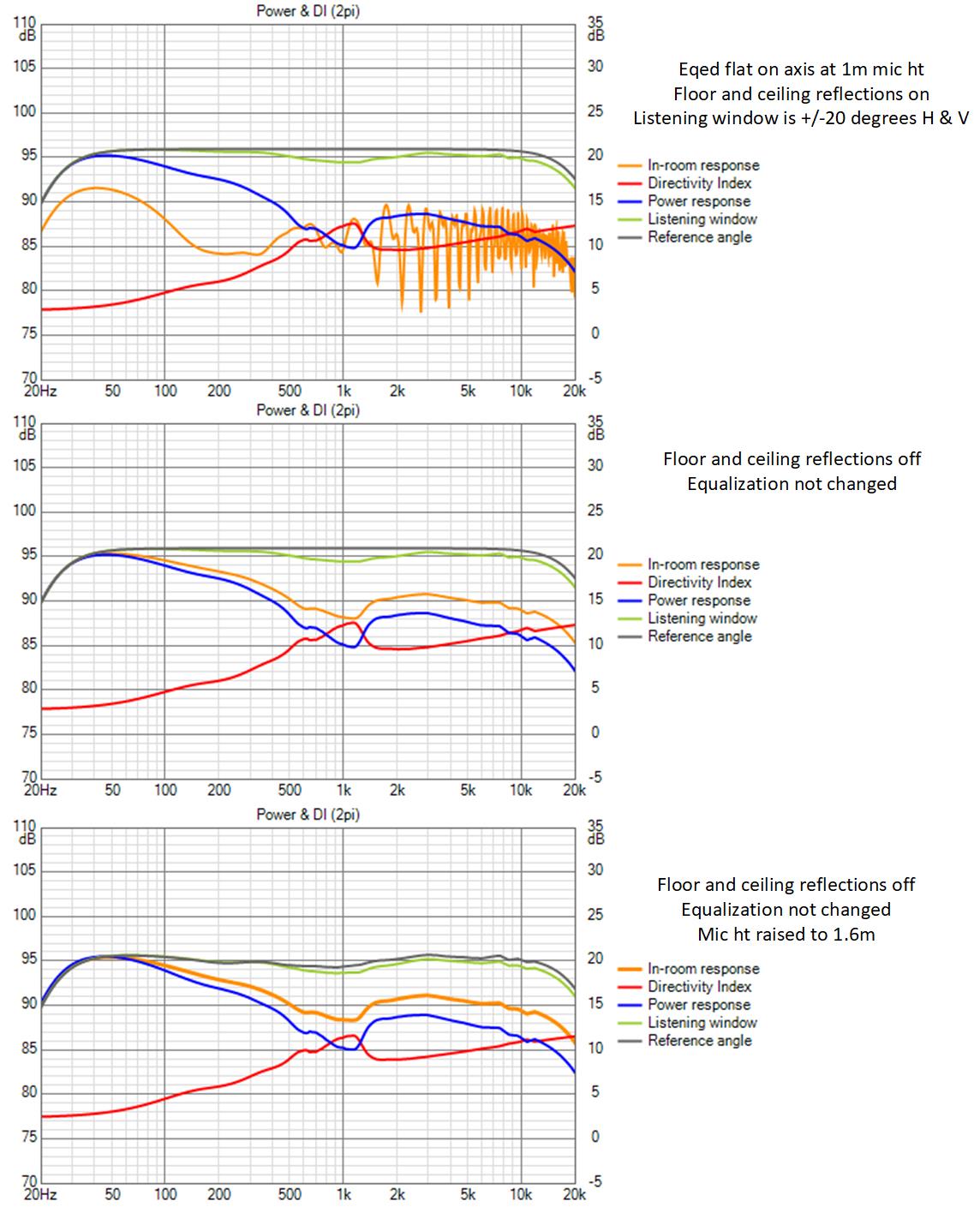

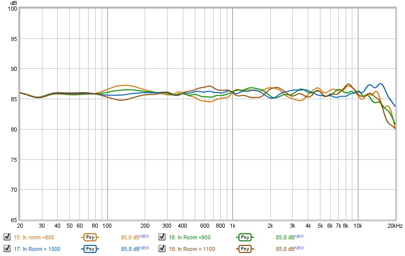

this yields these room responses vs height which are a little better than before, especially as standing height is approached
attachment.php
I think to get better than this above 1 khz a waveguide with a narrower vertical pattern is needed. (perhaps I can extend the narrowed vertical a little higher...)

Is this a 3 or 4 way solution? It looks like plus/minus 2 dB over that 30 cm window.
The horizontal window will be pretty controlled to? Hopefully a less narrowing waist below the horn. Probably less of an issue for you (theoretically speaking) as this is planned to go into a corner, should you be willing build it, right? It's still just an exercise.
For comparison I plotted my array + filters over the same 30 cm, I get a hair over plus/minus 1 dB, but no where near as nice top end behavior. Still impressive for the simplicity of the concept.
(and the minimal use of floor space to get it)
attachment.php
This is with the 2 dB absorption on floor/ceiling and psy smoothing. I did have to re-EQ and used the average of these 4 for a quick fix, but it does make it look better as a bundle 🙂.

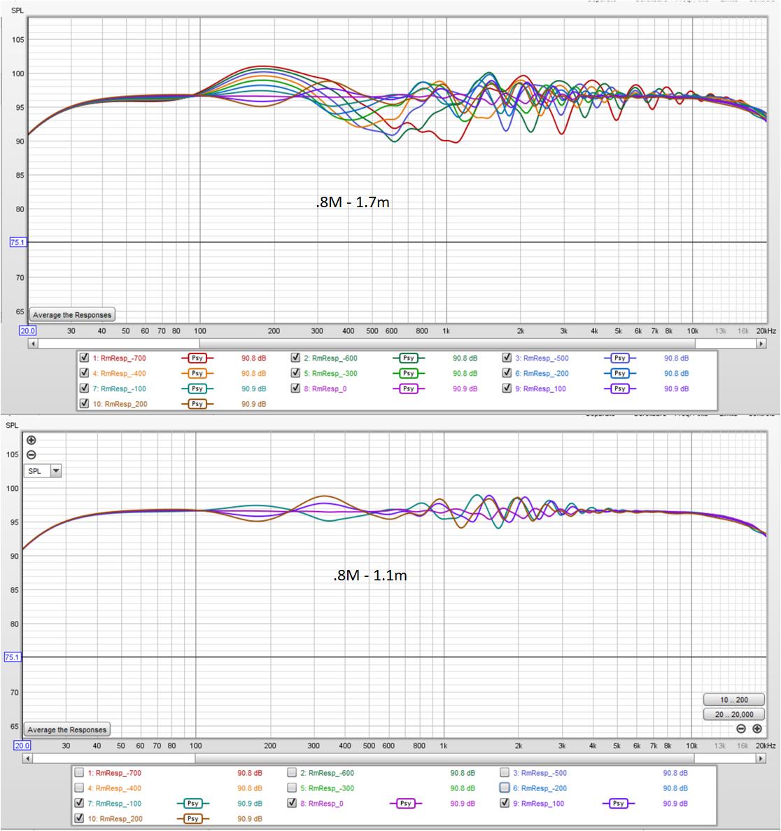

we prize Synergy because its crossovers hold together over the entire pattern window. What we really need mostly is for the crossovers to hold together for at least sitting to standing height variation. I show that here by equalizing with floor and ceiling reflections on, then turning them off, then comparing room response sitting vs standing. I don't see any change
attachment.php
For the most part a synergy will act as if it were a single driver. But even single drivers in a room will have variation in it's output depending on in-room position.
But your work here proved that my notion that I've often mentioned, a synergy in an array, is not all that easy to accomplish. Though I still think it would be easier for a synergy that reaches low enough, to actually be part of the low frequency array.
But that would have to be a true synergy with big holes to make it to those low notes.
(disclaimer; I still see your horn with an array of rim drivers within that horn as a variation on the synergy/unity theme 😉, otherwise known as a multiple entry horn)
Yes, what I've done is an MEH and intentionally not a Synergy and its got compelling benefits without needing large holes in the throat, which is what I wanted to see.

If the sole criterion is minimal vertical variation, then shaded floor to ceiling line arrays are better. that better high frequency behavior is something you've been interested in; whether it would be preferred in a double blind listening test is another question; one we likely will never answer.
Its certainly would not be easy to build and test the array I just simulated. I would work on simplifying it first myself. I would design a waveguide for a 1" exit (BMS4550) driver since I only need it to play 1 khz up and augment it with only 6 1.5" drivers inside the rim since they only play 500 Hz up. Outside the array I think passively shaded line arrays extending to floor and ceiling (like Crumboo is doing) would be ideal; two columns to control horizontal directivity.
But that is way too much work; I think I'd be satisfied rewiring my arrays for coarse frequency shading. Now that I have somewhat of a handle on abec, I can think about developing a line array horn for horizontal pattern control. It would be nice to have a line array that didn't need padding on the nearby walls.

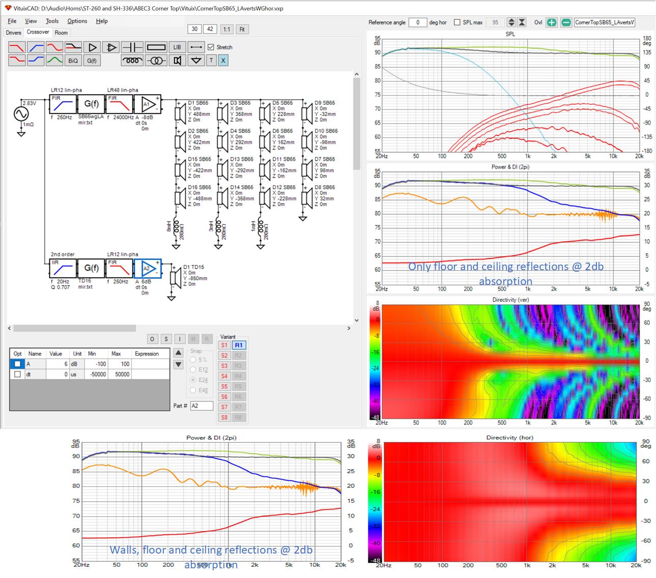

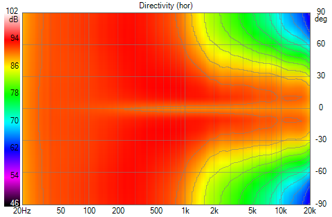

Yesterday it occurred to me that in Vituix, one could combine a vertical directivity file from a line array simulation with a horizontal directivity file from a waveguide simulation and get some idea of the waveguided line array's performance in room. This turned out to be pretty easy to do and has a startling result, which I will get to.
I never noticed before but Vituix can export polar frequency response files, like ABEC/VACS. I equalized a single SB65 and waveguide Vituix sims flat on axis, adjusted them to the same SPL, exported their polar responses. Cut and pasted them into a waveguide-H, line array-V directivity directory and did another Vituix simulation.
attachment.php
This simulation is of a short 4' tall 16 driver array sitting on top of a 15" woofer, with a quick, imperfect passive shading. This waveguide isn't loog enough to eliminate the floor so I'll likely go back to a floor to ceiling array.
Its not surprising that its showing me the horizontal directivity of a waveguide with the vertical directivity of the short line array as those are the input conditions (GIGO). What is surprising is that there is no visible difference between room responses with wall reflections enabled vs disabled - even below the frequency where the waveguide has lost vertical pattern control.
A real line array waveguide with this directivity would be so easy to integrate in a room. I'm anxious to see what ABEC has to say about it but so far ABEC isn't talking.

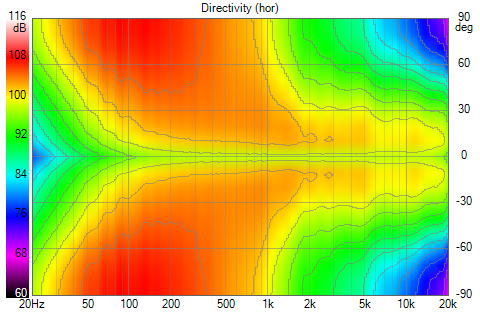

the un-normalized polar map shows about a 3 db dip on axis, which is consistent with the listening window response shape
attachment.php
I used fluid's blended108circ waveguide for the horizontal directivity. Interestingly, it doesn't have that dip. Ultimately, I want a rolled back edge waveguide for this purpose.

Here are the un-normalized polars for my full 32 driver floor to ceiling array unnassisted by a woofer, using the waveguide horizontal directivity
the vertical directivity is nicer:

That is a good point. You have to be careful whether you've generated directivity out to 180 degrees or just 90. These were just 90 because polar map exported directivity is limited to +- 90 degrees
Definitely a problem shown. Whether its a simulation artifact due to cheating on the directivity or to the lack of the baffle the waveguide was intended to work with or to the approach itself is TBD. I think the dip is the same on-axis dip you can get in an axisymmetric waveguide. My abec simulation is of a rolled back edge waveguide which should not have the reflection/diffraction that causes such a dip but that simulation is into its 30th hour and still only indicating 79%
