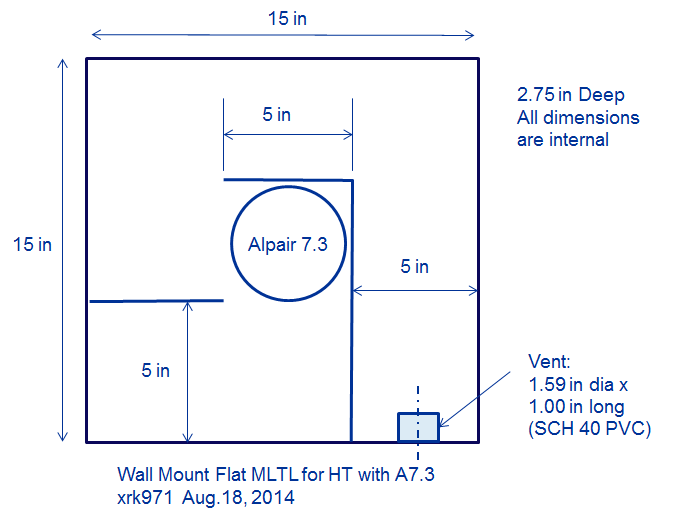

Design for Flat Wall Mount MLTL for A7.3
Here is a design that can reach 102dB with flat extension to 80Hz. It is a 15x15in "pizza box" shaped speaker with 2.75in depth. Use 1.5in dia SCH40 PVC pipe for the vent. Since it is wall mount, there is no baffle step correction needed. Use with a second order -12dB/oct high pass filter at 120Hz to prevent cone over excursion.
Use polyfill stuffing from closed end to just past driver.

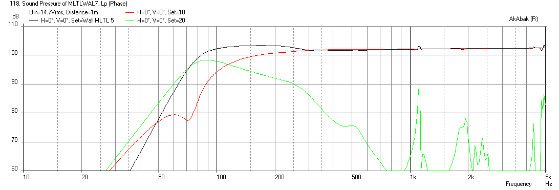

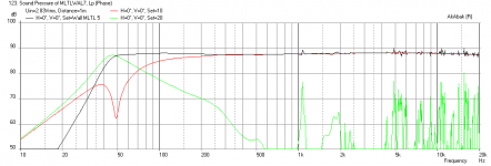

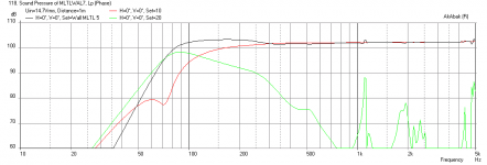

Freq response at xmax (with 120 Hz -12dB HPF):

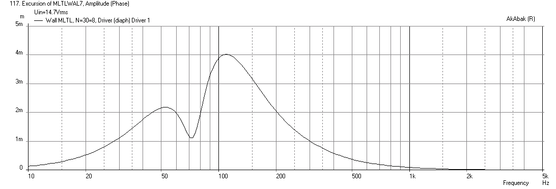

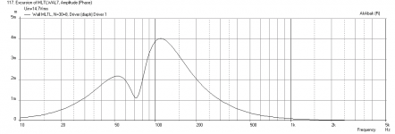

Cone excursion at 13.7 volts for xmax:

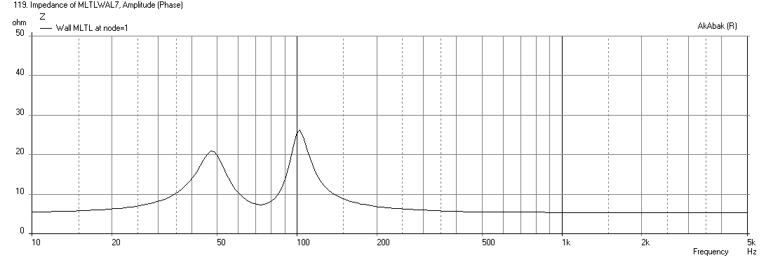

Impedance:

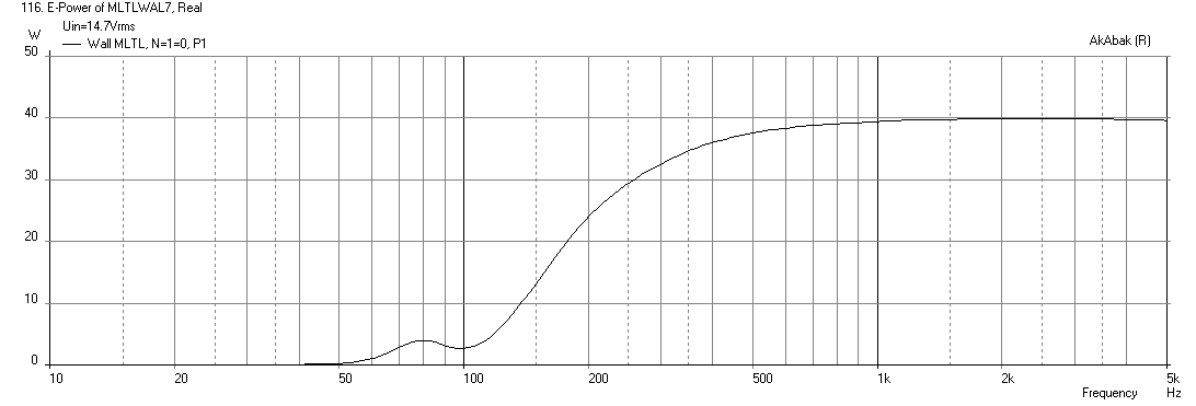

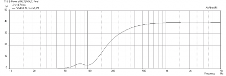

Electrical Power at xmax:

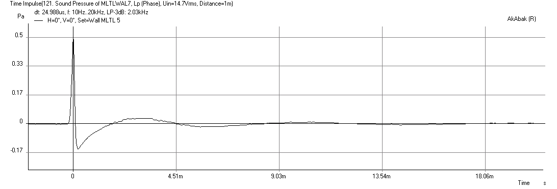

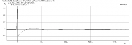

Impulse Response:

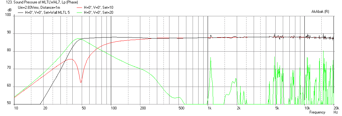

And by the way, if you make the vent 4 in long and remove the HPF, you can use this as a fullrange speaker but at lower SPL's and get some pretty good bass extension to 45Hz:

You wanted a wall mount so I made it thin. This lends itself to a MLTL. A bass reflex will not sound as nice and not load the cone as well. Yes, Mark Audio Alpair 7.3. I picked it because it has one of the larger xmax (4mm) for a 4in driver. You need that xmax to get 101dB at 80Hz if your driver is 85dB sensitive. A CHR70 cost less and works very similar but will not get to 101dB before running out of xmax. You can attach this out to a long 45in tall flat stick and it will behave almost the same.

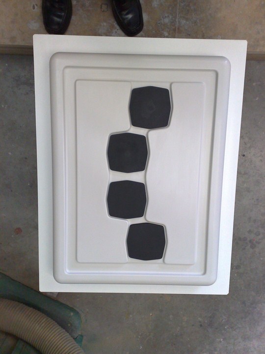

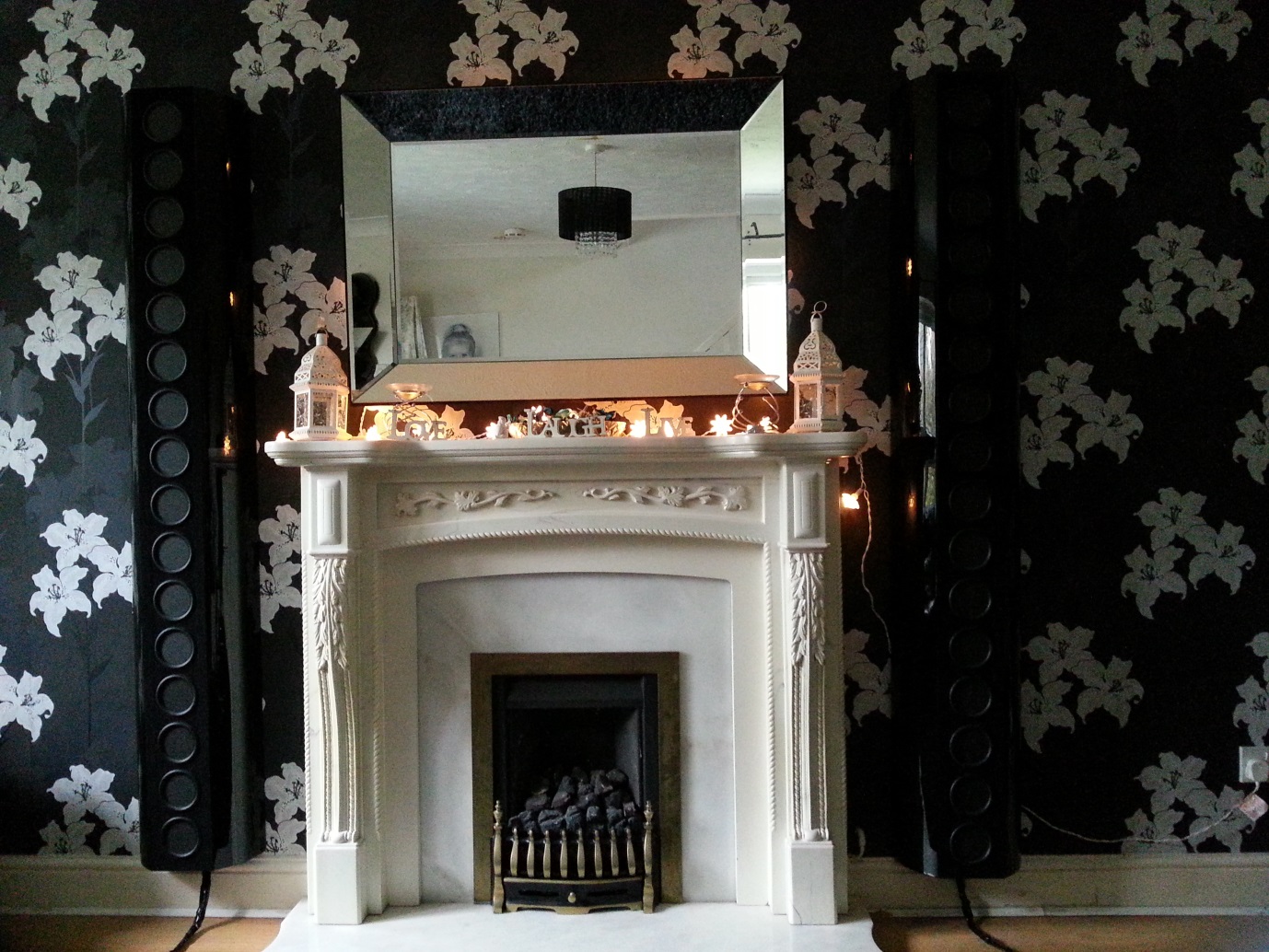

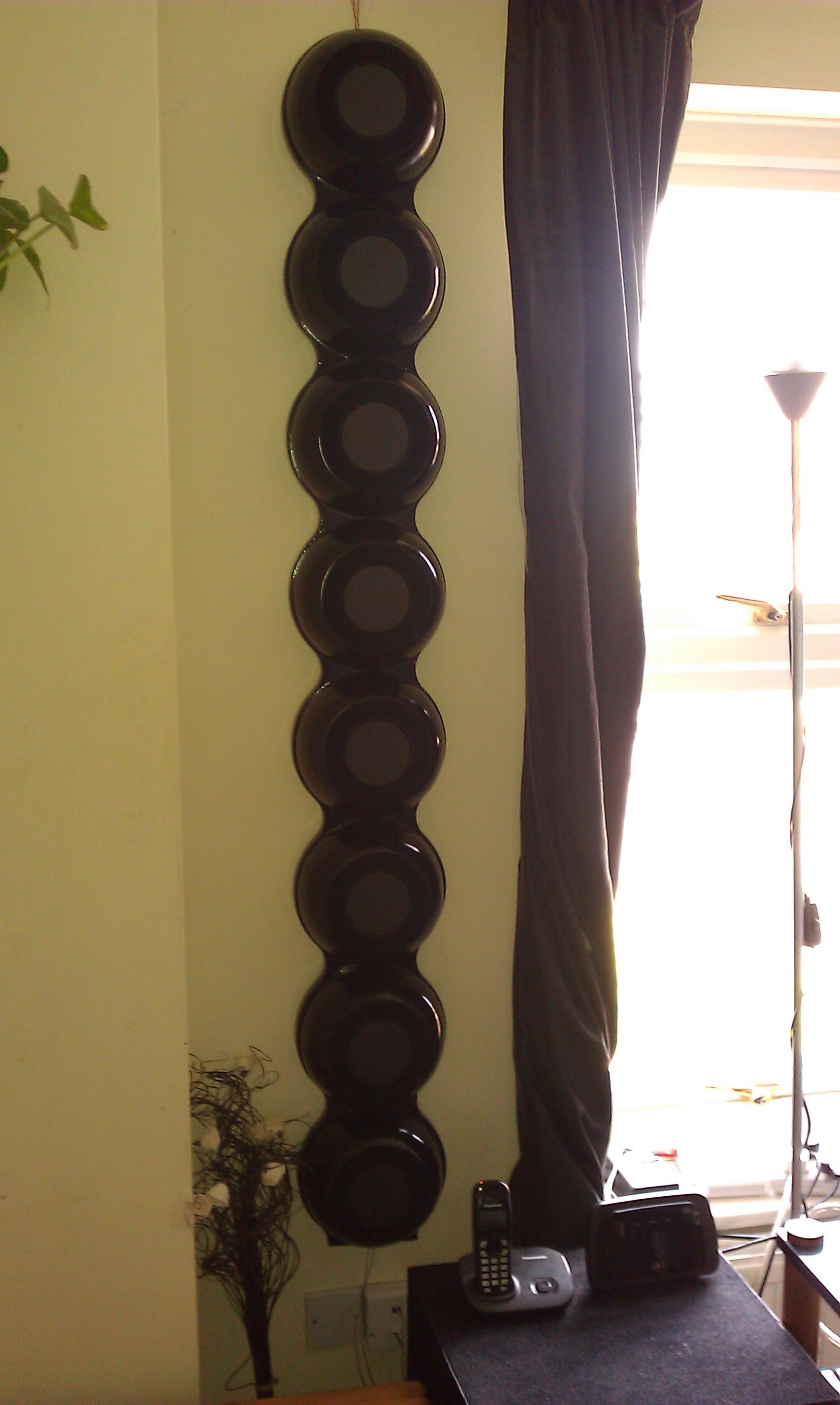

On or in wall line array
Hi Spekr,
My Overkill Audio designs from a decade ago are not relevant to the modern world...Massive, heavy, expensive, complex and amazing sound....Geeks loved them the real world dont!
You hit the nail on the head, you are looking for the same solution as 95% of all middle to high income folks....Great sounding low profile on-wall or in-wall AV solutions.
I have posted a lot of info and pictures over the last few years on this site so if you trawl back over my posts you will find a lot of good info on how I believe it should be done. Disclaimer...Many disagree with me on this site....They are all wrong!
I will have some cool " Bamboo and BMR" DIY kits available in December
(depending on shipping from China) and the attached should help to explain a bit more about the advantages of on wall BMR loudspeakers.
My website wont be ready until November but I have put up some "sneak previews" here CustomInstallAudio
I don't think there is any USA distribution for the good audiophile BMR's ( ignore the Parts Express BMR's.....Only TV screen audio grade) so it may be a non starter for you at the moment. But its still an interesting subject.
Hope this helps and all the best
Derek.
