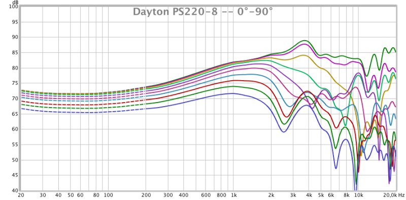

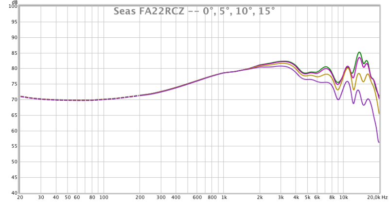

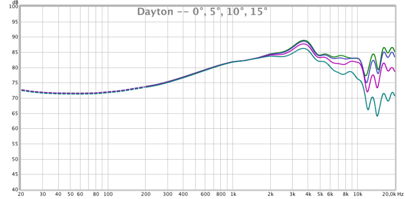

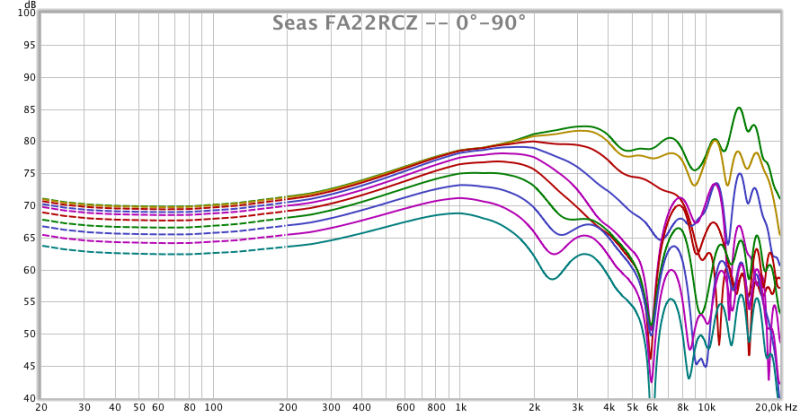

The driver arrived. I had also ordered a Seas FA22RCZ. Here're some measurements of each driver in a 48l test box. Impulse response window is 4ms.
The Dayton looks great. The only flaw seems to be the dip at 11.5kHz. Any thoughts?
