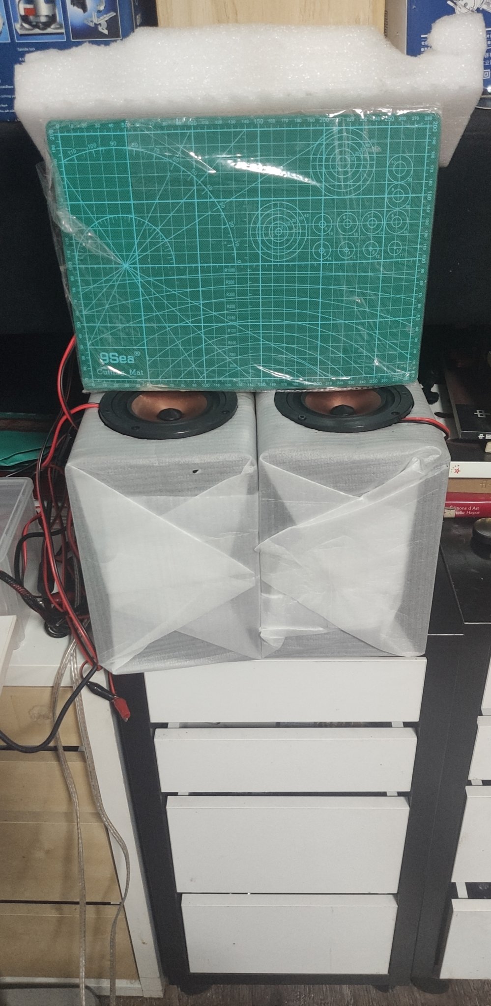

Yes of course, for the pictured tetrahedral speakers, the benefit of the shape would be one less corner for the baffle compared to rectangular, wouldn't this mean less equal distances from a centered driver and thus less pronounced baffle gain for the frequencies whose wavelengths correspond to those equal lengths?That makes sense, but weren’t we talking about the outside.
And no cabinet reflections frontwards from the "side walls" as they're really back walls.

I've seen similar speakers online, but never had a chance to listen to one.I meant that the tetrahedron has the least kinks in its pattern overall. While the EM dodecahedron is really smooth at 2kHz, it becomes really shaped at 4kHz. The tetrahedron is on average closest to spherical.

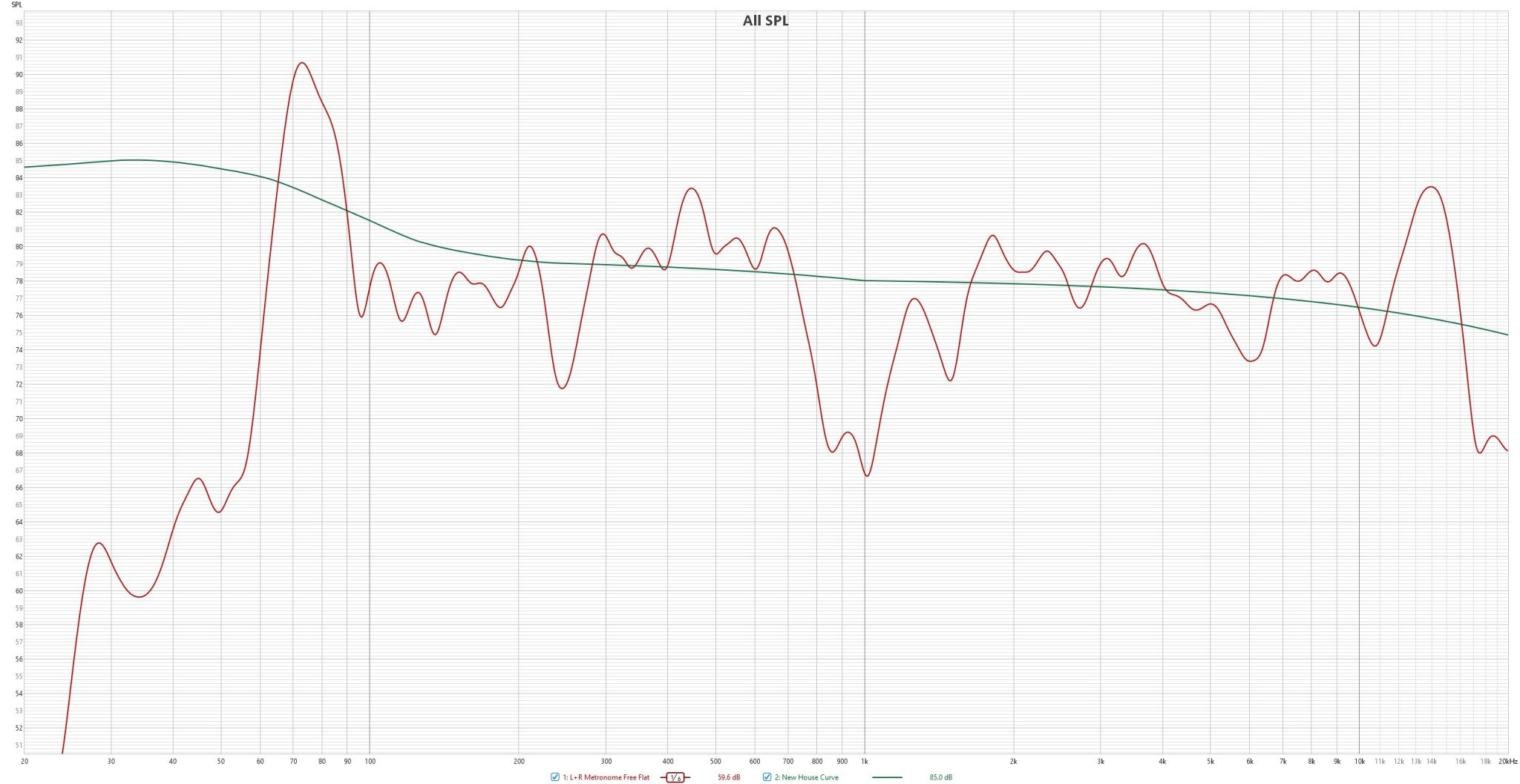

I built a new pair of full range Metronomes (quarter wave quadratic transmission lines) using Fostex FE108EΣ drivers and 18mm Baltic birch; I have to wait for warmer weather to finish two recent builds. I intend to use them as surrounds in my music theater but I tested them up front alone too. I like this driver and have used it in two other pairs of "Onkens" in the system. This system is now all on EΣs. The Mets perform well and don't seem to display as much baffle diffraction step "loss" as I'd expected... even in free space. There's "always" a 1KHz dip with these drivers. The full build process is described HERE if there's interest.

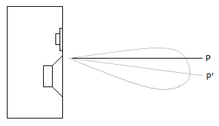

Does anyone know from listening tests what influence of lobing has in practice?
Stand up, sit down. Move side to side, forward & backward will not likely be an issue until you get close.
A lobe starts to develop when the difference in distance from the ear to each of the drivers starts to exceed a quarter-wavelength.
Includes the math and more detail: https://audiojudgement.com/speaker-lobing-polar-response/
In a 2-way speaker this is the general idea. (in theoretical plane on axis.
With 2 FR speakers running FR you don’t have an XO keeping the HF output of one interefering with the other. Below a quarter-wavelength they act as a single unit, as the disatnce increases the combing gets worse (as frequencies go up and and wavelength get shorter).
Here is a conbing diagram (from Taylor) with 4 drivers. As frequencies go down they disappear, as frequecy increases they get worse.

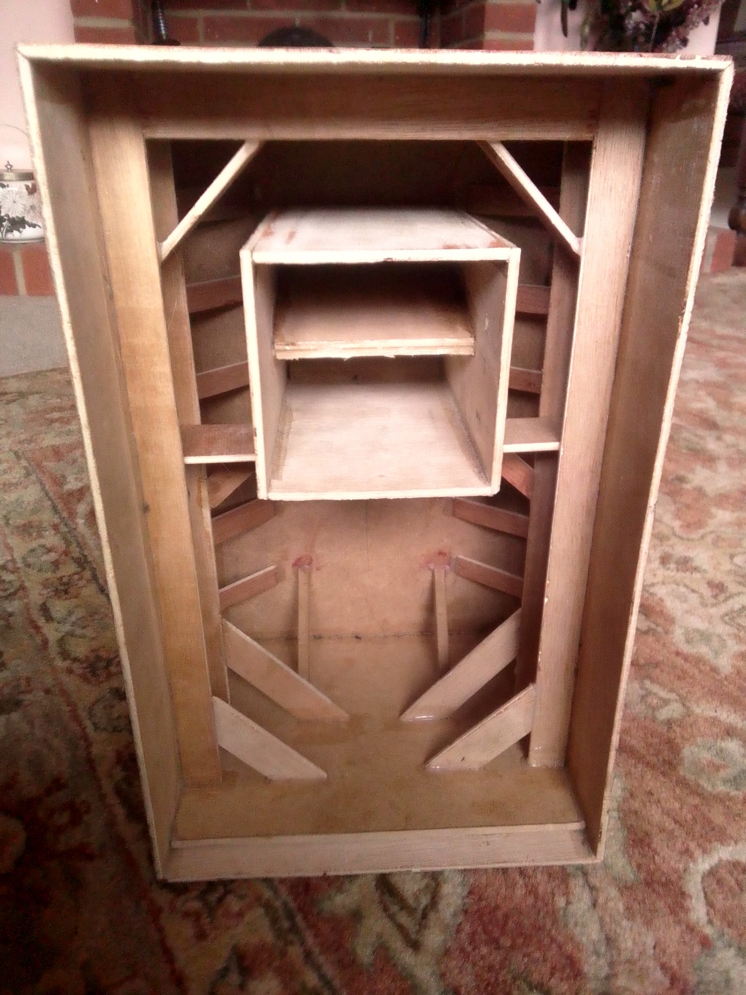

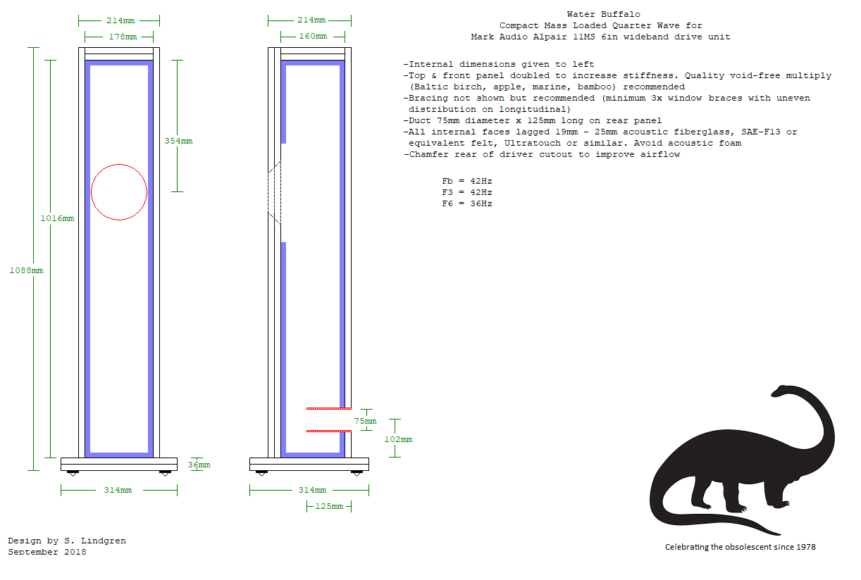

For the Water Buffalo project , how did u manage the back port. I am not getting a ready port with same dimensions.... i.e 75mm by 125 mm, is there a way around this ,,,View attachment 1214575

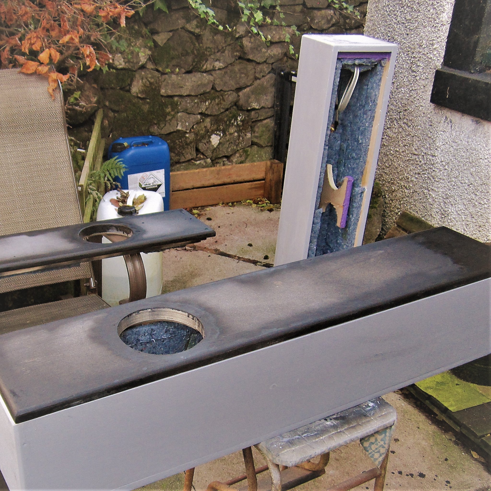

alpair 11ms drivers - soon to be replaced with maop 11's
double ply walls all round - insulation sandwiched in top, bottom & front panels
lined with metisse & tuned by adding/removing 'loose' herdwick wool
sealed unit sits 'in' bespoke floorstand
front panels incorporate Smile Plastics charcoal 5mm planks (recycled yoghurt pots, etc) to provide recess to flush mount driver
amazing soundstage, surprisingly good bass
cabinet based on scott's water buffalo design but... I'm no techical nor skilled at stuff, so it aint true to the design; but it works for me!
What would higer R slot mean.... here what Scott has suggested is a 75 by 125 mm port. So what would it be for this design.
Also the inherent design of the Water Buffalo seems it should go pretty low... please correct me if wrong ...
As a generalization a slot vent will trade initial rool-off and ultimte depth for a bit more elegant bass and less going in and out of tune with the dynamic changes in T?S parameters.
We used it on our big MTMs using Scott’s A12pw ML-TL and the ML-TL for the W14 in Tysen V2.
