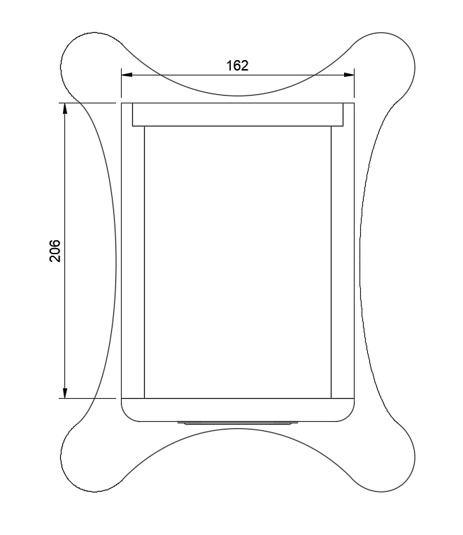

The array cabinet is 2160mm tall, 162mm wide and 222mm deep. 206mm for the cabinet and 16mm for the baffle.
Here is a scale drawing with dimensions that you could scale if you want to copy it. The base is 200mm between the centres of the feet pads left to right and 275mm front to back.
6 drivers per side will be a very short line, more would be better. If that isn't possible (or even if it is) some form of shading would help to shape the response.
