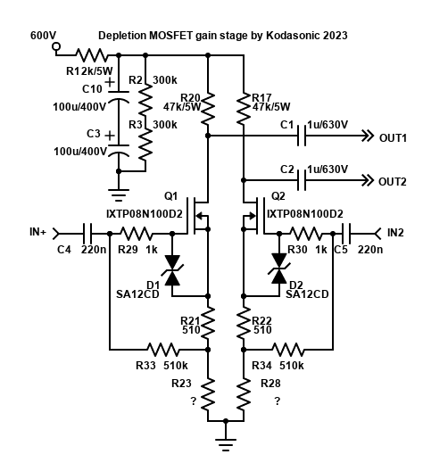

I designed one. If you make R23 and R28 0R, this will make 69 VRMS from 1 VRMS input.One day I intend to have a preamp that swings +/-50 volts and a unity gain power amp. First watt F4 owners seem to like it this way. That's the joy of DIY.
Works well, and won't break the bank.
The PCB could be used for single ended stereo or balanced mono.

Thanks. Will add it to the list of things I'll eventually make
