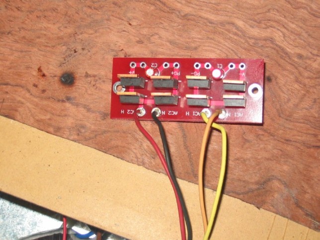

Well I didn't make any progress tonight. I put in some new fuses fired her up and........nothing. No sparks, no smoke, no voltage!!!
I'm not sure what to do next. I'm afraid the Black Gates are the culprit now. I guess I could try the other power supply board..but I'm afraid to since I don't know what was wrong the 1st time. Any suggestions?![bawling :bawling: :bawling:](https://files.diyaudio.com/forums/images/smilies/bawling.gif)

If you shorted V and PG pads (as this what it seems from your description) chances are you blew the rectifying diodes, that's why no voltage. I don't think BGs have anything to do here. Check the diodes.

kestrel200,
Disconnect the trafo from the PCB with the diodes.
Power the trafo alone and measure the voltage.
Nothing?
Fuse Ok?
Or your trafo has some thermal protection and it's open (like a fuse when it blows), or you
ed the trafo.

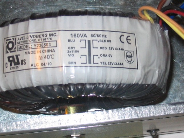

I get 25V readings coming from the Trafo into the PCB. Here is the trafo schematic. I wired it up per Brian GT's direction in previous post:

When taking measurement make sure the probe of your DMM does not make contact to the metal casing of the diodes. Your secondary connection to the bridge rectifier pcb looks ok.
I take it that your reading of 25V is AC. When you measure the V+ and PG+ what do you get? Make sure the DMM is set for DC.
