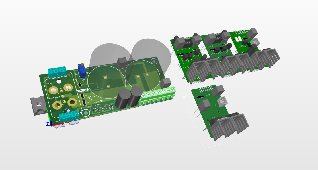

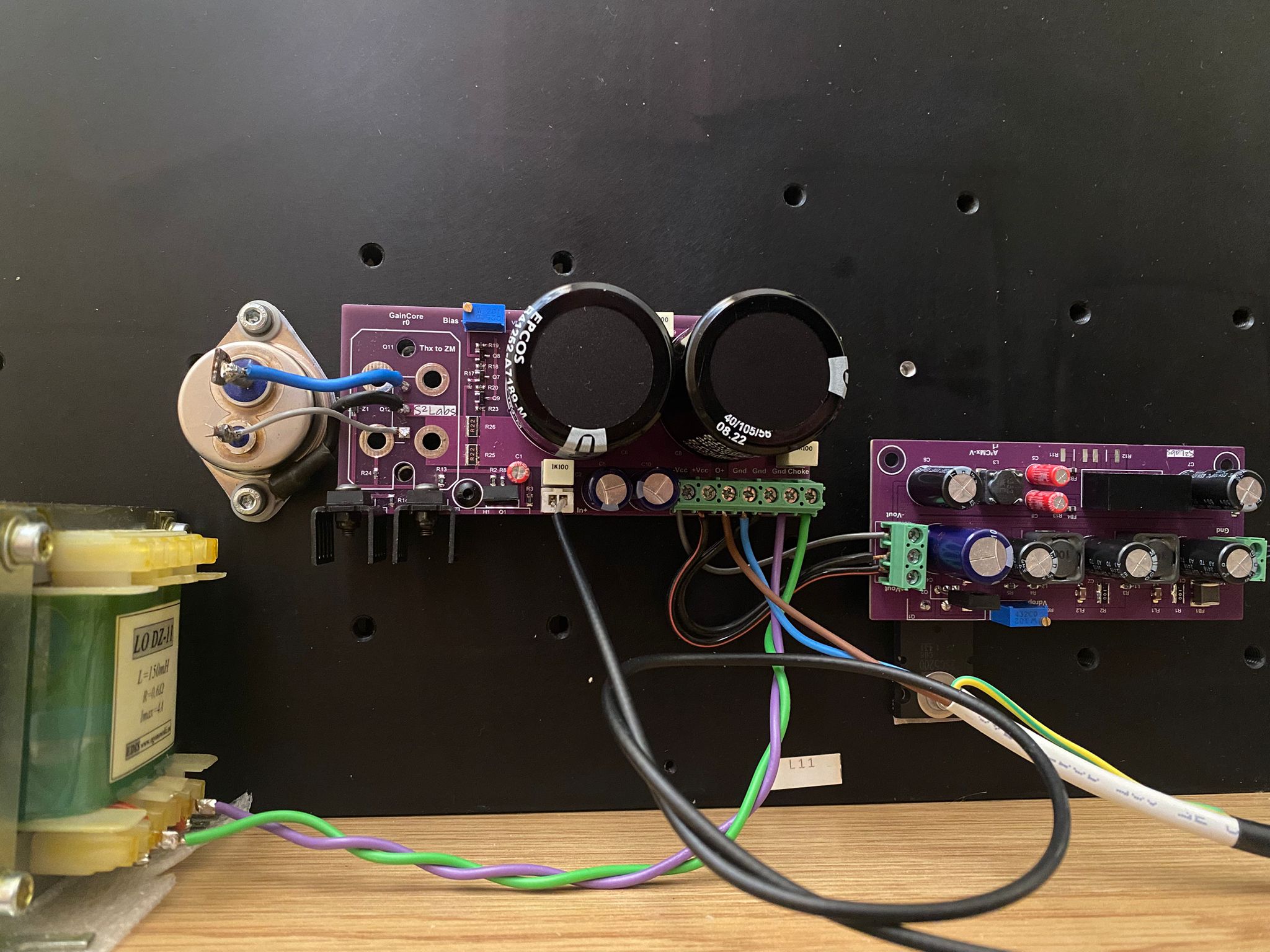

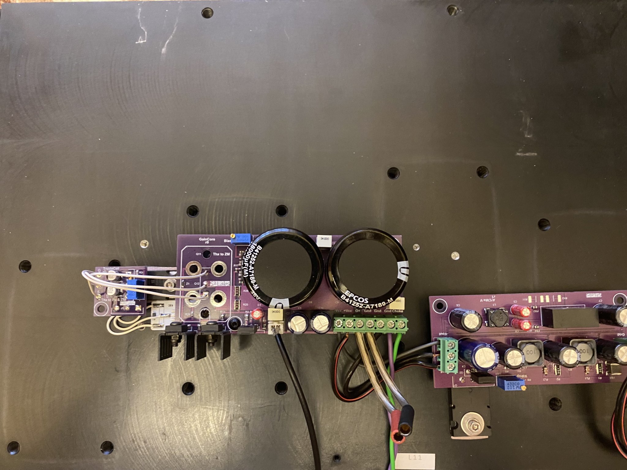

Here you can see the modules assembled. The ones from the right are A2Cmx-V power supply filters and negative rail generators.
The amp requires a positive high current power supply and a negative low current one so the A2Cmx-V takes anywhere between 16-32Vdc on its input and gives ~3V less on the high current output and -30V on its negative output.

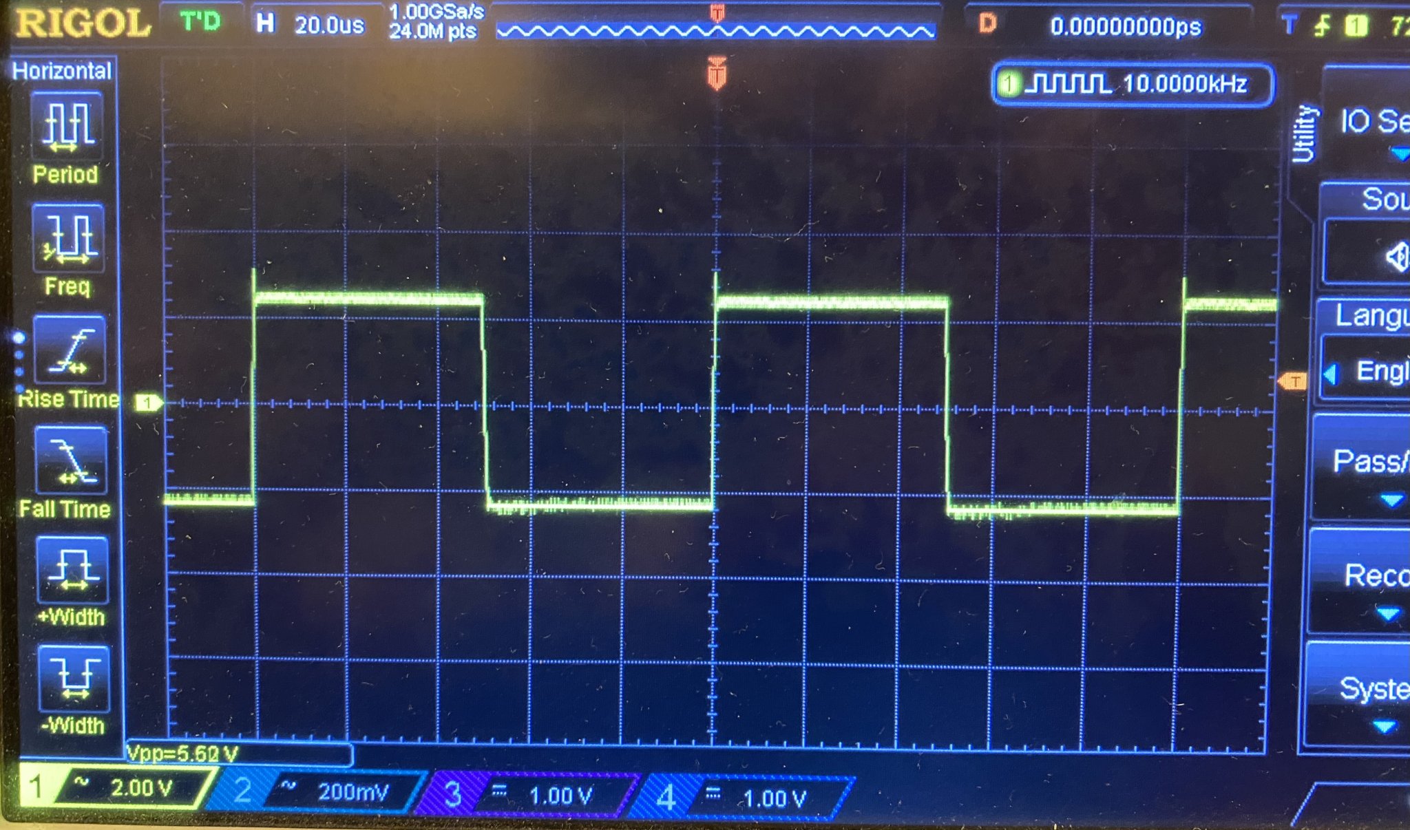

Here you can see the noise on the output of the amp when powered with laptop brick smps and A2Cmx-V

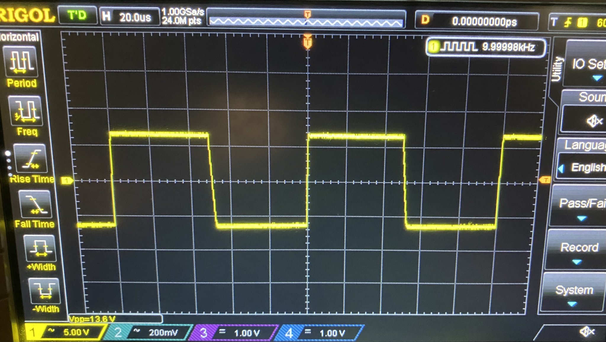

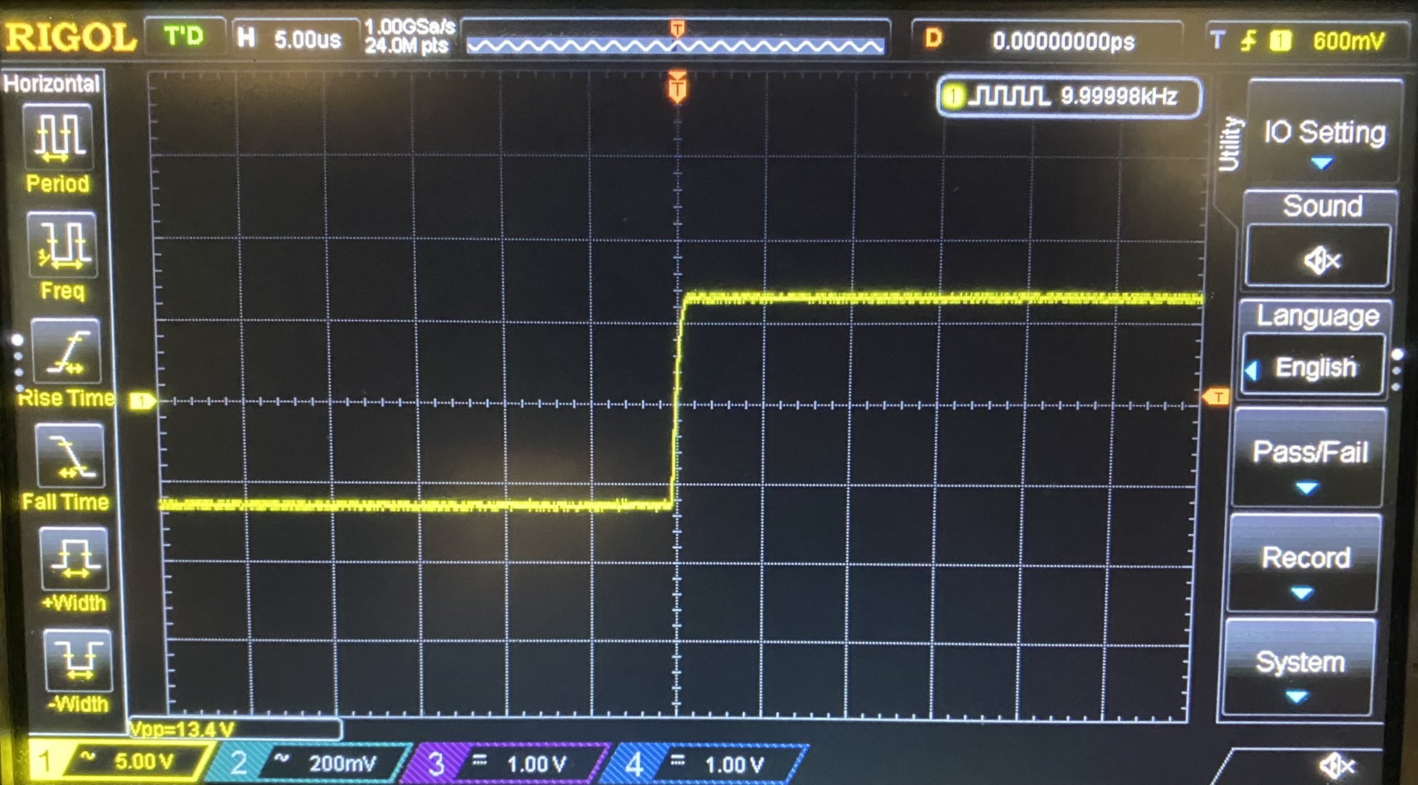

Initially I went for too much open loop gain and feedback that gave some ringing
The problem was solved by increasing R13

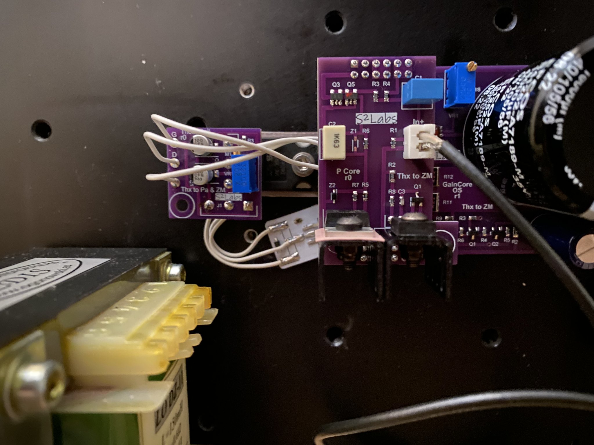

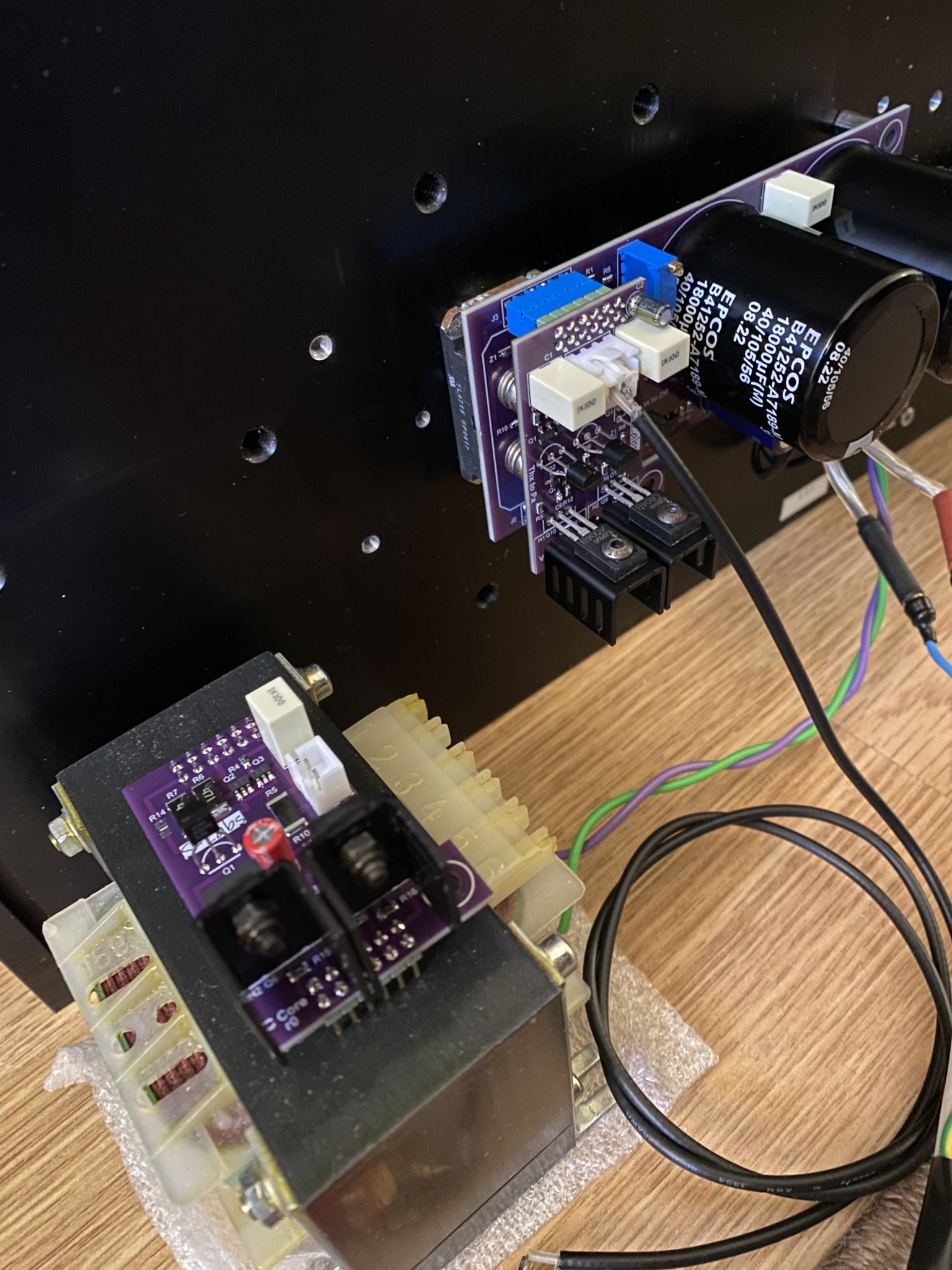

Here is a pic of the amp at work.
The inductor in the picture has 150mH/0.7dcr/4A but actually does 3.6A before starting to saturate. These were quite cheap when compared to hammond, I think half the price.
Depending on the needed power, a 2a/70mH choke is the minimum that can be used with this project, or at least this is what I seen when simulating. I have only these 150mH inductors for test.

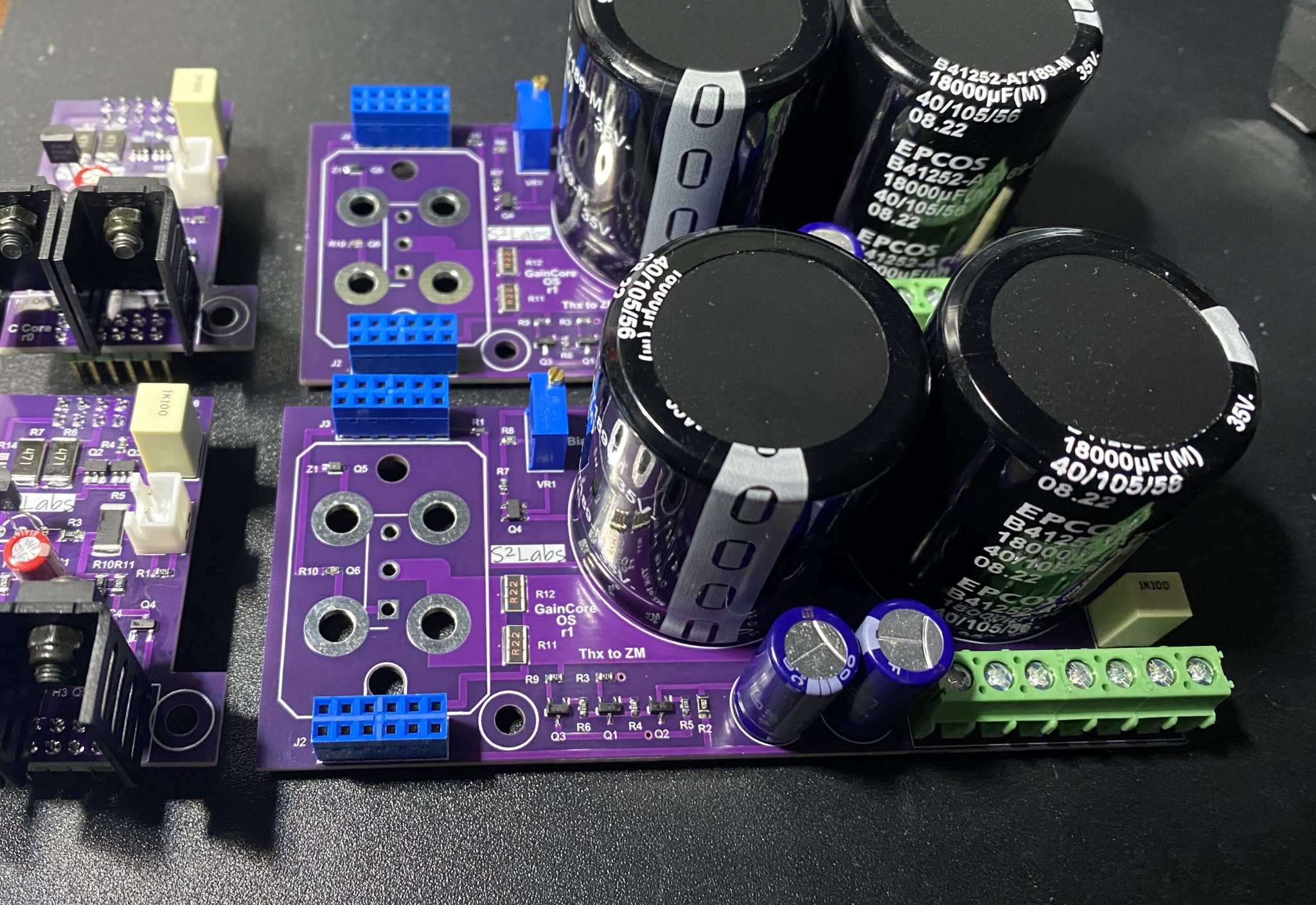

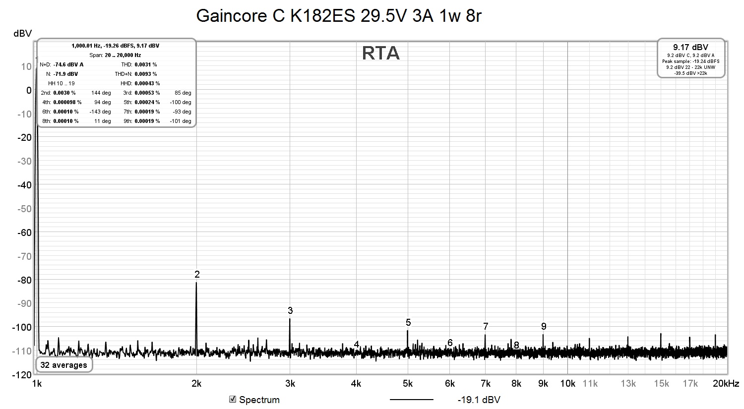

Had the SITs sitting on my desk waiting to be used with the Gaincore. So today was the day
With these I get a bit lower thd but also a bit less power.
Here it is at 2A bias
And here it is at 3A bias

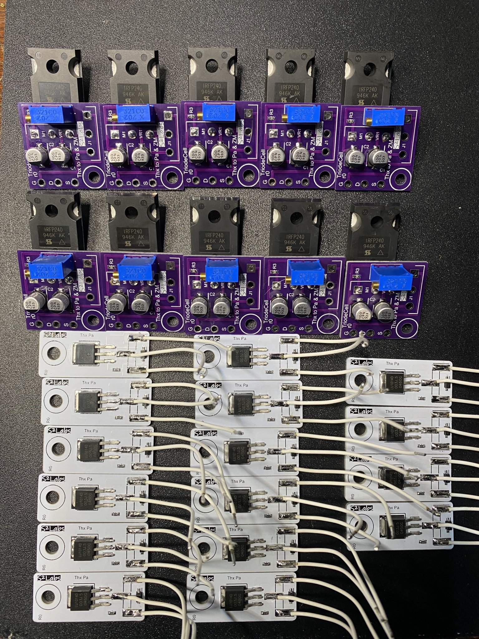

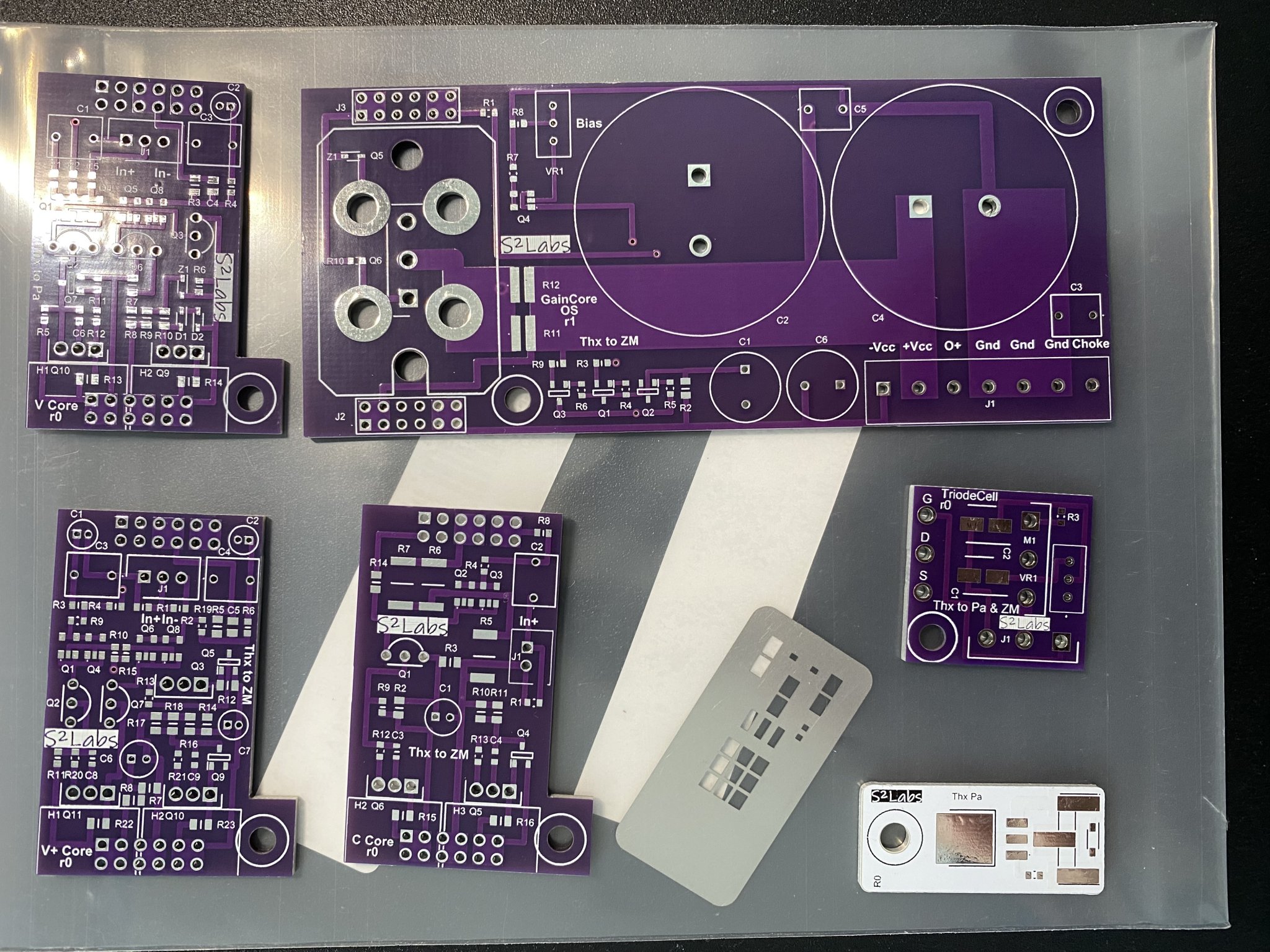

Recently Pa sent a few lu1014 which I was planning to try in this amp.
So a big thanks to Pa!
I designed some small cascode pcbs that will go together with the lu1014.
No pin strip on the lu1014 pcb because I had bad experience with them in the past so I decided that I will use wires from now on.

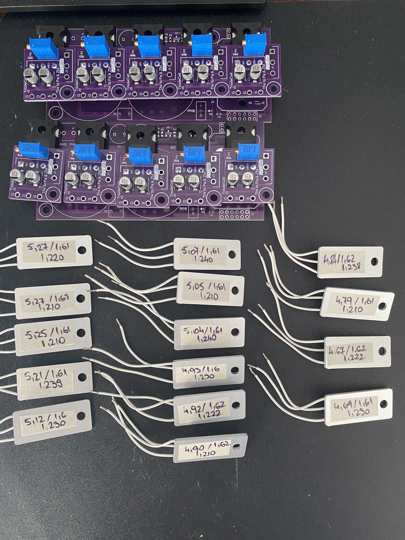

I connected them all to my temperature controlled matching jig.
The measurements were taken at 55c heatsink temp, 2.4vds and 1.6a bias.
On the back sticker I have noted the gm, bias current and vgs.
It seems that Pa sent matched devices 😎

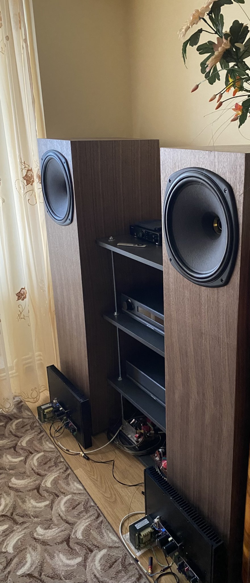

I have some Tannoy drivers in transmission line enclosures. 6r/96db
So I went ahead and connected the Lu Triode cell to the Gaincore.
Because of the extra feedback that the cell provides I had to remove some feedback from the amp so I slowed down a bit the Vas by increasing the degeneration on it and also increased the amp closed loop gain to 10x
Without the above modifications it looked like this
Now it looks like this

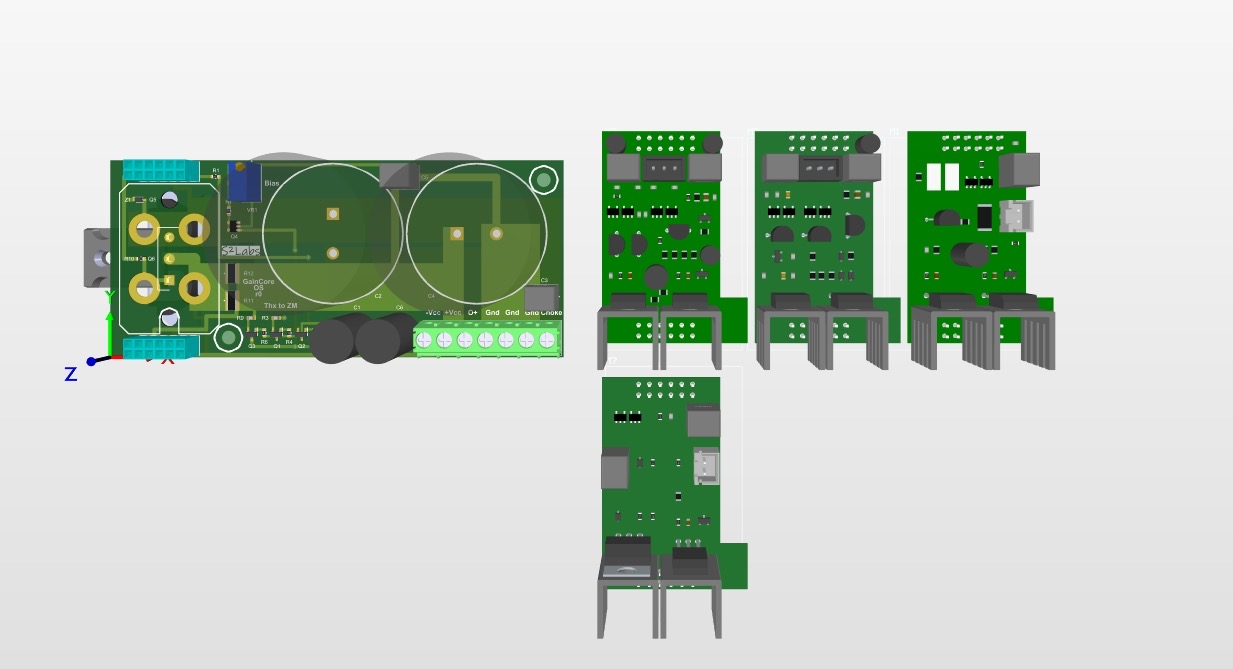

After this I will be ready to test the new modular design that has 2 new front ends with voltage feedback.
Then there will be enough stuff to play with.

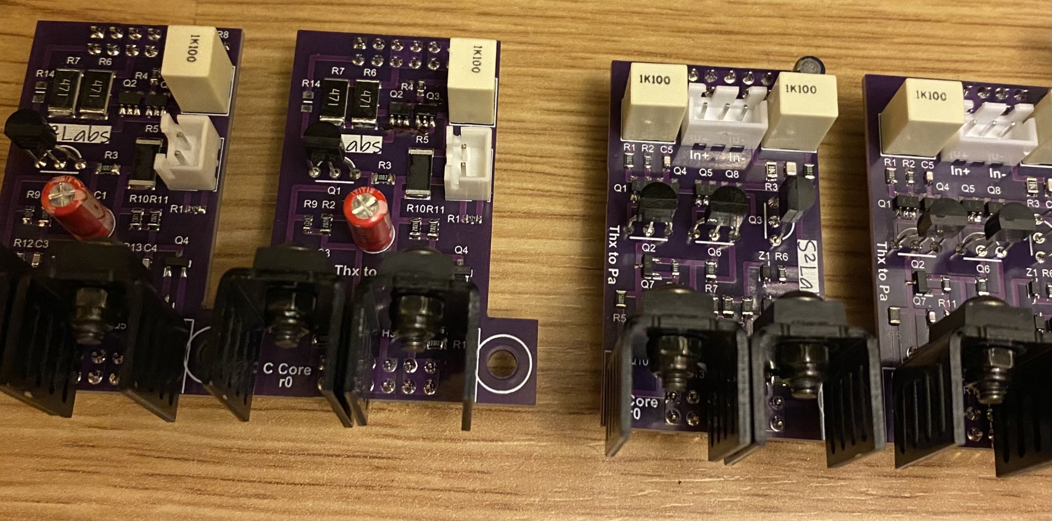

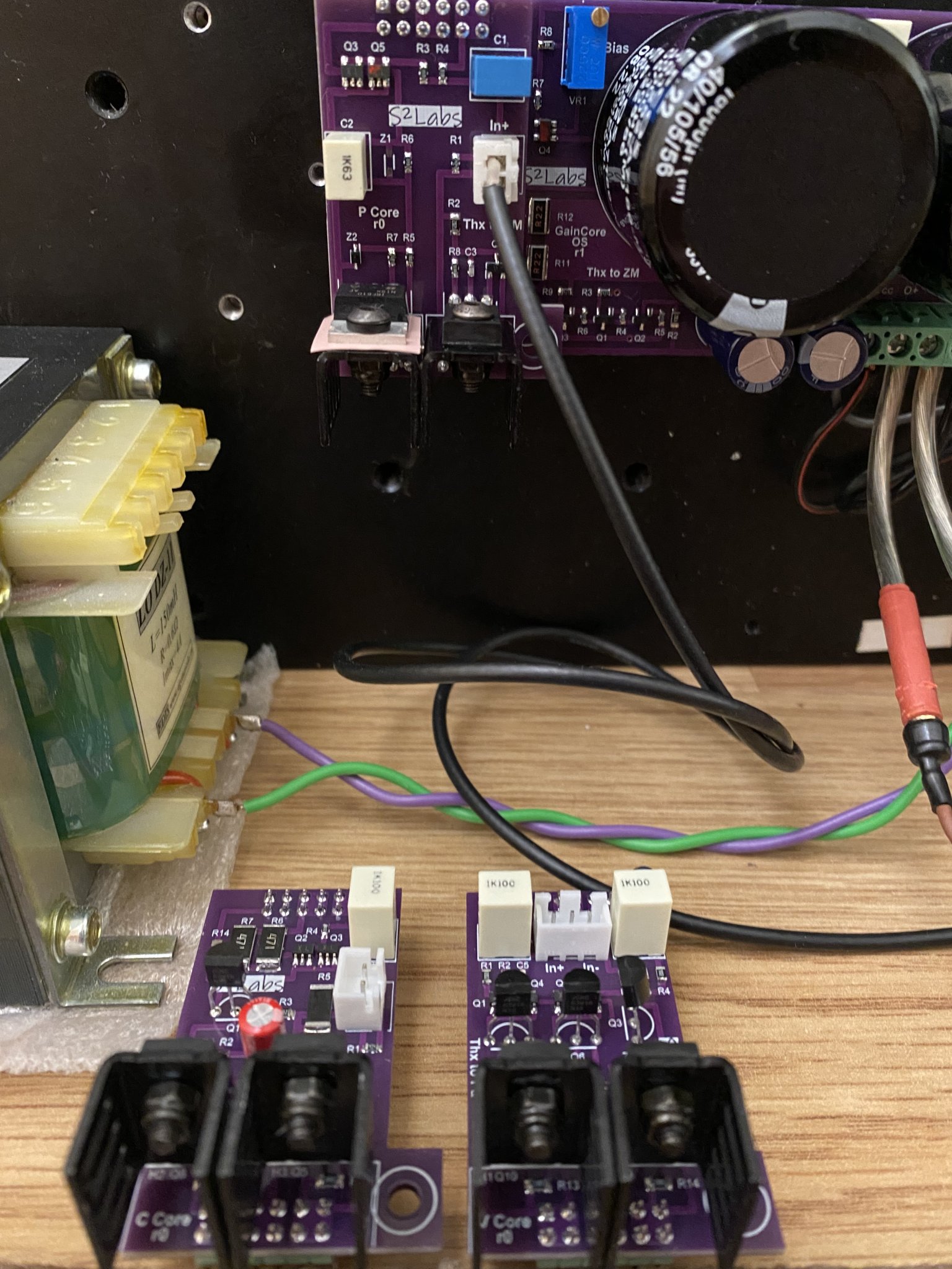

Went silent yesterday.. it was a pretty busy day..
For now I have populated the main pcb that hosts the OS and the C core which is practically same stuff as before only that now is modular.
Then I assembled another core which is the V core, a voltage feedback front end exactly like the one that Pa did for the Stasis.
I had the Warbler in the past and liked very much its sound though tested it with mosfets and sits.
The P core and the Gaincore OS when put together are exactly the Warbler.
Now that I had the Lus from Pa it was the time to give them a listen in the Warbler 🙂

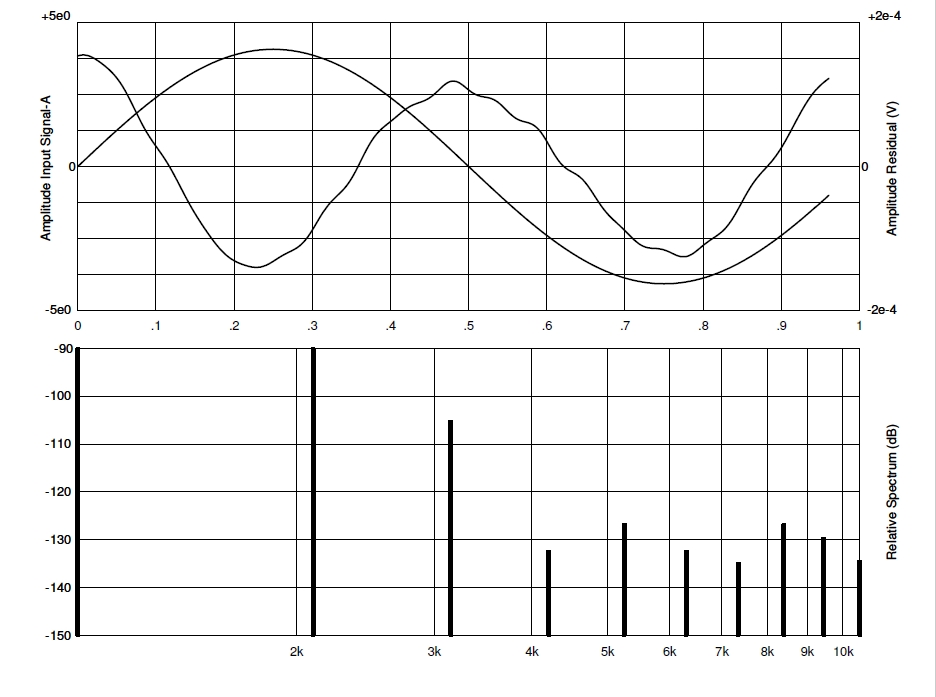

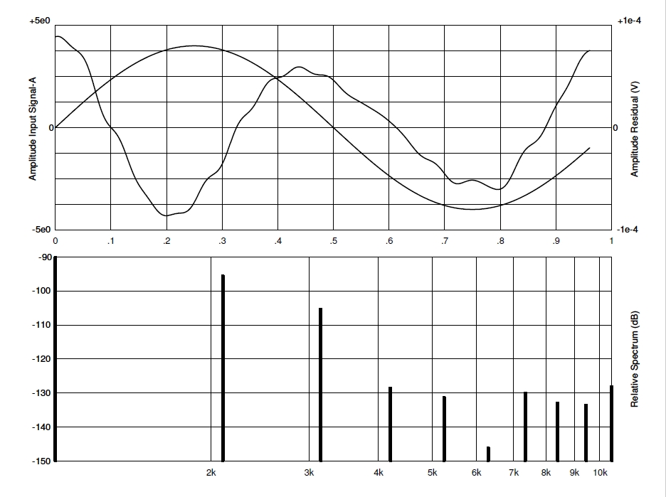

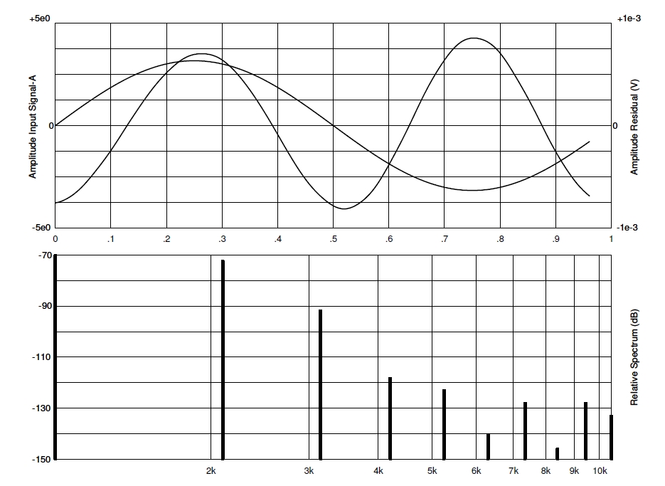

This time I waned to look at the shape of the 2nd hd.
So here is the Gaincore with the V Core and LU1014 at 2.84V/8r
Here is the Gaincore with the C Core and LU1014 at 2.84V/8r
So here is the Gaincore with the P Core and LU1014 at 2.3V/8r, only 2.3V because the soundcard I use for this synchronized test goes until there.
The P core got it`s name mainly because of the 2nd hd it gives that is Pure 🙂 It gives the highest thd but in a very natural way. The other 2 gain stages are good too but because of the global feedback give much lower thd and alter a bit the shape of the 2nd hd.
All 3 are very musical and at this point I can`t say I have a favorite.

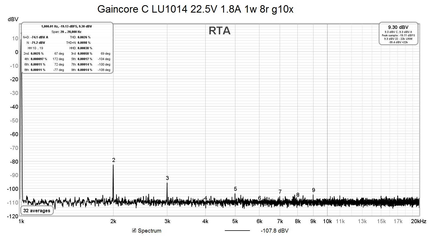

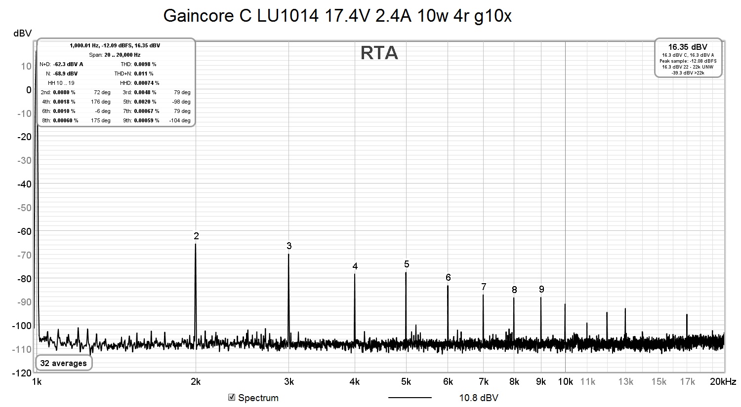

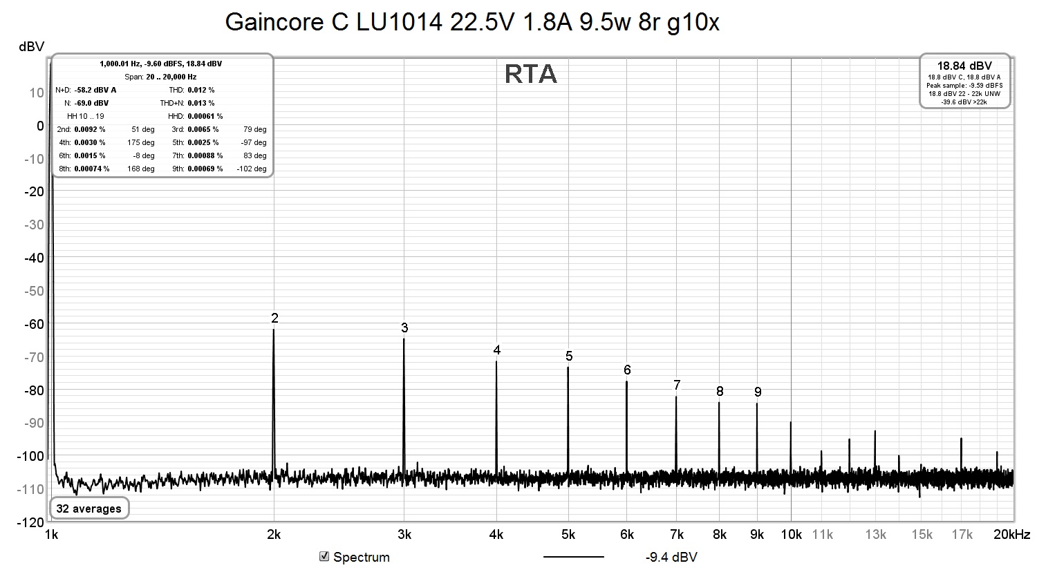

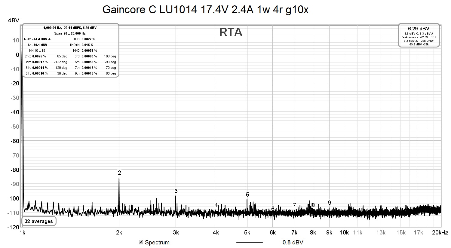

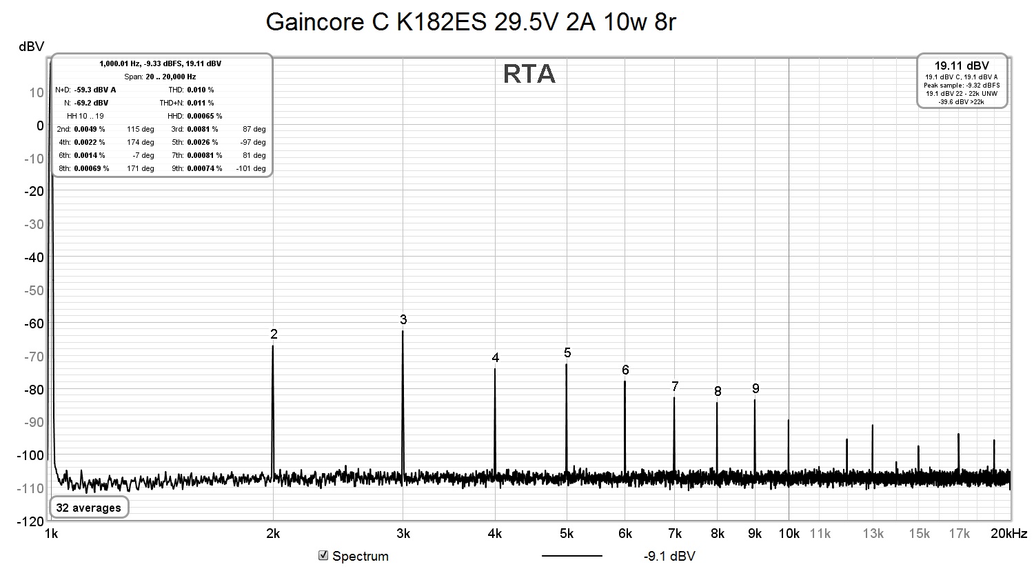

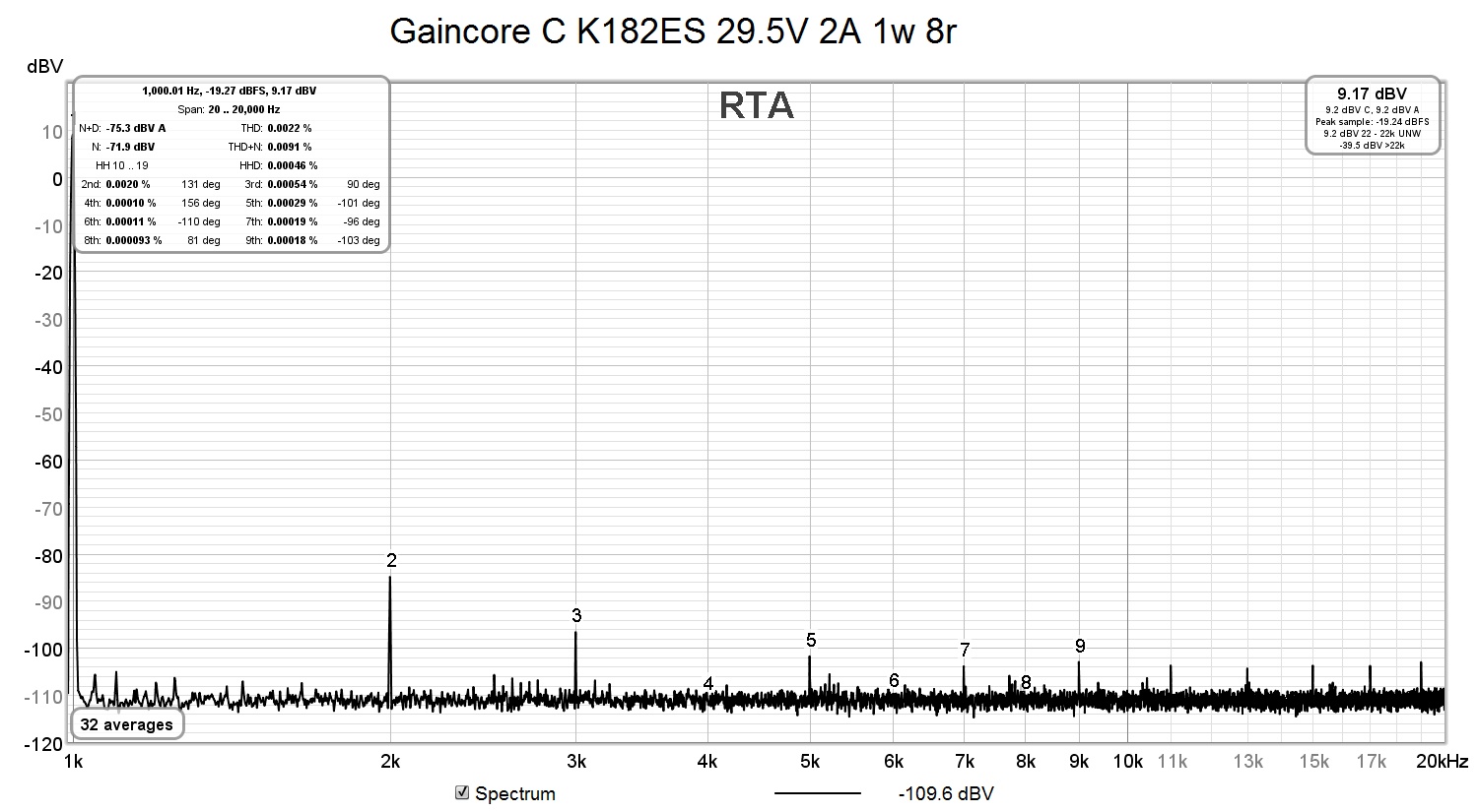

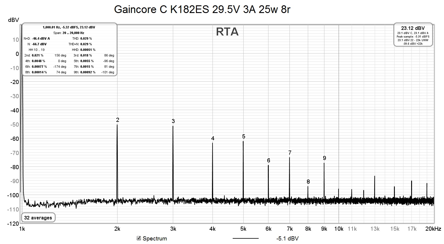

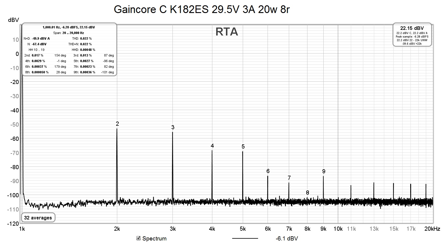

Tonight out of curiosity I decided to take some measurements of the amp with the C core with a 4ohm load.
To my surprise it did quite nice.
