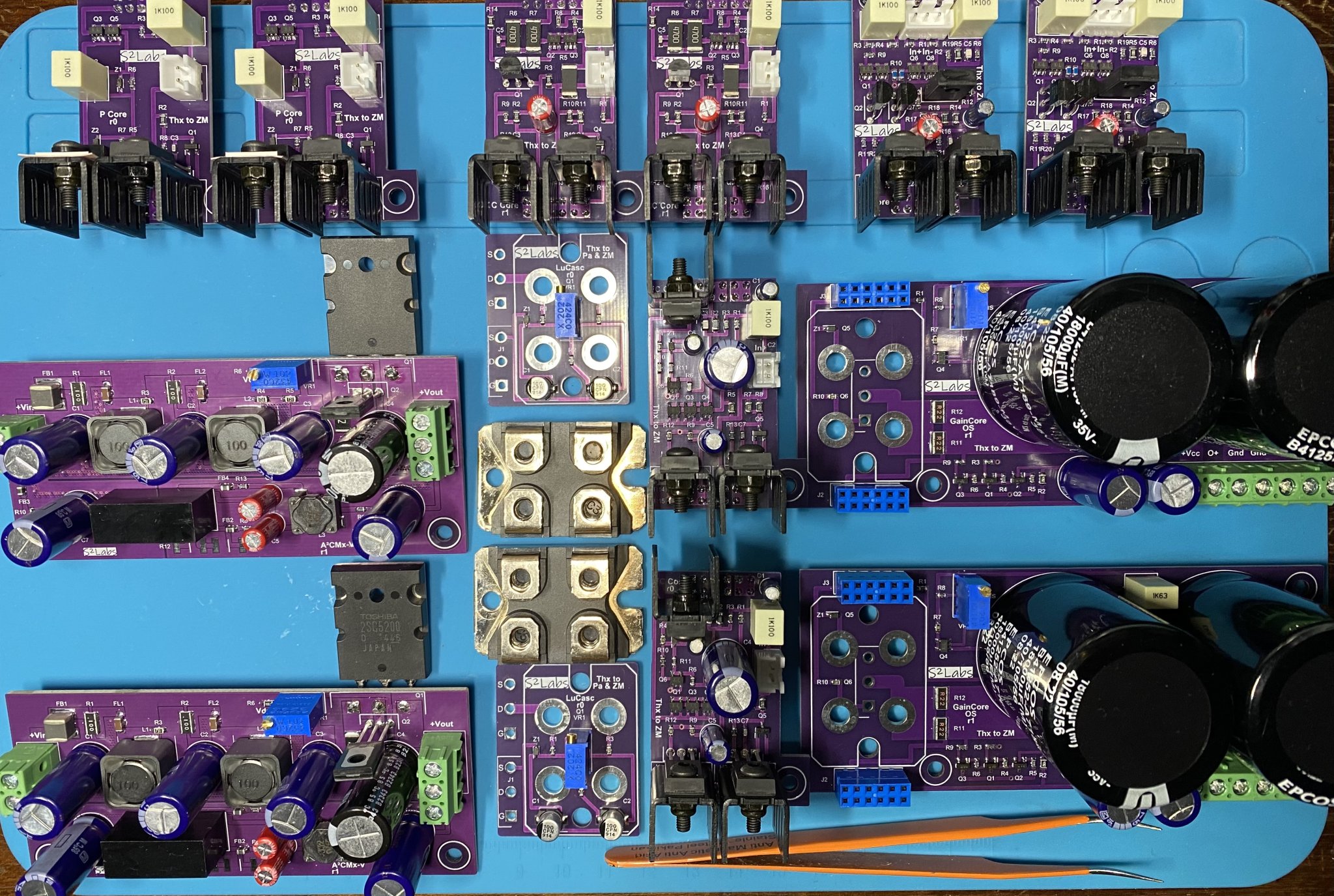

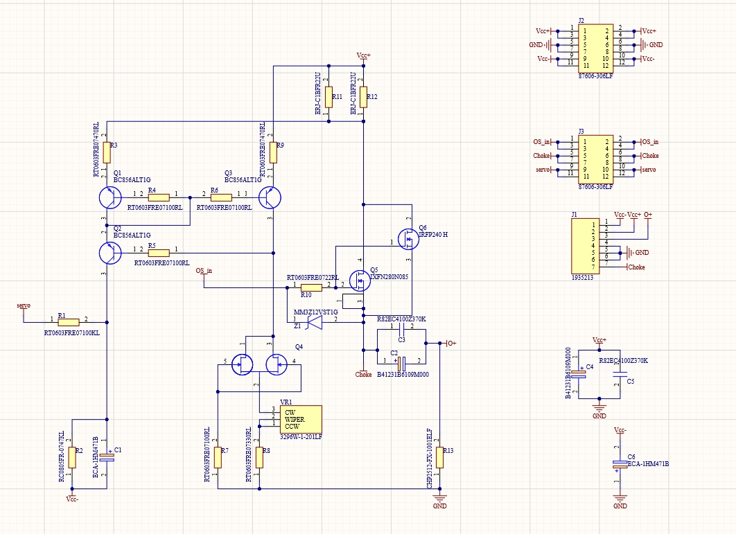

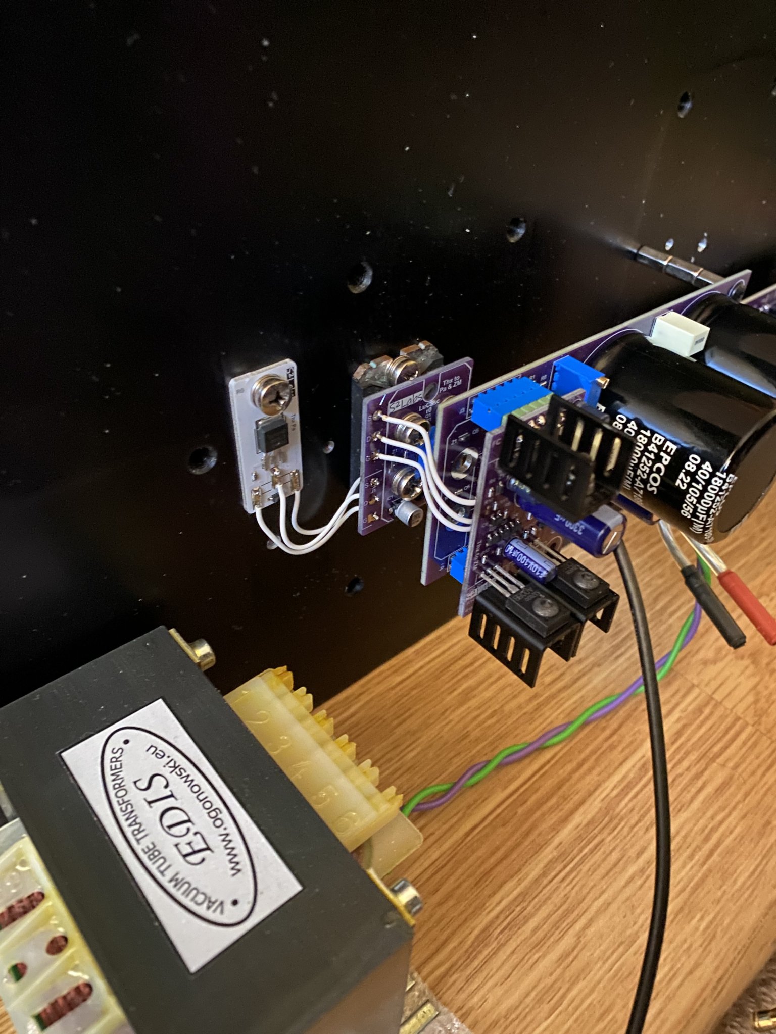

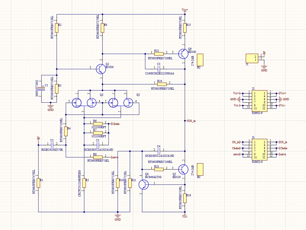

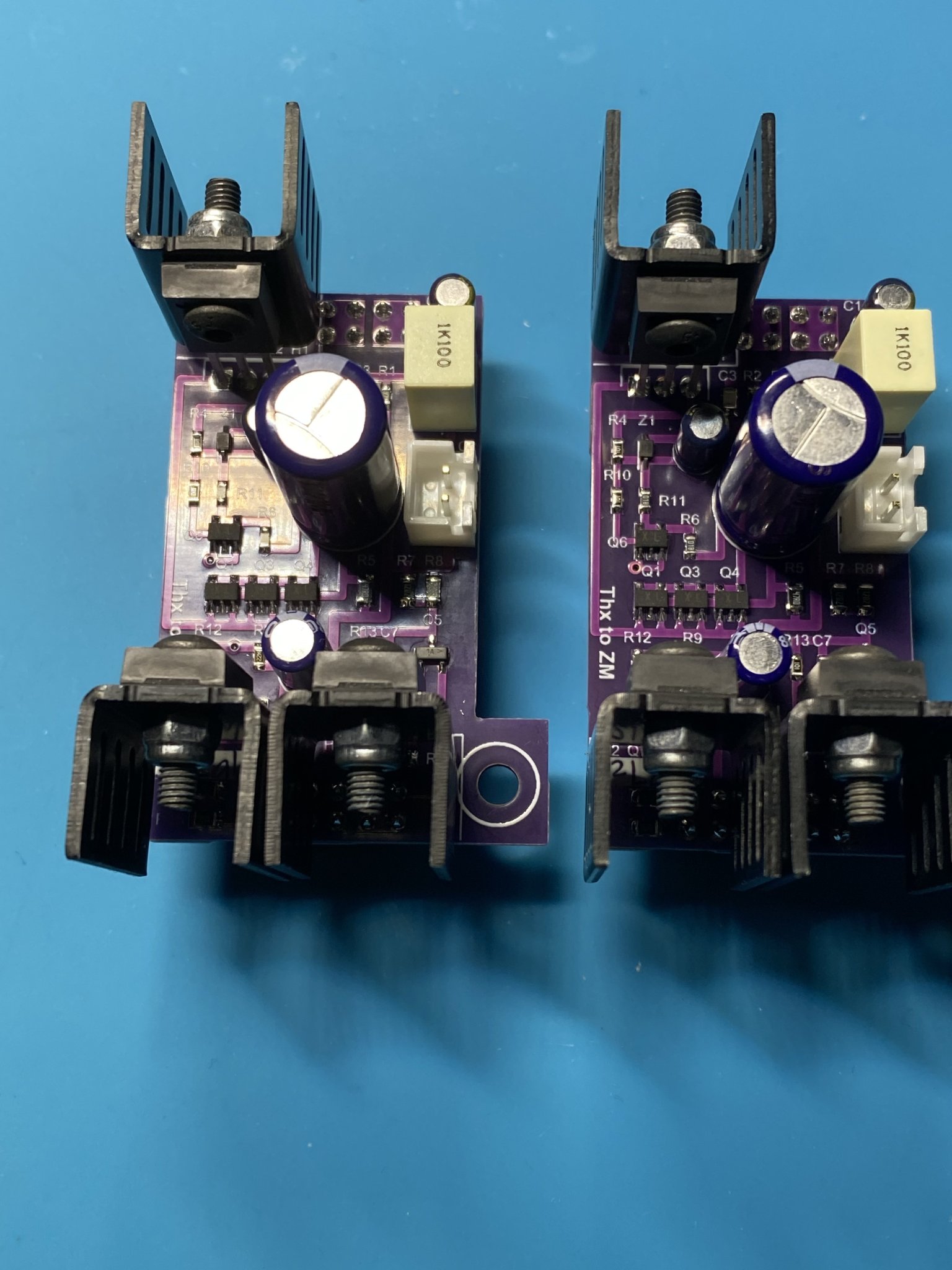

Because I wanted to hear how different front ends will sound I adopted a modular approach. The output stage and it`s control circuitry is on the main pcb and the front ends on slave pcbs that connect between them with pin strips.
To change the modules you will need to turn off the amp.
The schematic for the OS pcb:

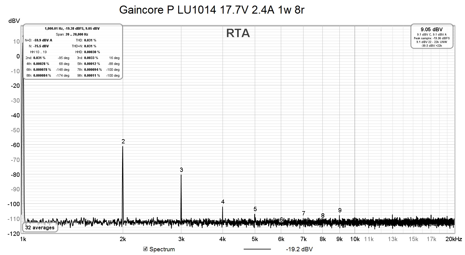

Some thd measurements using the LU1014 as output device

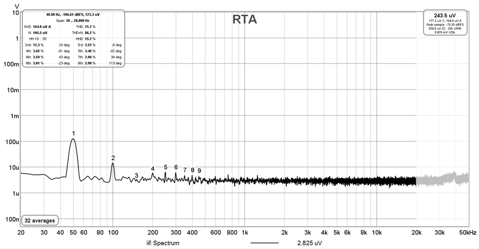

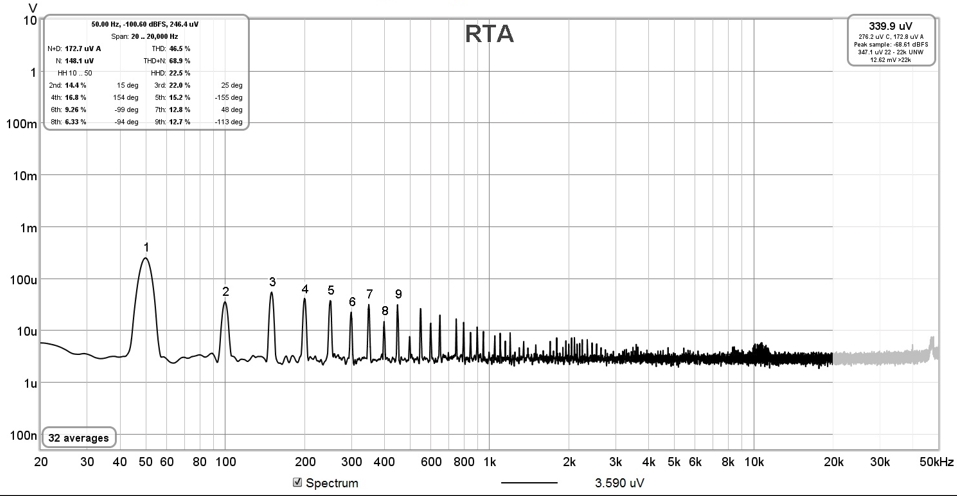

The last week I bought two meanwell sp-320-24 power supplies. One for each channel. Intially I was using notebook power supplies.
When I first connected the new power supplies there was an unpleasant buzz coming from my speakers which wasn`t there before.
It looked like this on the fft analyzer
Having the A2Cmx filter connected between the power supply and the amp, it was less probable that the buzz was coming from the power supply so I supposed it is a gnd loop. After trying all possible combinations of connecting the gnd and earth and still having the buzz there last thing which I could think of was that I could have a gnd loop on the pcb.
I was using a twisted pair of unshielded wires to carry the signal from the preamp to the amp.
As a last attempt to cure the problem I said to test with a lousy pair of rca shielded cables (that i had around) because the amp was quiet with the input shorted to gnd.
Now the story changed a lot. What is displayed at 50hz is coupled from the wiring and I can`t hear a thing in my 96db eff speakers. So the lousy shielded rca cables did their job.
So at this point one thing I can think of is that the notebook power supplies are screened better than the meanwell and if you don`t need the higher voltage and power from a meanwell it`s probably better to stay with notebook ps. Mine are 90w/20v lenovo and got them used for very cheap. These are good up to 2.4a bias.
The second thing that I am thinking of is that I need some coaxial wires to build a pair of rca cables 🙂

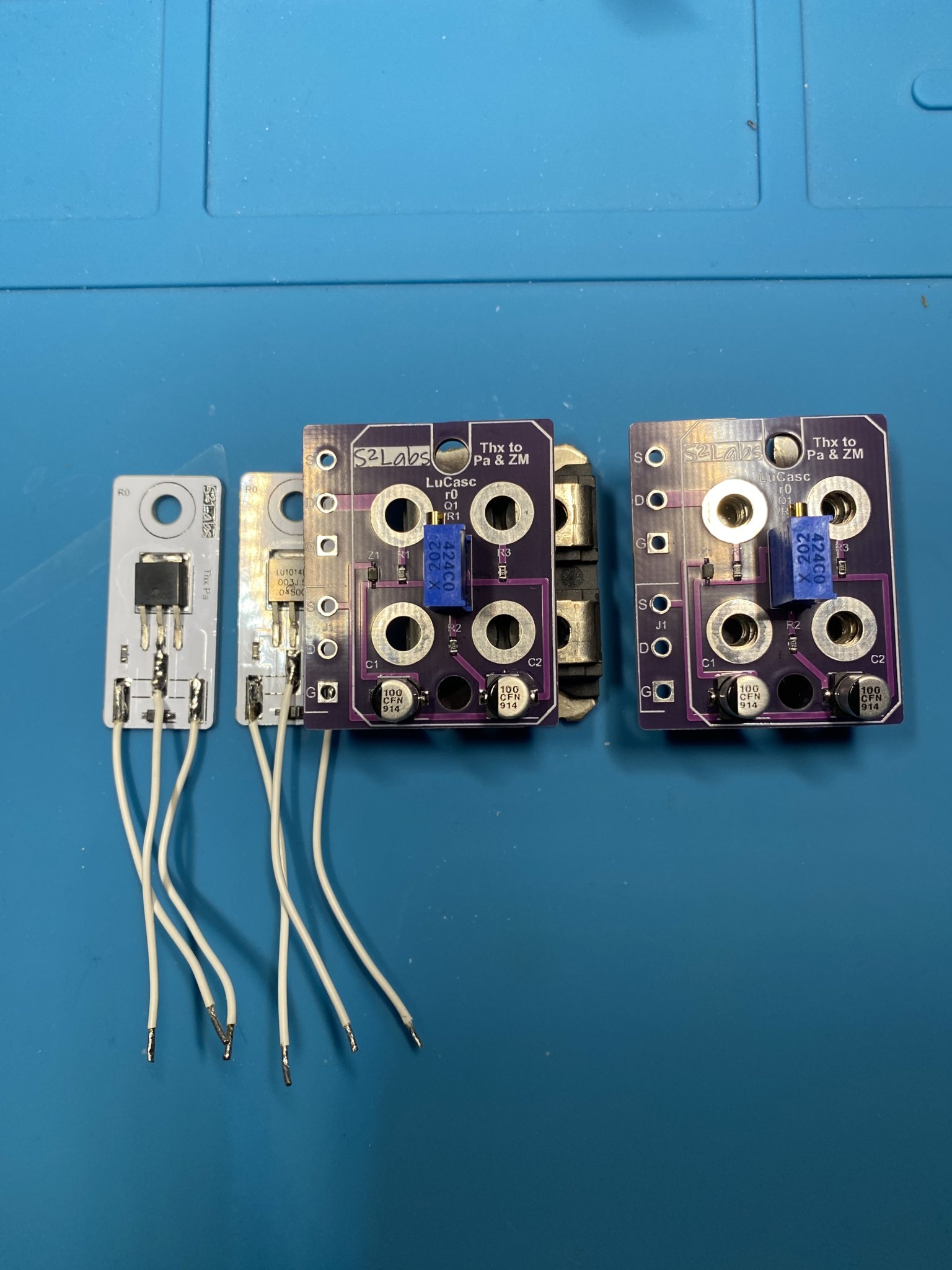

I always wanted to try the lu1014 at a higher bias but was limited by the to247 cascode. Well not anymore..
I plan to run these up to 3.5a, above this my 4a choke starts to saturate.
Will give them a try the next days.

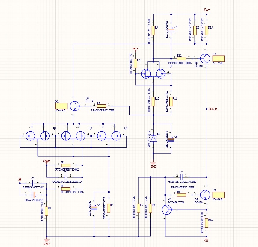

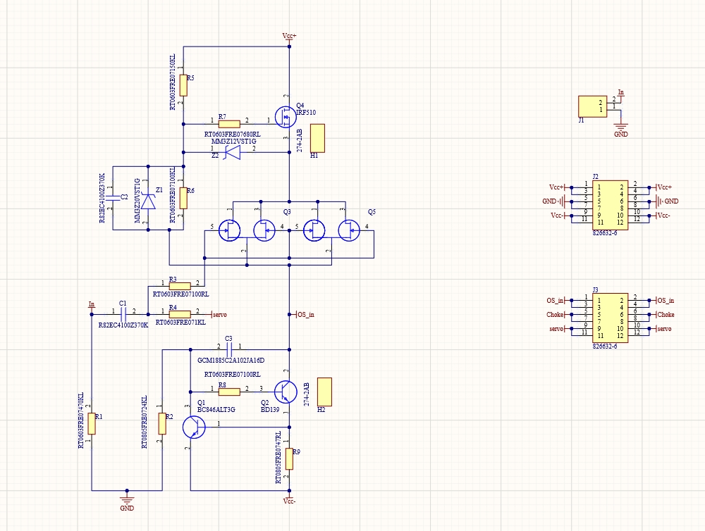

For today I put together a pair of FC cores.
FC from folded cascode.
Here is the schematic.
With the other gain stages(except P core) that I have the amp is a 3 stage amp. With the FC core it becomes a 2 stage amp, yes something new to explore.
The FC core inverts the phase so the speaker terminals need to be swapped.

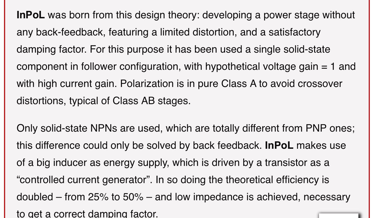

At a closer look not only the heatsinks look nice but also the INPOL amplifier concept.
Here is a part of the description from their site: https://pathosacoustics.it/en/about-us/
From the above description seems the os uses same inductive coupling as Gaincore.
At this point I think that for now I will try to change some of the cores(that I have) with voltage gain and global feedback to local feedback.

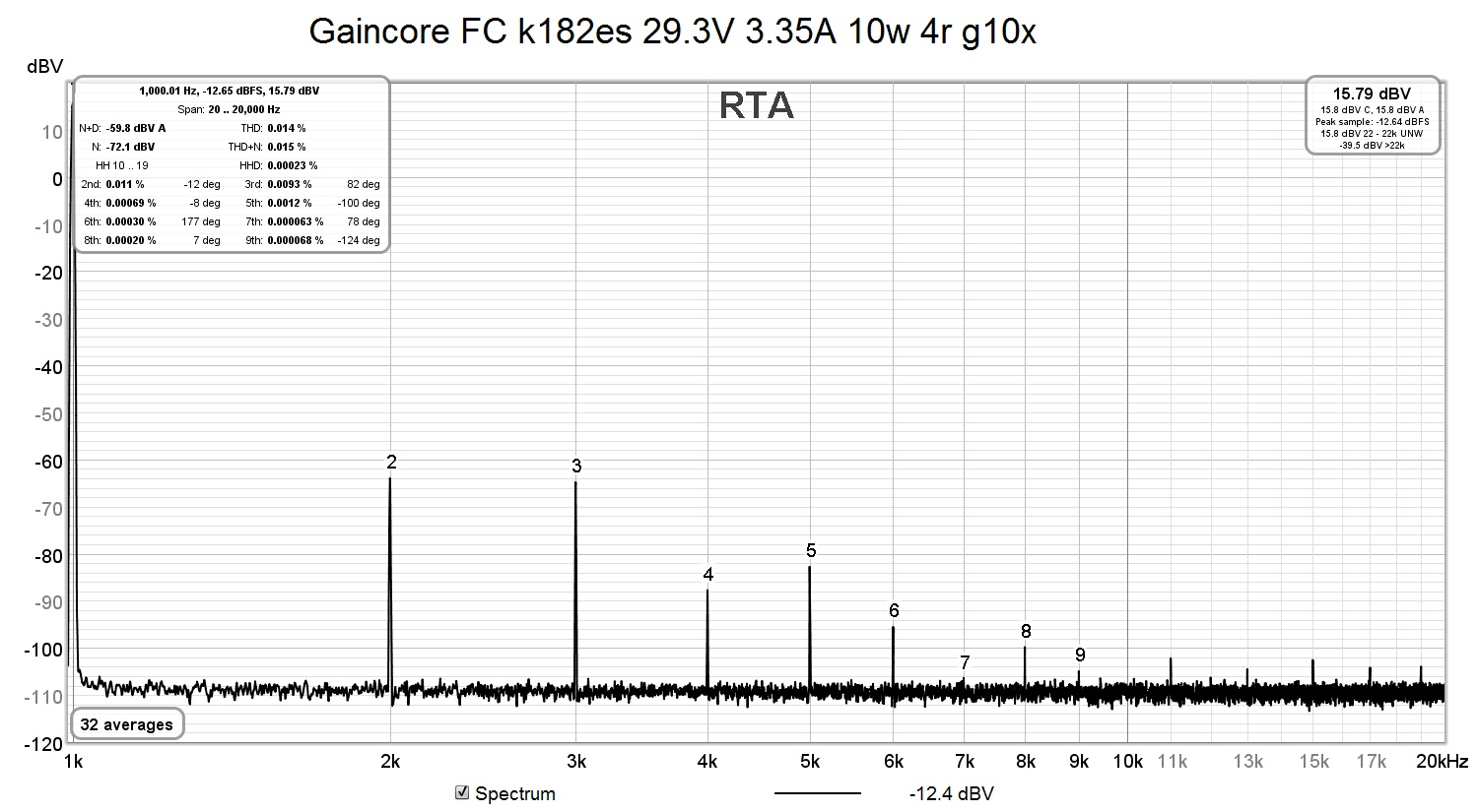

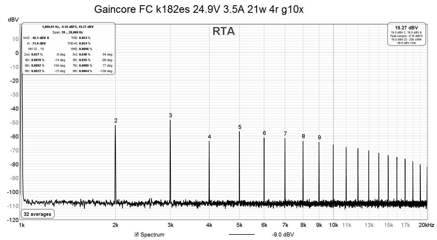

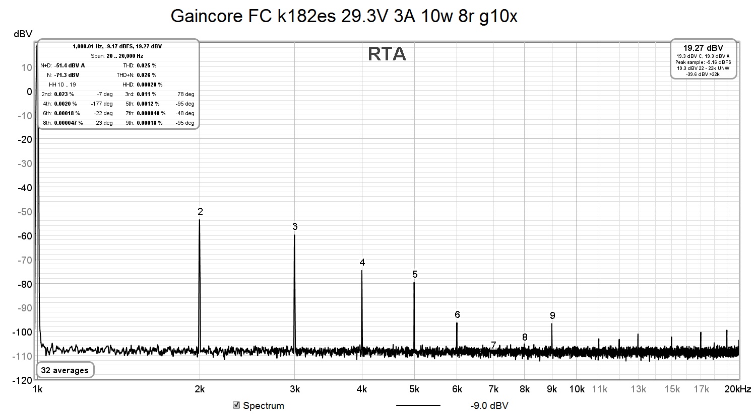

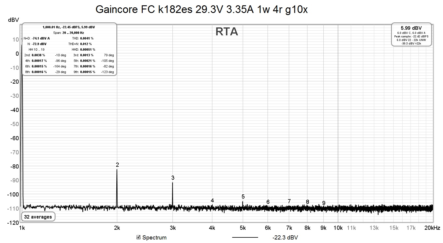

First I started with the 2SK182es SIT and the FC core.

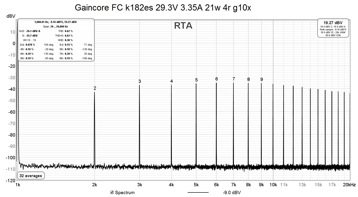

Some measurements at 4r
With a bit more bias the thd at 4r drops considerably.

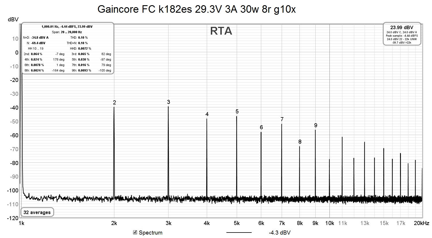

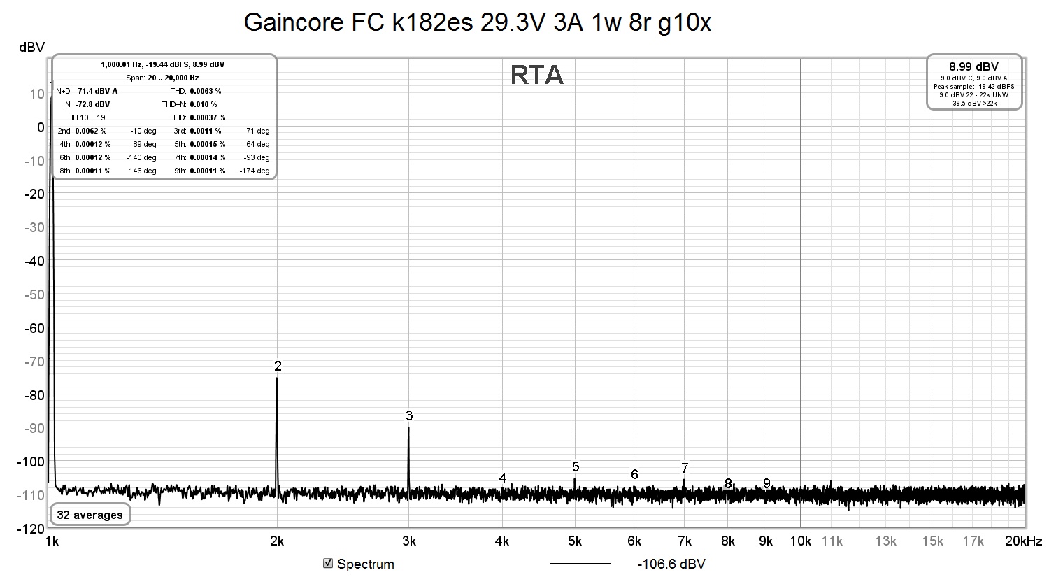

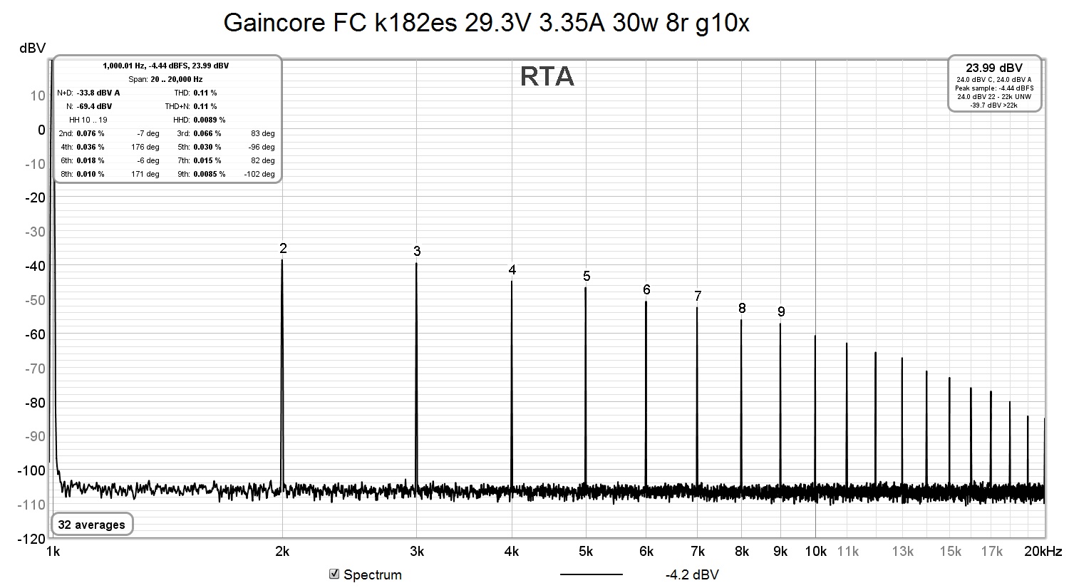

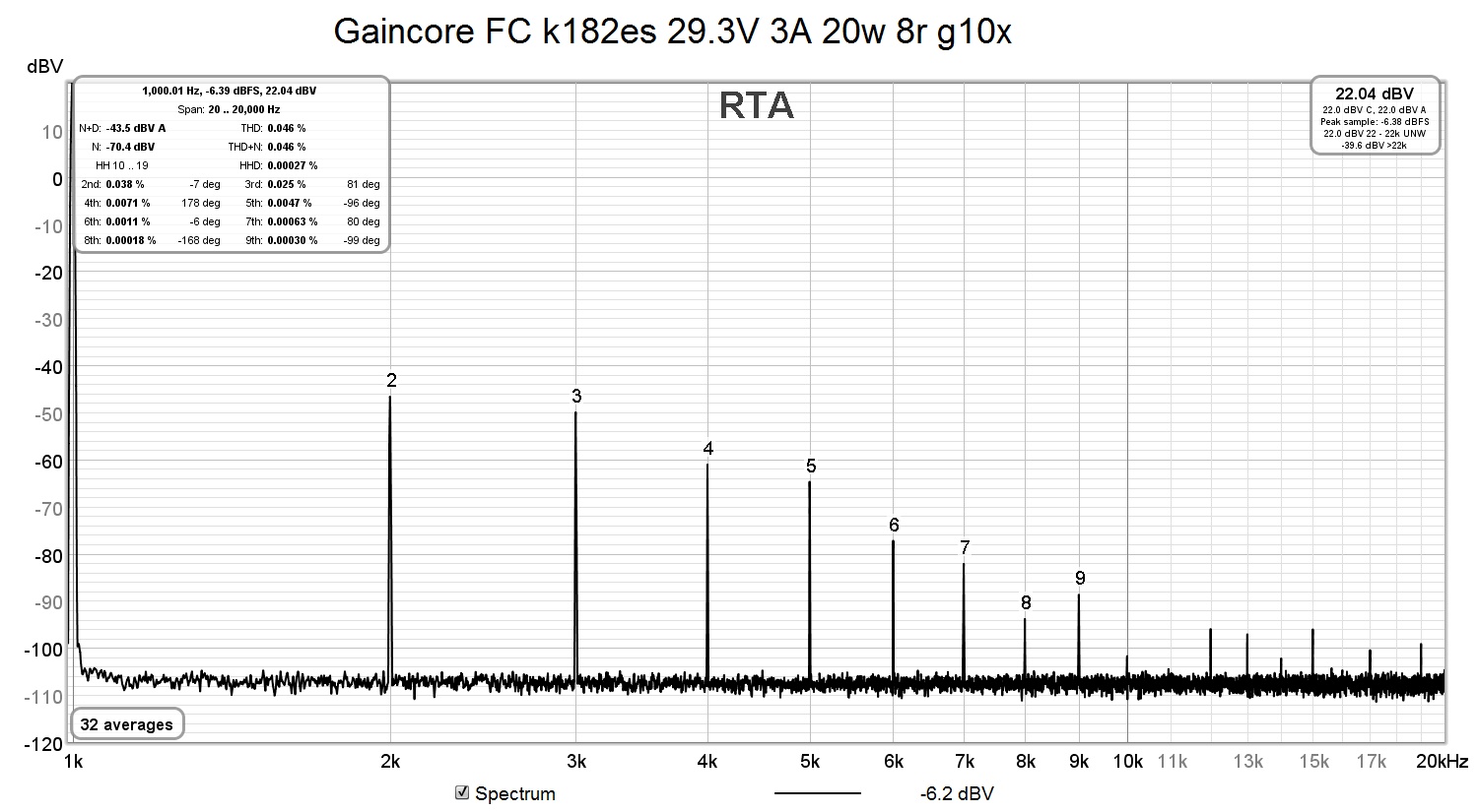

8r measurements
Here a bit more bias helps too even if the measurement shows otherwise.
I managed to take take a screenshot with the shape of the h2 at 1w/8r.

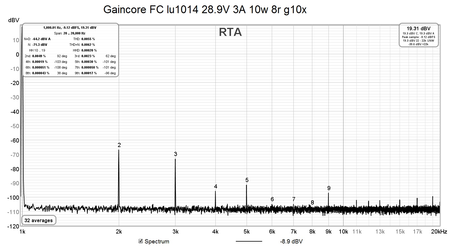

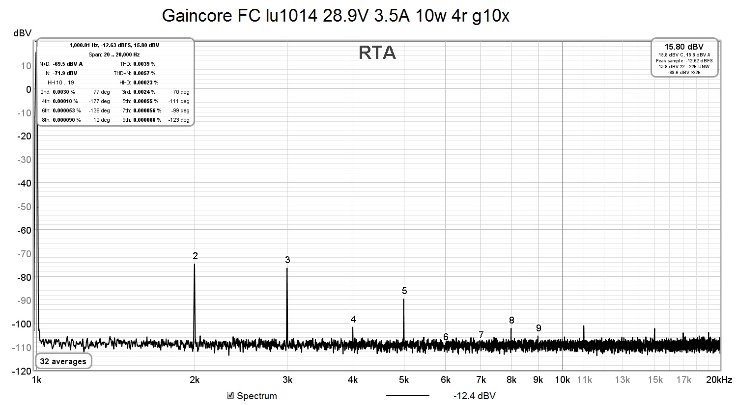

Then things got more serious 🙂

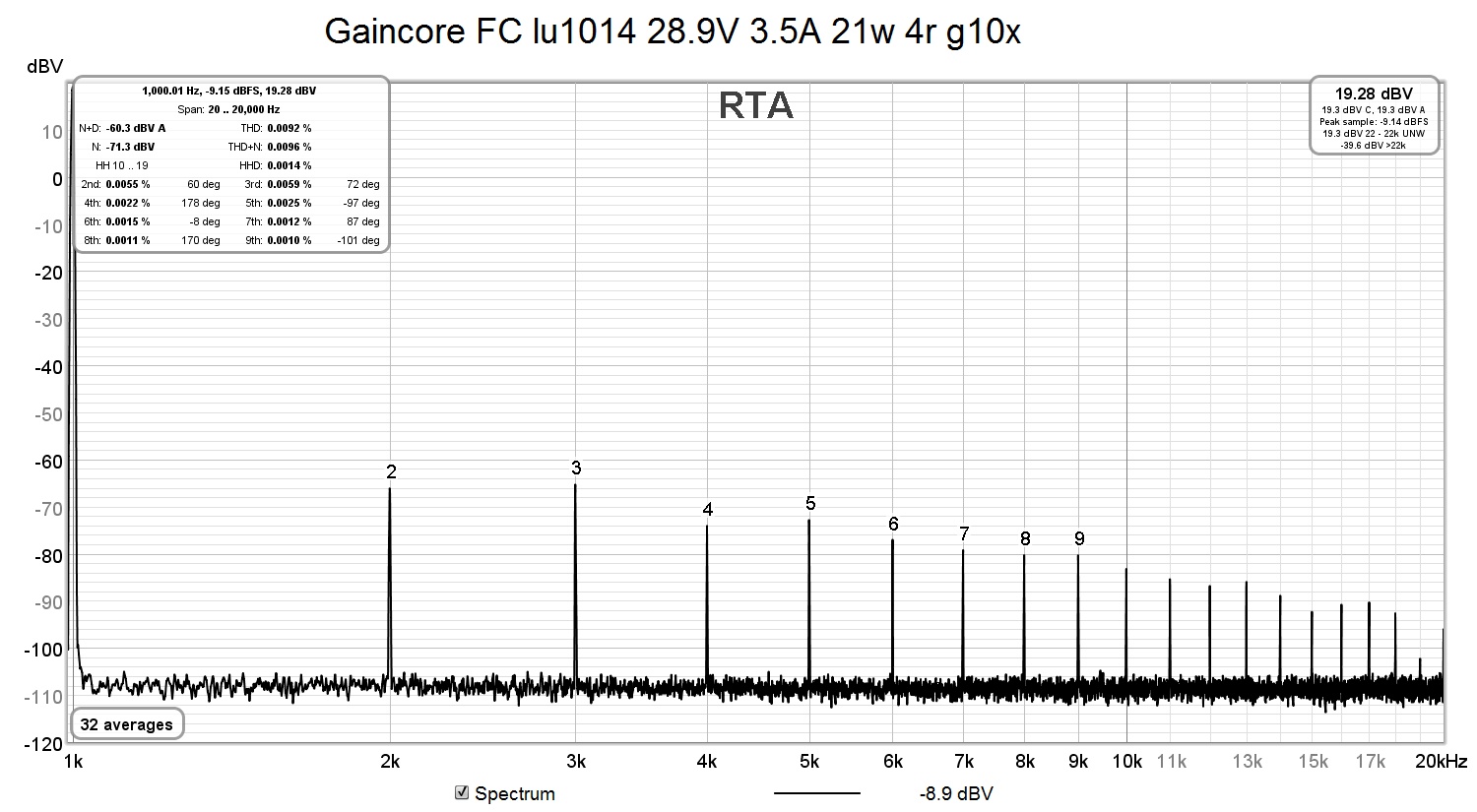

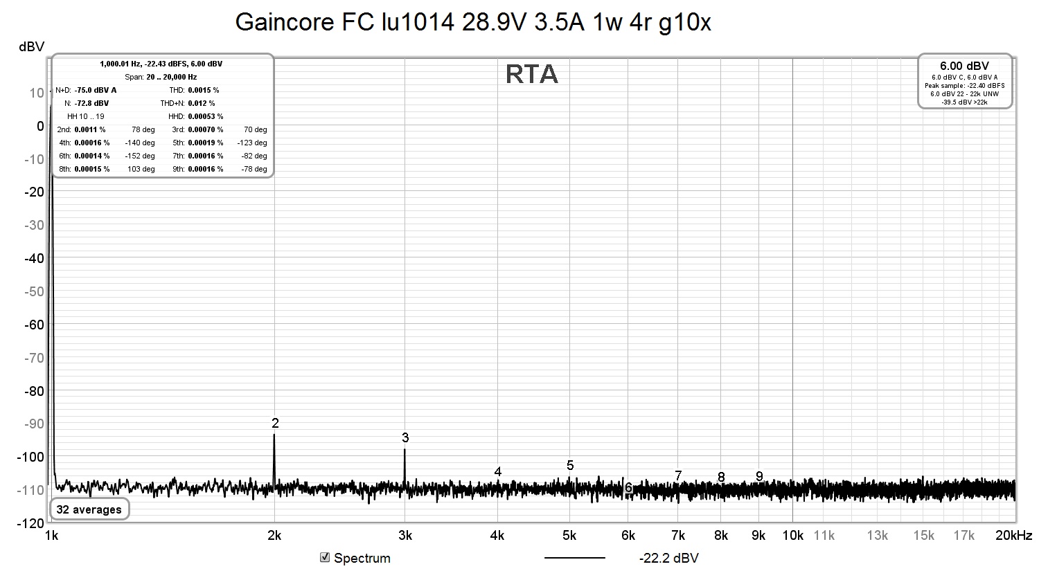

Here a few measurements.

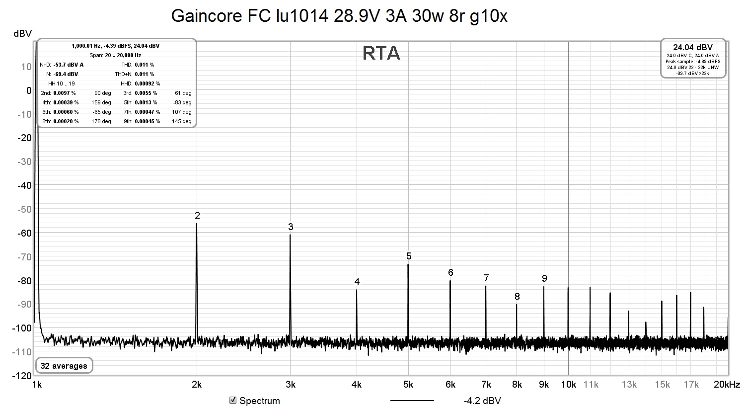

First at 4r

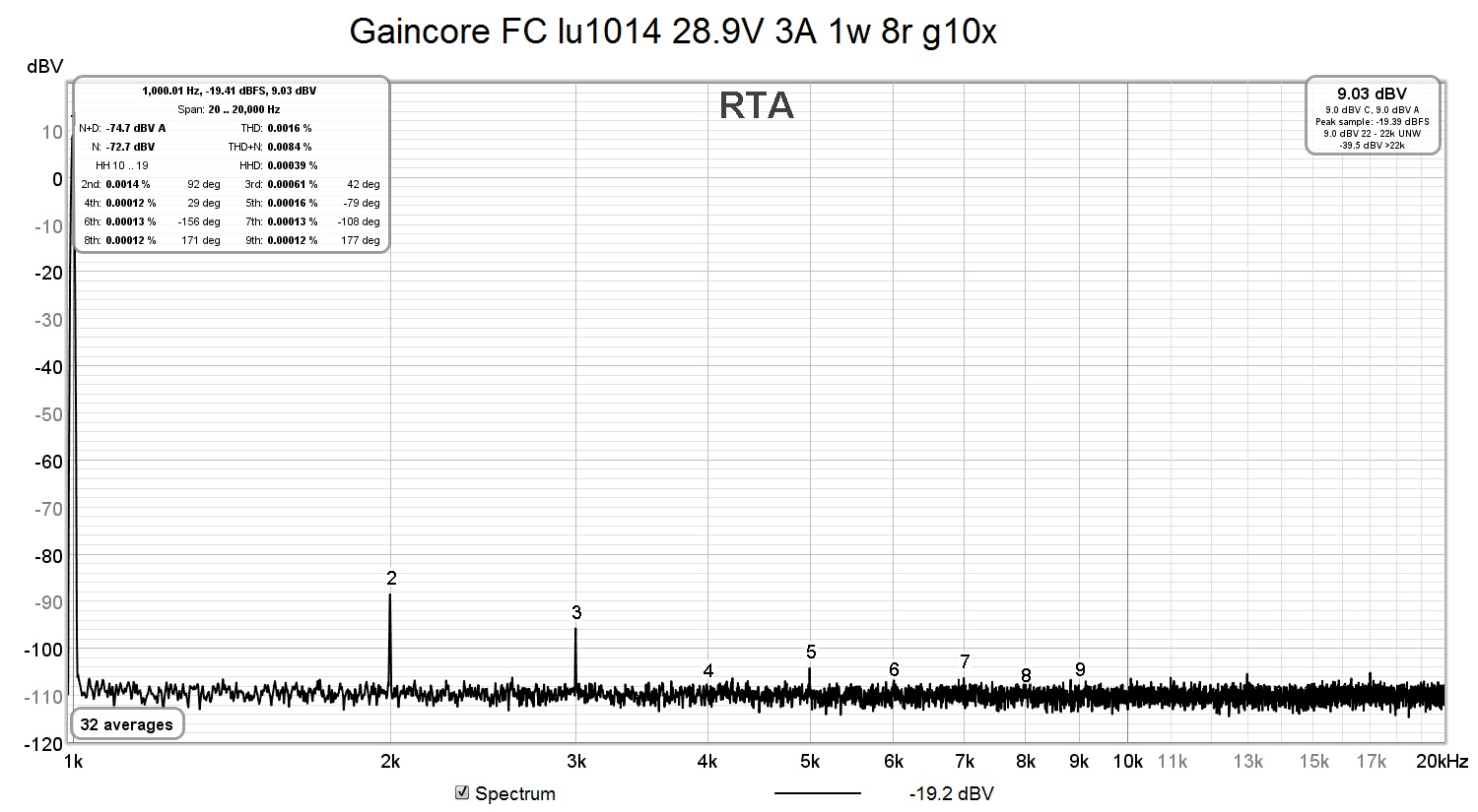

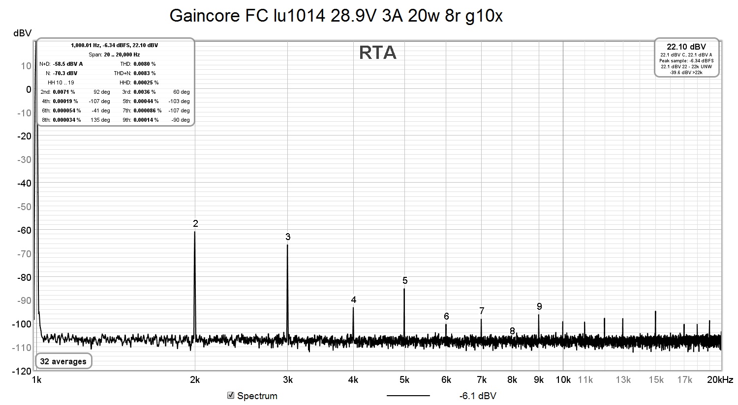

And here some measurements for 8r

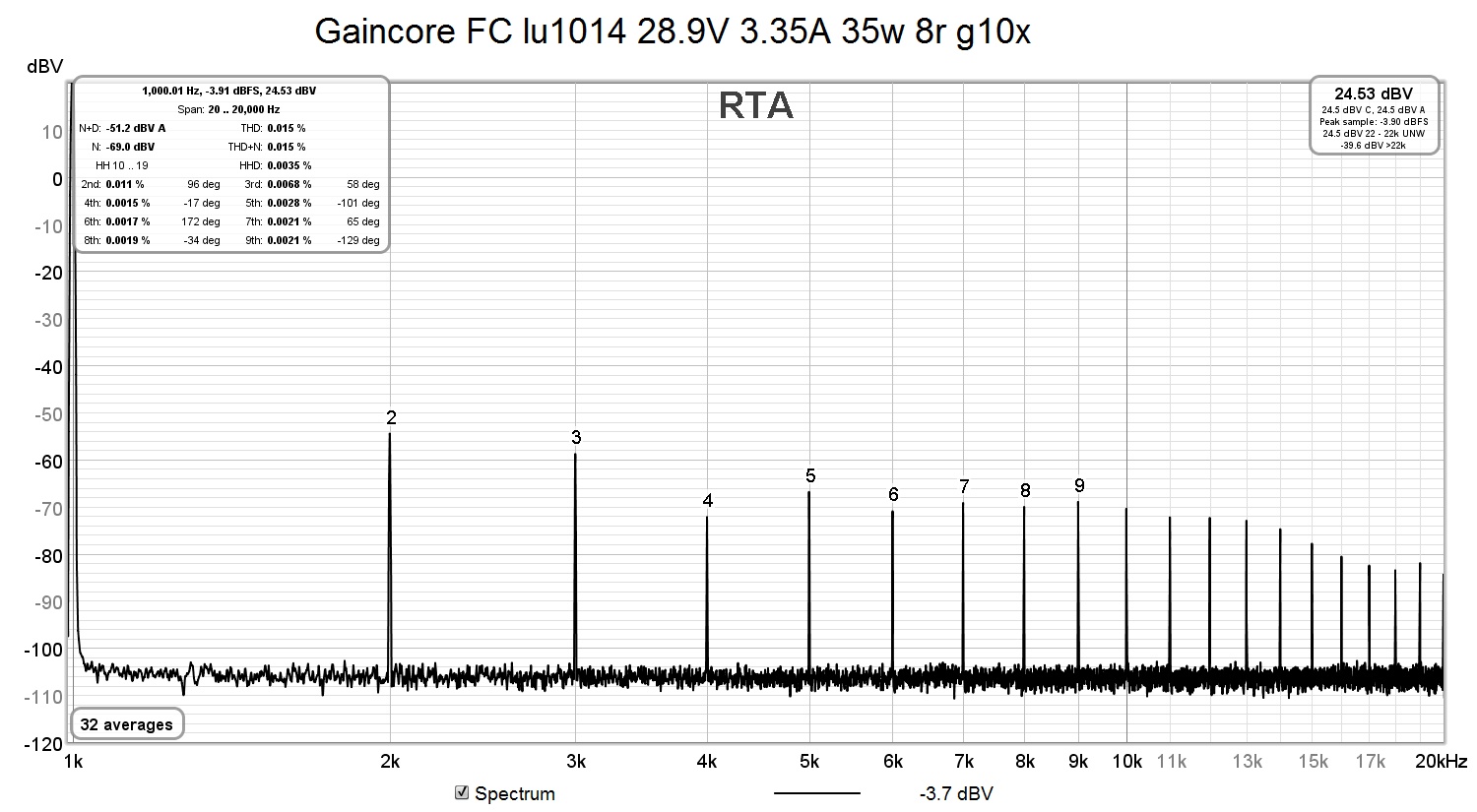

Here a bit more bias helps too with the thd at 30W and can get you 35W
