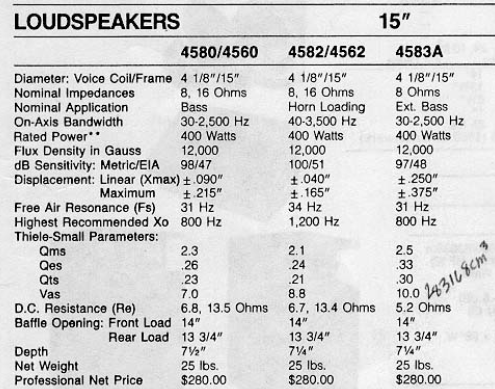

hi guys, I have a pair of gauss 4583a, I would like to build the cabinet but I don't know which type of onken or horn is best for this speaker. Is there anyone who can suggest an idea?ciao ragazzi, ho un paio di gauss 4583a, vorrei costruire il cabinet ma non so quale tipo di onken o tromba sia il migliore per questo diffusore. C'è qualcuno che può suggerire un'idea?

Specs here: http://www.bluearan.co.uk/sales/misc/Gauss 4580 Speaker.pdf,
but if these are old, they'll need to be tested
After a closer look, I see there are cabinet recommendations on the pdf
