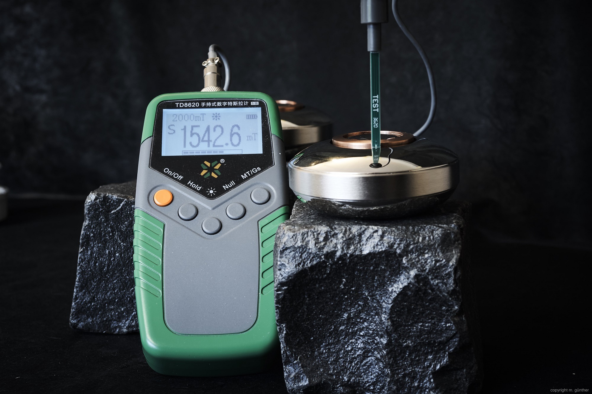

Despite the low price I´m quite happy with a chinese gaussmeter as pictured (don´t remember the name, sorry...). Easily available.

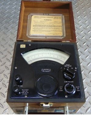

I had a Bell Gauss meter it was fine. However this may be the best for speaker magnetics:
Sensitive Research Fluxmeter Not common but they work with the voice coil you will be using. Similar to what Mr Fahey proposed. However its important to know what to do with your measurements.
