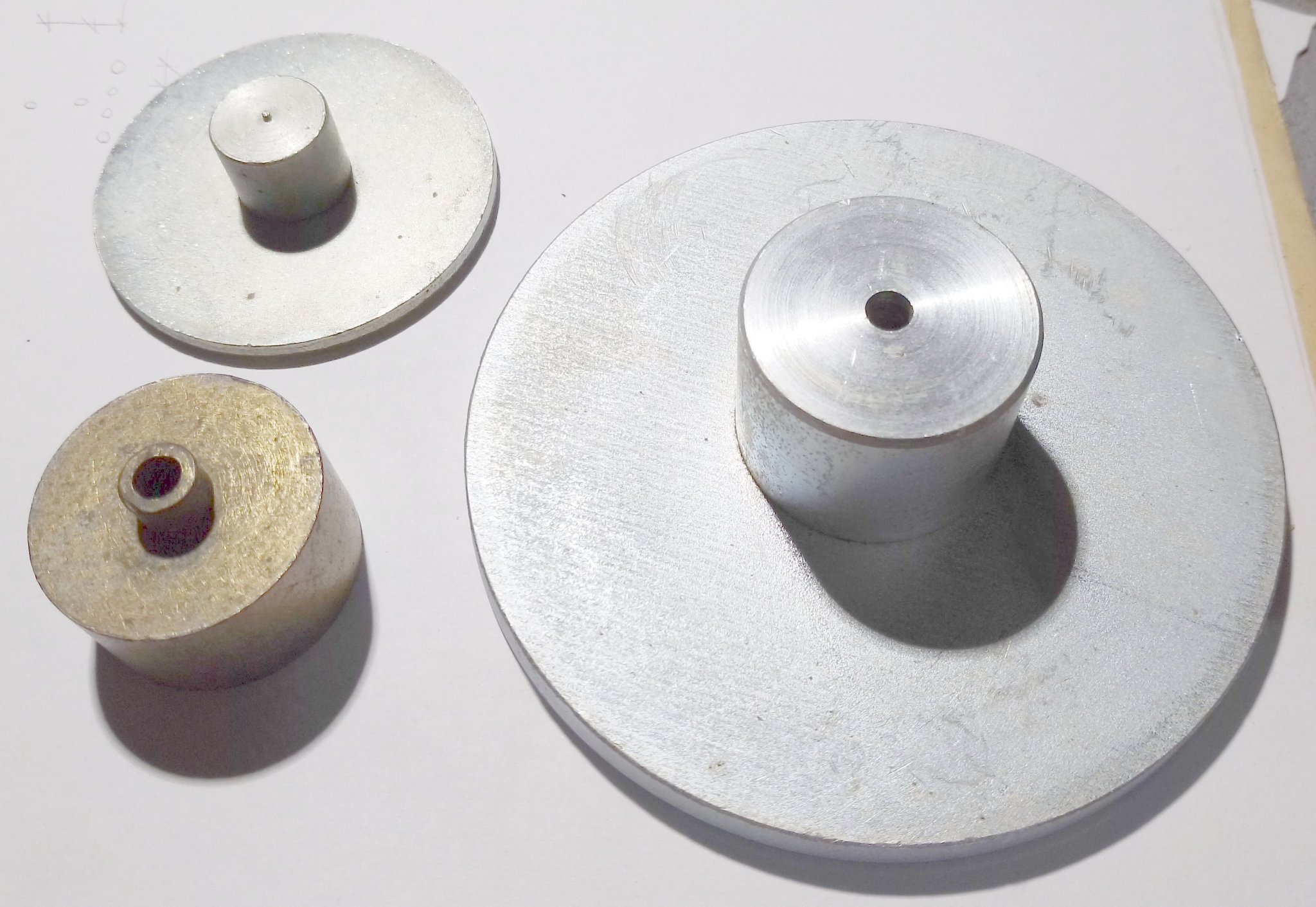

I make them from scratch.
I buy full (6 meter long) cold rolled round bar steel in 12L14 alloy, which is magnetically acceptable and much easier for the Lathe operator, since is gives out short (couple mm long) swarf; actual low carbon steel (SAE1008) is very soft and gives you impossibly long swarf which clogs the lathe, sharp edges can cut opeerator´s fingers or worse, a mess.
I turn them to proper size, including a little plate thickness length stump which is used to "rivet" it to back plate.
Plates are hydraulic press punched (if 130 mm or less) or Oxy flame/water jet/Laser cut from 6.35 mm, 7.92 mm or 9.5mm cold rolled SAE 1008 steelplate ... what everybody else uses by the way.
Then backplate and polepiece are pressed together, again in a Hydraulic press, I spot (resistance) solder front plates to stamped steel frames/"bells" orin the heavier models bolt gthem to cast aluminum ones.
All steel parts are zinc plated, best finish in my view.
Paint takes up too much thickness and when scratched allows water + oxygen in, rust then travels under paint, while zinc "sacrifices itself" to protect steel.
I wind my own coils, but buy cones and spiders.
Oh, and magnets, of course.
As an example (just what I had nearby), here you have a turned 1.5" diameter polepiece, showing the mounting stub , (I like to drill a vent hole through them), a similar polepiece mounted on a 130 mm backplate (my Guitar Speaker standard) and a 19 mm polepiece mounted on a 76mm backplate for my high power 4" cone tweeters,which I use in biamped Bass and Keyboard cabinets.

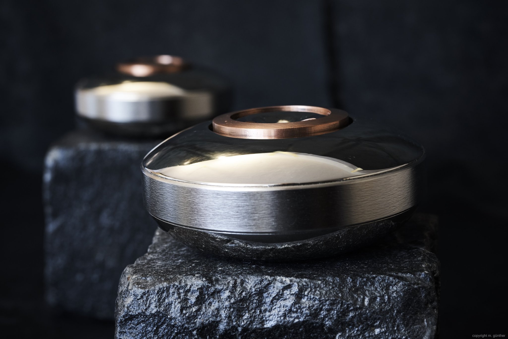

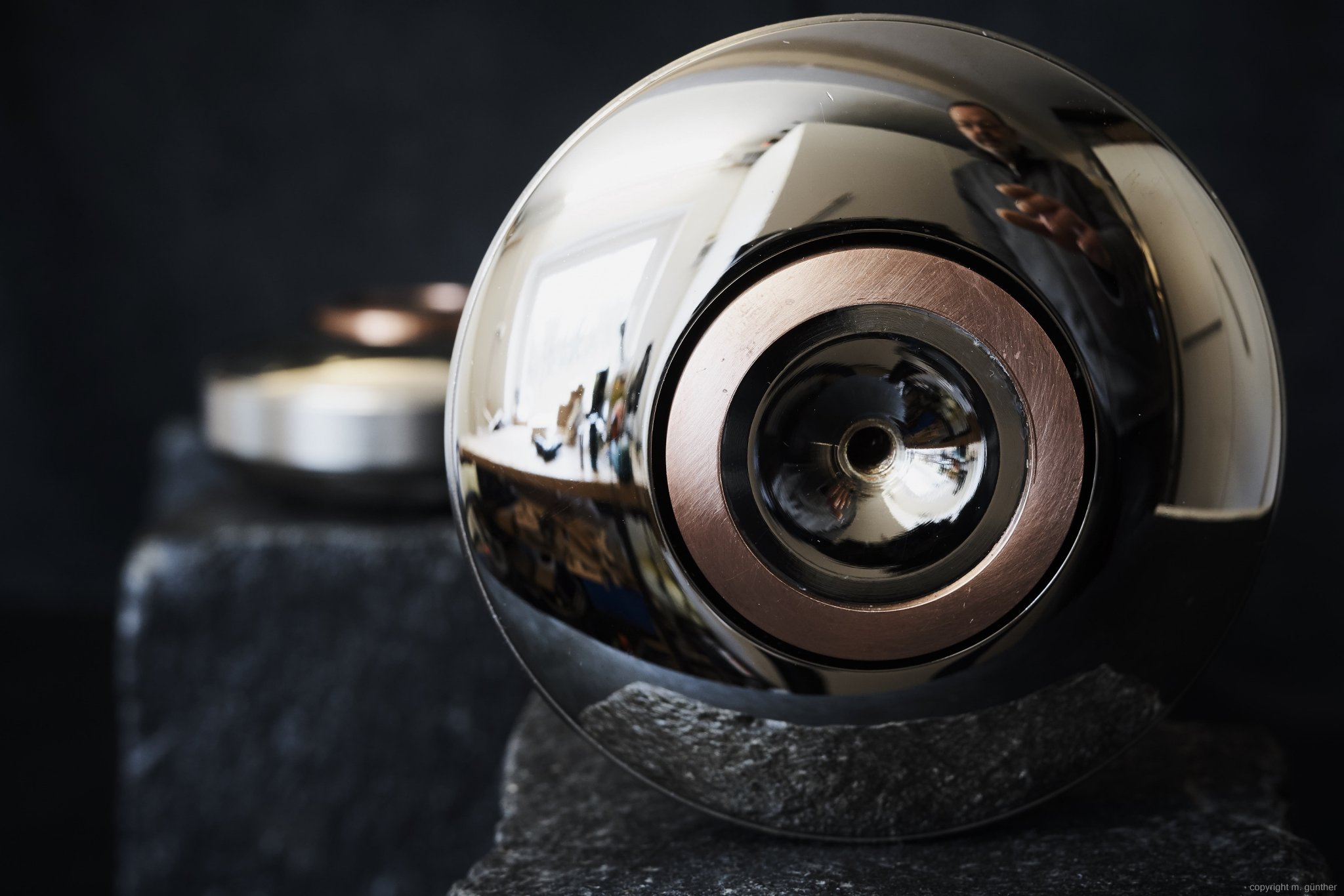

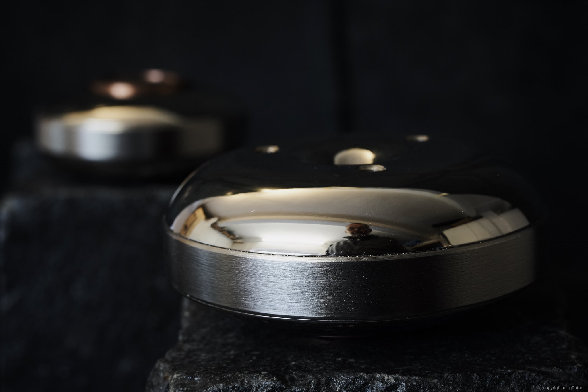

Hi Boden,
Indeed. This motor was mainly designed with FEMM, but of course was as well evaluated in real life at various steps. Reality showed good accordance with FEMM and proved not only that FEMM is working as claimed, but also that my method how to work with FEMM is correct.
The goal was to have a brutally strong motor with saturated pure iron pole plate and core, in order to have the strongest control and a max Qe. Don´t judge this motor by size. Many expensive FR drivers have gigantic motors, but if you look at the Qe values of the final driver, the energy seems to have been lost somewhere underway...
Despite their aesthetics, these motors are a true form-follows-function design. The geometry is optimized to the very last detail; every change of dimensions or shape of a mm or so will deteriorate the result.
All the best
Mattes

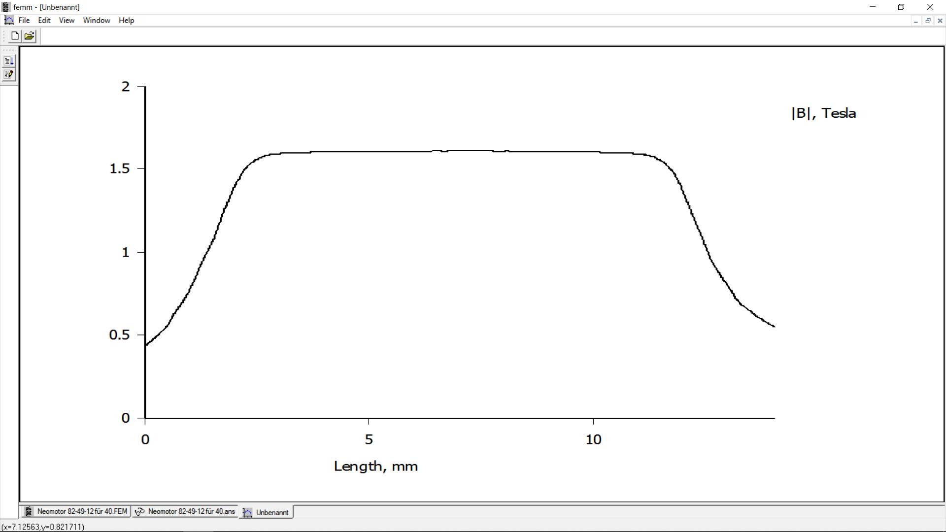

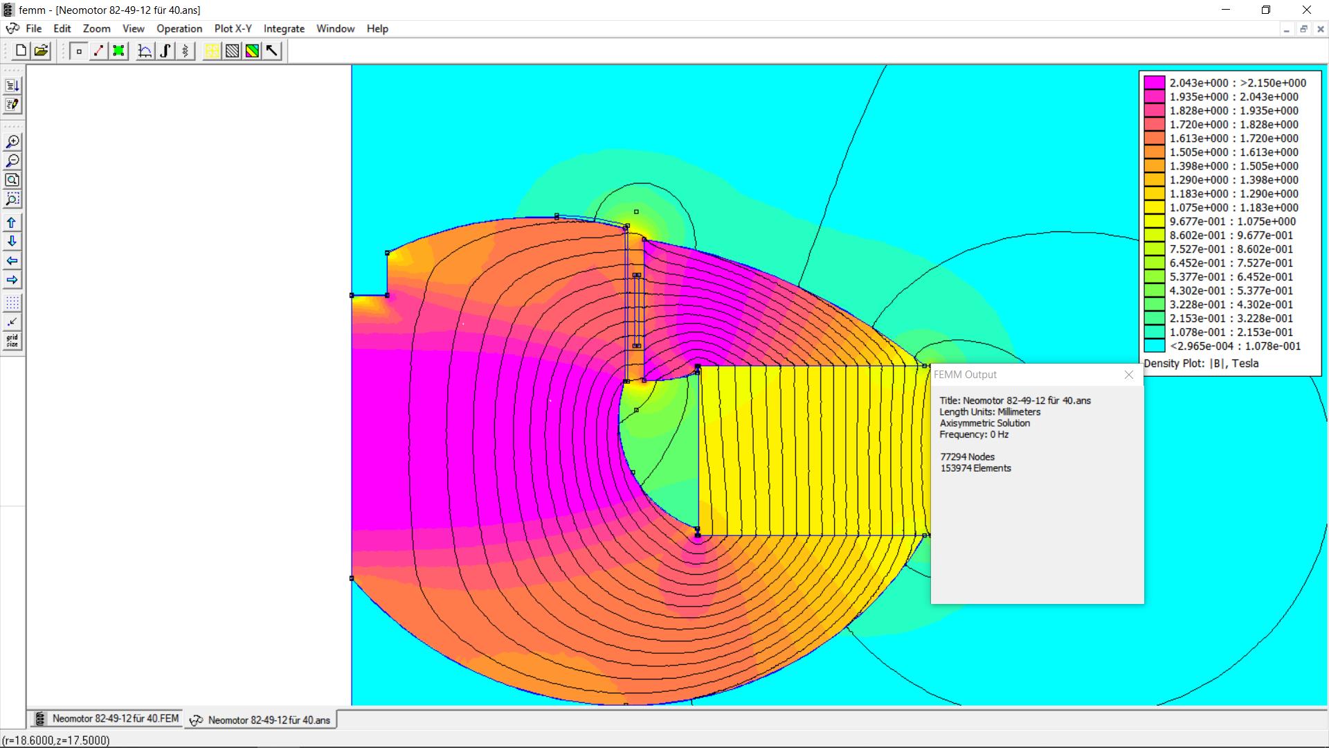

Hi Mark,
Yes, the left edge is the central axis, that´s how FEMM works with circular motors. Compare to the pictures above of the motor in reality. The central recess is a thread for the phaseplug.
1.6 T is extreme, yes. It is the simulated value - reality measurements show a value of 1.54 T. That´s close enough for me.
I wanted maximum motor control, as I have friction-free low-loss carbon arm front and rear suspensions which result in a very low mechanical damping, therefore the motor has to have control. It is extreme as this results in a very low Qts (0.09) driver which will not do any bass in "normal" applications.
With the given airgap dimensions (for a 40mm diameter voicecoil - chosen for various reasons - and a length of 10mm, to provide +-2.6mm linear travel of the 5mm coil, while having a width of 1.3mm as a compromise between flux and mechanical reliability) it cannot be any higher - as you can see, pure iron metal parts are already saturated at 2.14T, the maximum permeability of pure iron.
Whatever change in dimensions of metal parts or magnet you do, it will not get any better. In a simulation you can quickly explore gigantic magnets, field coils and changes in quality and shape of the core and plates. Nothing will give a better result, I have been there and have done it.
The only ways to have about 8% more flux in the airgap are to make the airgap more narrow (which means a higher risk of issues with production tolerances) or to use Permendur for the metal parts (or combine both, of course).
The use of Permendur would be extremely expensive in a small series, this motor already is a lot more expensive than many other drivers. It employs custom made pure iron (ALLIEDPUREIRON TM) parts in the complete motor and a custom made N52 magnet.
