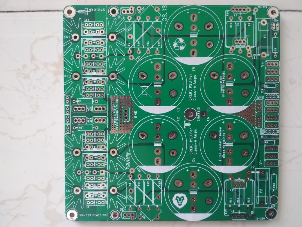

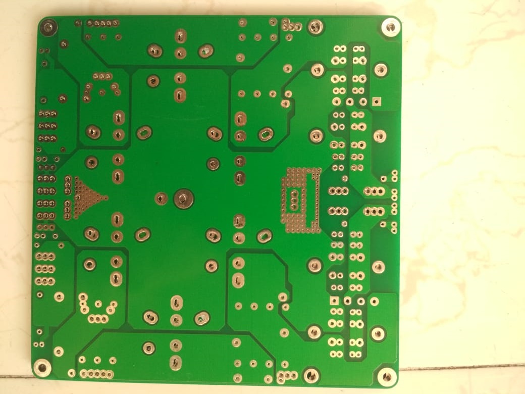

It looks like the LT4320 based ideal rectifier boards will also support the GSIB (Vishay PB) as well as the GBU style packages. Is there a way to have the CRCRC board support both footprints?
I have been looking at bridge rectifiers with the Vishay PB footprint as alternates to the ideal rectifier boards for their high current and low forward voltage properties. It would be convenient to have the CRCRC board go both ways.
I tried it, but was not possible to maintain adequate trace widths in the design. it was either vishay pb or ideal bridge. Ideal bridge will have super low Vf🙂
At that stage many people wanted ideal bridge compatibility, so i did that.

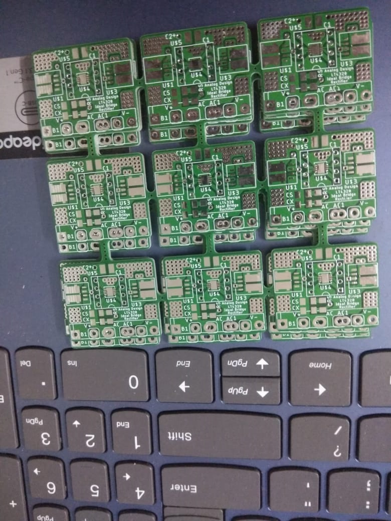

Hello all,
I got about 100 of the CRC PCBs delivered. 70 microns of copper on both sides and 2.4mm thick base, makes it look very sturdy!
Also the LT4320 from china by DHL in the last week.
I will take things easy and start sending out invoices as and when I get a moment. With financial year end, job demands more attention!:sigh:.
Regards
Prasi
