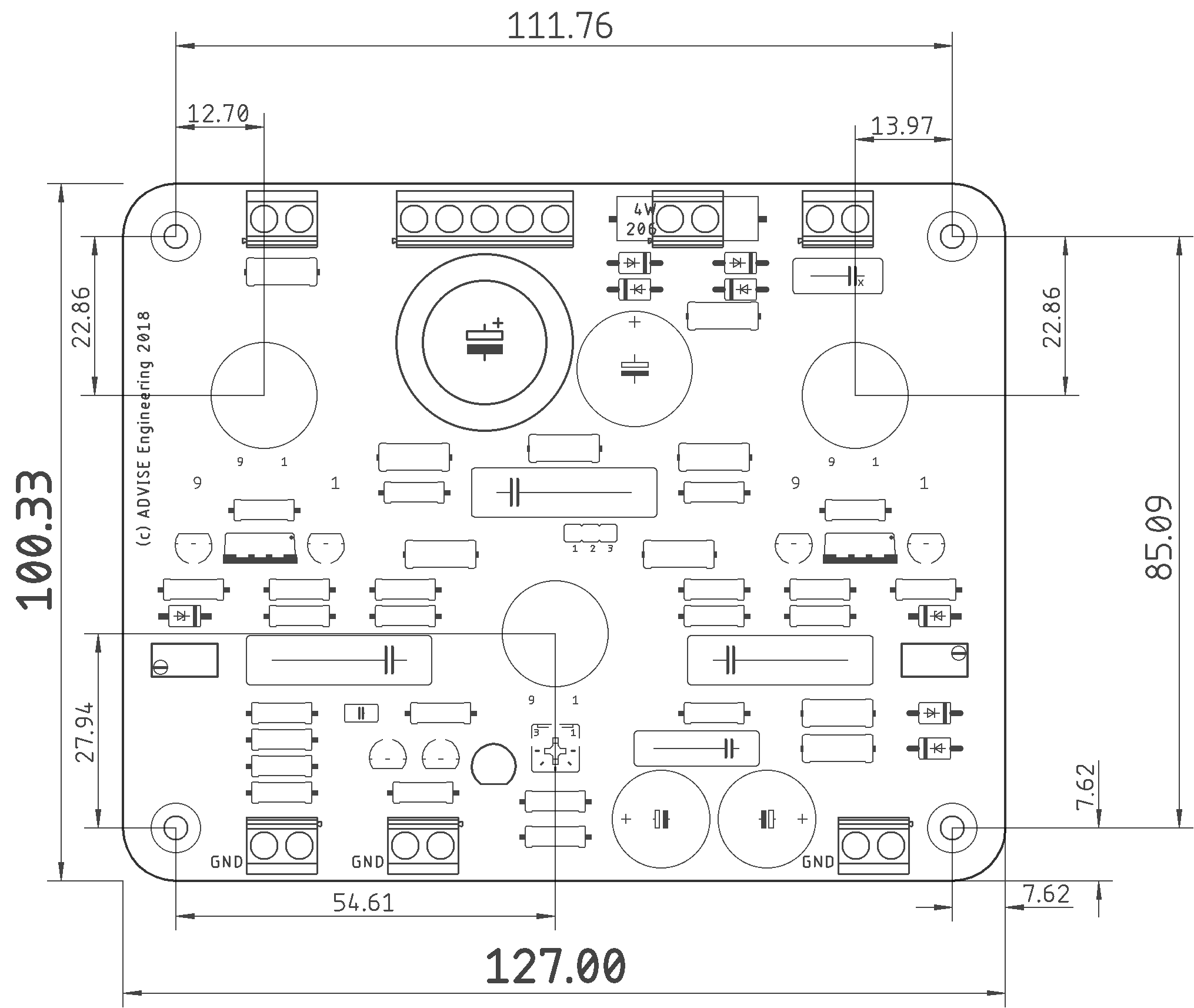

Hi. Does anyone have a panel cutting plan for the current EL84 PCBs please?
Or a drawing of the PCB with detailed dimensions where panel holes need to be?
Hi DCH,
let me know if attached is ok?
regards
prasi
The zip file contains the dxf format
