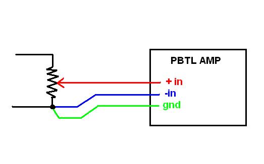

Input lines:
Better like this where green line is shield.
And use a low value of pot if you can. (2K or lower)

Have you also tried removing that wire that binds all RCA grounds together?
Could you perhaps post a schematic of how your RCAs are wired to the DUG PBTL boards? This is what it looks like to me:
Code:
RCA_1_HOT - red wire - DUG_1_POS_INPUT
RCA_1_GND - clear wire - POWER_EARTH/CHASSIS
RCA_2_HOT - white wire - DUG_1_NEG_INPUT
RCA_2_GND - clear wire - POWER_EARTH/CHASSIS
DUG_1_GND_INPUT - floating
In other words, it looks to me like you have two RCAs going to one PBTL board... but maybe that's just because I can't see how the potentiometer is wired.
My DUG boards, and all my tpa311x boards for that matter, have a very slight hiss that can only be heard with my ear right up next to the speaker. Whenever I'd had worse problems, it's been due to a wiring error on my part.
I suggest going back to basics: take the pot out of the circuit entirely, so you have only amp boards and power supply. Use a smart phone or PC or something (that has builtin volume control) to feed the amp boards directly so you can bypass the pot. You might even want to remove power from one board and test them one at a time. Basically, simplify the build down to the absolute minimum. In such a basic config I would expect no hiss.
Actually, an even simpler test perhaps: have you tried with different input devices? In particular, try an input that runs on battery (smartphone, laptop) to see if that changes things at all.
Maybe another simple test is to attack it from the other end: remove all power to both amp boards, and try something like a 12v battery for just one board. You could probably even use a simple 9v battery for a really quick and easy test.
My hunch is a ground loop of some kind; if you can get your amp running without hiss in one of the above alternate configs, it might help pinpoint the source of the ground loop.

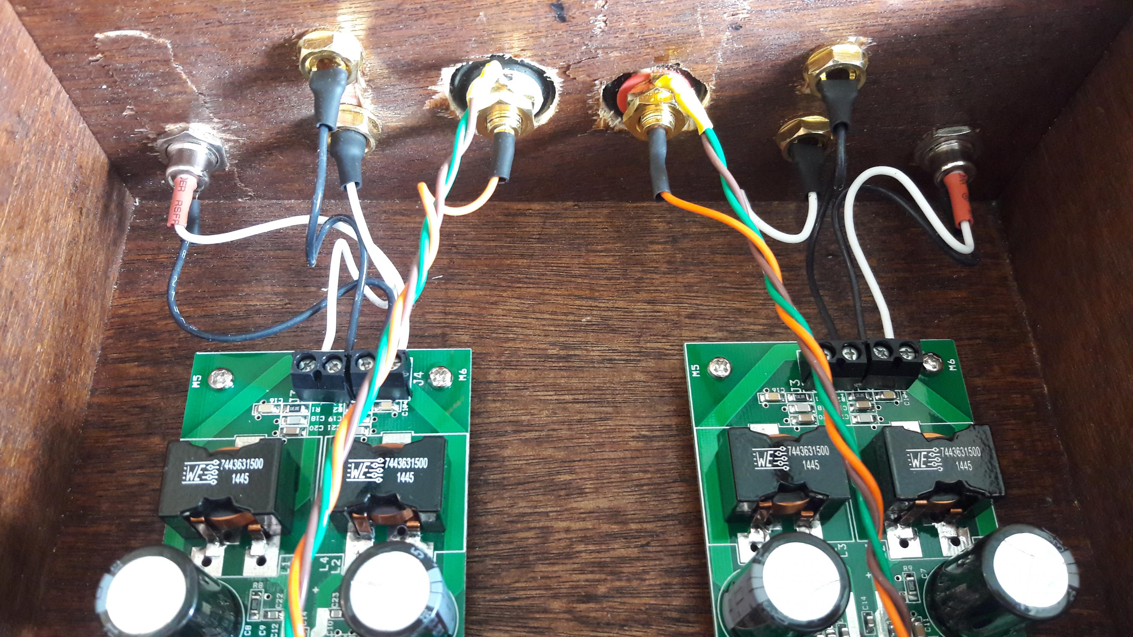

Can you provide more info or pictures on the pot wiring and input wiring in general?
Also, don't think it matters but you seem to have an extra wire from the SMPS to the star ground (i.e., two green/yellow connections).
Like m_g suggests above and you have already started to do, strip down to basics and bare essentials and see where you stand. Then start adding back your extras.

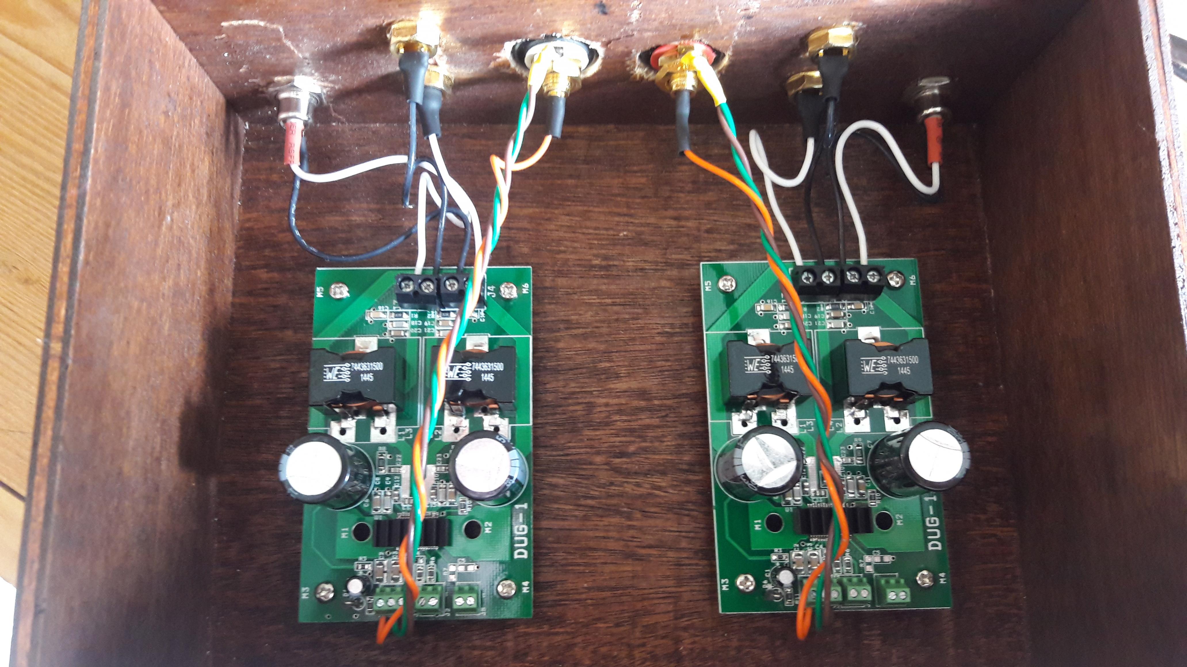

hi,
thanks all for your time and good advises!
all parts disconnected, i put a 9v battery to power up both dug boards, and cellphone connected straight to dug inputs: boards are dead silent, sound is fine!
if i disconnect the cellphone, so input line open: then i have this hum very load!
then i put back the smps still with cellphone connected straight to input line of dug's boards, and same result : dead silent when no music ! and no audible noise while listening something, but then also when line disconnected (open ) this load hum!
should the dug's board be silent with input line disconnected (open)?
before doing all of that ! tests were performed with a Teac PD-301 as input line.
by putting the song on pause, and rising up the volume , hum noise was there.
sylvain

Thanks for the pics and additional info, Syl20m.
I can't speak to the DUG since I don't have it nearby, but I normally ignore noise with open inputs. Shorted inputs = no noise = amp is fine at a basic level = focus elsewhere such as wiring and layout. I even have a set of "shorting plugs" that are simply RCA ends with the signal and return connected that I use for setup and testing.
You might try lifting the ground on that input selector and try a single pot for both channels.
Less gain might be helpful in your case (2V input and 92dB speakers).
I also have the M2 and it's one of my favorite amps, but of course a different kettle of fish and also not the quietest if you are super sensitive to that.
Hopefully more knowledgeable folks can provide further guidance.
BK

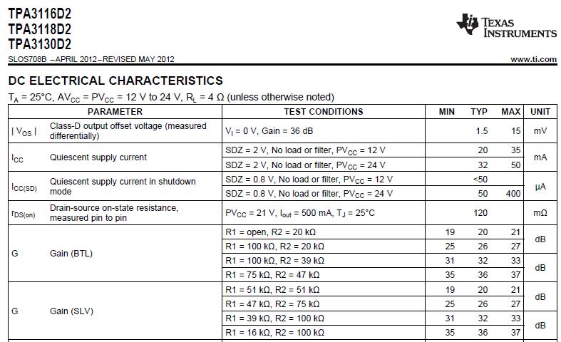

So I'd like to correctly set the master/slave configuration. I'm keeping 26dB gain, so on one of the boards I'll change the R4/R5 pair from 100k/20k to 75k/47k. I'll also populate C5 and R7 on both boards with 47pF and 4.7k respectively.
1) Do all these values check out?
2) Do I connect both pins of J5 (GND, SYNC) to eachother? I believe the boards have shared ground plane anyway, but maybe twisting the sync wire with gnd is a good thing?

Don't forget to set master / slave gain resistors.
I would place the resistor on the master side. This isolated any capacitive loading of the master side. Put the capacitor on the slave side.This will help reduce noise pickup.
Because it is a single board sharing a ground plane, you could connect a thin wire point to point on the bottom of the board...keeping it close to the ground plane. This will help minimize noise pickup.
