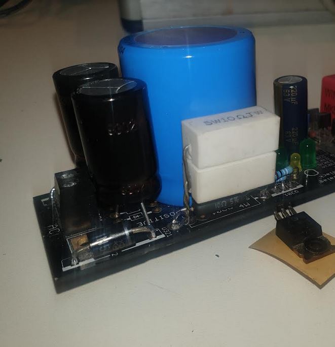

I used two diodes (in place of 4 diodes in the bom) and a pair of 1000uF caps I happened to have laying around and it appears to be working well and stable.
7,3VAC input, 14,3VDC on the main psu C105 cap, 6,8ohm R101 resistor for 400mA CCS current heatsinked to the case bottom. The output is set at 7,5VDC for less than 150mA.
I think the Q101 temp at 60°C is a little bit too hot, I am using 4 diodes in d102.3.4.. position, would temp on Q101 go down with only 3 diodes?
With 300mA CCS the Q101 temperature should ease significantly. Using three instead of four LEDs and/or different value R101. You might need a smaller resistance value for your CCS goal when with fewer LEDs. There are tolerances in Mosfets Vgs & LEDs Vf so its important to verify the result. See if it actually runs 400mA now. The voltage drop between R101's legs divided by its Ohmic value proves the CCS current in any case, now or after changes.
Now with only 3 leds, 3,3ohm R101 resistor and CCS close to 300mA (about 310mA were measured), the temps are cruising at about max 45°C!

Here is a close up of the doubler (2x 1N5403 and 2x 1000uF were used):
This SSLV 1.1 with remote sense is powering a DDDAC motherboard @8,25VDC, next are a 470uF cap and a L78S05CV regulator (with further 4xLF33 regulators in parallel).
Is the 470uF cap actually necessary from SSLV 1.1 point of view or would it be better with a different/no following cap?

Now peace of mind is with the 470uF cap, thanks.
