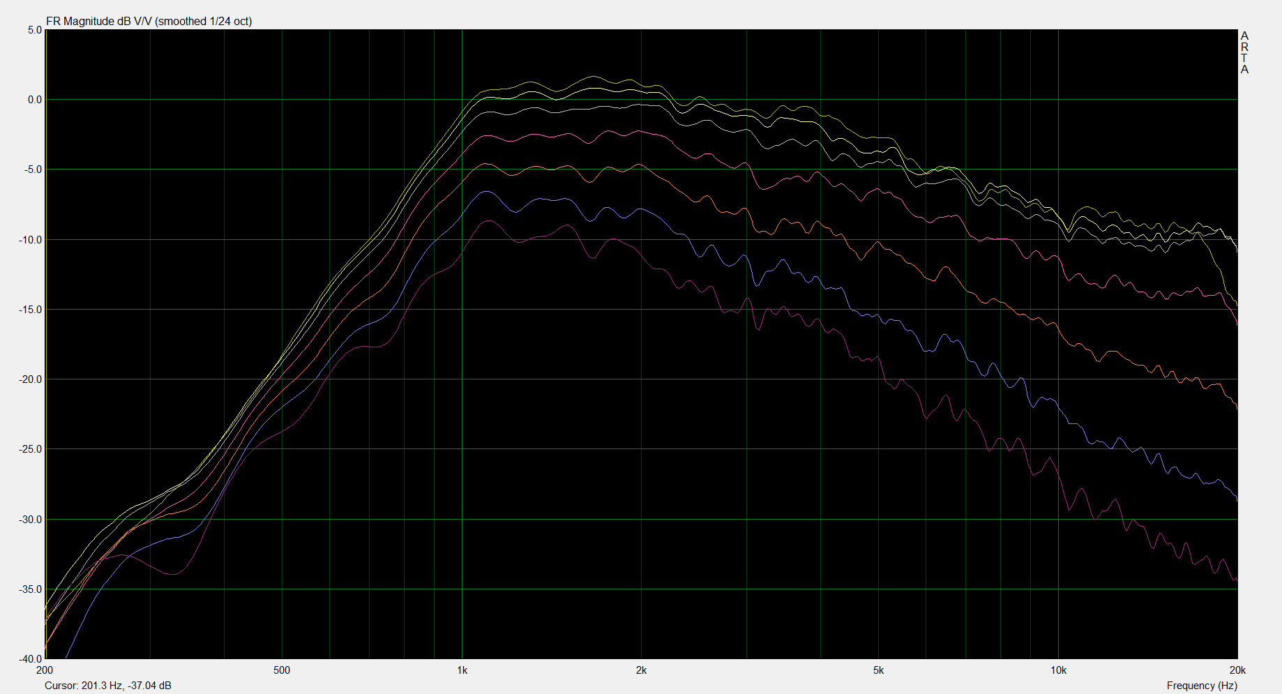

I have a 1" dome on a 120 degree waveguide. It does not start to beam until about 18 kHz. The directivity of the dome itself is not a problem because of the waveguide.
I find that incredibly hard to believe. Can you support it with real data? The wider the waveguide the less its control on the directivity and the sooner its ability to do that will fail. So what is possible at 45 degrees is impossible at 120.

Based on the diameter of a 1" dome your claim seems to be more than wishful thinking. Wavelengths smaller than the diameter will cause the dome to bend and these bending modes are part and parcel to the breakup modes of any dome tweeter whether they are soft or hard domes. Any study of dome tweeter diaphragm's shows this very clearly. A waveguide can help direct the wavelengths larger than dome diameter but above that point directivity is not affected truly by the waveguide to the affect you speak of. It just isn't physically possible to solve that problem. It is very similar to the problem of compressions driver exit diameter and waveguide coupling.

Here's the raw measurements of my waveguide on a baffle with a 25 mm radius, 0-90 degrees in 15 degree steps. Just above 20 kHz the dome starts to break up, because of that the dispersion starts to widen again already slightly below 20 kHz. There's very mild narrowing above about 10 kHz, but I'd say big differences only appear just below 20 kHz...

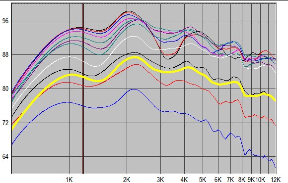

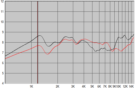

I have radiused my waveguide. I noticed a reduction in content around 1k, and I assume that's a good thing.

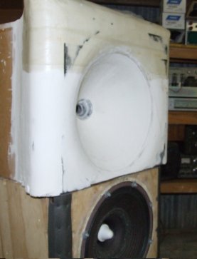

I'd like to know what the peak (2k) and dip (1k3) are from. The waveguide (under construction, 15" woofer for reference, power in yellow (response level not absolute)) is OS, I hope, down to 1k3 where the perspex ends in the photo with a conical profile until the roundover. IIRC the mass rolloff of the DE250 happens here but I don't recognise the response profile well enough as yet.
