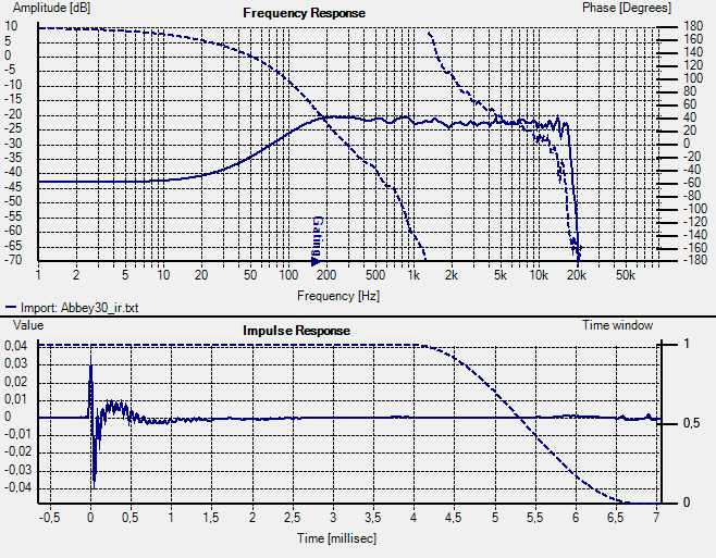

Hi Earl,
Sorry for the mishap yesterday. The system did not allow me to upload the attachment, so I removed the message. Hopefully, it’ll be OK now.
I have attached a paper, visualizing my line of thoughts, so perhaps you could refer to the paper while reading the reminder of this post.
Figure 1 – Shows the original woofer and tweeter drivers – from manufacturer’s specs. I do not know, if the tweeter’s data was taken with a HP filter.
Figure 2 – Reconstructed woofer and tweeter. Phase is generated from SPL via Hilbert-Bode Transform. Please note, that woofer is installed in a sealed box – as indicated by the asymptotic SPL (-12dB/oct), going towards lowest frequencies.
Figure 3 – Given the information from the previous posts, I have re-constructed one possible version of Abbey’s crossover. I have no idea if this is correct, and I am only showing one LRC network across tweeter. My understanding is, that there are 3 such networks.
This figure also contains minimum-phase response of the whole system.
Figure 4 - IR of Abbey and SPL + Phase response. This was obtained from your file Abbey30_ir.txt using SoundEasy software. Please note remarkable similarity in phase response between measured and modelled. All phase transitions are in correct places in both: Figure 3 and Figure 4.
Figure 5 - IR of Abbey and SPL + Phase response from HolmImpulse. Setup parameters are shown as well. Please note remarkable similarity in phase response between measured and modelled. All phase transitions are in correct placed in both: Figure 3 and Figure 4.
Figure 6 – Pos’s measured tweeter phase response.
The goal of this whole exercise was to correctly determine phase response of the Abbey. It should be simple and easy to do. Knowing the phase response of the measurement chain would also help.
But all the above may turn out to be just a fantasy (and I would not be surprised if it did). Without your input I am not able to progress any further with this issue.
Best Regards,
Bohdan
  • System_Phase_Abbey.pdf
Ok, I understand the plots, but I don;t understand "Without your input I am not able to progress any further with this issue." You have the phase - its in the Holm data that I posted. I don't understand what is missing.
I will say this however, the DE250 data that you show is for an entirely different waveguide than mine and the data is completely different than mine. Hence any similarity in your reconstruction is likely a pure coincidence or "just a fantasy". (Or the fact that it is a minimum phase system so the phase ends up correct for the same end result no matter how you get there.) I don't know which. I never look at the phase so there is not much that I can add.
This is the response of the whole system, from the IR Earl posted.
I did reverse polarity to get the first peak positive (and have the phase shifts in the right direction up high).
I also applied windowing to the impulse in HOLM, so that the response in the lows looks smoother and shorter than it should.
I chose the impulse offset so that the phase response reaches 0° around 10khz. Response above 10khz does not look to be minimum phase anyway (due heavy diaphragm breakups I suppose), so I let the phase alone up there.
So here choosing this offset I am basically "hiding" the low pass behavior of the compression driver (as well as amplification and measurement systems), because showing it would not have a lot of interest.
Of course any other offset or phase polarity could give a different view of the phase that would be equally "true", so it is just a matter of choosing the one that suits your needs.
The one I chose let you see the theoretical behavior one would expect from that speaker (24dB/oct acoustical crossover at 1200Hz), and is easier to analyze, or correct using rephase for example.
